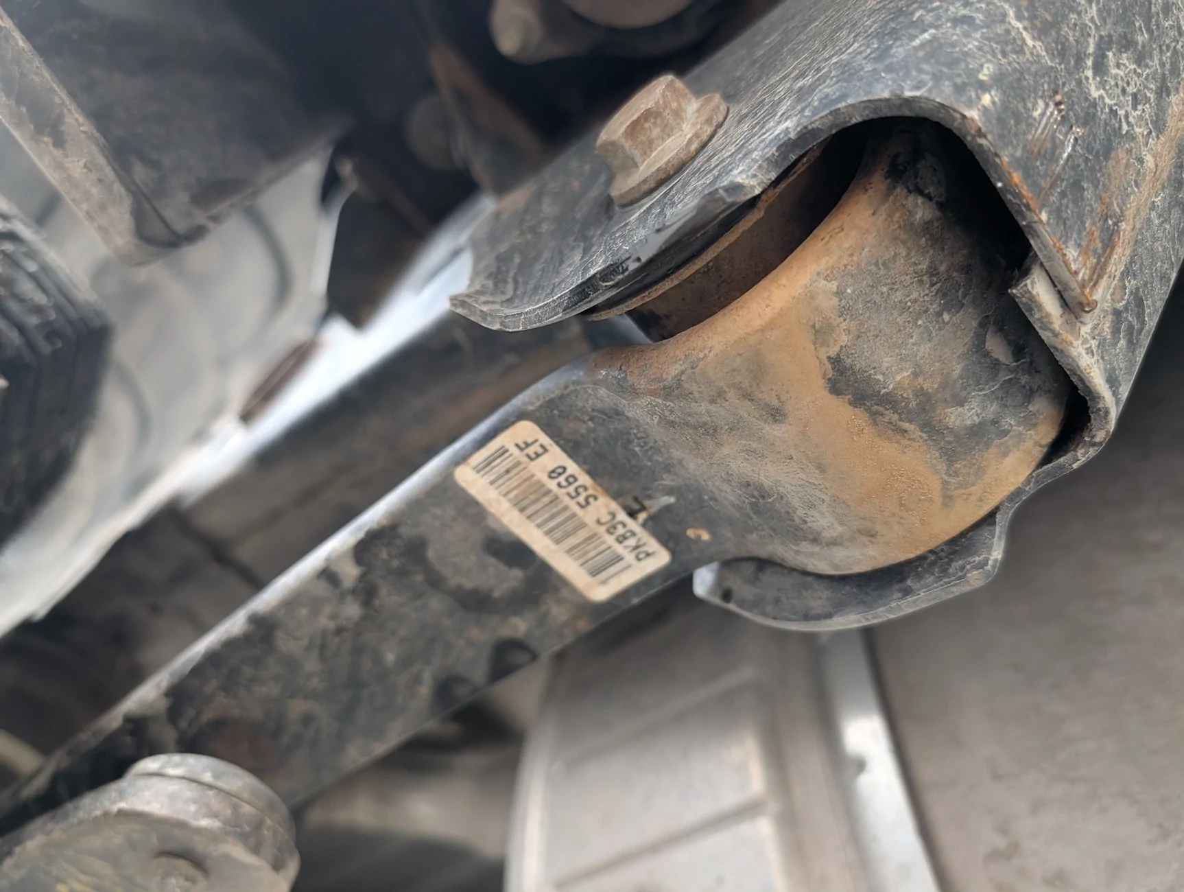

About a month ago I sent my ranger into a local shop to have my rear brakes/rotors/calipers done. The tech put it on the lift as usual, started lifting the truck and promptly stopped once he realized the front of the truck was going up and the rear axle was still touching the ground.

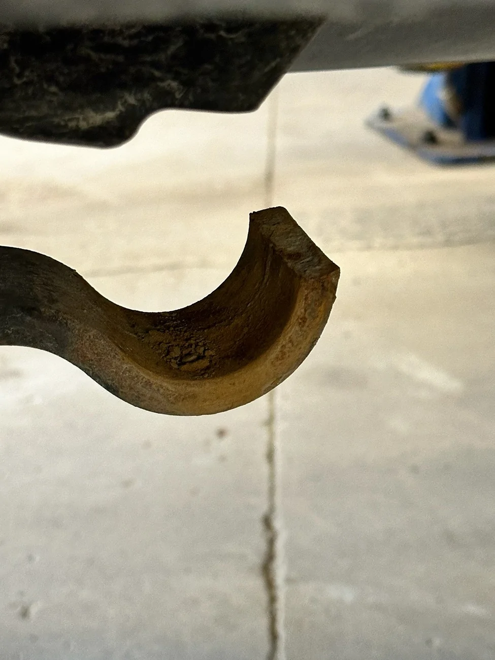

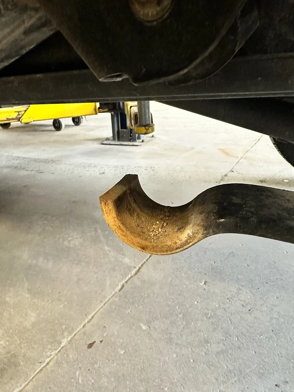

Long story short, both rear leaf springs completely fractured at the radius of the front eyelet at an almost perfect 90° angle, in the exact same place on both sides. Signs of advanced oxidization, meaning they have been fractured for a while.
Obviously indicative of an improper heat treat/defective parts/yadada.
Truck has 65,000km on it, 2019 XLT. Barely outside the factory warranty for milage. Highway/city driven it's entire life.
Dealership says nothing they can do about it, get in contact with Ford customer service, rep agrees on the phone that this failure is completely out of the norm. They humm and haww for two weeks and offer to cover 50% of the repair, which they quote at $2300. I tell them that's ridiculous, I can buy better aftermarket parts and install them for hundreds of dollars cheaper than what they're asking me to pay. They tell me too bad, even after acknowledging how dangerous of a condition these faulty parts could've caused.
Ultimately I replaced the rear leaf springs with OME EL120r's and am currently drafting a letter to Ford HQ with invoices for the cost of replacement parts to return my truck to a safe drivable state and the transcripts of the recorded phone calls with customer service.
Filed a vehicle defect safety report with Transport Canada, doubting I'm going to hear anything back from them, but i kept the old leaf springs just in case. Considering legal action at this point as well based on if/when I get a response from Ford HQ.

I think I have some pics in the other thread - (Snap-Shots) from a random video showing how they are made - at a point in the video it shows the (Die Press) that holds the plate as its rolled (creating the eyelet) - so far it looks like they are all breaking at the exact same spot (and its where the die set) holds the steel in place - even with a new leaf, you can see a small indention into the steel plate - so that's possibly part of the issue and then followed by (moisture) entrapment in the bushing compounding the issue.
Crystal lattice fracture of the metal. This is a classic failure example. Happens with steel wheels along the rim edge as well. And lots of other materials.
I knew that NCSU Material Engineering Lab Class would come in handy some day! Didn't think it would take 45 years!
