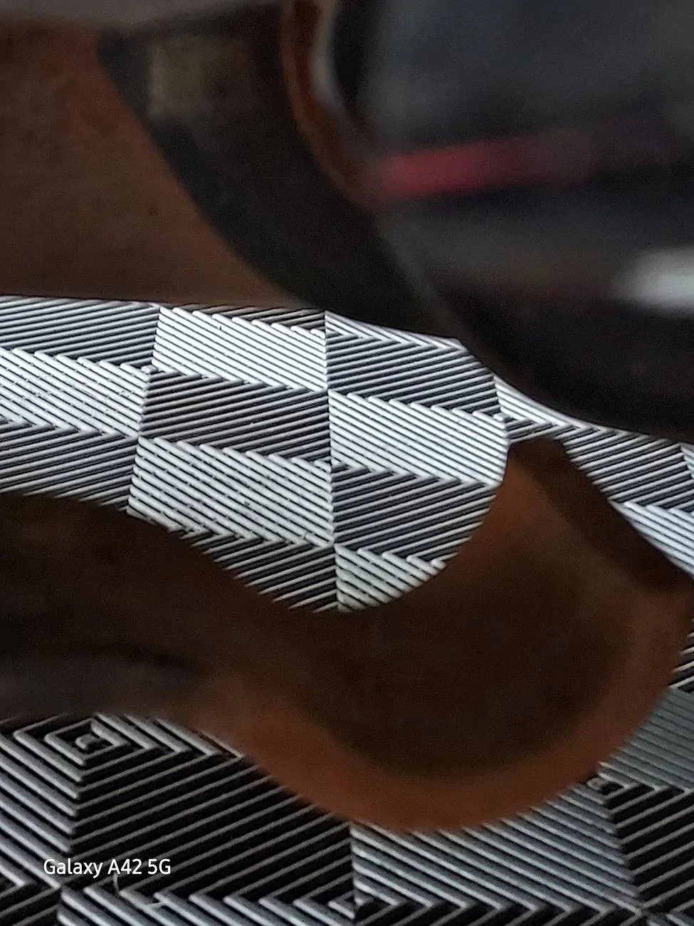

Just had passenger side break.
2019 Ranger XLT 2wd 37400miles.
