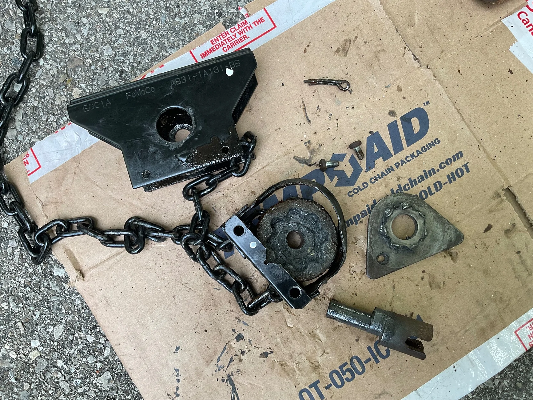

Even if it fits, it might be too heavy for the chain winch/mechanism thingy. Mine would no longer lift my 275/70R17 (32”) General Grabber so I took it apart to see why and determine if it could be repaired - nope, toast.
They are made from very soft material, wrapped in cheap pot metal. :(

Any idea what’s it’d cost to replace that?
Regular Price: $218.92 CAD - on sale for $156.04 CAD with free shipping.
Works out to roughly $157.00 USD - on sale for $112.00 USD
