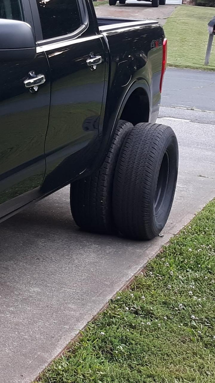

I noticed this awhile back so I decided to take the spare off and put it beside the other and it is very close. On my truck the regular tire is 255/65R17 and the spare is 255/70R16.

So trucks that came with 18" tires got a 17" spare, and ones that came with 17" got a 16"?
If any, not all, and 2019 may be different than 2020. My 2020 Lariat 4x4 (non-FX4) with chrome package came with 18” road wheels and a 16” spare.
