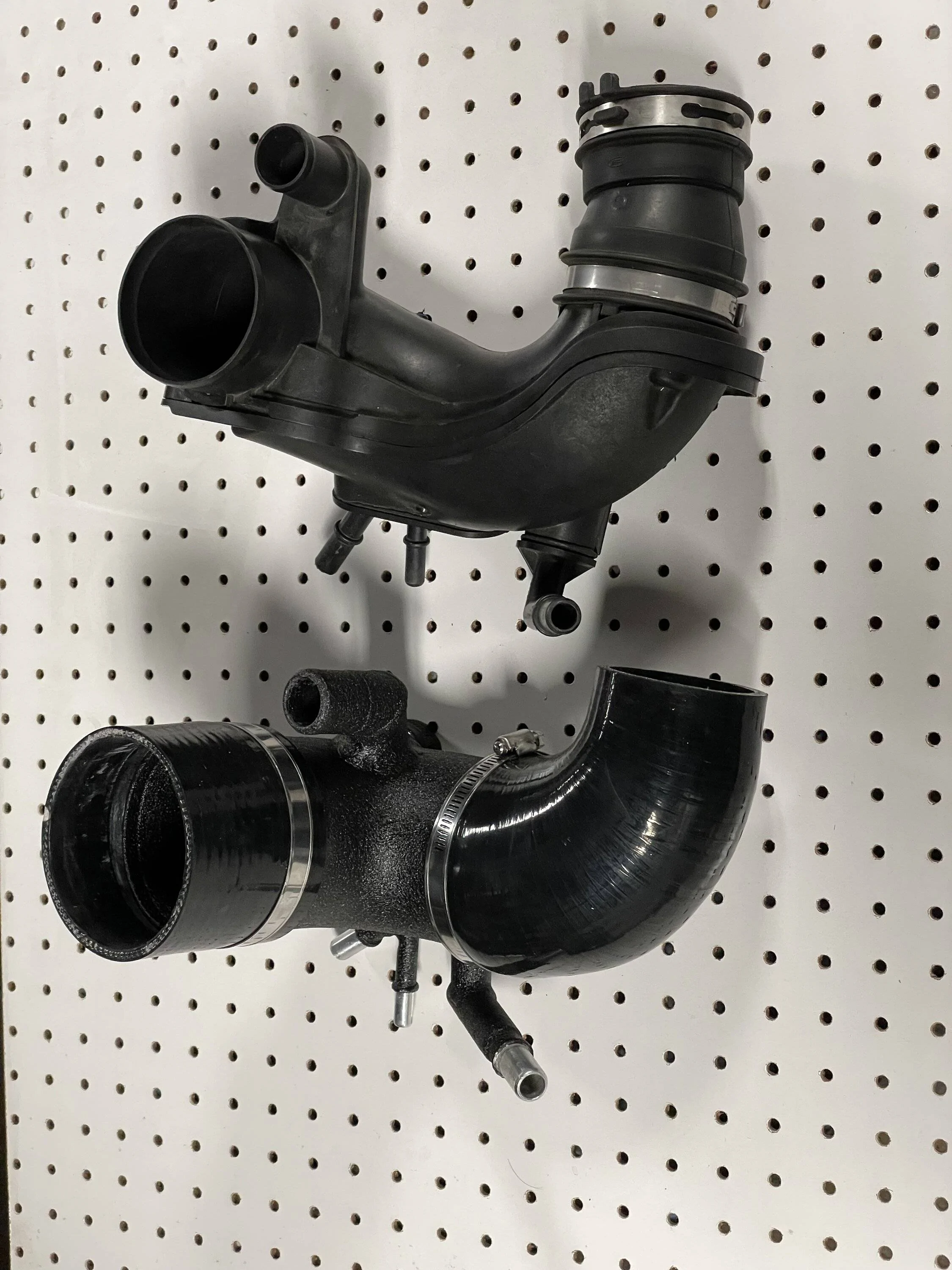

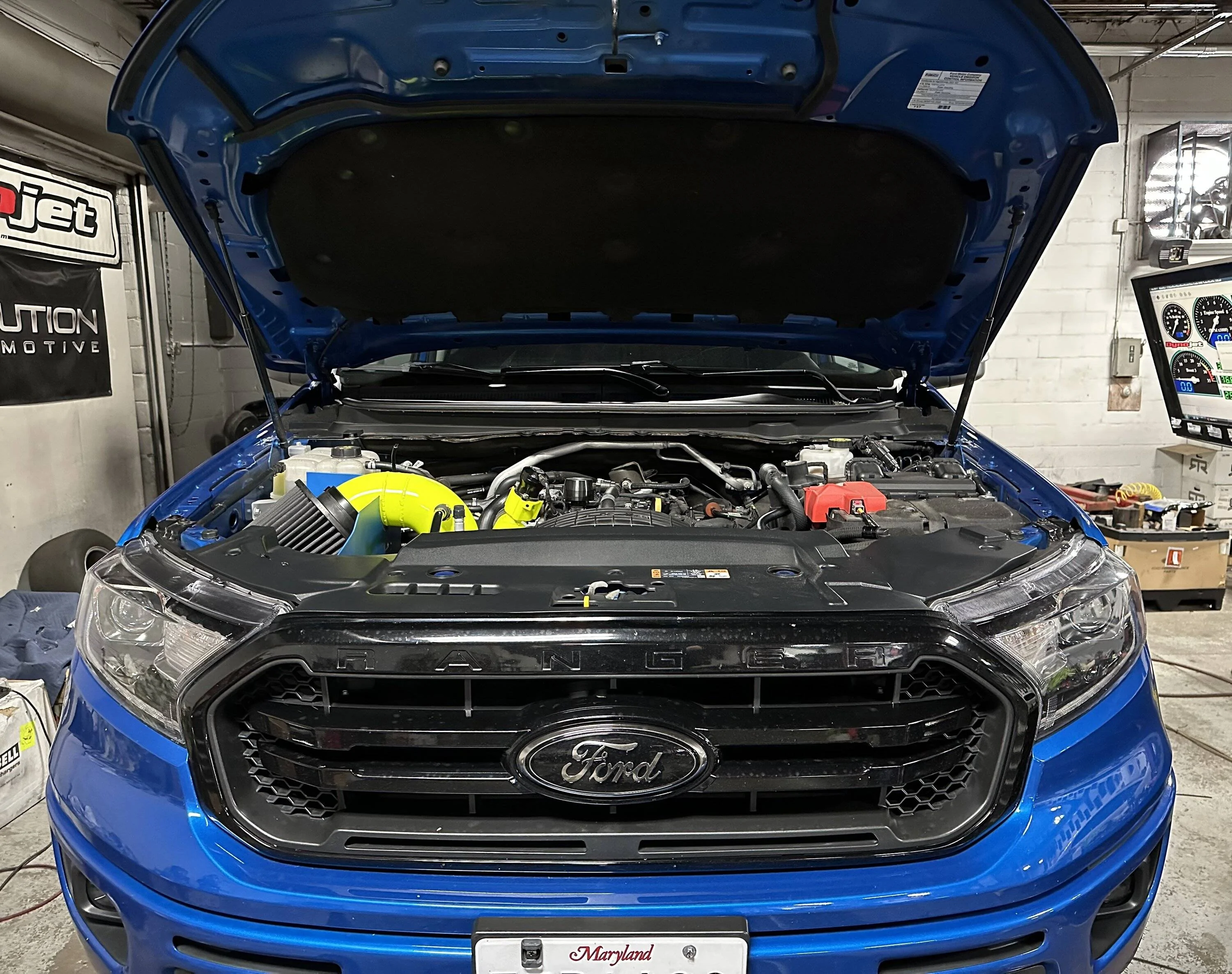

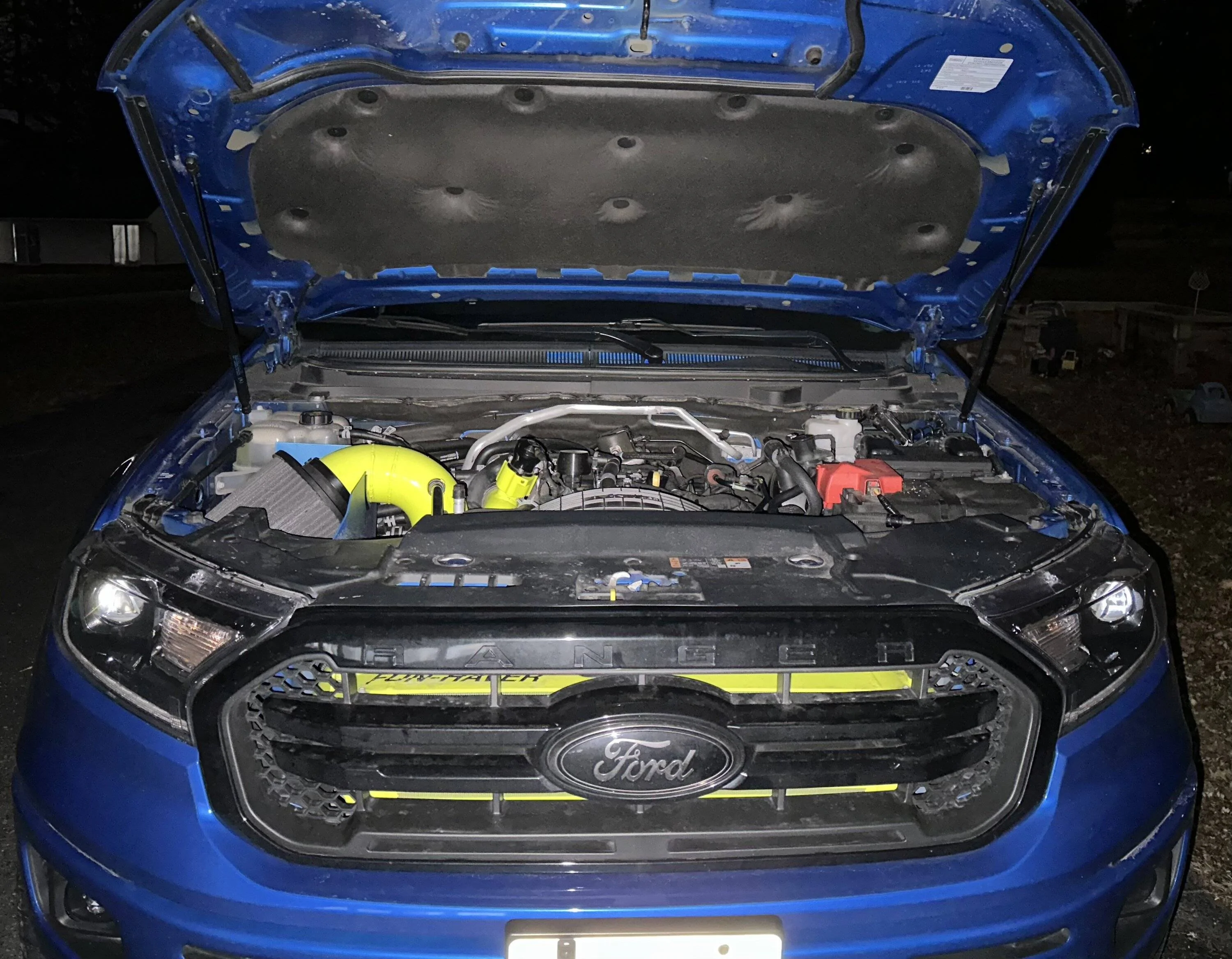

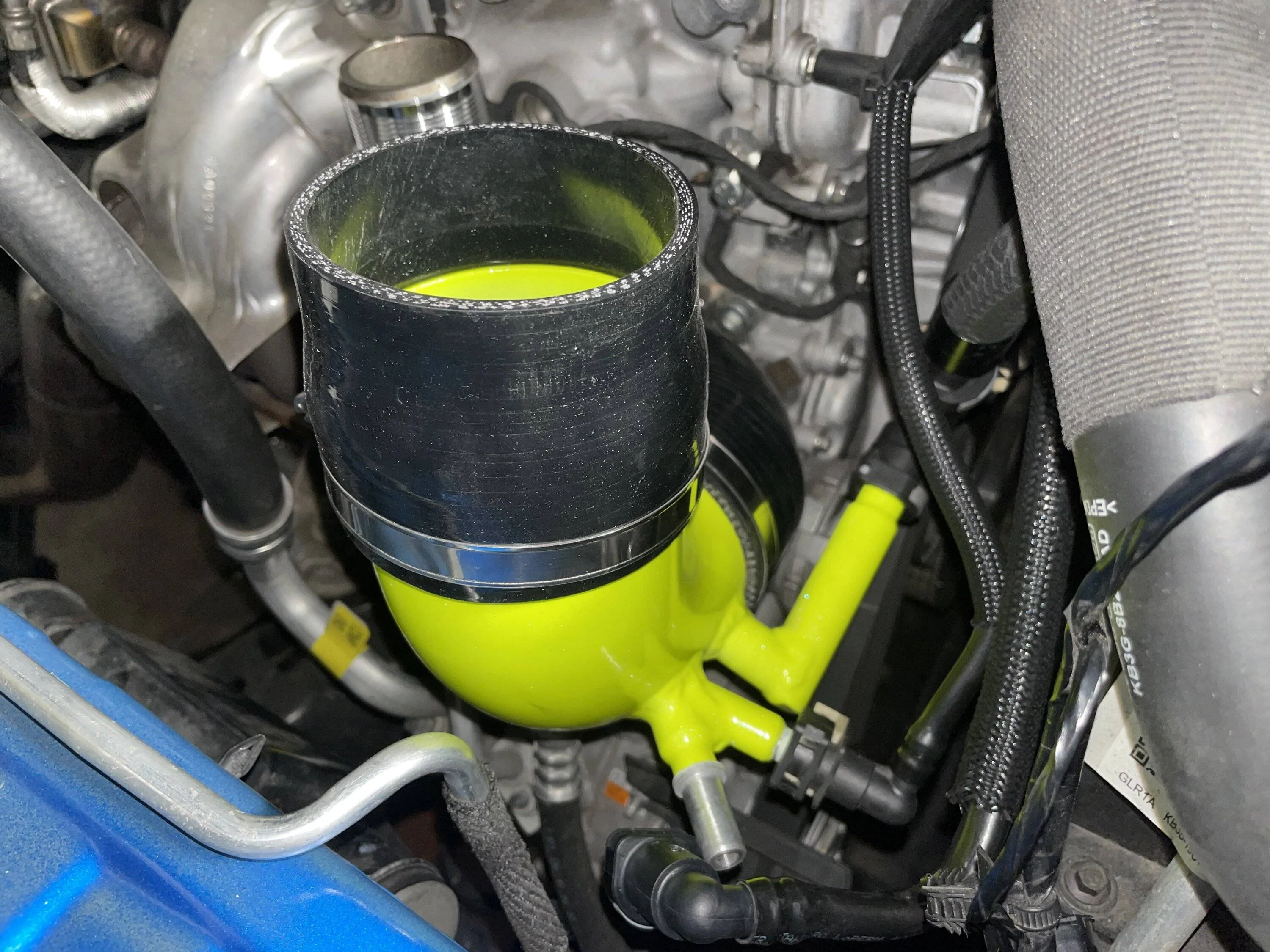

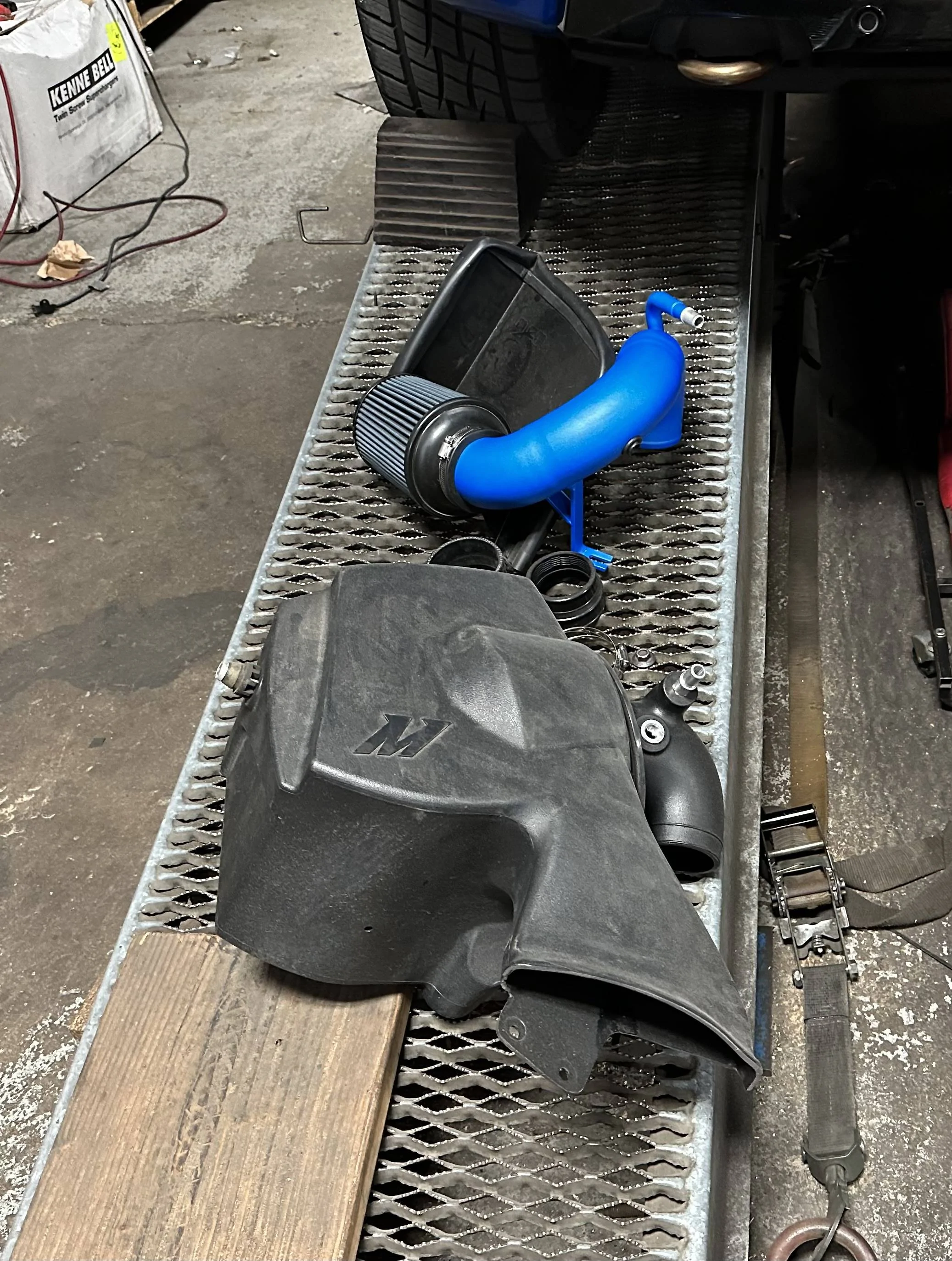

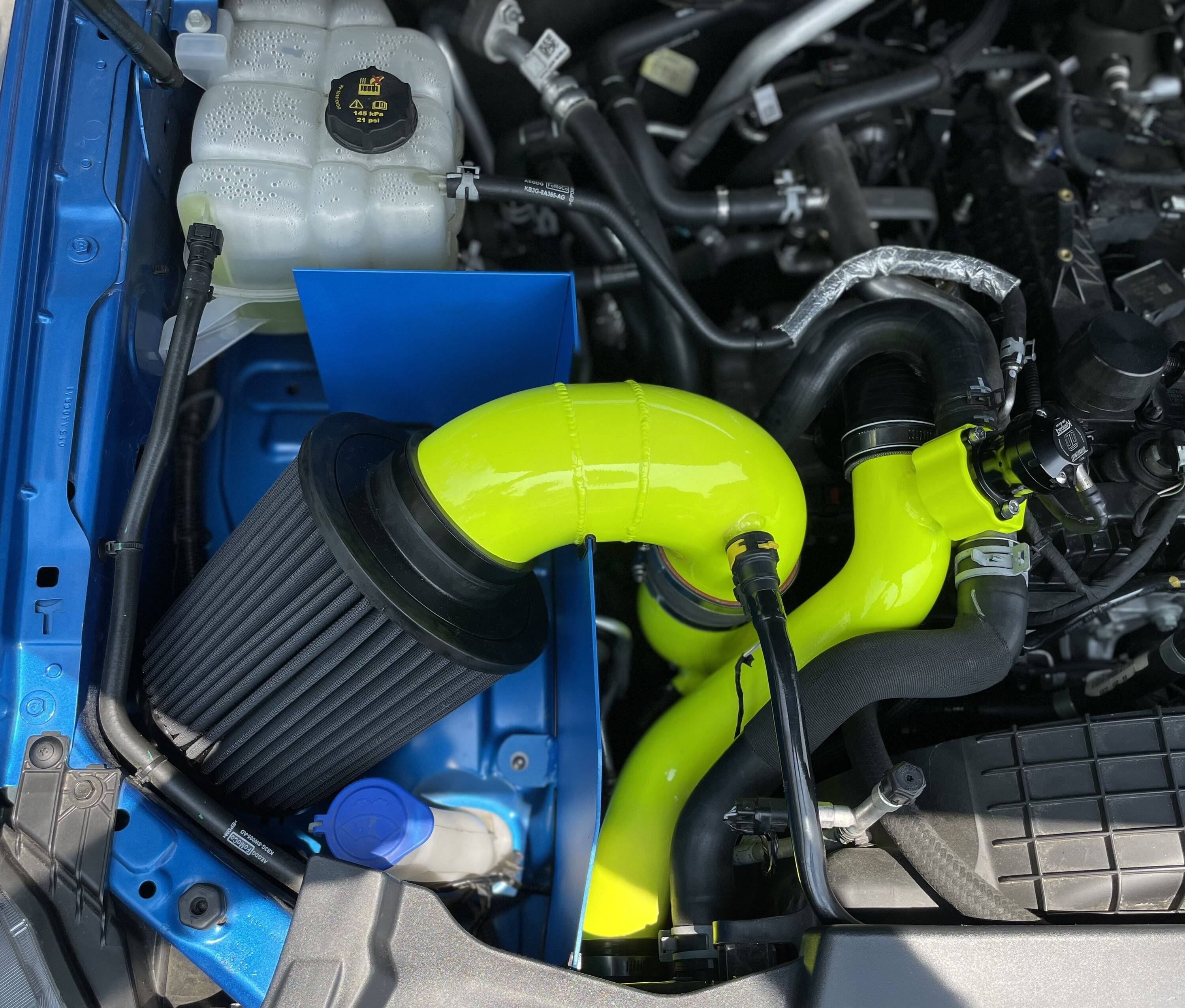

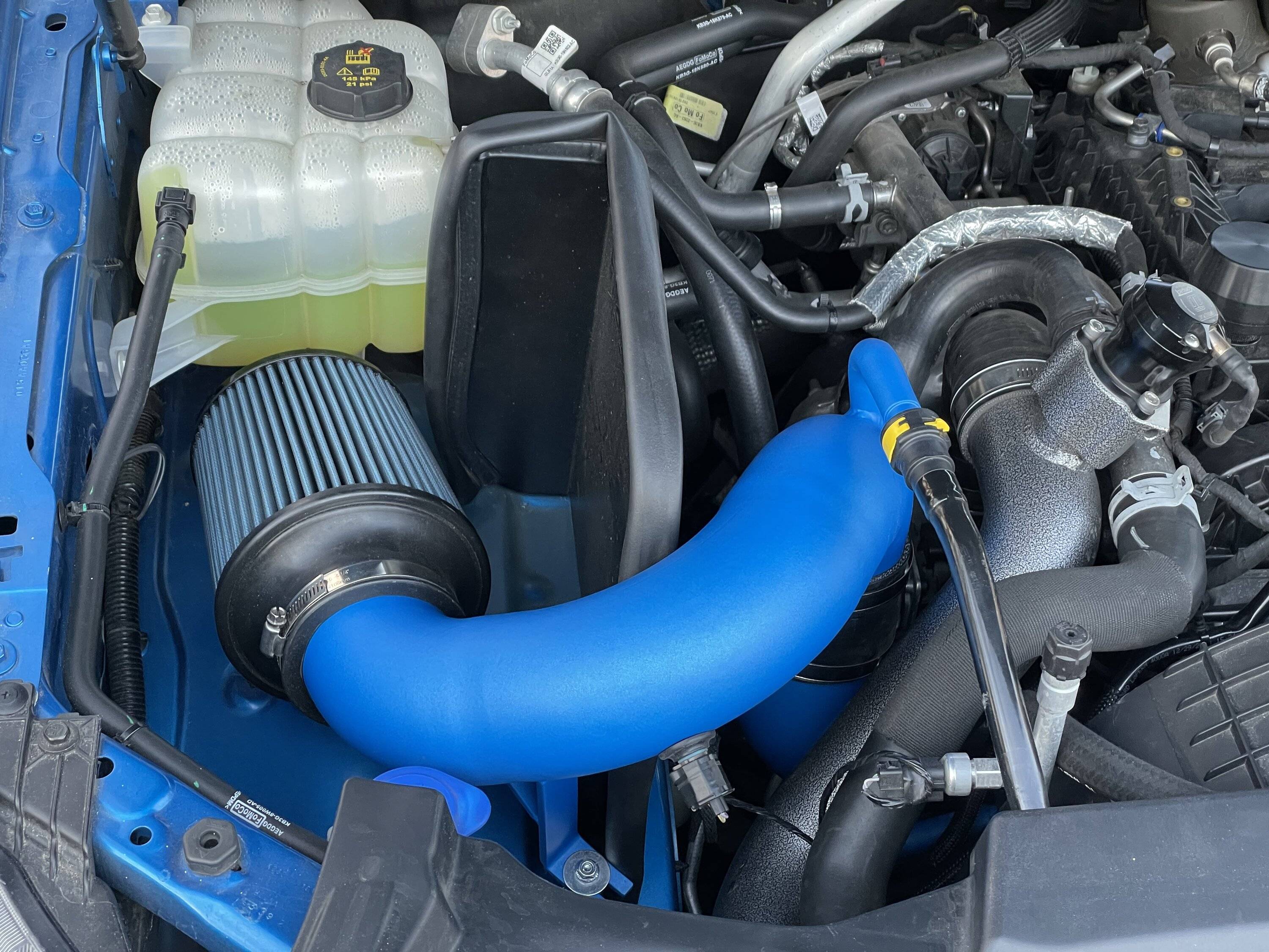

I have dyno tested quite a few intakes on my truck and other Rangers in various combinations.
Basically, a stock truck on 93 octane will gain about 10rwhp with almost any aftermarket intake. Tuned it’s worth pretty much the same power until you reach a level where you really need that available air. I have noticed that even stock the pedal feeling and lower rpm power is improved with an intake. I currently have a 4” open element intake and a 3.5” turbo inlet on mine and the difference over stock was noticeable, in data, dyno and butt dyno.

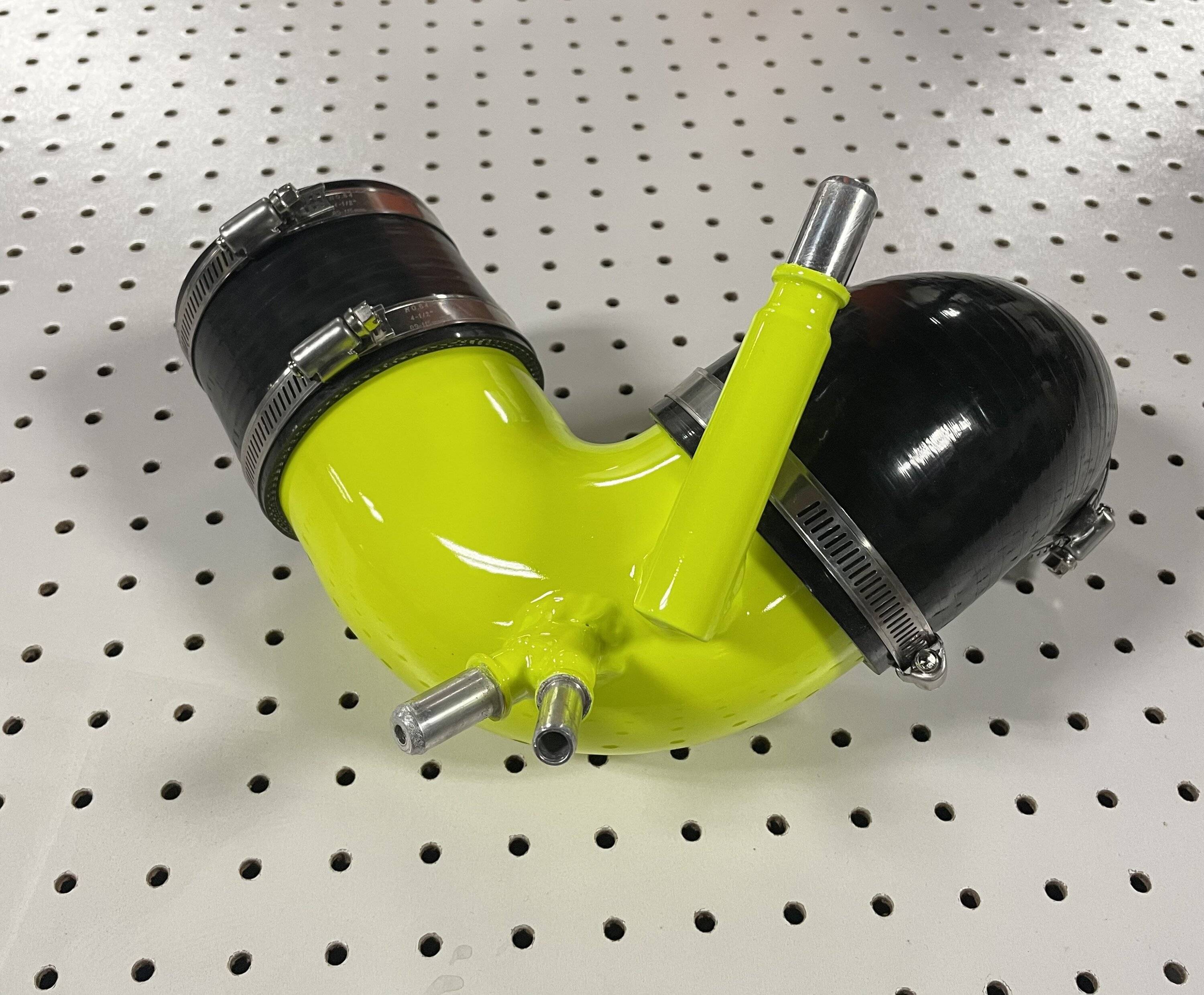

How can one acquire the green turbo j-pipe?

@Loweredon33s what would it take for a run of the turbo inlet elbow for our 5G's? Minimum order? In my mind anyone who is considering a turbo 'upgrade' and a free flowing downpipe should be making it part of the package.

Honestly the factory box shaped tube is so poorly optimized, I think almost anyone could benefit from this over a cold air intake.

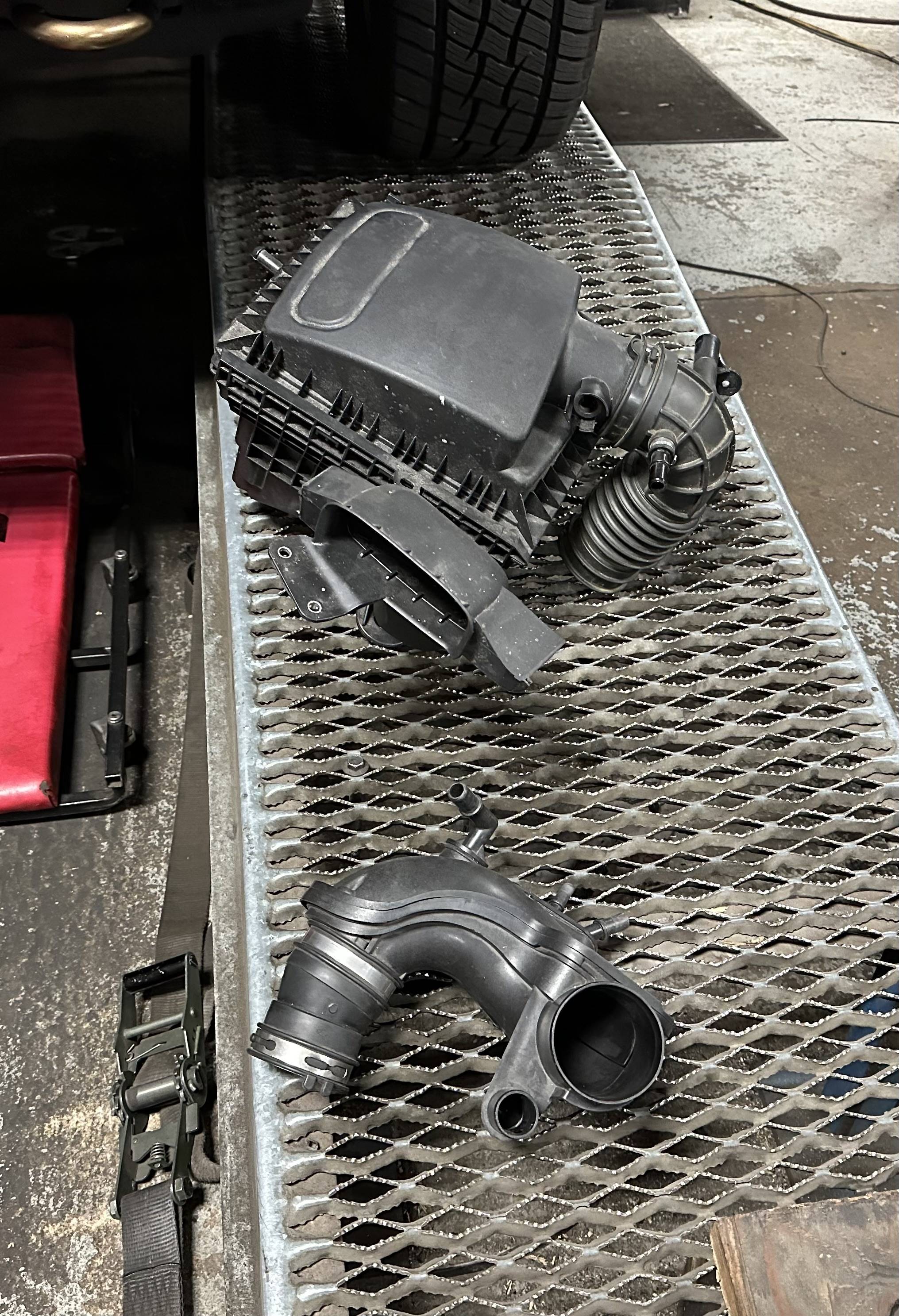

The stock housing does look quite bad, the inlet to the box is so much smaller than the outlet. I have just run K&N and AEM filters all this time but since doing engine bolt-ons and a Ford tune, I am thinking of getting the s&b cold air intake. Good price and they apparently manufacture everything in house. I want to make sure none of the stick hybrid Tacos are faster :LOL:
