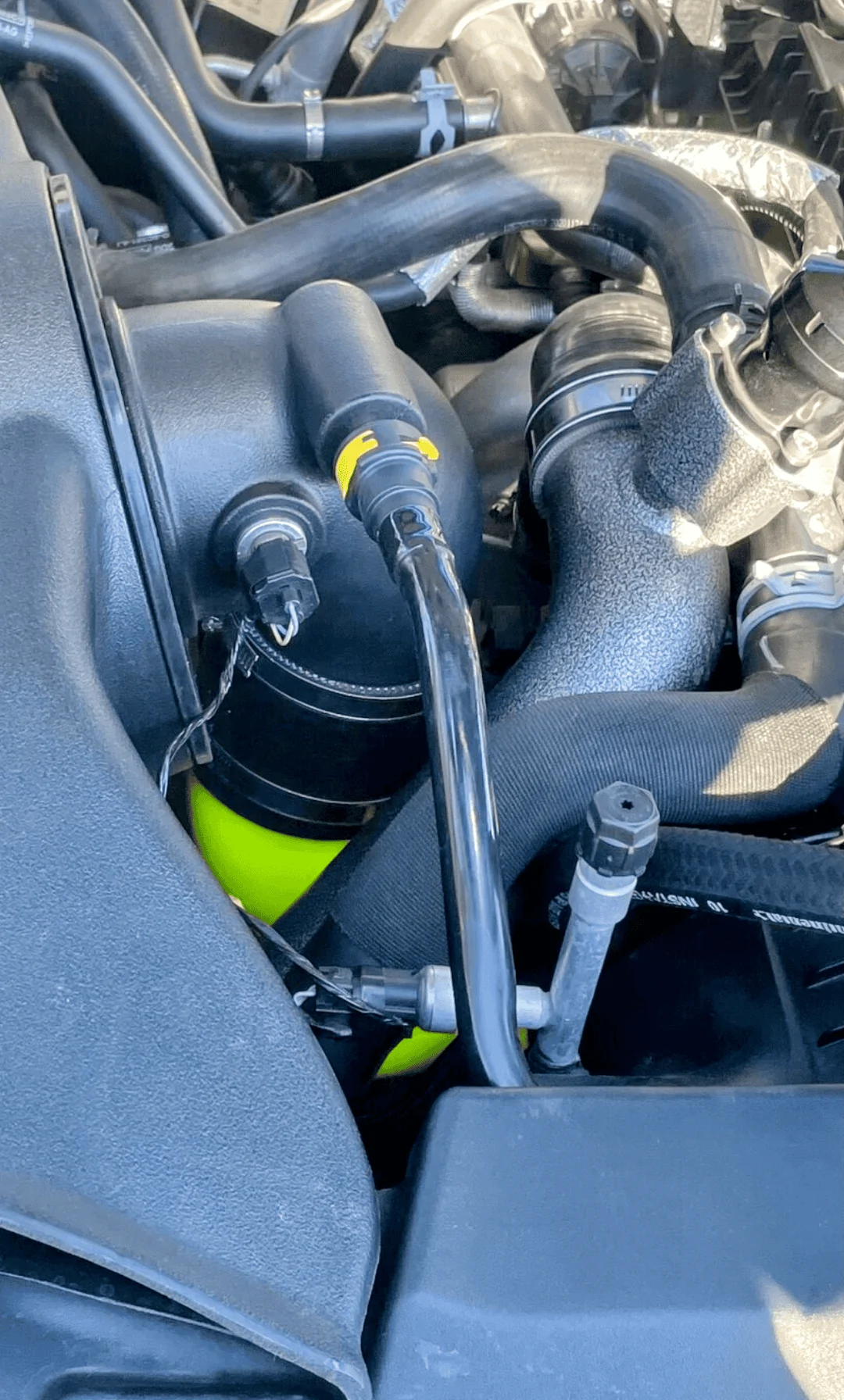

I developed a turbo inlet pipe for our trucks. It improves power and throttle response along with a lot of other benefits for modified trucks. The photo shows the stock one compared to my pipe
Do these fit on stock airboxes? I see yours attached to the Mishimoto or am I seeing this wrong? You said you have a UPR dual vac catch can, how are you plumbing the WOT port?
m

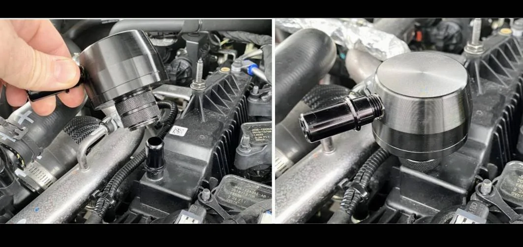

y Upr can doesn’t connect like that, do you have an old version or something? My can has a tee fitting at the pcv connection on the turbo inlet pipe. Yes you can fit it to the stock intake but it requires a little squishing similar to fitting Roush and AFe.

my Upr can doesn’t connect like that, do you have an old version or something? My can has a tee fitting at the pcv connection on the turbo inlet pipe. Yes you can fit it to the stock intake but it requires a little squishing similar to fitting Roush and AFe.
I have the second dual valve they sold on the second can they sold (so they told me). Curious about a T fitting.

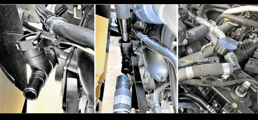

The instructions for the dual valve catch can that uses the tee fitting.

I see they've improved the kit (on sale now!) with a 'clean side seperator' which looks pretty trick. If I ever upgrade the turbo inlet I suppose I'll ask them for the upgraded parts. I'll have to replace the elbow that I drilled a hole through as was originally required.
Yup, that’s the kit I have. I slightly modified my CSS. I don’t know if it did anything but..
