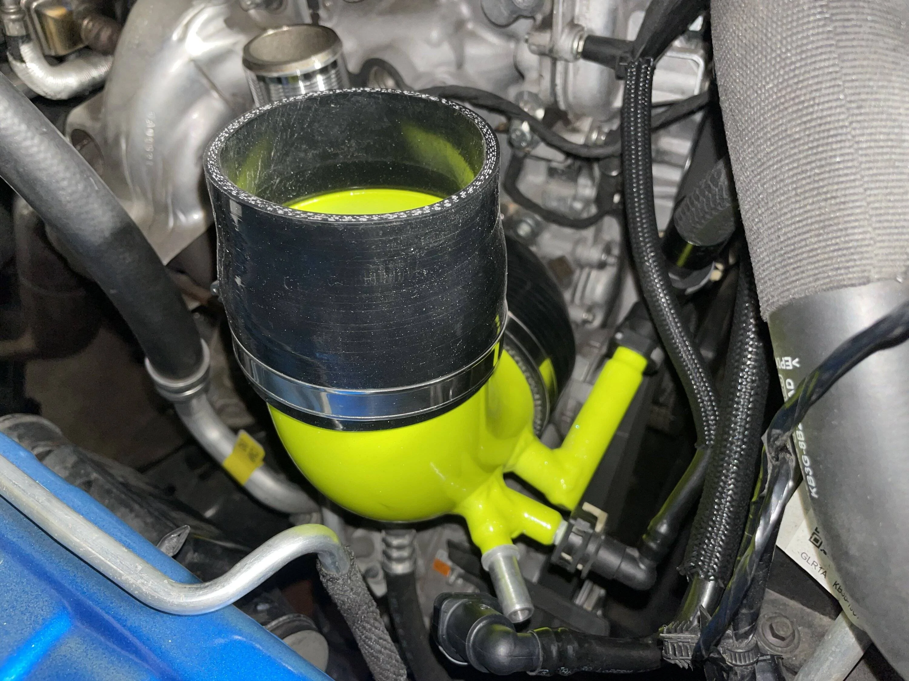

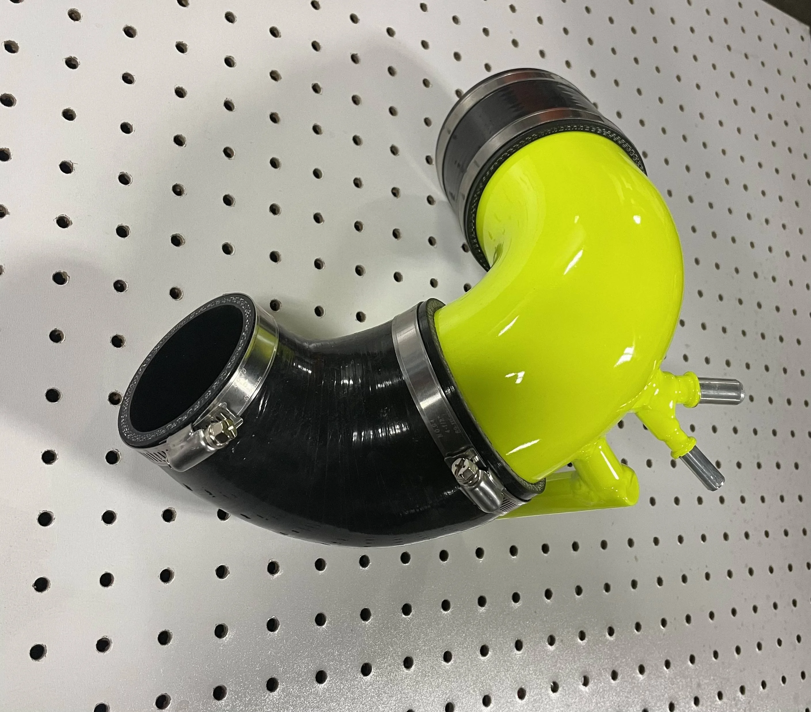

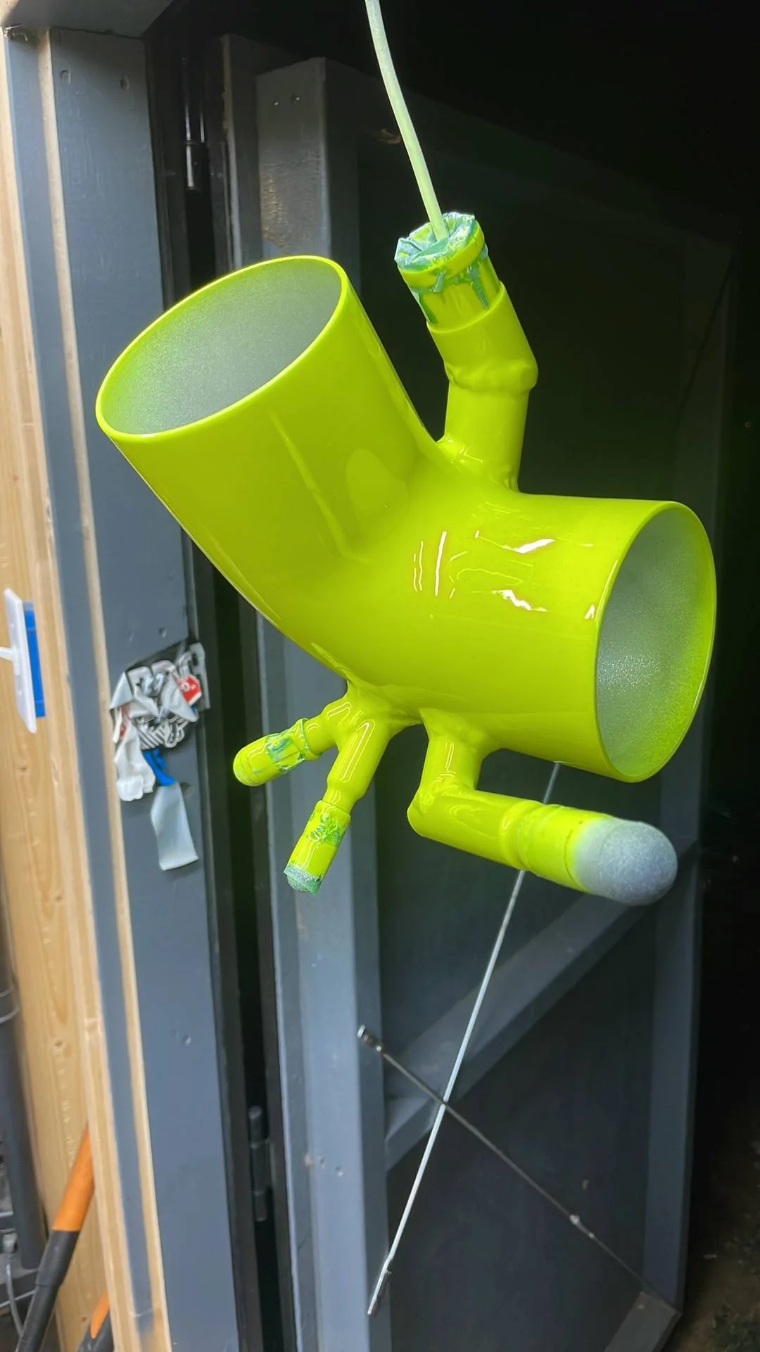

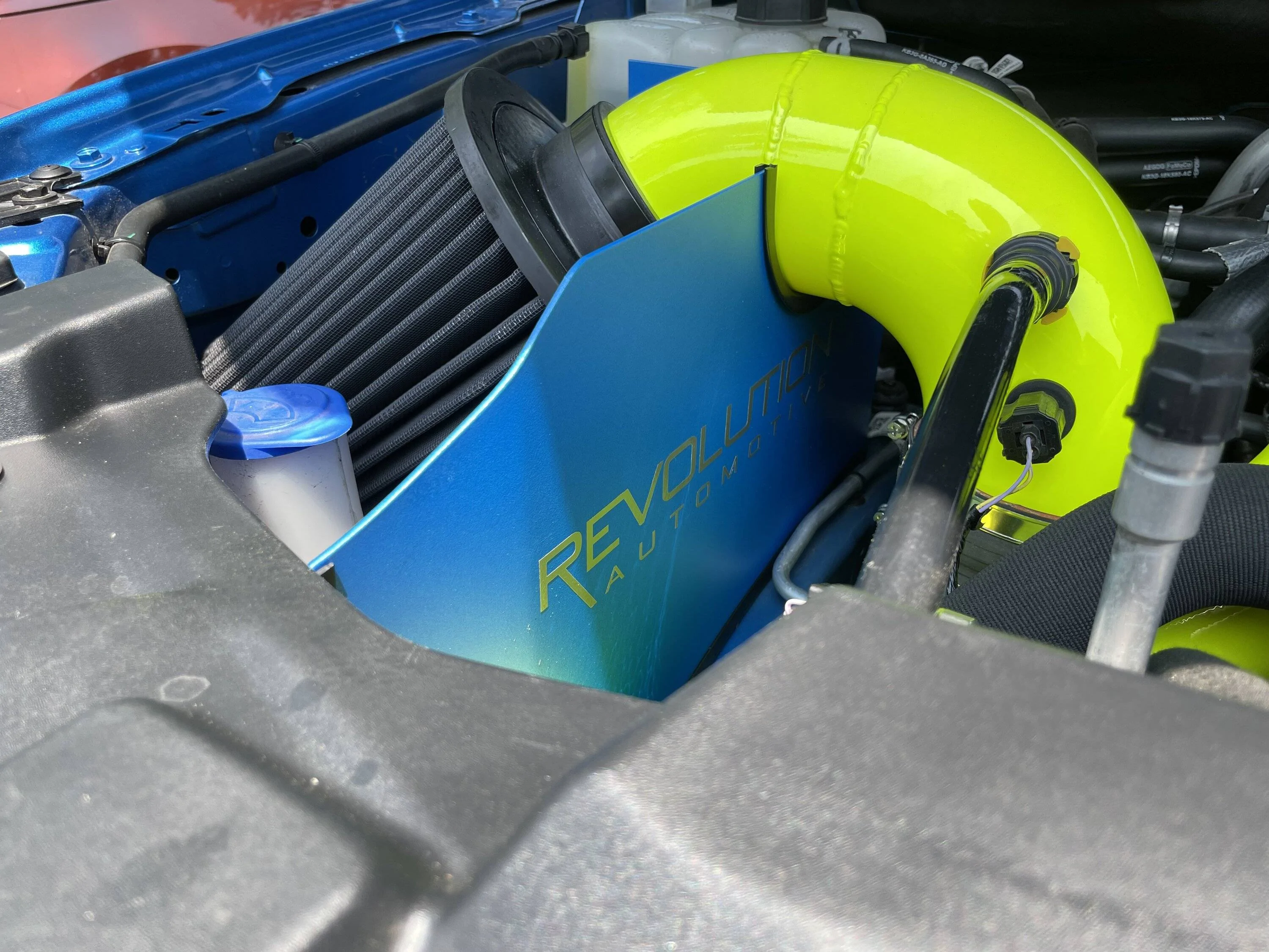

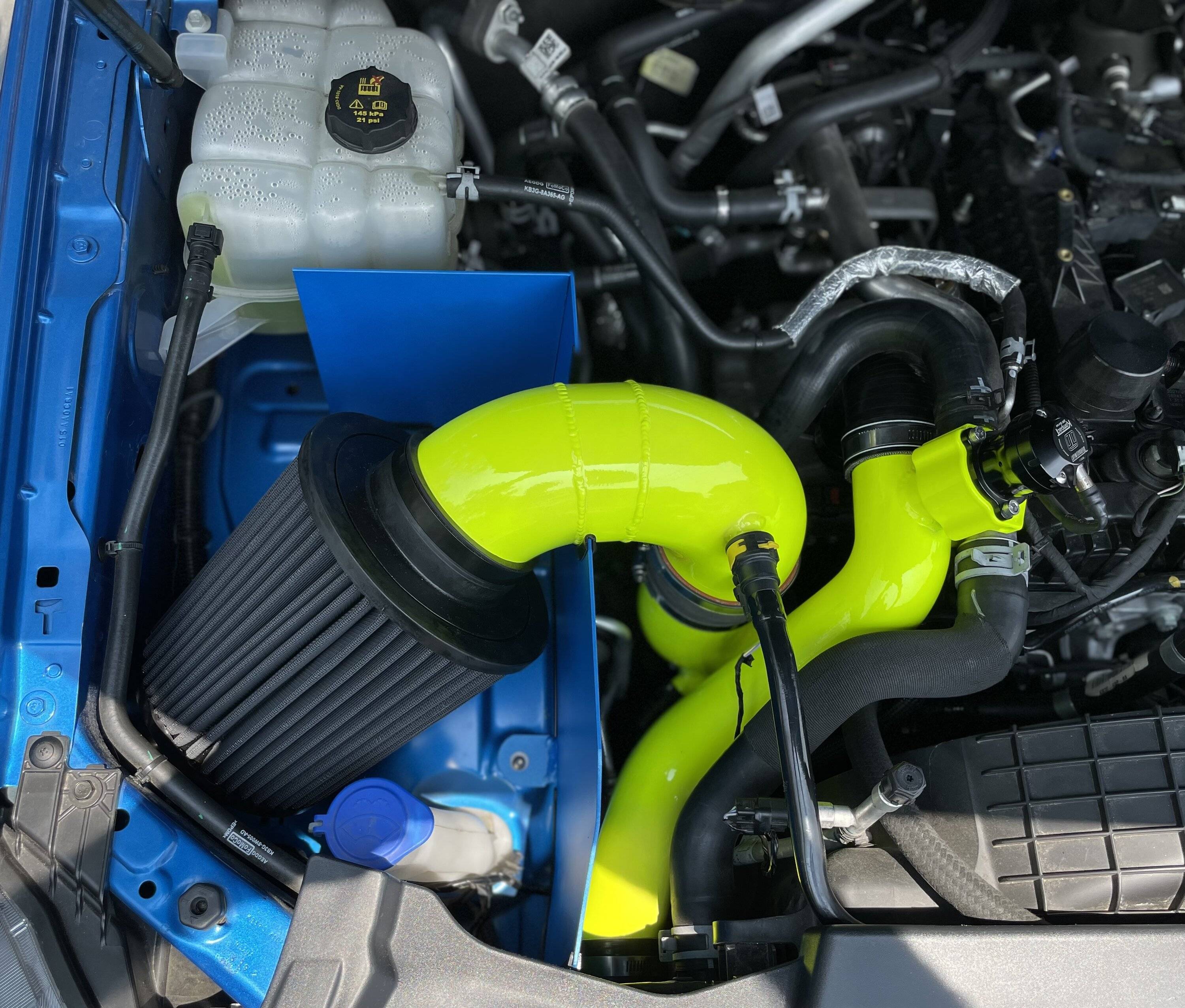

Mine makes quite a bit of noise for sure. It’s a 4” upper intake with a 3.5” turbo inlet and 57mm turbo. Sounds like a vacuum cleaner when casually accelerating ?
can you quote the parts or kit that you bought? sounds interesting. i used to like hearing my buddies 1987 gran national turbo spool up
