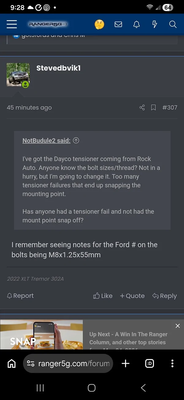

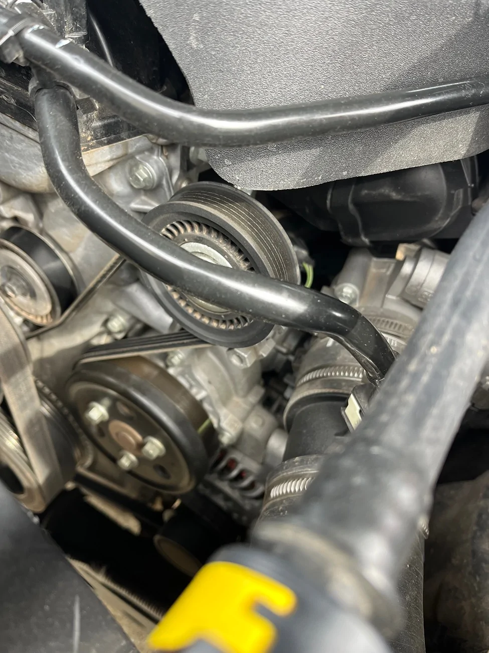

I've got the Dayco tensioner coming from Rock Auto. Anyone know the bolt sizes/thread? Not in a hurry, but I'm going to change it. Too many tensioner failures that end up snapping the mounting point.
Has anyone had a tensioner fail and not had the mount point snap off?

I remember seeing notes for the Ford # on the bolts being M8x1.25x55mm

So Ford already had a better design and chose not to use it for some reason...

I just ordered a pack of 10 for $9.98 on Amazon. They have a shoulder, but it is easy enough to extend the threads if needed. 10.9 grade. I'll use loctite blue to insure they stay in place.
One less Ranger weakness to worry about.

I just did the same as a preventative measure. Went with the Motorcraft BT114 tensioner from Rock Auto. I know that all the reported failures on here have been 2020’s. Mine is a 2022 and I have an ESP plan. But if/when the oem fails it’s a mess and you’re down for the count. For me it’s cheap insurance. This also appears to be a great fix for someone who has a broken front cover. Besides, I think this gets me over the 5G forum expense for the month. I hope.

I think I recall a couple of newer years that failed as well.
I do think that the issue is an inherent design weakness and not a manufacturing process or QC one. It is basically a cantilever design. It flexes under sudden shock and breaks. Stupid design, and any engineer (and Ford) knows it.
