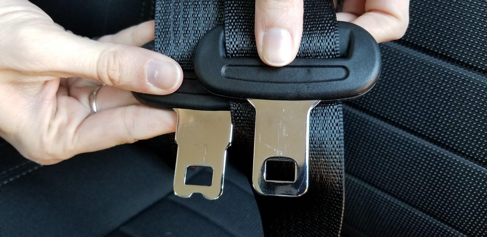

This issue has been fixed now, and just wanted to update on what information I got. Just like @HoosierT, my buckle was installed improperly from the factory, so the dealer properly installed it. I believe it was also twisted! Interesting to note though, as @Anthony mentioned above, the middle buckle is actually different, and basically "keyed" to only go into it's proper receiver. Probably something to do with how the buckled/not buckled information is reported to the dash, to make sure everyone is buckled properly! Anyways though, all is good here, and here's a shot of the different buckles (the one on the left is the middle seat belt and the right is an outside seat belt):
