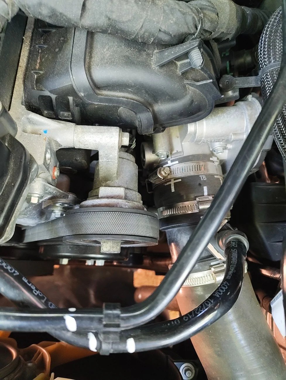

Belt Tensioner SNAPPED OFF

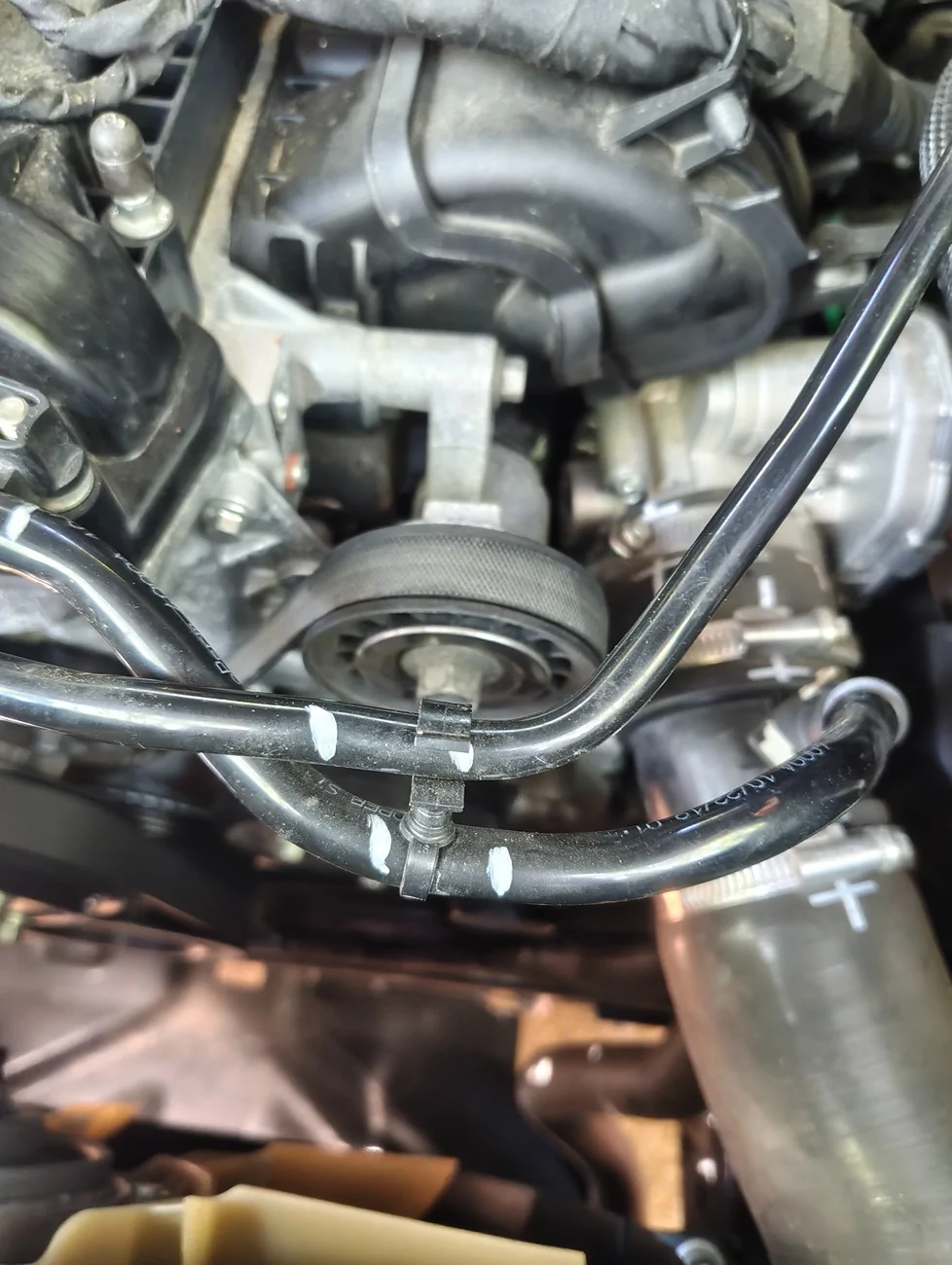

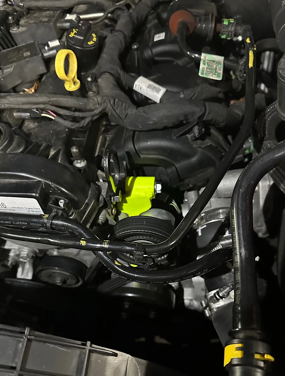

I made it. Been on my truck a couple years now.
Did you add a longer bolt to the lifting point mount?
It looks like it's further back and mounted to the aluminum ear on the block.
If so, did you thread the ear and add a bolt?
It has two extra mounting points.

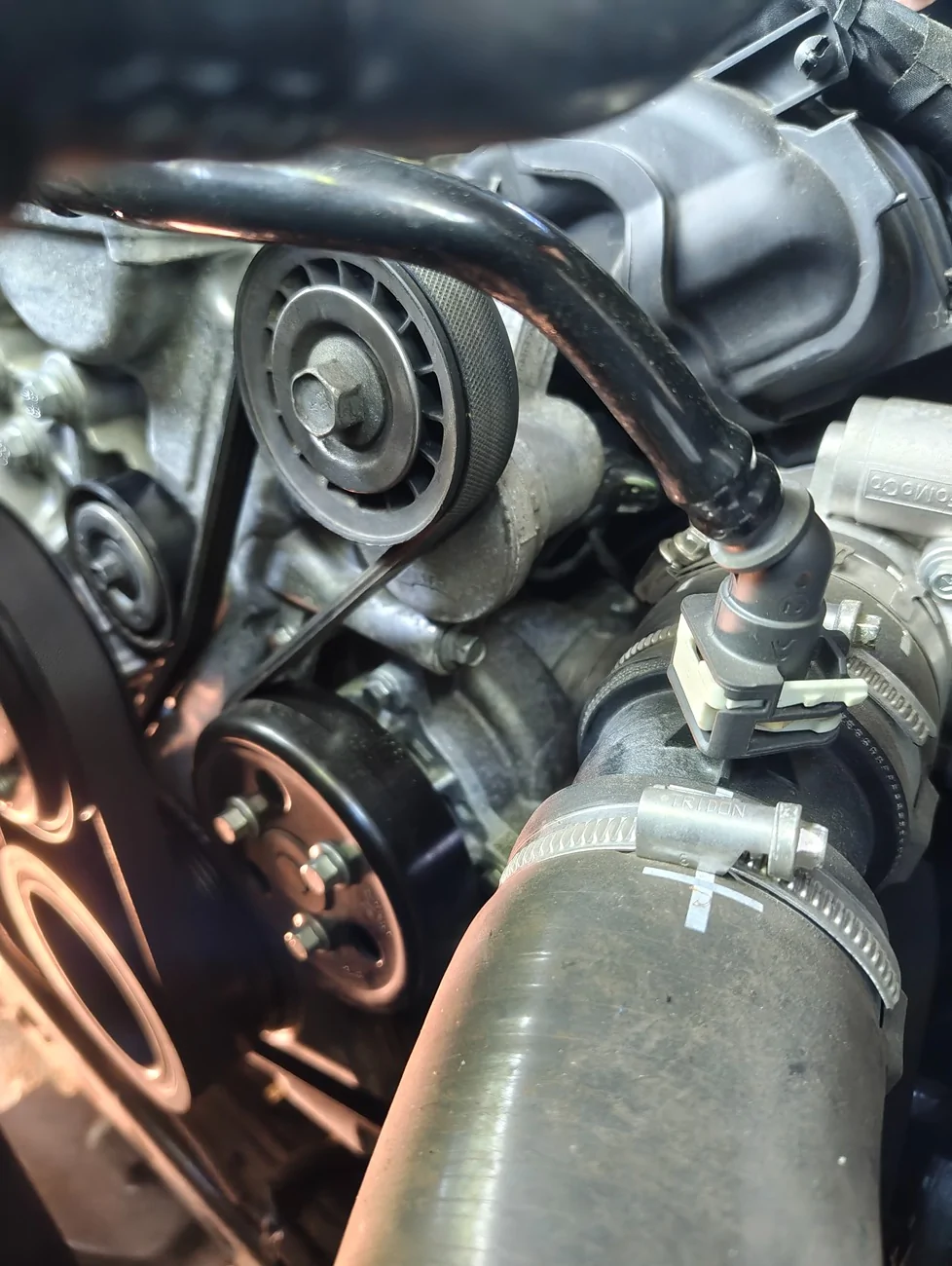

If anyone has this happen the belt idler from a 2018 Ford escape with the 2.0 engine fit perfectly. It bolts to the head and block
Nice! Same pulley diameter and belt?
