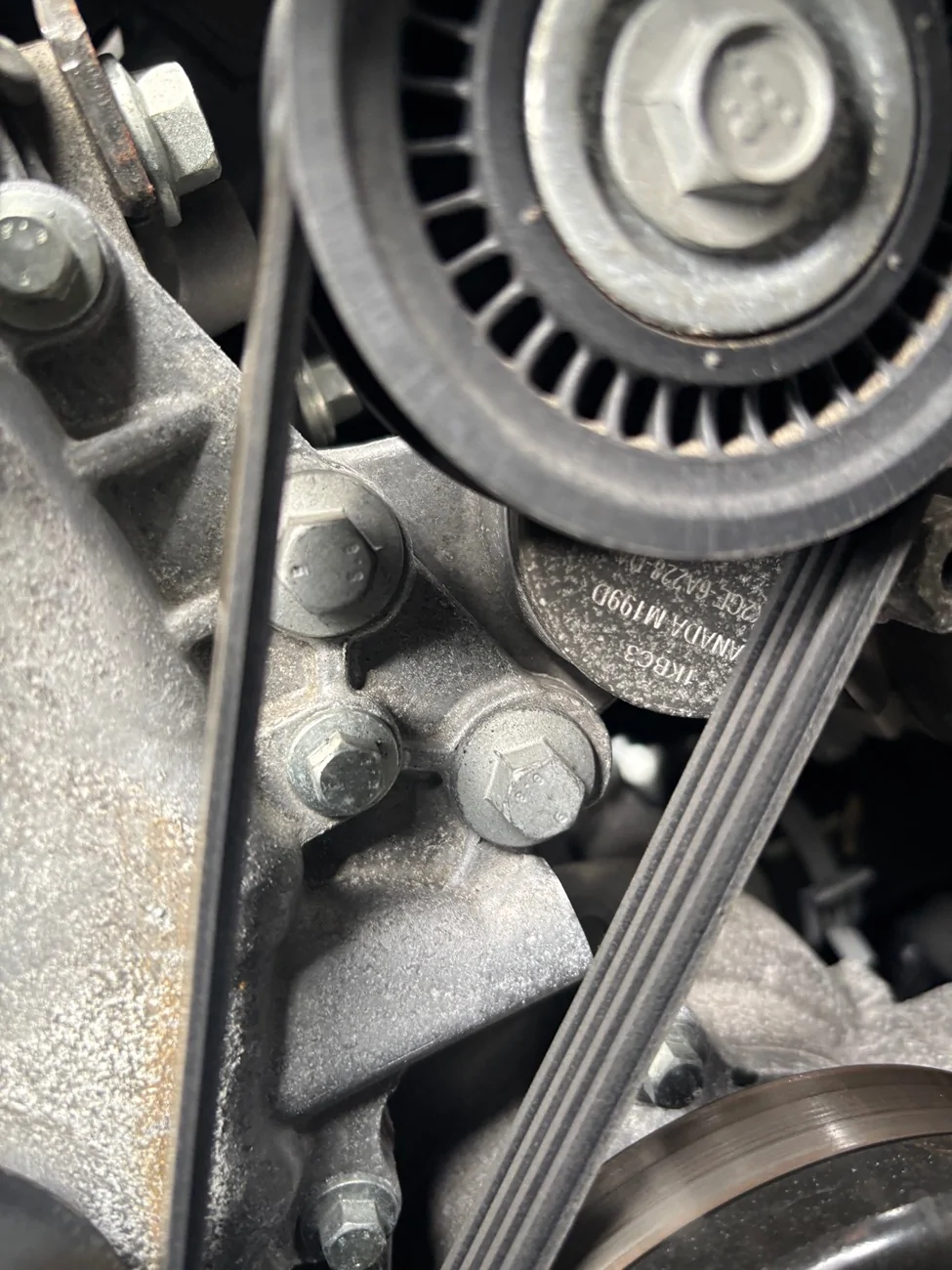

Also some said there was a difference in the later years on that support that holders the tensioner. I have a 21 so what’s the difference. I’ll get a pic of mine and post it and can someone with a 19 do the same so we can compair if there really is a difference in the cover.
I'll post a pic of mine when I make the change.

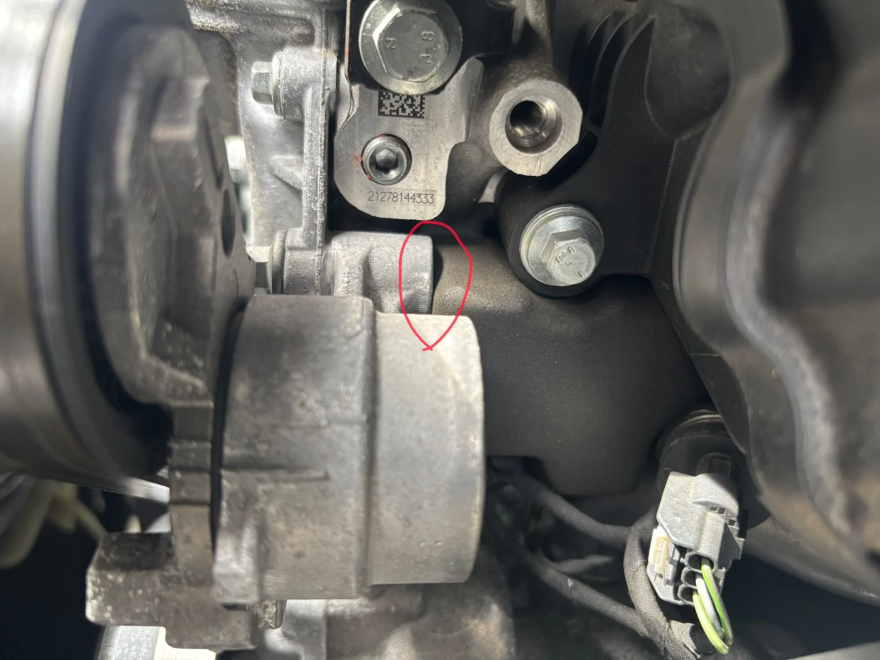

This is the best I could do without pulling the tensioner off..I see ribs in the cover and looks like it’s wedged in there on the back side that I circled.

So got my bolts and my Motorcraft BT114. Went to install and ran into a snag on my 2022. It mounted up ok to the block. But when I went to untension it to install the belt the was no tension. Where ever I moved the tensioner it stayed and wouldn’t spring back. Thought the tensioner was defective and removed it. Once I got it off I found this. The back of the housing on the tensioner was making contact with the lower mounting boss for the original tensioner. Not very much but enough to create a drag. I’m thinking that my 2022 may have the “beefed” up cover? Add a picture showing the thickness of the mounting boss. Put the original back on and deciding whether to do a bit of grinding on the new tensioner or the mounting boss. But I don’t really want to grind on the boss because you know how Ford can be. Interested in if you run into this when you do yours.

Would putting a thick washer or two on each mounting boss on the new tensioner space it away from the timing cover?
