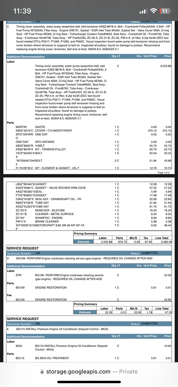

Brandon - what’s the anticipated length of your downtime? Any idea?
Not sure yet, just brought it in and waiting for them to give me the details about pay and such. Luckily I am still under warranty I hope, not sure if the FP tune shortened the warranty which I think does say it did. But will find out. Will let you all know the price and down time

At this point, we are still not sure if the tensioner failed.... We know the casting failed, but we don't know why it failed. If we could discern it to be the tensioner, then proactive replacement might save the casting.
Has anyone reported a rough or failed bearing in the tensioner?
Or a sticking tensioner spring?

@DukeCanBuildit estimated early next week. So ima say Thursday or Friday 😂
The guy said it was all covered under warranty still. 3.5k cost.

I’m glad it’s covered - that would be a nasty bill to tackle. 👍🏻
100%. Got the truck in November 2020 so 3 months later and it would of been a whole different story.

Hefty bill so thank goodness you are in warranty!
Do you need the TSB done on the tranny while they have it? Any shifting issues?
