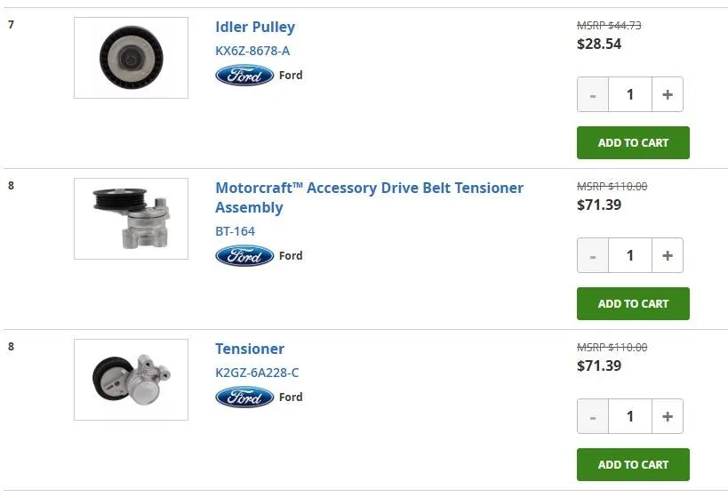

So, if we use a (Block) like this that @Loweredon33s, designed it would help absorb the forces exerted on the (Tensioner) if the bearings were to wear and start a grabbing as the added block will limit the (Rotation) and (Kick-Back) force
I would have to actually get a wrench on this to see how far it actually moves to simulate a grabbing bearing.
It (MAY) be advisable to just replace this as (Preventive Maintenance) since so far, no one has stated they have had a belt squealing prior to this breaking, which should be an indication of the bearing going bad and or the (Spring Tension) weakening.
So, it is giving - no prior (normal symptoms) and the extra stress created on the (Mounting Ears)
weakens to the point (it just let's go)
I would image that the (Tensioner) is rocking excessively and would be a good visual indication of this possibly being a (NEED TO ADDRESS) and not overlook it or the end result will eventually be breaking off.
The Engine Front Cover is not an easy thing to replace and is labor intensive as well as requires special tooling (Alignment Pins etc) for the Cam & Crank
So, I would rather spend less than 1 hour (Preventive) replacing the Tensioner and the associated (Idler) pulley vs 12 plus hours replacing the (Engine Cover) and sourcing parts and tooling.
As I suspect 1 of the (2) is the root cause
It actually looks like they revised the Part # for the Tensioner.
I do not know the reason for listing (2) separate part #'s for it but the
(-C) is a revised part # from (-A) Tensioner K2GZ-6A228-C is the revised part #.
What did they revise? (IDK) but they may be addressing this issue.
Items 7 & 8 are what is needed.

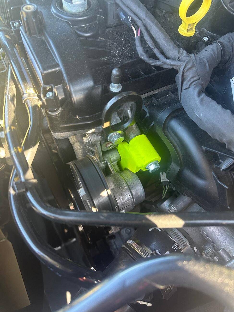

I think it’s vibration and harmonics. The tensioner is hanging off two weak bosses in single shear and is just in a terrible position for leverage and is prone to stress fractures because of it. My reinforcement adds mounting rigidity to the other side and holds the timing cover/tensioner in more places to keep that from happening.

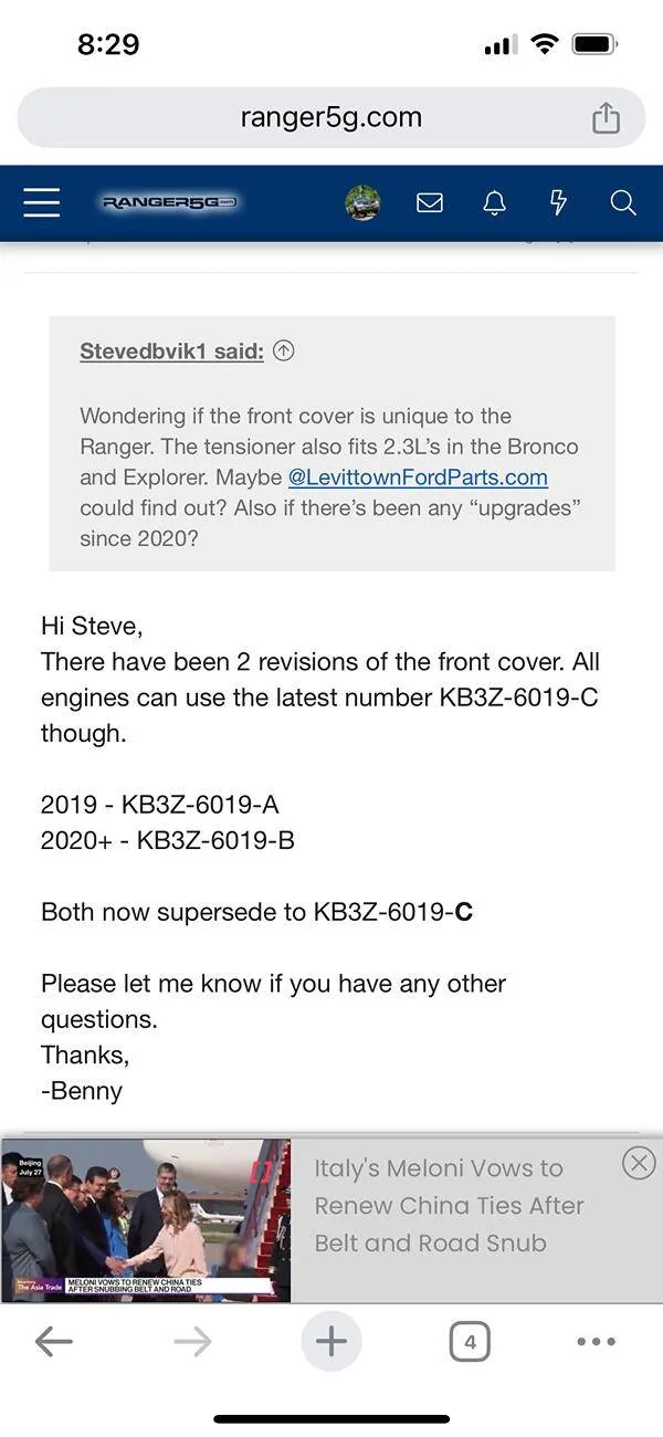

I’m still hung up on all the reported failures on here have been 2020’s. Plenty of 2019 and 2021’s with high mileage and no failures. And wondering about the part # revisions especially in 2020. It would be interesting if we could get the build dates of the failed ones.

@20_lariet , @Lonewolf831 and @Rkahl90 could you provide your build dates for your 2020 Rangers that have had this failure?
@TheBadger I think you mentioned that yours was 08/20 correct?
Not very scientific but it would be interesting to see how close the build dates are.
