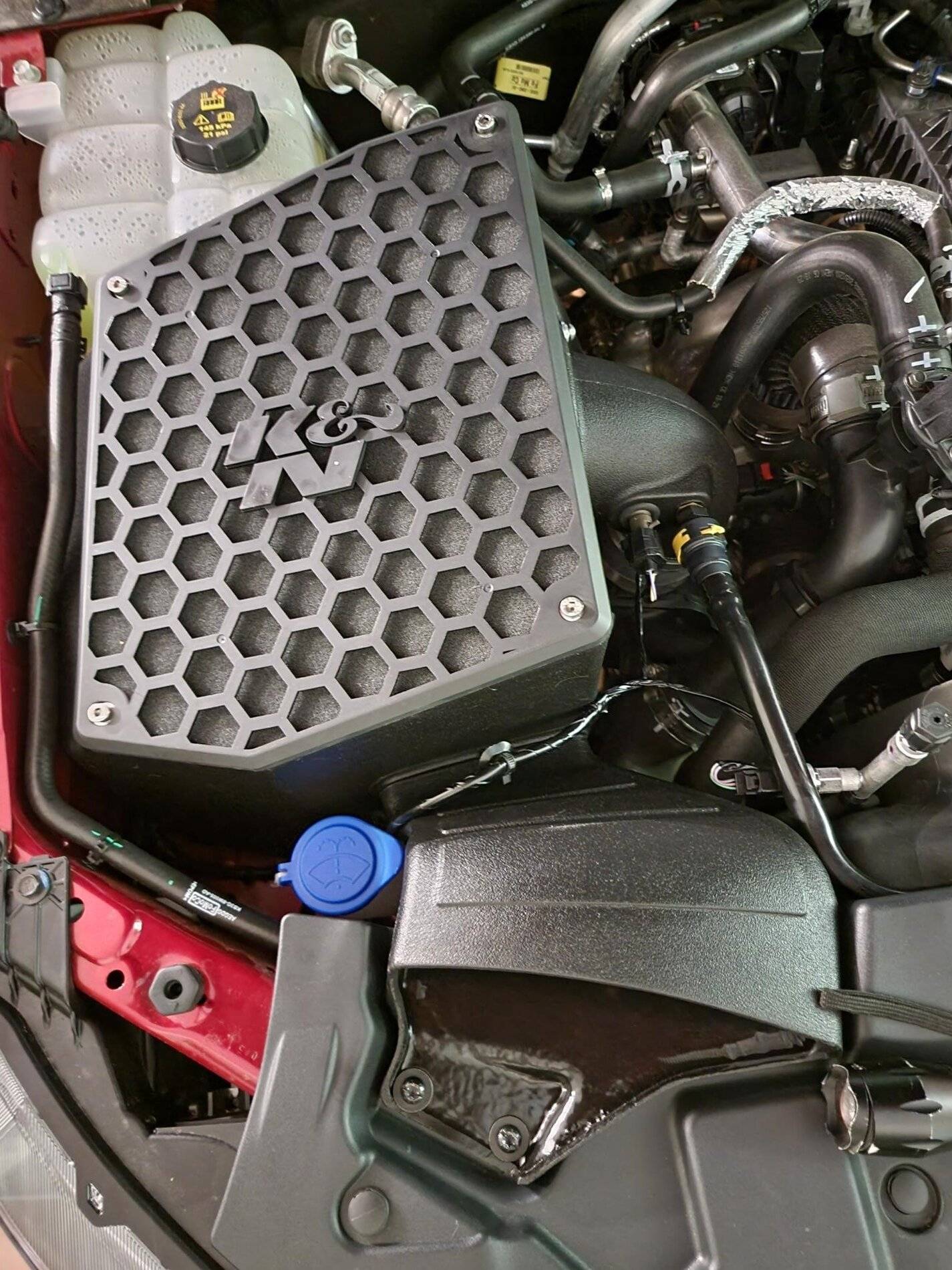

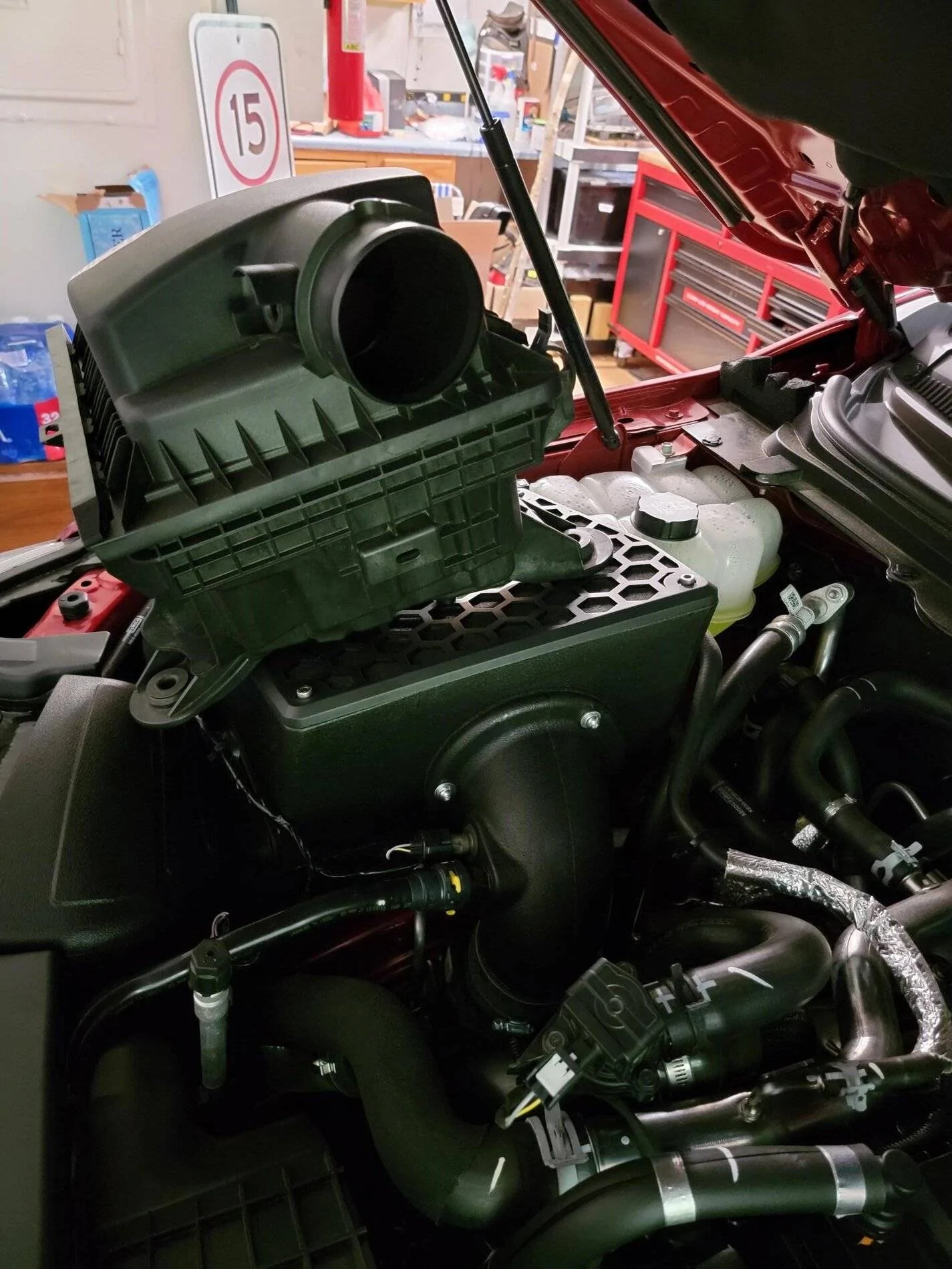

Here is the stock air box vs. the K&N. and a picture of it installed.
Honeycomb has been really in fashion lately. Such a nice design.

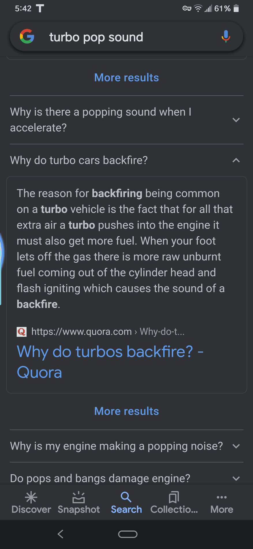

My truck does it also.
"The reason for backfiring being common on a turbo vehicle is the fact that for all that extra air a turbo pushes into the engine it must also get more fuel. When your foot lets off the gas there is more raw unburnt fuel coming out of the cylinder head and flash igniting which causes the sound of a backfire"

I kind of figured that, but I still wanted to see if others had seen the same with theirs.

Could you provide a link to where you obtained this data?

The lid of the K&N is THE worst design of all Ranger intakes. It is an open element design, with a foam mesh in the lid as a pre-filter that allows the intake to gobble up gobs of 200+ deg engine air heat when the hood is closed. Funny, that’s not how they dynoed their test truck to get that +14 Hp they claim.
For all intents and purposes, it is a hot air intake. Might as well just strap a cone filter onto the end of the factory accordion intake tube for $50 vs the $300+ for the K&N intake.
Ingestion of that hot air is messing with the AFR and causing the backfires, no doubt.
