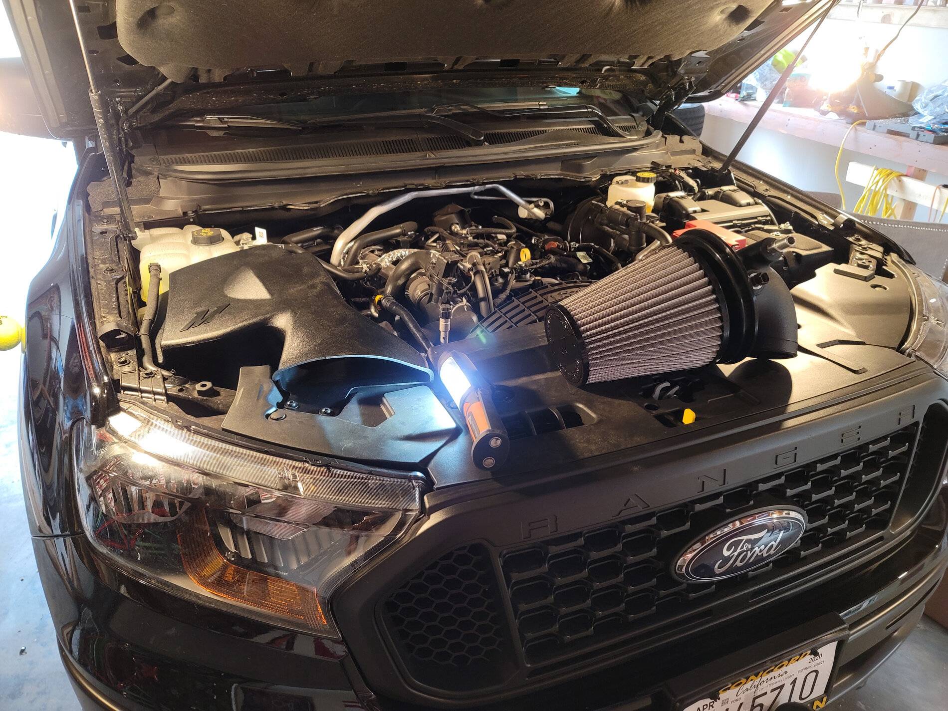

I got this paper cone with the Mishimoto CAI.
The extra time and money to maintain an oiled filer just isn't worth it, personally.
Got one of their stickers on my garage cabinets though! ?
How do you like that CAI? Did you notice much more power or throttle response? Thinking of getting either that or the Roush CAI.
I'm really happy with the Mishi CAI, though I can't say I noticed a difference in acceleration from it specifically. The tune made all the difference there. The Mishi intake just looks less restrictive to my unqualified eyes.
