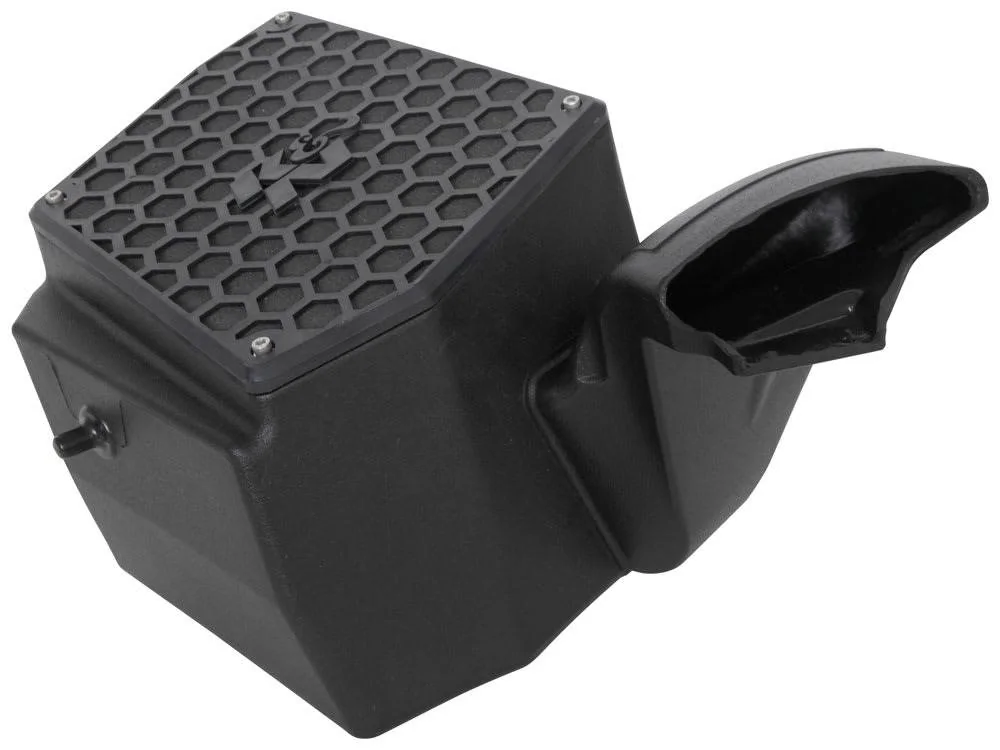

I still have stock exhaust. And it did not backfire until the cold air intake. I am thinking of closing off the lid. it has a filter and I do not like the idea of pulling hot engine air inside my intake.
The roush CAI has a box around it. Perhaps try the lid on.

Yeah.... I'm envisioning the flat K&N that comes with the FPP..... you're running that with no lid on the airbox?

This is the CAI I installed yesterday. You can see the top of the box and the size the lid. I can only imagine how much air it is pulling into the intake. I am going to block it off and see how it behaves. I think it is making my engine run too lean.

Interesting.... I've not seen that one yet. I'd try to revert to the stock airbox, if you can and see how that works. I'm a huge fan of a good CAI but the stock box on these Rangers is actually pretty great!

I believe it is a recent design. It is not smog legal in 15 states. I bet you can guess the first state.
