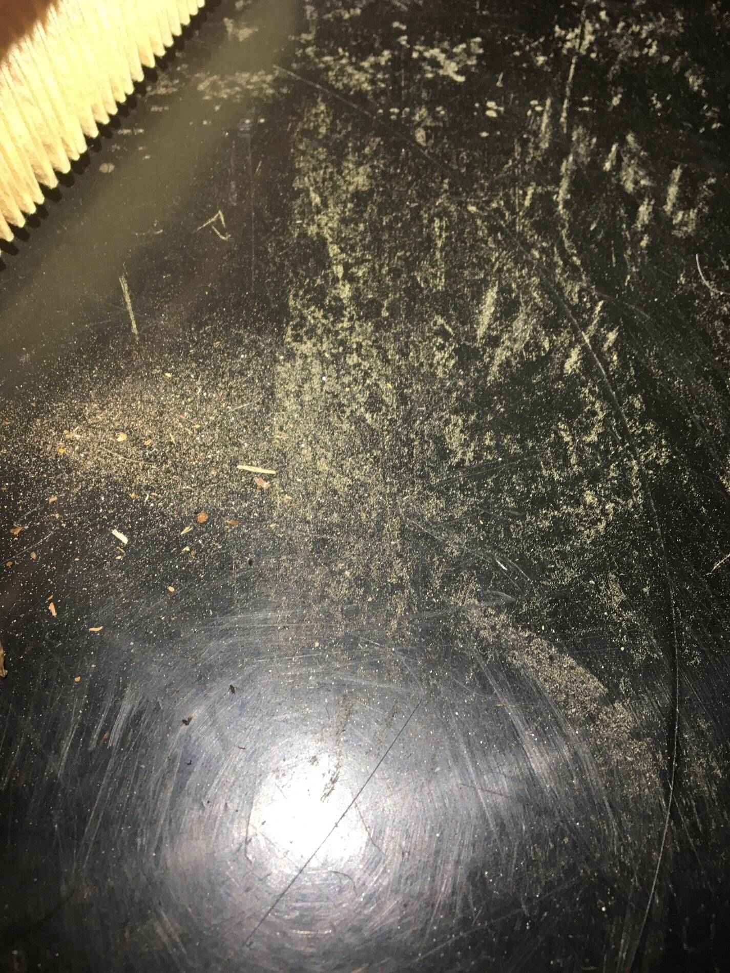

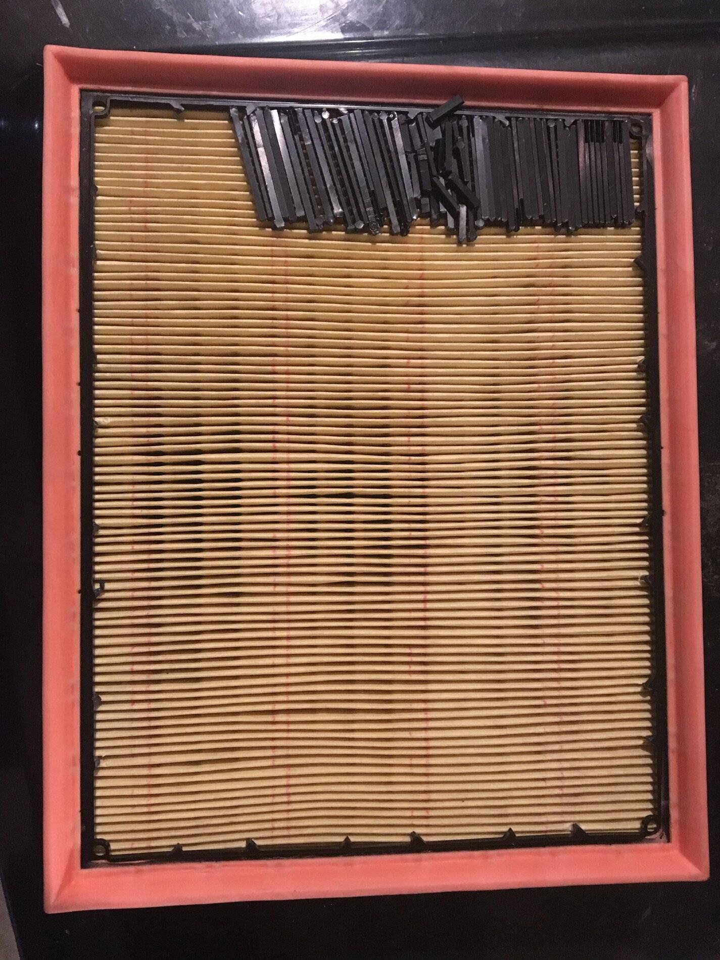

Ditto. Have FP tune with paper filter too. IMO runs better with the paper filter. Since speed density tuning assigns a predefined fueling value to predefined rpm cell at WOT, if the tune is expecting a higher airflow volume at that predefined RPM with a K&N and you reduce the airflow at that predefined RPM by using a paper filter, then theoretically you have created a slightly richer AFR. I noticed difference going to paper from K&N with the FP tune with low end response and I liked it. My open OEM downpipe backfires a lil bit on off throttle slowdowns now and I love that too.
I also did the math and when removing the plastic grill on the back side of the filter you free up 13% more filtering area / flow capability.
Final thought, changed my paper filter at 6k and was amazed at the fine silt I knocked out of it (see pic below). Made me so glad no K&N. Turbo cars ingest such large volumes of air over their N/A counterparts that dust loading a filter becomes a factor very quickly depending on environment.
Exactly my concerns. Always varied opinions reg air flow vs filtration but since this is my only turbo engine vehicle then I will err on side of caution with the factory filter. Truck does not feel chocked up so gonna ride with it.
