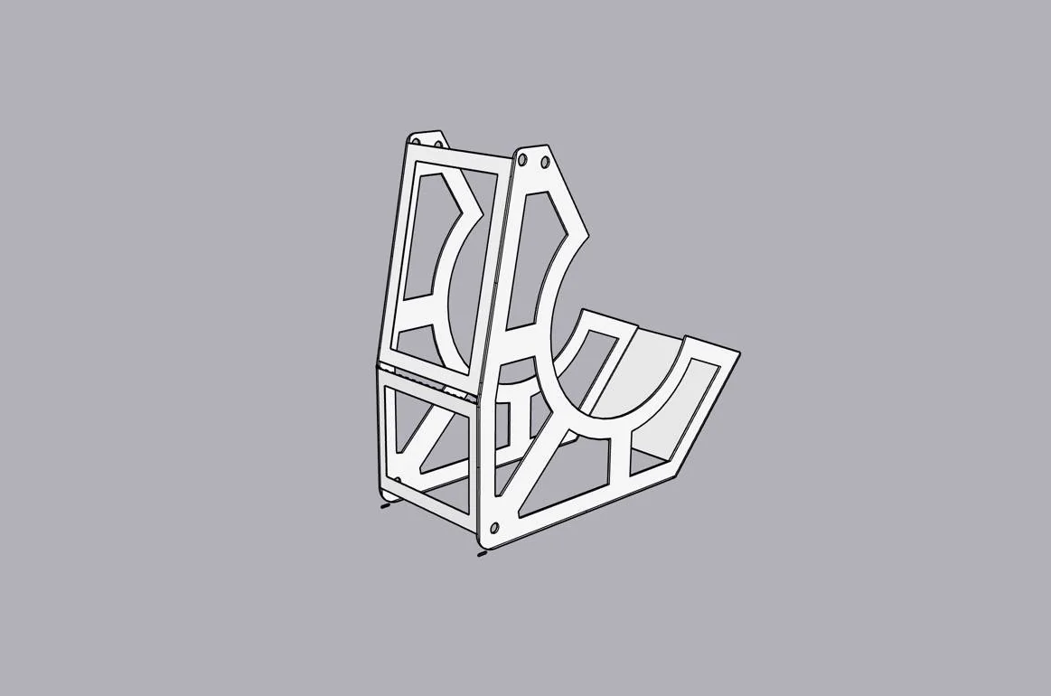

Spent some time this morning after I got off work to throw a swing down tire carrier drawing into the computer. It’s totally no where close to final but it’s something have documented. Probably will go to the CAD, cardboard aided drawing, later on this week. This should hold a 37” BFG KM3 snug. I do plan to run a strap over the tire so it won’t roll off when swinging down and of course while driving.
I need to make the baseplate for it next.
