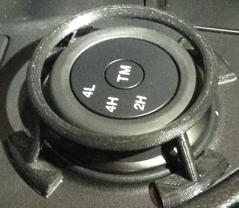

It's never happened to me or the wife (unless she's afraid to tell me) and I like the location. Guess since it seems to be common a tougher to turn switch might have been a better design. I'm only 5'5" and the wife 5' so maybe less of a problem for smaller people?

Great. two quick bits of advice:
When determining the exact orientation of the cage, place it over the knob and then rotate the cage until the upper ring is parallel to the top of the knob. You'll notice that if you set the cage on a table the ring will be slightly sloped with respect to the table. That is because the Ranger selector knob is actually subtly sloped. When you place it just keep turning the cage until everything lines up. Then use that orientation when taping it down.
Second, wipe the center console down with isopropyl alcohol and the feet of the cage with the same. Don't use acetone as some recommend when using VHB tape. It will be very bad for your console.

I just designed and printed this up. It does a pretty good job of making it difficult to accidentally rotate the knob. You have to reach in under it with the tips of thumb and fingers to rotate the knob. If you have extra meaty fingers it might be a little annoying. Not interested in printing, selling, shipping these etc. But I offer up the file free to all. https://www.thingiverse.com/thing:4729147 -- Held in place with thin double-face VHB tape.
