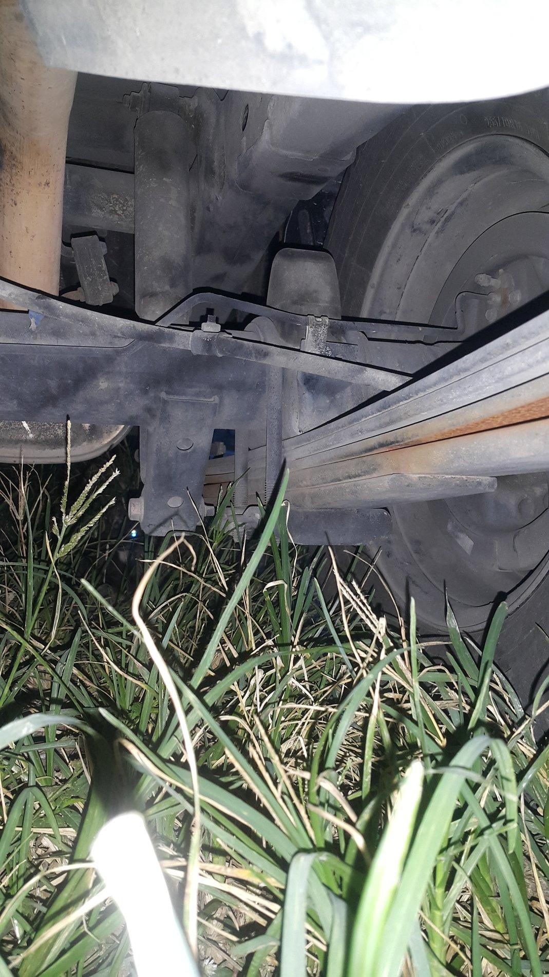

Looking at the rear spring and rear end a shackle kit won’t work.
It would have to be a new spring for a mild lowering or under axel for what looks like what’s in the above picture.
IMO.
