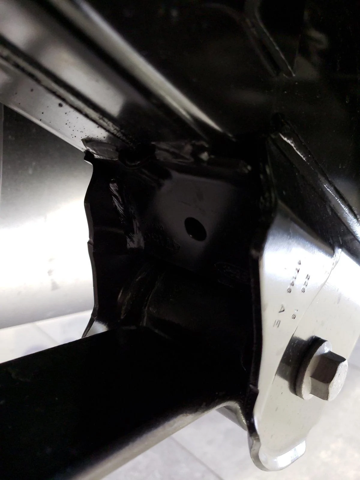

Need to look at the front spring bracket. If the spring eye is located low in the bracket(spring eye is closer to the ground), then it could possibly be flipped over and swapped side for side to effectively lower the rear without having to do a axle flip with blocks. I would never recommend using different shackle lengths because it changes the characteristics of the spring.

I should have looked at that pic better before I left.
This is the right side forward spring bracket. Looking in from the gap between the tire and wheel well opening.
Doesn't look like anything can be done to lower the truck with that since it's welded to the bottom of the frame.

2011 Dakota
The front suspension looks pretty straightforward. Either a custom spring or possibly use existing adjustable coilovers already being made for something else. The strut looks like a generic 3-bolt top mount with a rod or spherical lower.
Starting to think the rear will end up being a flip kit or custom leaf. There is a shop here in Atlanta that could make a new set of leafs.

I e-mailed "The Suspension Specialists" (the ones that have the adjustable front end leveling kit in this forum) about a rear lowering kit, and they said " We have done some R&D on the 2019 Ranger and im pretty sure we will not be able to make a 2 or 3" rear drop kit because of how its designed."
Anyone that has looked at the rear end think a flip kit would work ? Anything in the way ?

After seeing the pic below, it rules out a simple drop shackle for the rear of the leaf spring :frown: Not sure about the front attachment point...
Want to lower with slight rake...Doc
Exactly. After seeing the pics on the "build-it" page, it looks level, but they are so "butt-high" in real life. If a flip kit brings it down too much, a short shackle could bring it up if needed, as long as the correct geometry is maintained.
