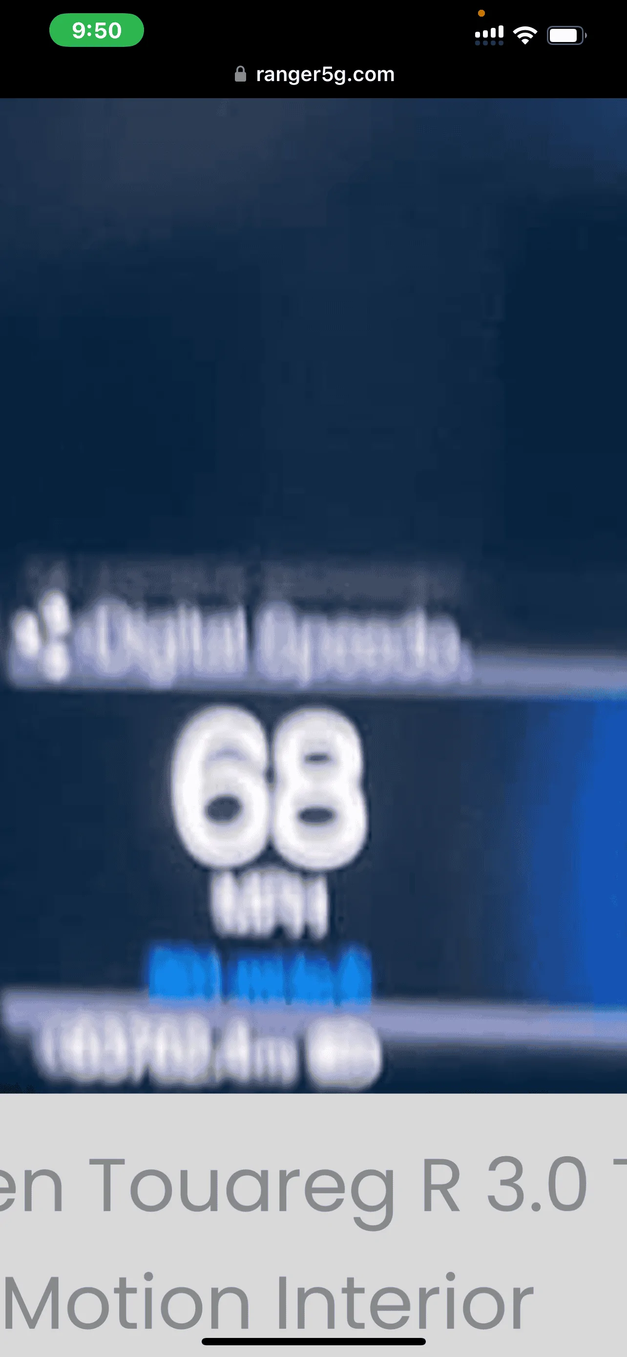

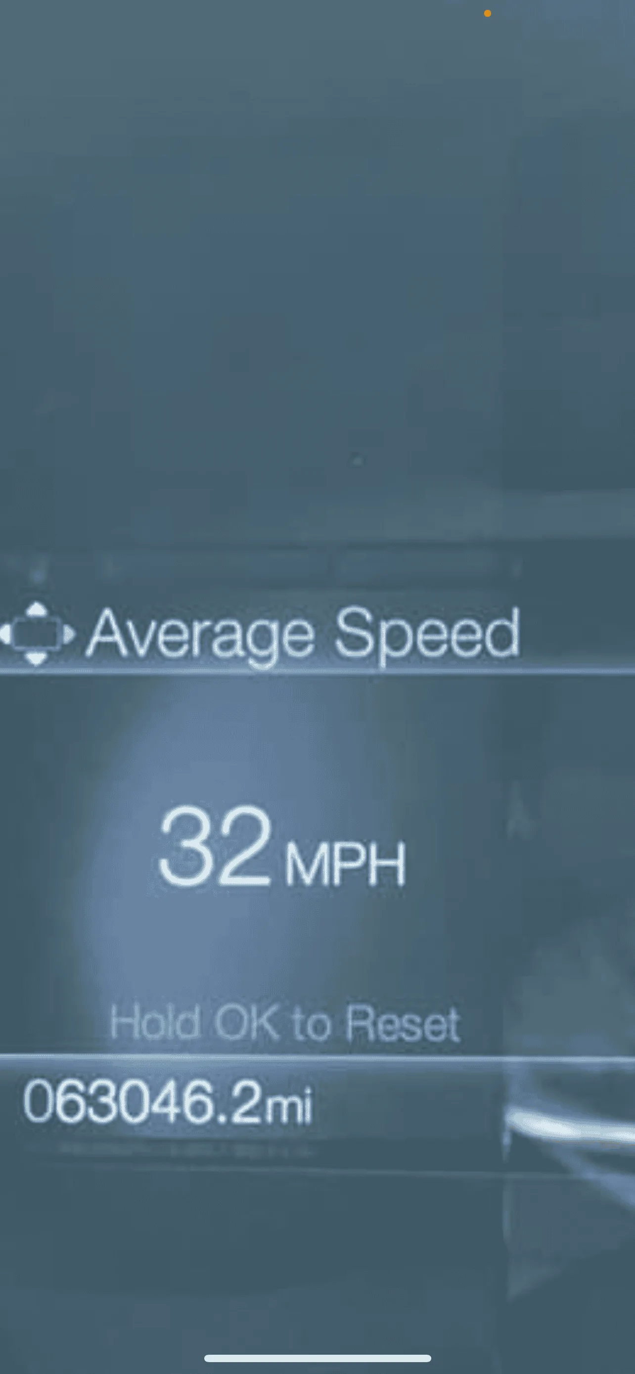

Yall are killing me lol IT IS NOT AVERAGE SPEED! Look at the blurry picture better lmao it is DIGITAL SPEED ? I’ve added an actual picture with “Average speed” so yall can see the difference ? rotflmao
The difference between what, sitting in Park with Average Speed showing and driving with Digital Speed showing? That doesn't make sense.

Please look and see there’s a clear difference between “average speed” and digital speed” in the picture I know one is blurry but y’all should see it’s actual speedometer speed not average ??‍♀

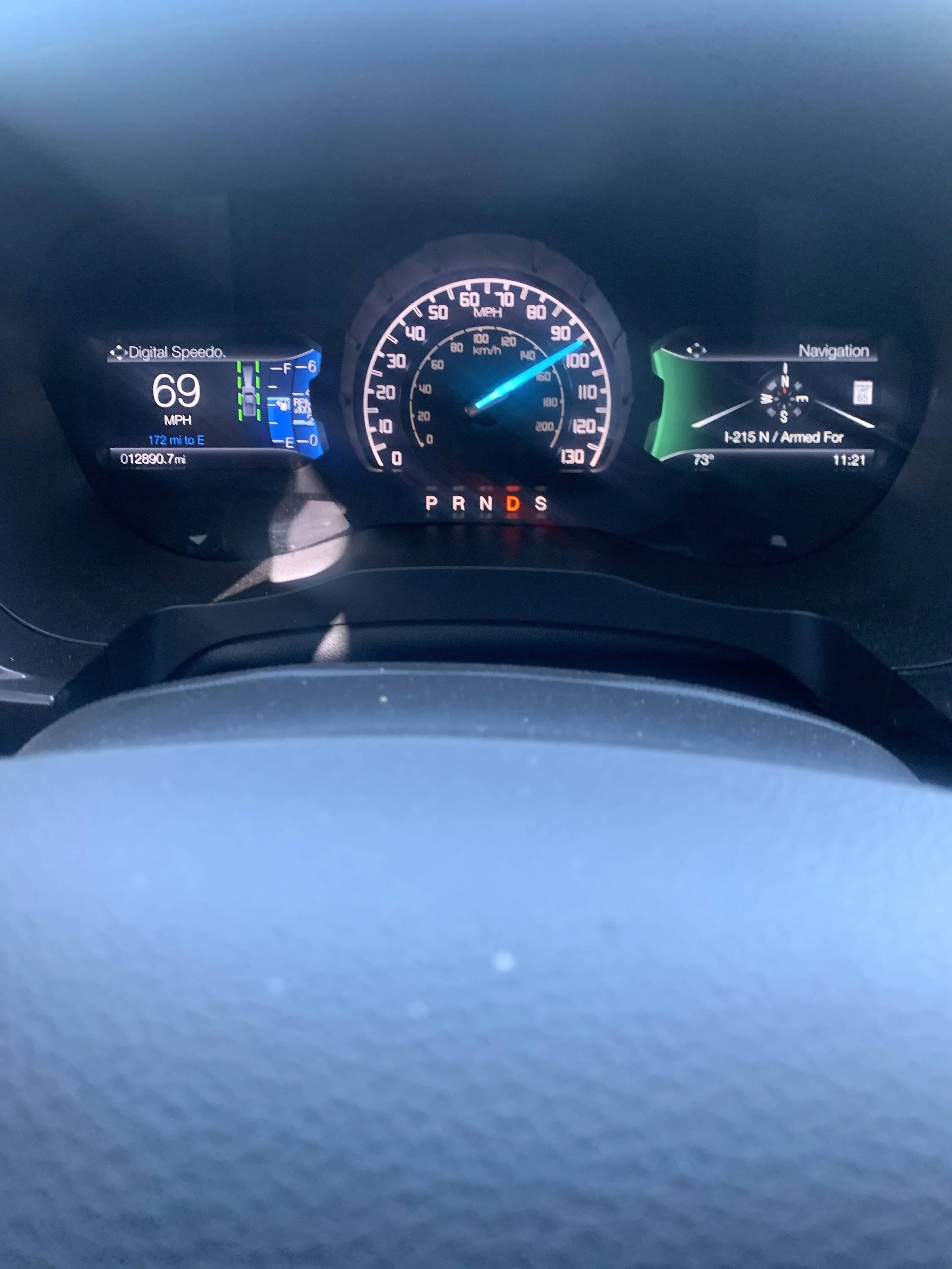

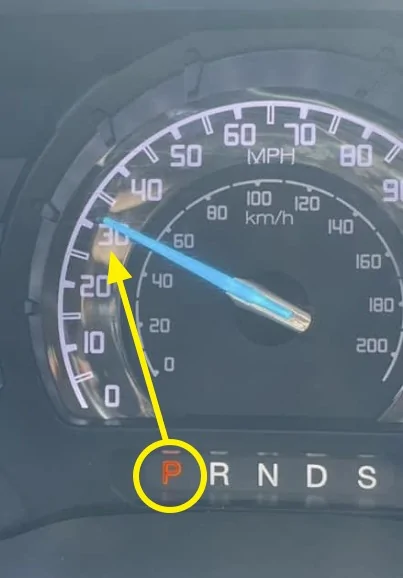

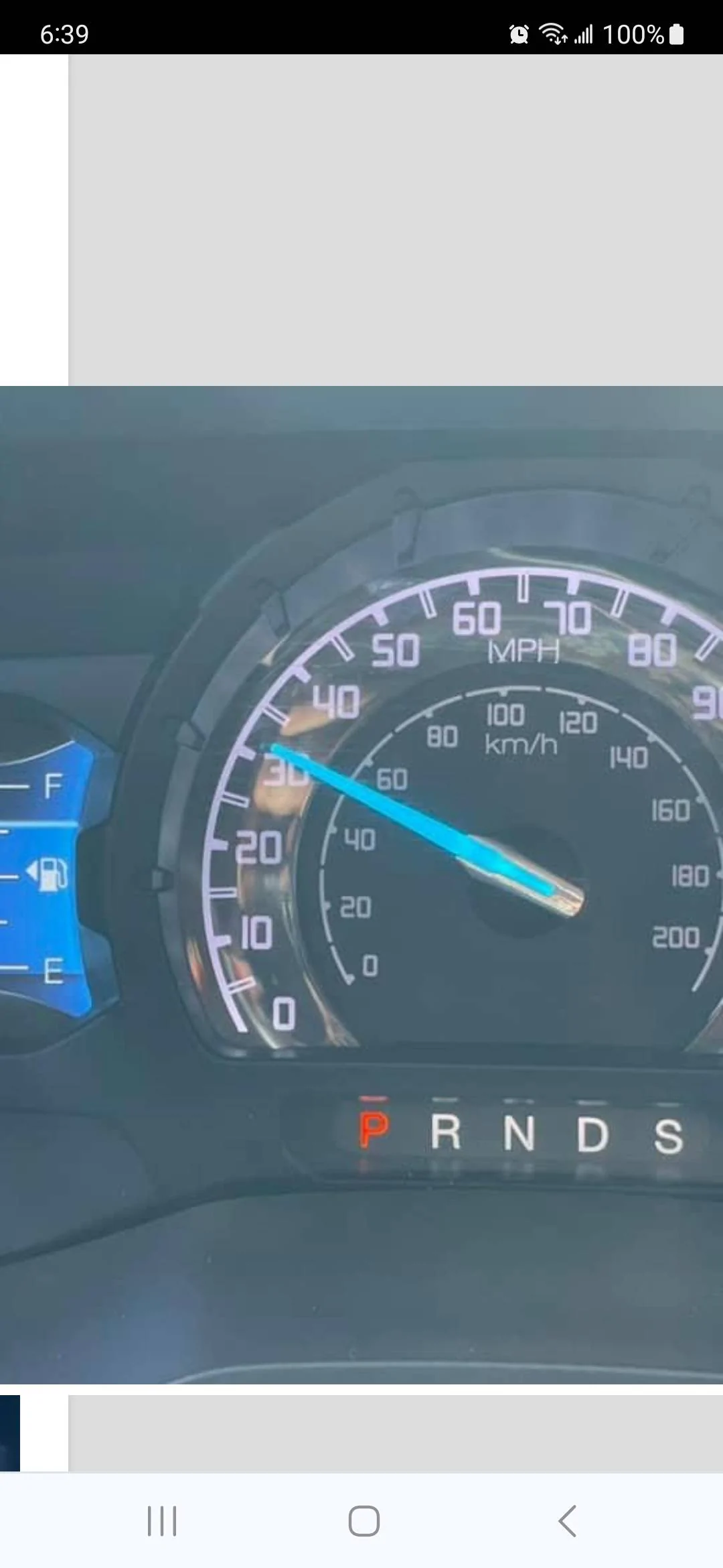

So as I posted above - this is a normal reading, it defaults to last known speed if communication is lost for more than 5-seconds.
so failure occurred at 32 MPH.
I have a hunch the OSS is dropping, requires transmission pan to be dropped to get to it.
OSS - Output Shaft Sensor
Might get lucky and just do a IPC self test to reset the locked in code
