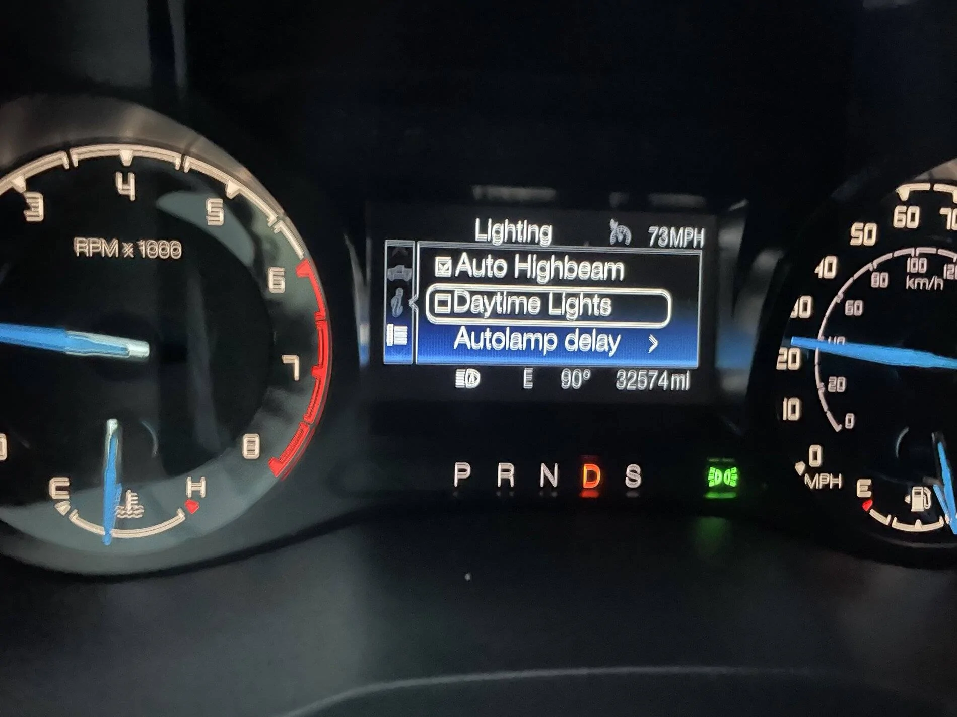

Anyone know why my lights will turn off when switched to Auto mode? (PROs, w/drop in LEDs--work great otherwise.)
Synyster06Gates
Austin
Oct 6, 2019
140
386
Liberty Hill, TX
That's weird. Mine operate perfectly in auto mode. Try turning off the DRL from the truck menu. That turns off the lower voltage operation - I wonder if that's what's messing up some bulbs for people.
JBro
May 15, 2021
North Dakota/Idaho
'21 XLT FX4
Army veteran/student
I did, and that didn't seem to have any effect. Is it my choice of LEDs perhaps?

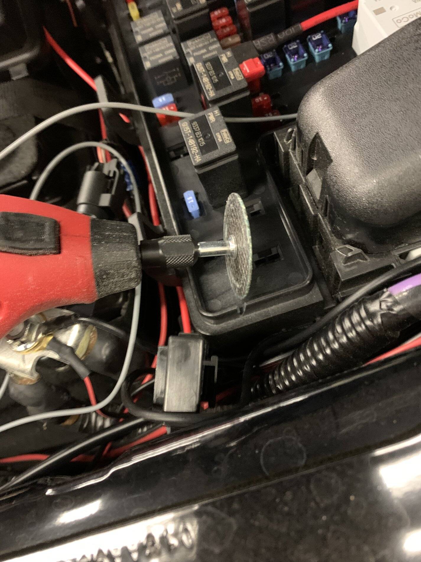

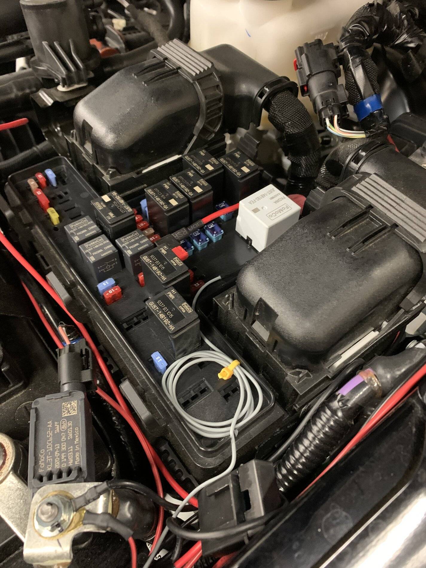

I posted this in another thread but just a suggestion when you wire up your DRL‘s. Do not modify the fuse box lid with the important seal. Make a cut on the fuse box itself and let the seal come down over the wire. Put a little silicone in there once you have your wire in place. These Alpha Rex alpha black PROS w LEDs are definitely worth the upgrade!
