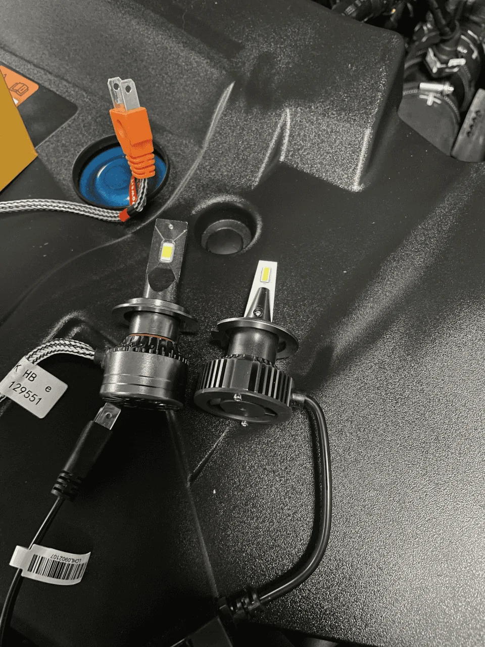

So surprisingly, was able to change both low beam leds without having to remove the assemblies, although it was a very tight fit for my hands.
Drivers side a bit harder, but not too bad.
Anyway swapped in the Auxitos and they sort of fit. While they are shorter than the Aukee ones, theyre wider and that extra width does make putting the dust cap a bit harder as it just barely blocks one of the locking tabs of it. Sorry no pictures cause its a very tight angle to see.
However, when changing just the drivers side and leaving the right alone (since it was working fine on that side), i was repositioning both of the bulbs and noticed after about 5 minutes of them being on, the Auxito one was hot (but not too hot to hold and adjust) and the Aukee one straight up would burn my hand if held on to for too long. Maybe theyre just too hot for these assemblies, and maybe the drivers side gets the raw end of the deal.
I also originally thought the drivers side may have failed due to its fan not coming on, but i turned on and off the lights around 6 times and each time the fan kicked on immediately, so not 100% sure why that side was failing, maybe after a certain length of time the fan would shut off? Or maybe just isnt enough to cool it down.
When i drove up this morning both of the Auxito leds worked good and did not shut off on the entire drive up, ill update this thread if i have any issues or no issues in a few weeks.
Aukee on left, Auxito on right.
Gotta admit the aukee just looks better quality, but seems like the auxito has better cooling, but i have no actual data of that.
