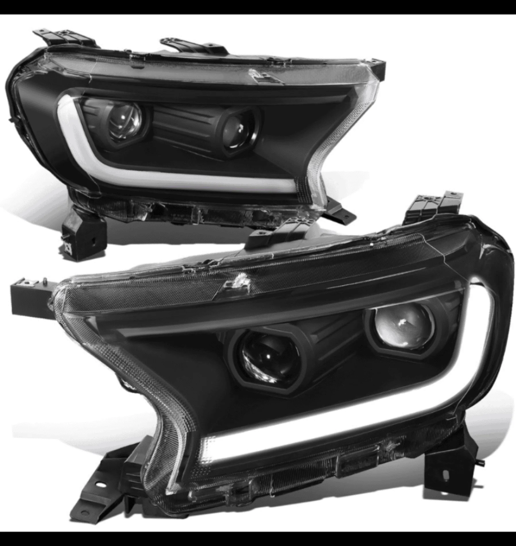

Alpharex pro headlight problem
JBro
May 15, 2021
North Dakota/Idaho
'21 XLT FX4
Army veteran/student
Which lights are you talking about the turn off? Also if the running lights or driving lights are set to low beams from the factory then it won't turn on the driving lights which are the low beams on until you put it in Drive during the day
Low beams will turn off when in Drive (in daylight).

I honestly gave up on the alpharex lights and sent them back and went with a $500 set from pro tuning lab. Zero problem with these.

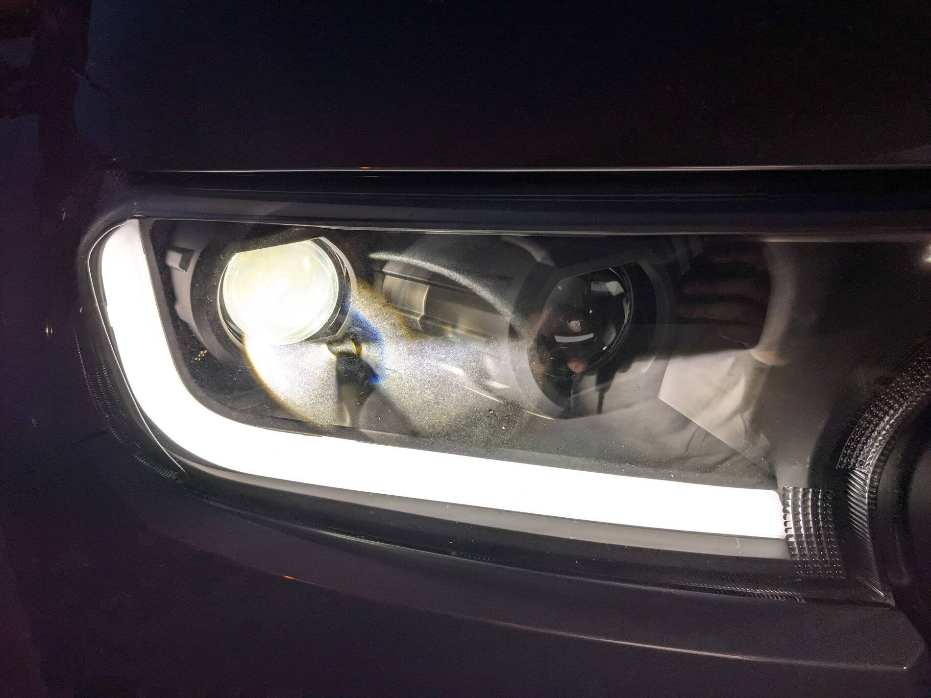

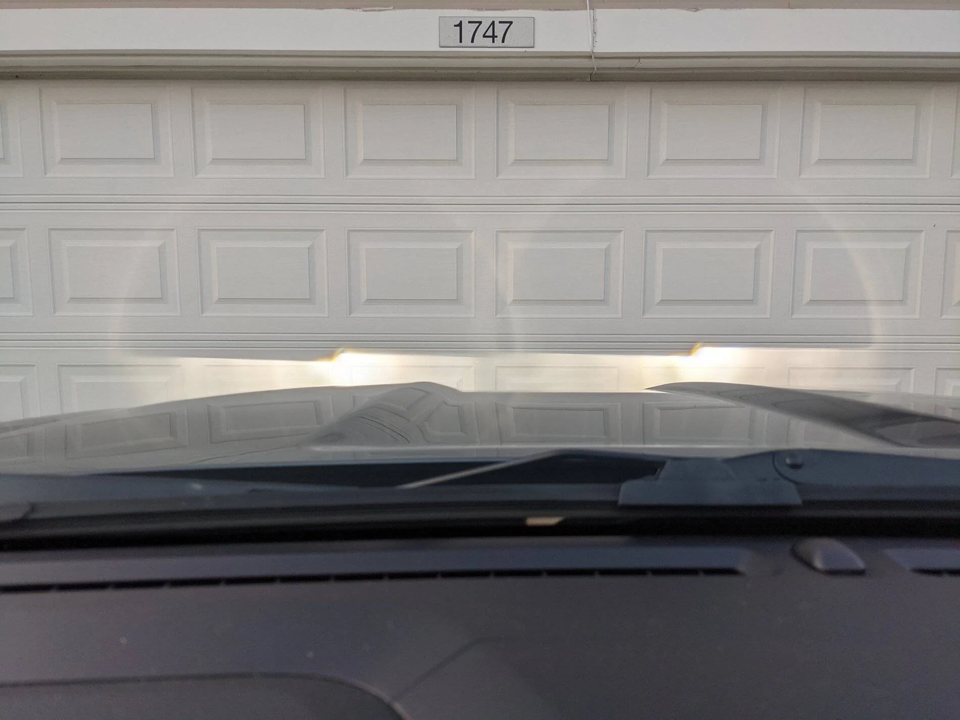

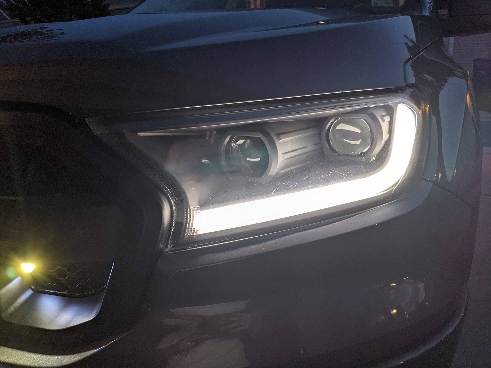

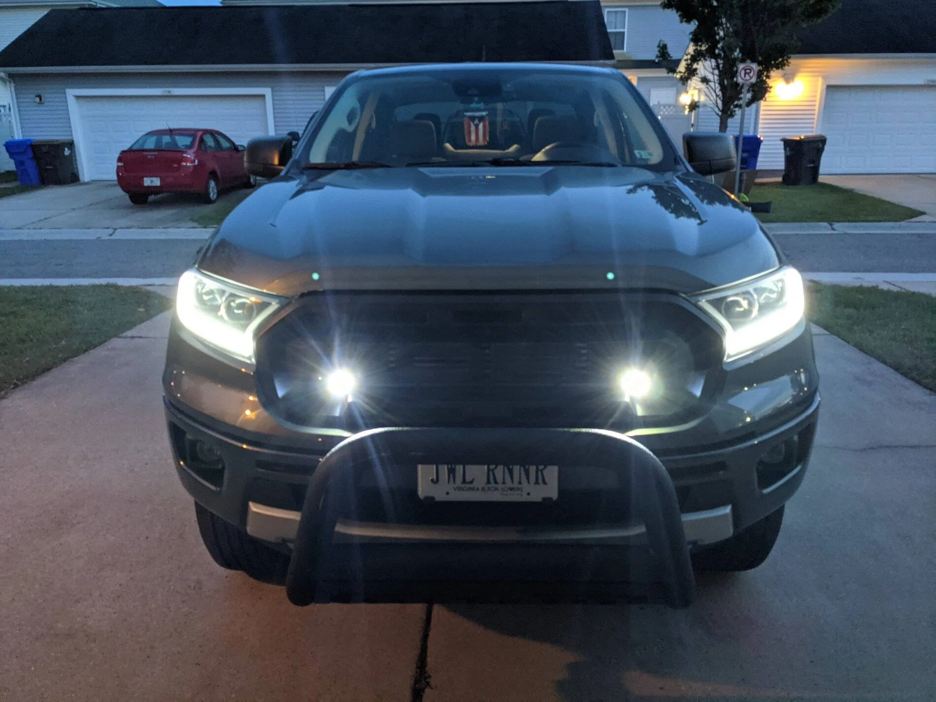

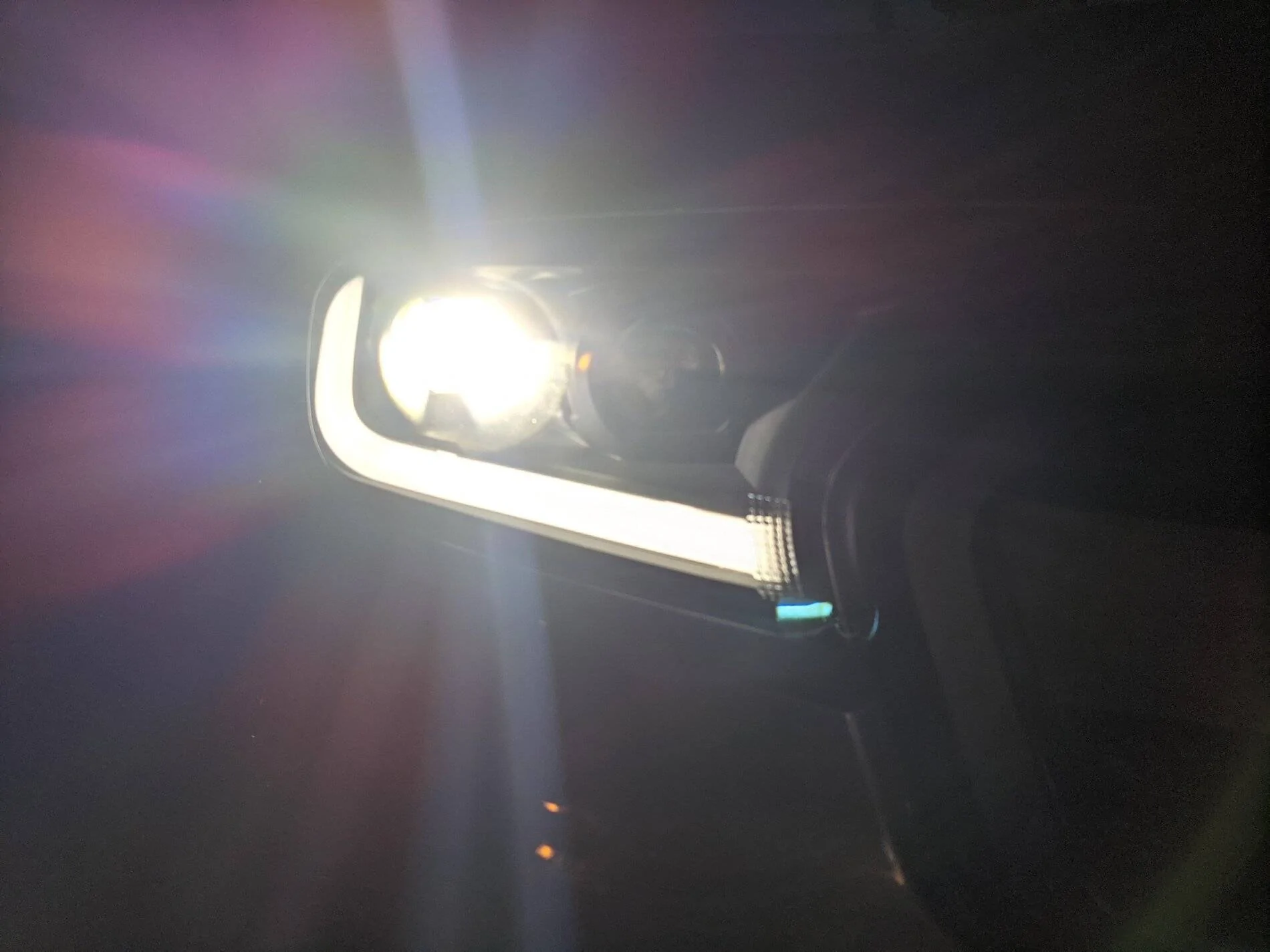

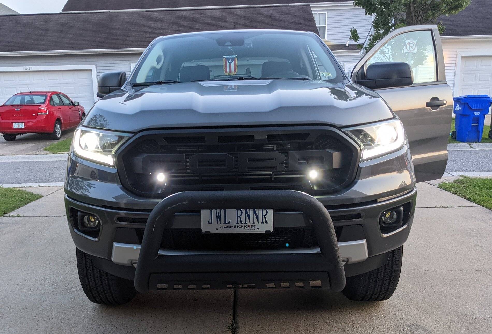

Show us some pictures of them on your truck and of the cutoff pattern. Did you need to do any changes in Forscan changes to get the LED bars to operate as DRLs instead of the low beams? Also did you change out the halogen bulbs for LED?

It's not very dark here. So i can't get a better cutoff picture, but there are the basics.

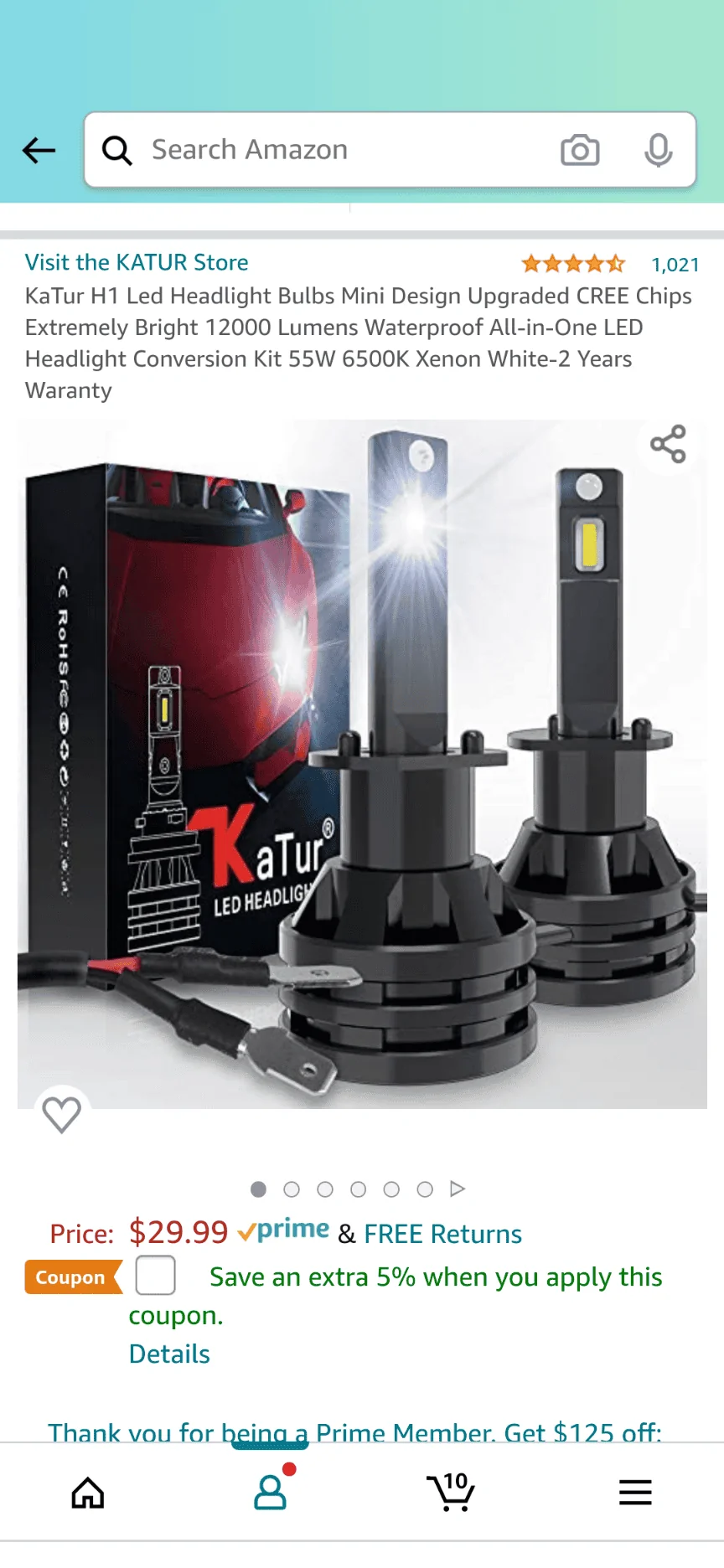

All I did in forscan was the turn off low beams for DRL, and enable parking lights only. Since the led bar functions as both DRL and turn signal, it's always on. And i only swapped out the lows for LED bulbs since i never use the highs. They use an H1.

DRL work in auto mode, no need for forscan. And while i used those lights they worked fine for me. They were a tight squeeze to put in, but they do fit it you have patience.
