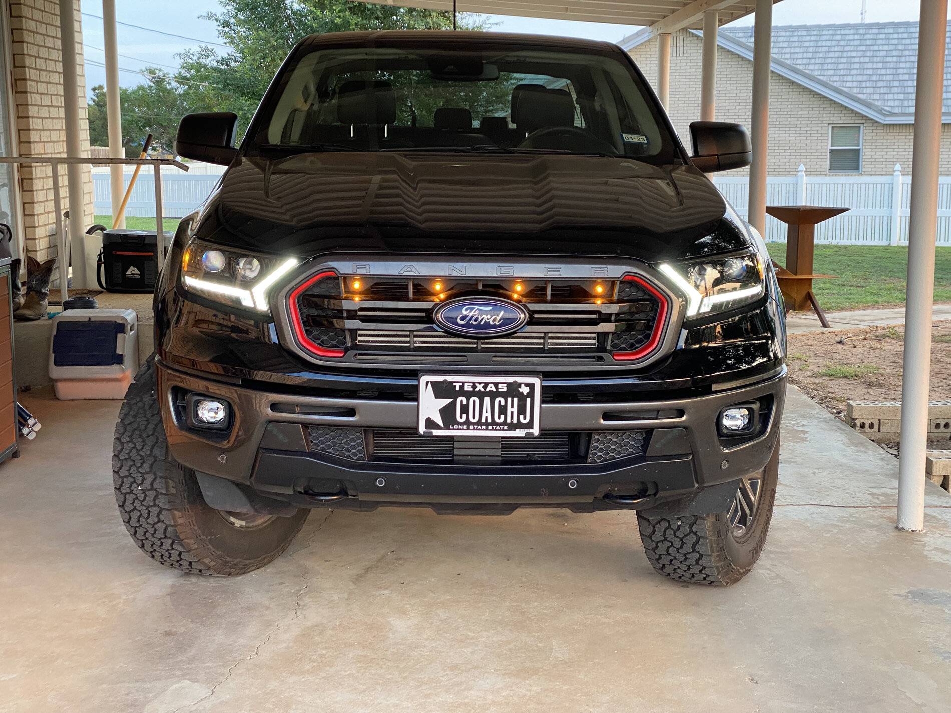

I installed these today, and went with the Aukee bulbs as well. My driver's side bulb keeps shutting off randomly; is this happening to anyone else? They also don't have near the "brilliance" as what your pictures show...yours turned out really nice and appear very similar to my Morimotos in my last truck (2013 F150 with the XB LED headlights), so i went with the Pro/Aukee setup and I'm a bit let down to be honest...I'll have to investigate what's causing the shut down. It comes back on after turning them off and back on again. And it's just the one bulb is what's weird.
CoachJ
Rhett
May 14, 2021
53
42
2021 Ford Ranger Tremor
Teacher/Coach

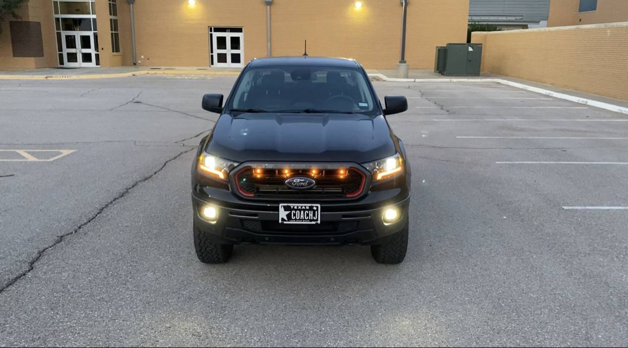

Oh, but here's some pics. They do look good. Also installed the Stage3 grille lights and Diode Dynamics fog lights today. The grille lights were the only "easy" thing all day lol.
