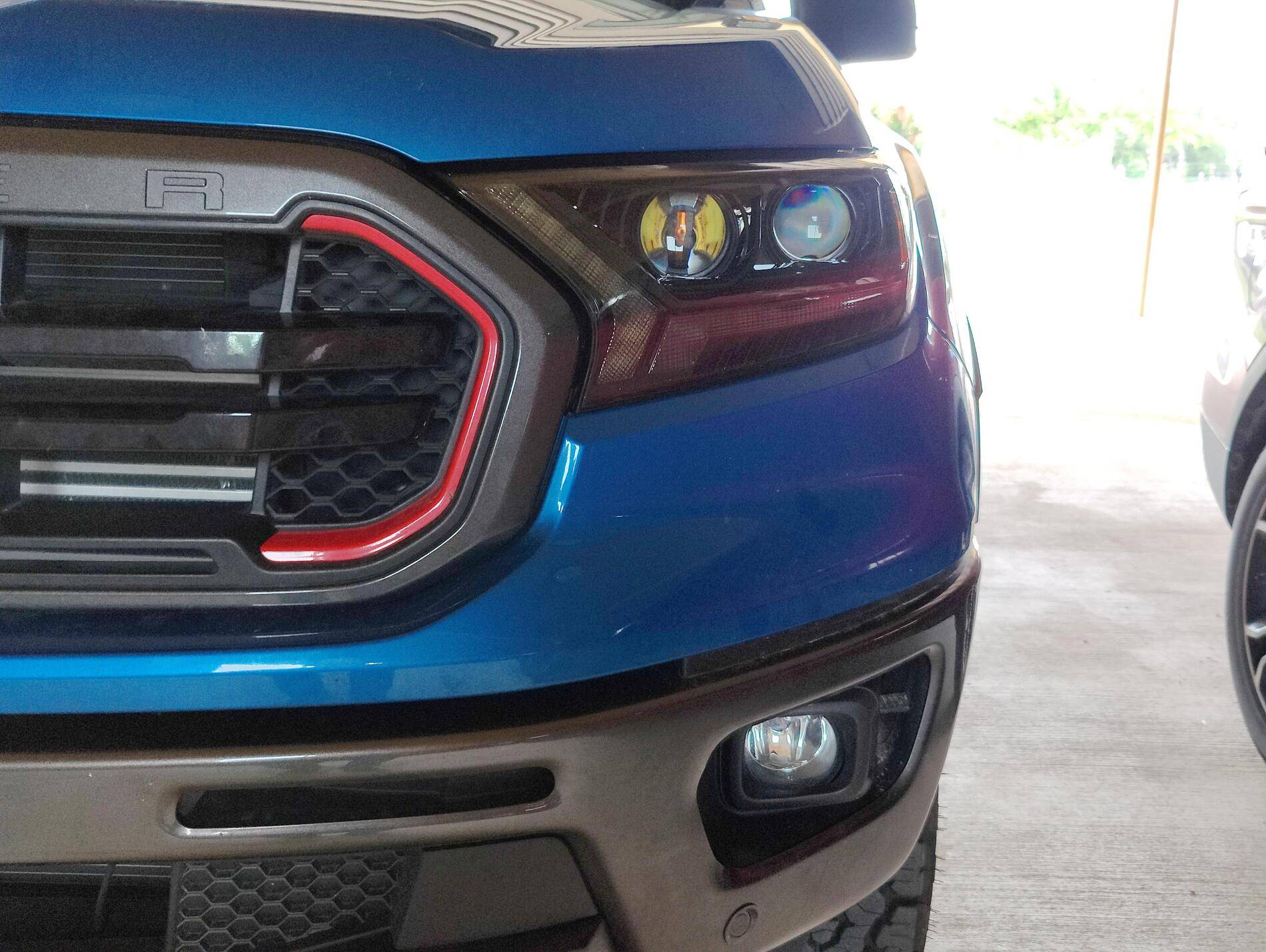

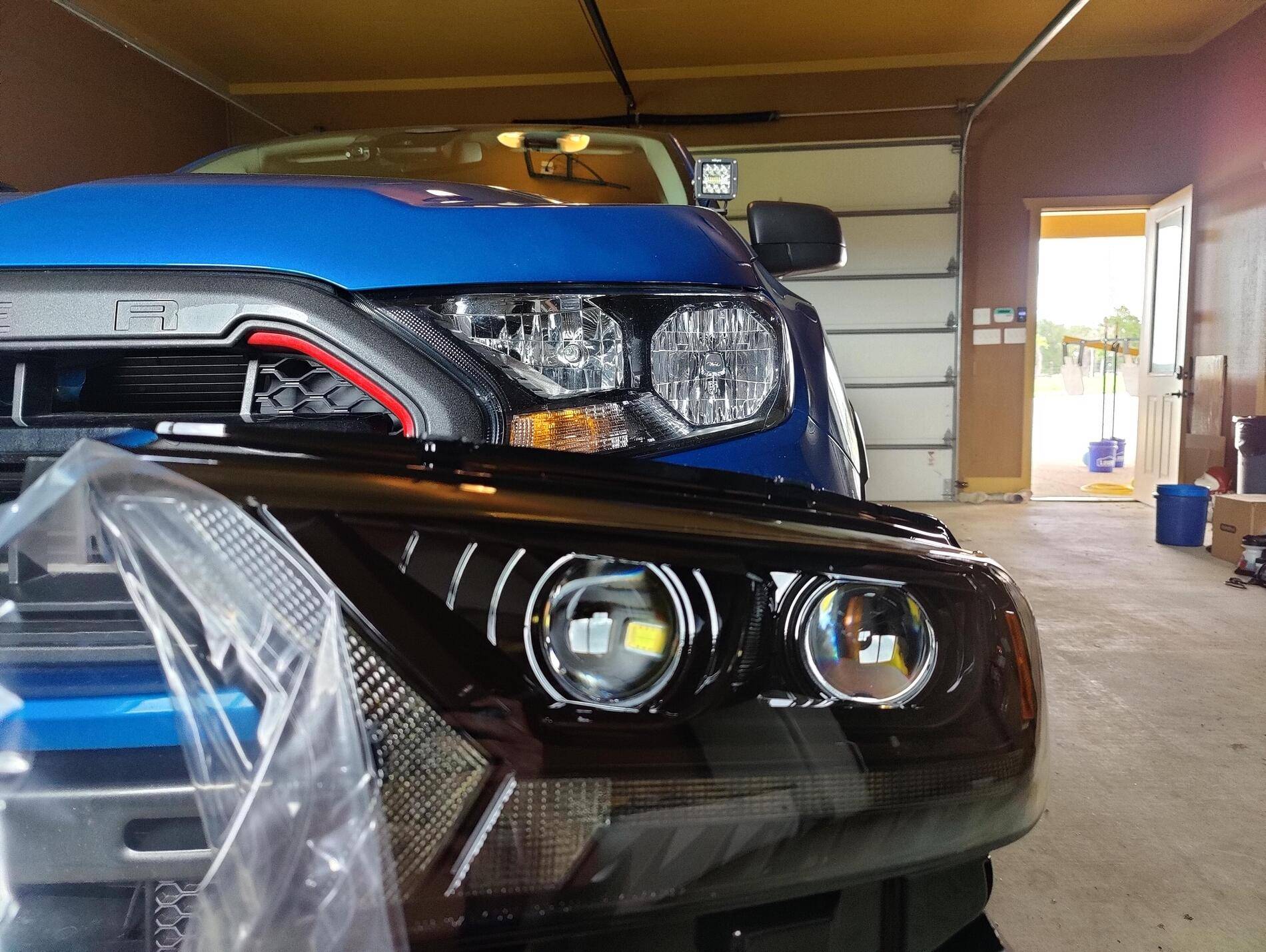

Before - next to the stock lights.

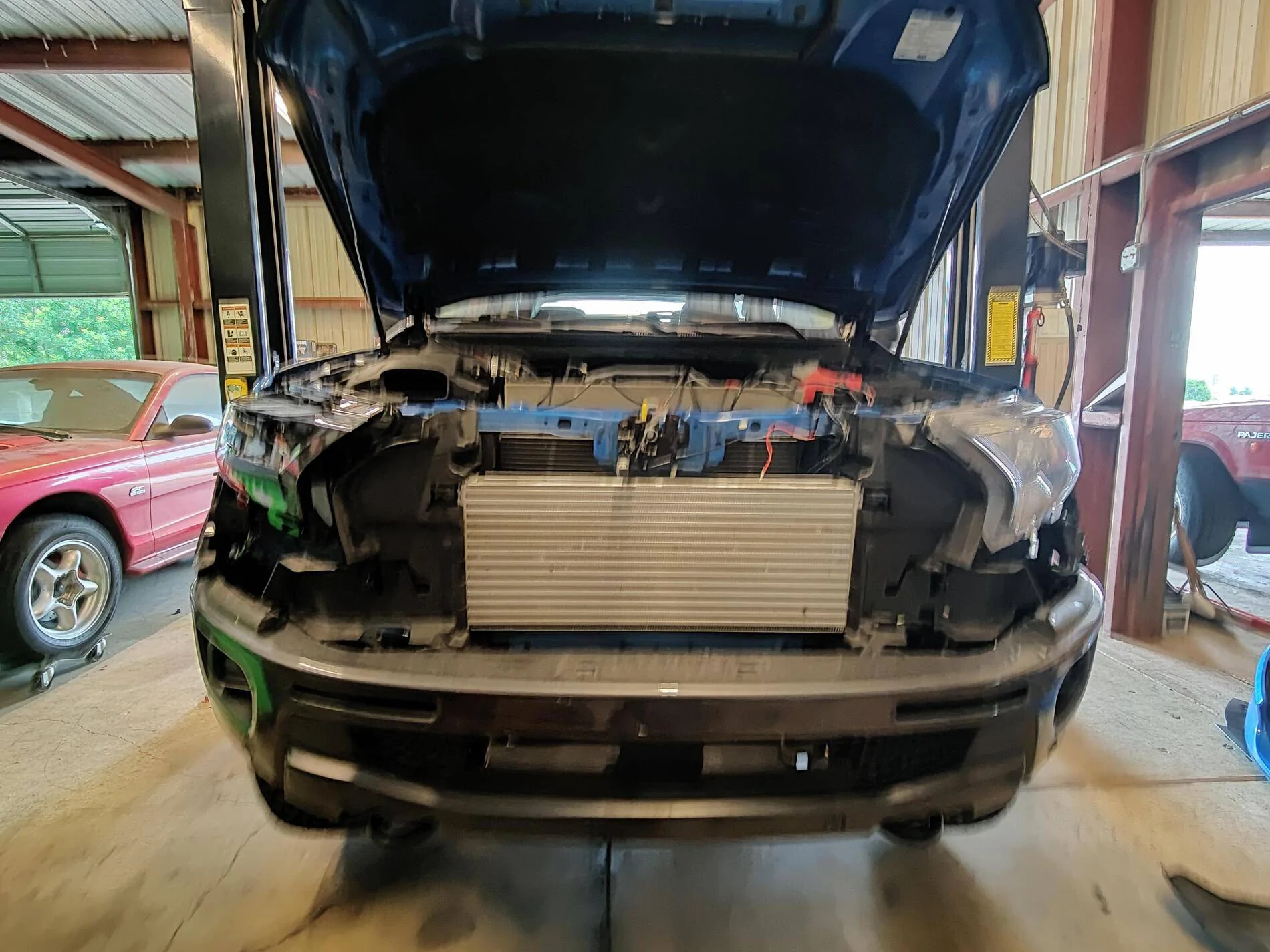

During install

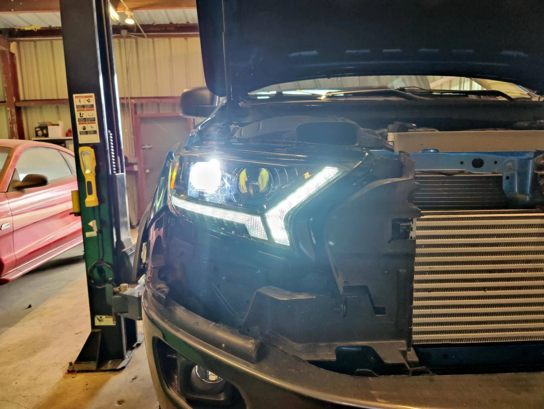

Testing the first light

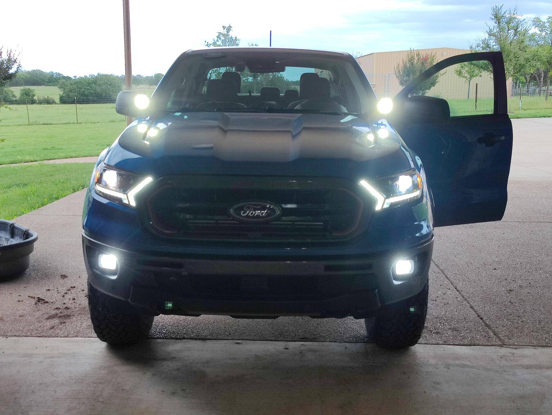

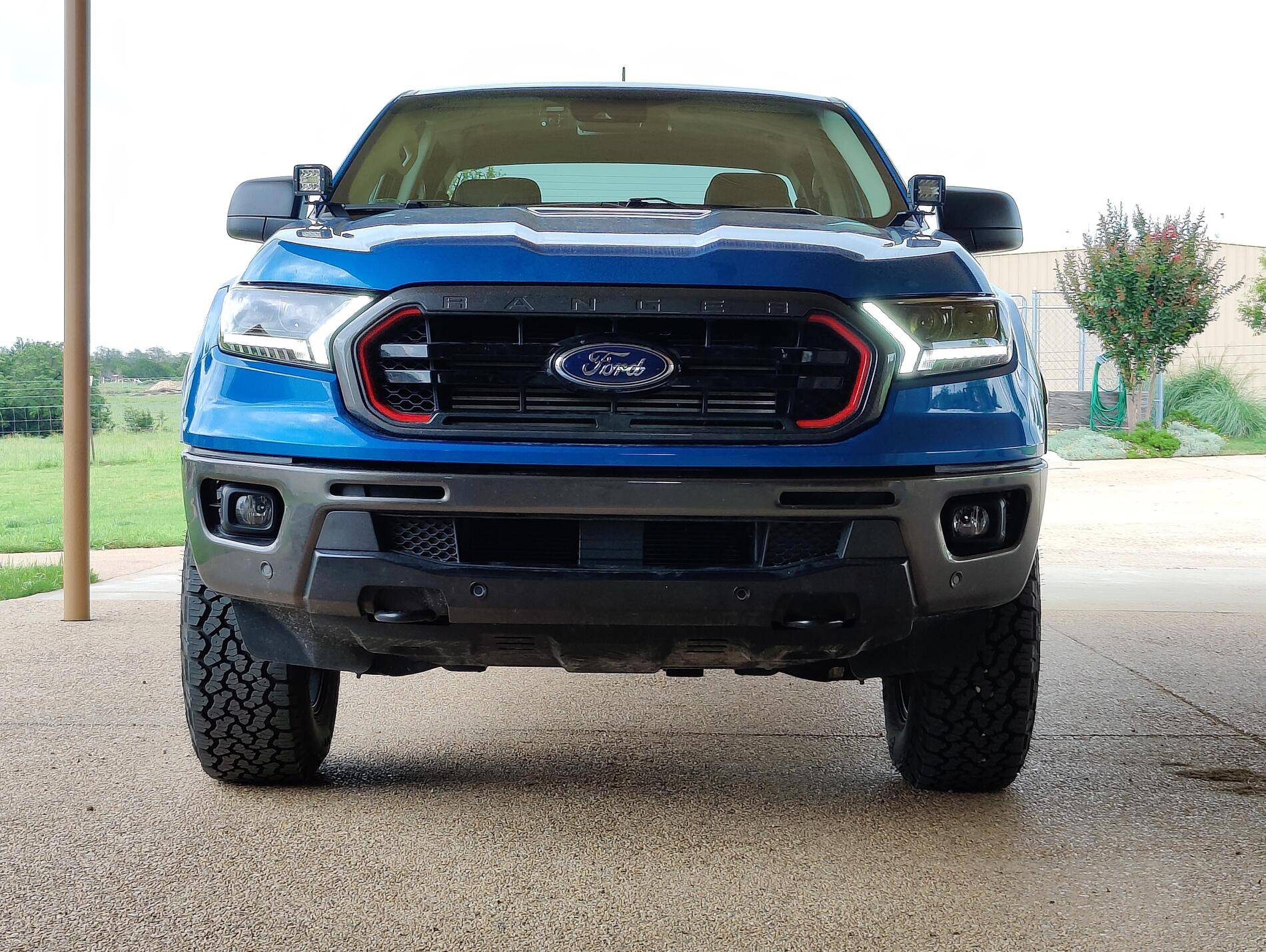

A few shots on the truck

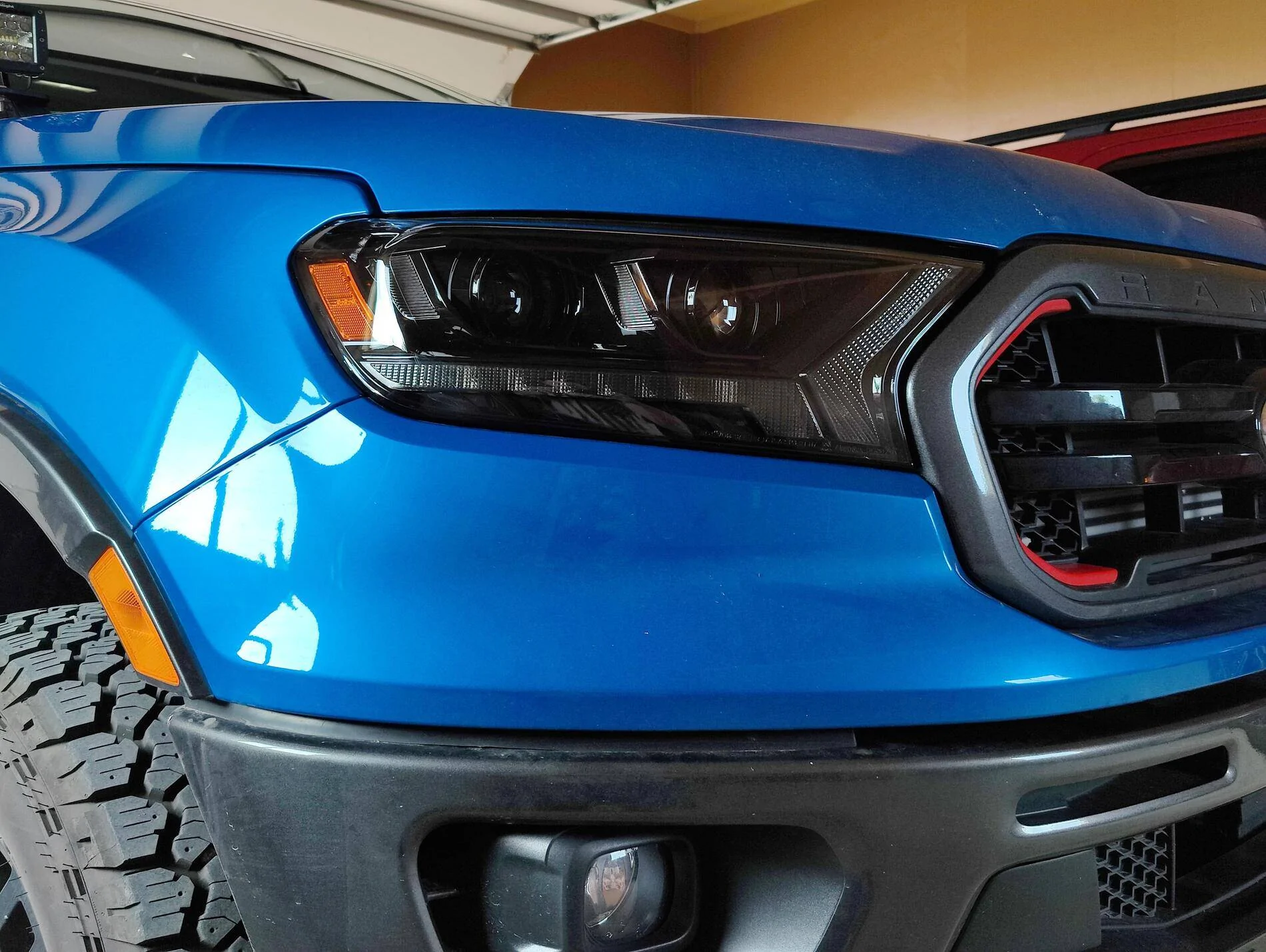

All of my lights

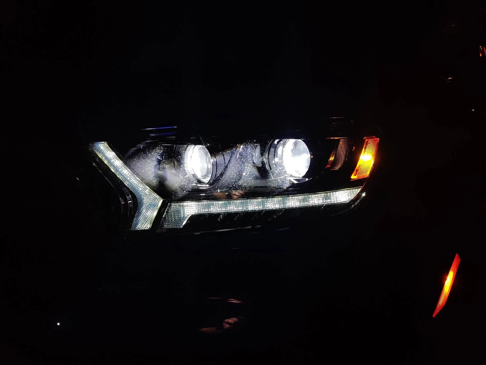

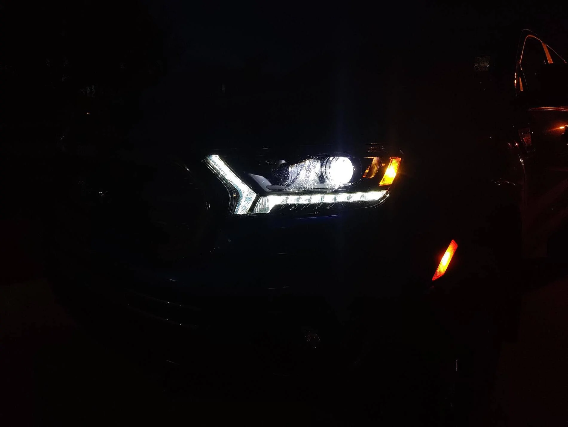

Now for the actual lights!
DRLs only
Low beams

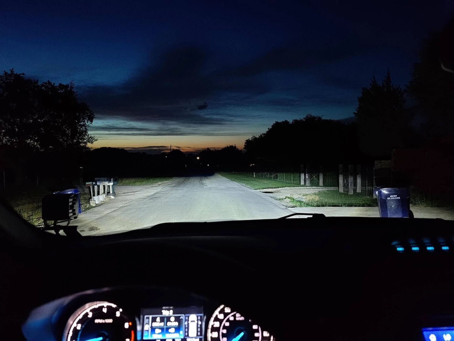

Lows - light cutoff on my gate

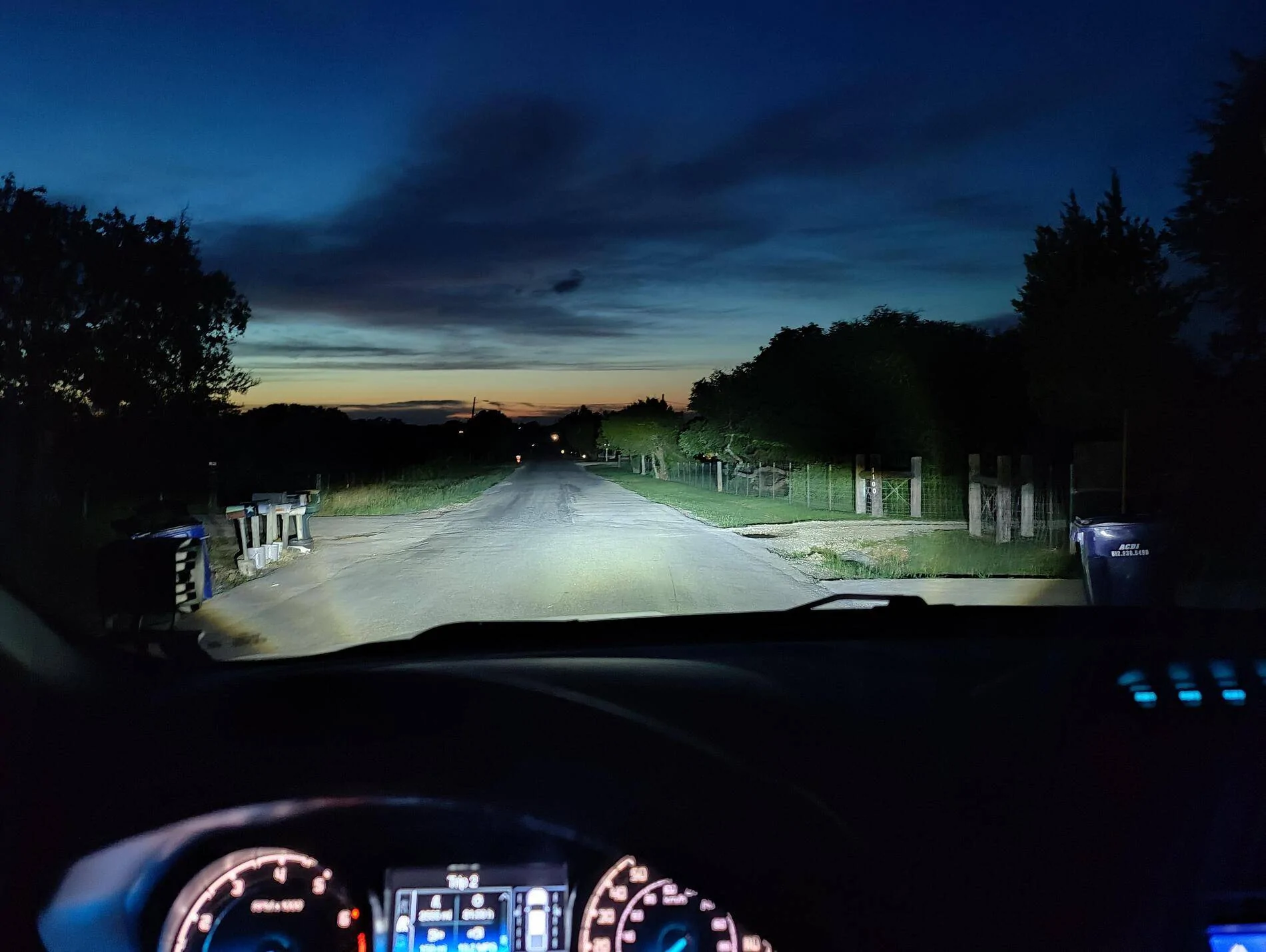

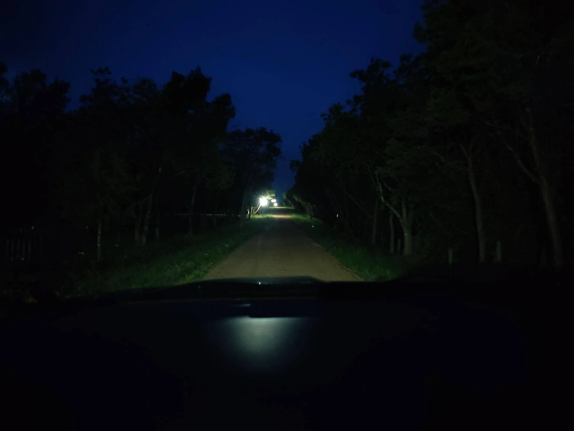

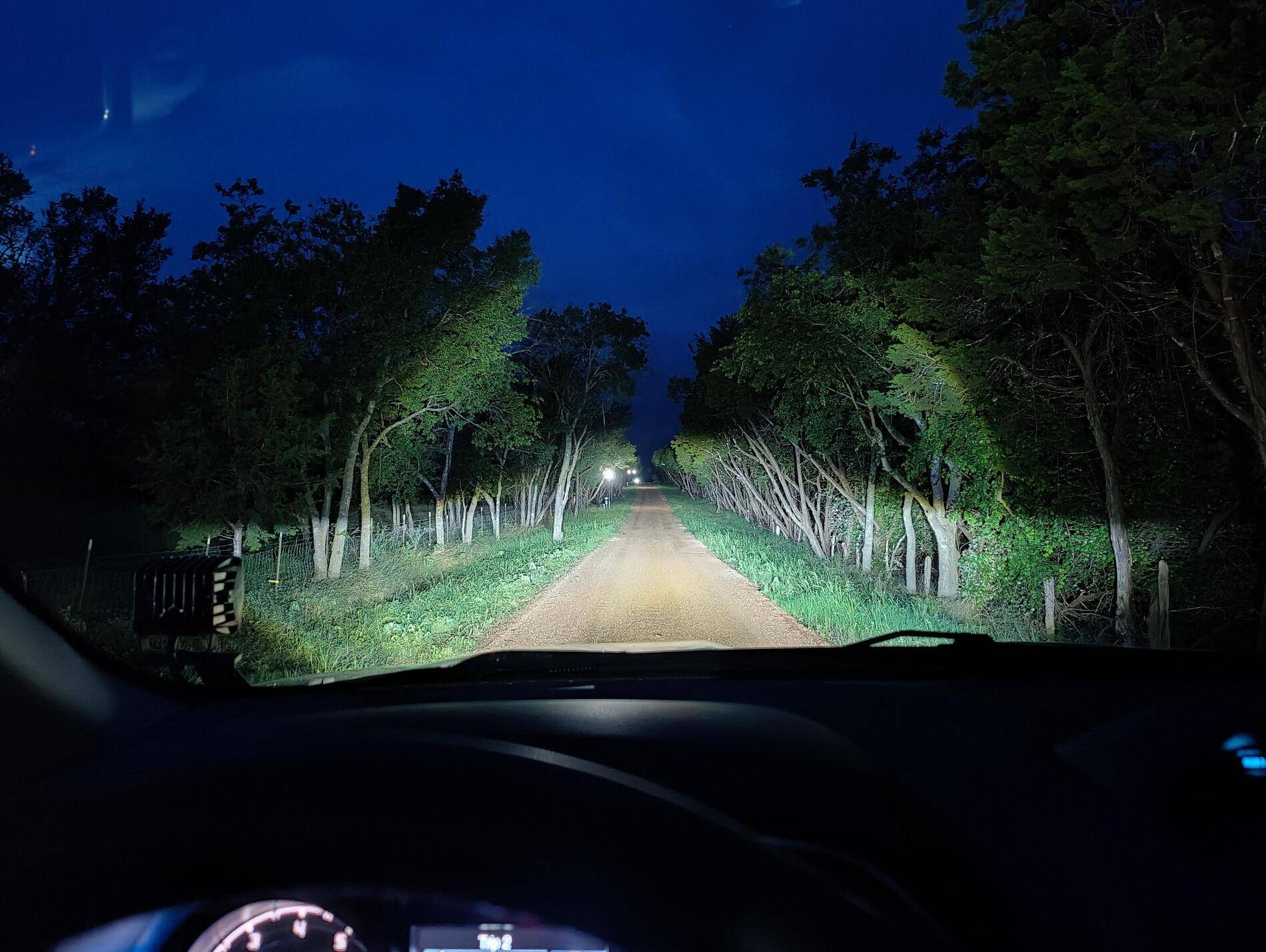

Low beams on the road -
And high beams on the road
