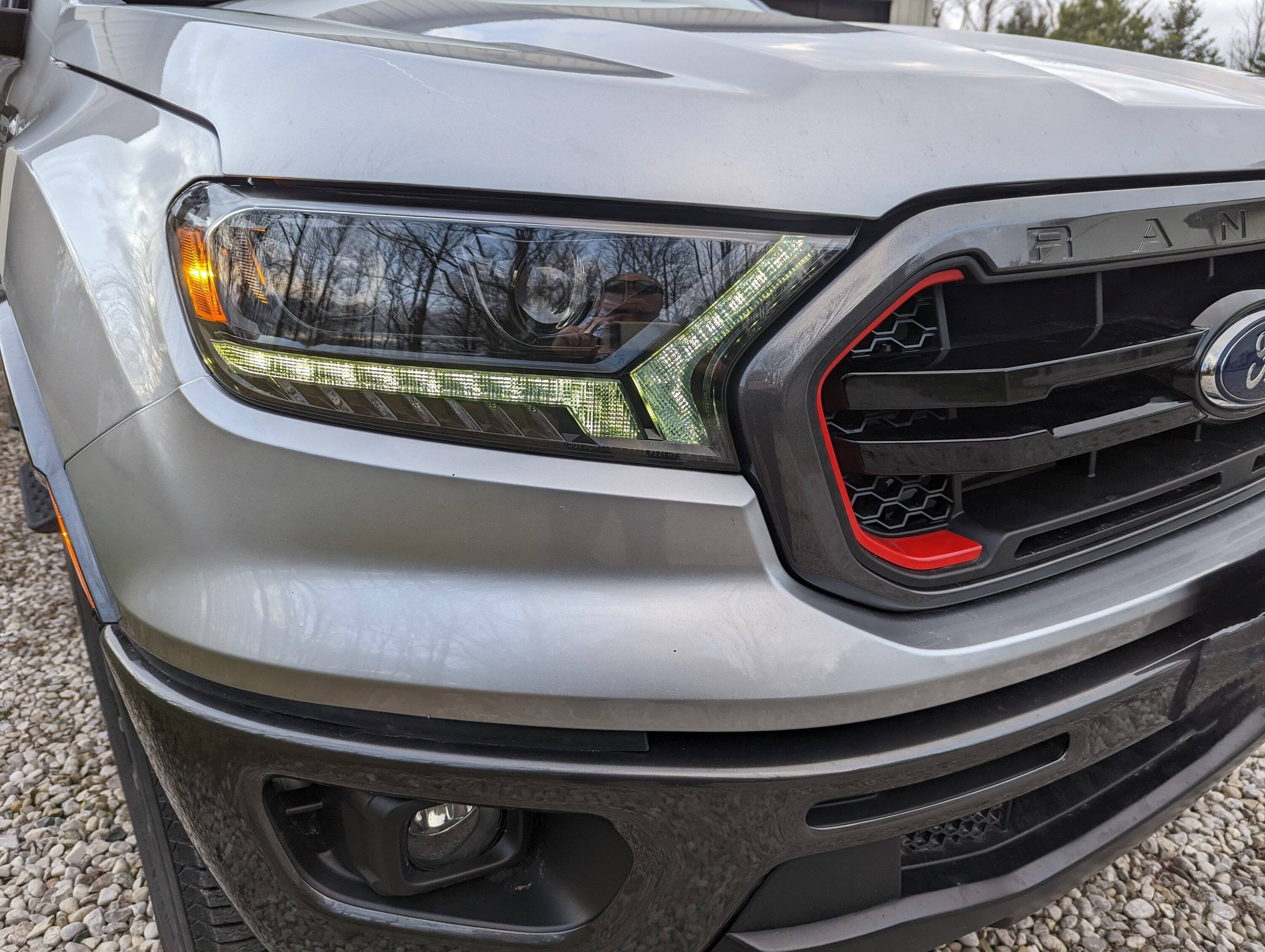

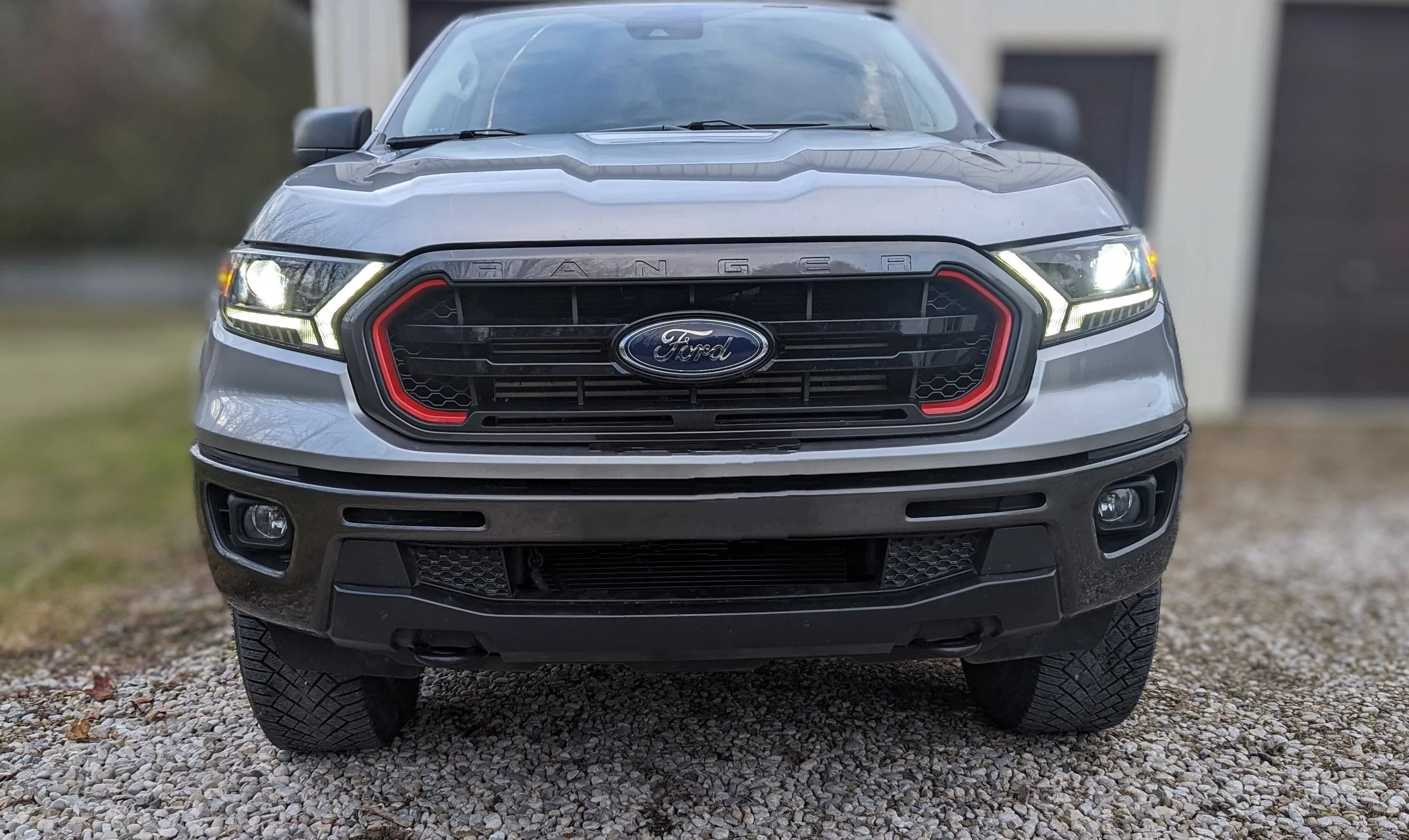

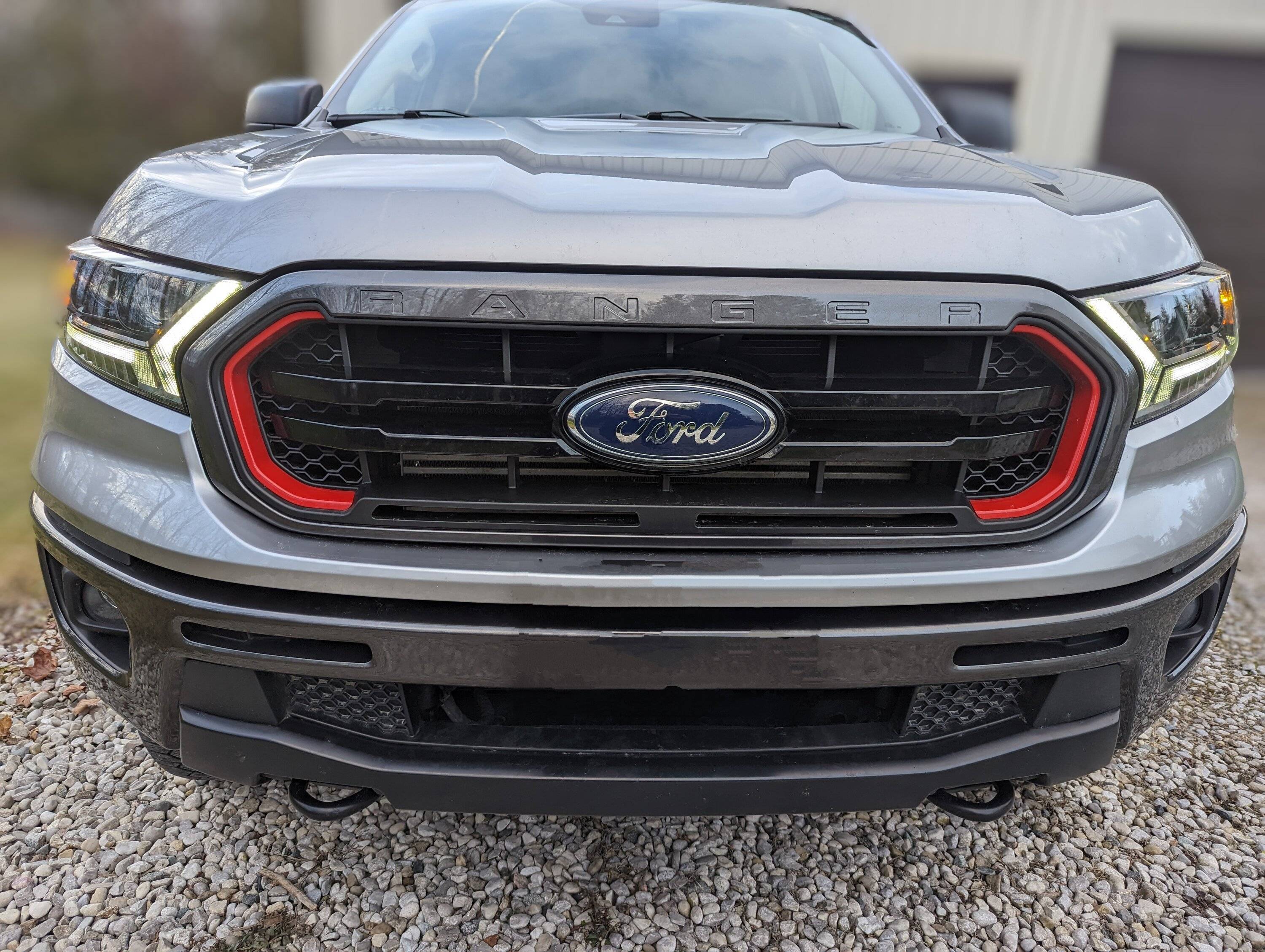

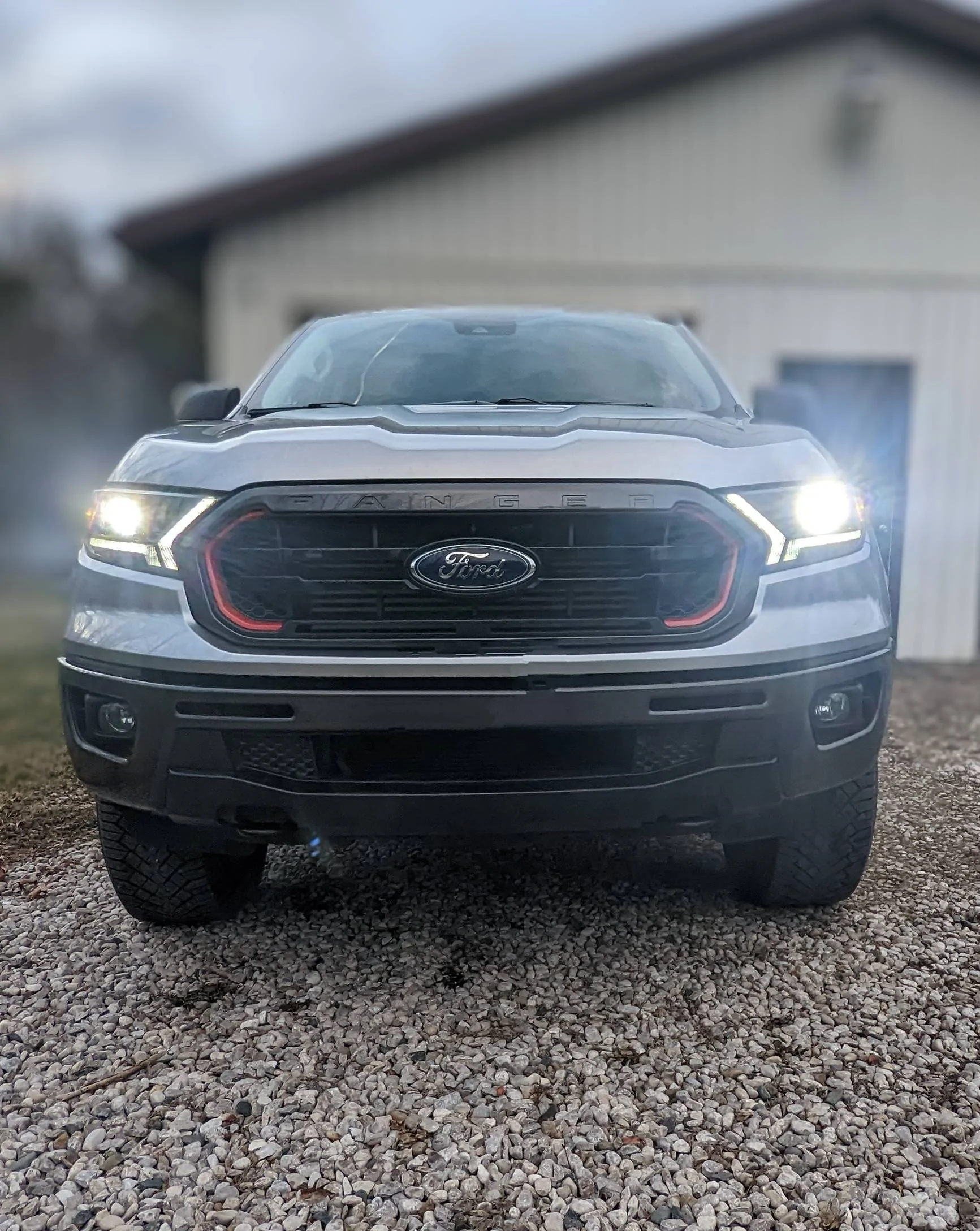

Just had my alpharex pros installed ....I decided on using Auxito H7 GF series LED bulbs in lieu of the provided Halogen bulbs.
I'm pretty happy with how the lights have turned out...great cut off beam nice bright color.... everything seems to be functioning as well...turn signals, 4 ways...DRL functions well.
I did not install the assemblies myself I just took my truck to a local ford dealer to have installed and they reported nothing much in the way of issues during installation and that everything was pretty much plug and play.
To date the best upgrade I've made to my Tremor
