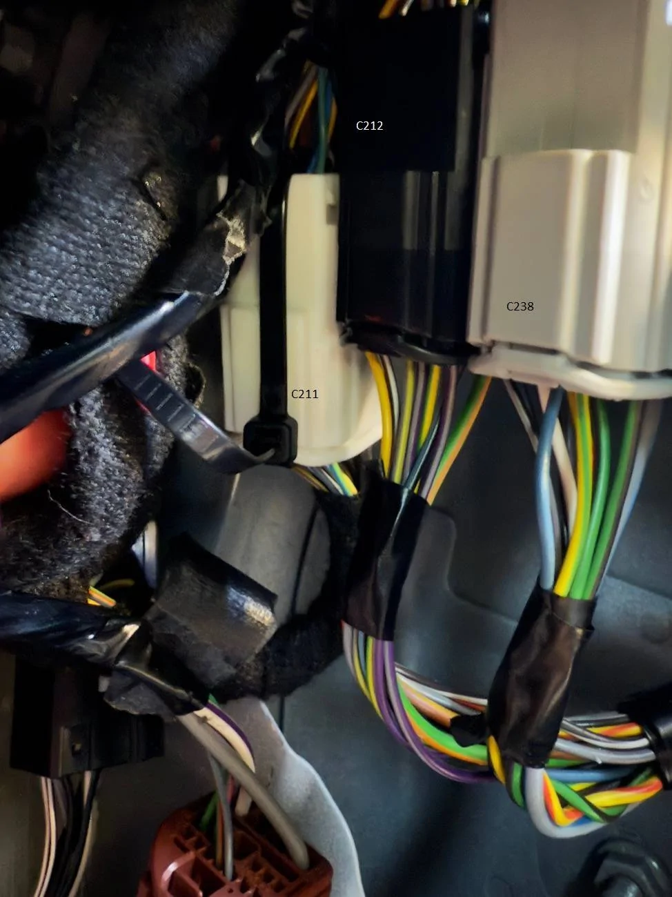

The (MS-Can) Bus has a connector just before it feeds the FCIM Connector, and it is an easy access connector.
Under the Passenger Side - Kick Panel is C211
This has been a noted problem connector, and this contains the (Can-Bus) wires that feed the FCIM.
With the FCIM being the only module on the network that is offline, this may be a good spot to try a (Pull & Reseat) to see if the FCIM will come back on-line
For Ref: C211 feeds pins 17 & 18 on the FCIM Connector (MS-Can) Bus
There are more wire checks to check the Can Bus but let's start here with these simple checks to verify we have power to the FCIM, and a quick connector reseat before we dive further.
C211 - Location (note the zip-tie) from another member who had similar issue and found this connector not secured
This is located behind the passenger side kick panel - just below the glove box.

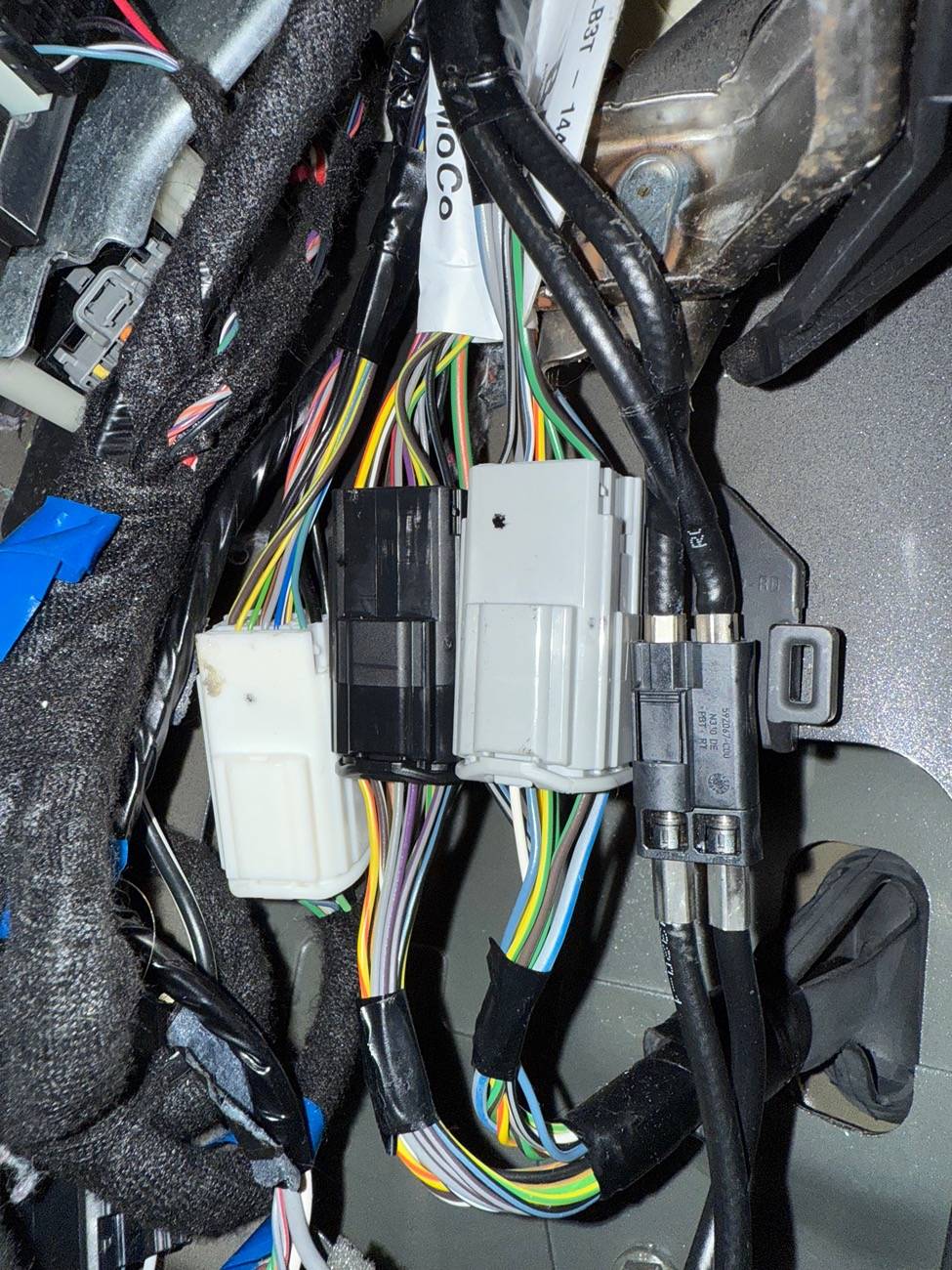

To check the (MS-Can) bus circuit we need to understand that for the MS-Can it has 2 terminating resistors (One on each end of the circuit)
One is in the GWM and the other is in the FCIM
So: Disconnect the Battery
Disconnect the connector on the (GWM) this is the connector on the back side of the OBD-2 Port
and we need to Ohm C2431 (Pins 22 & 23)
This is testing the MS-Can circuit and should be reading 108-132 Ohms, each end of the circuit has a 120 Ohm resister - so when the circuit is (Intact) GWM & FCIM connected = 60 Ohms resistance in the circuit.
Any module on the circuit (internally) faulted can pull down the resistance and affect the circuit.

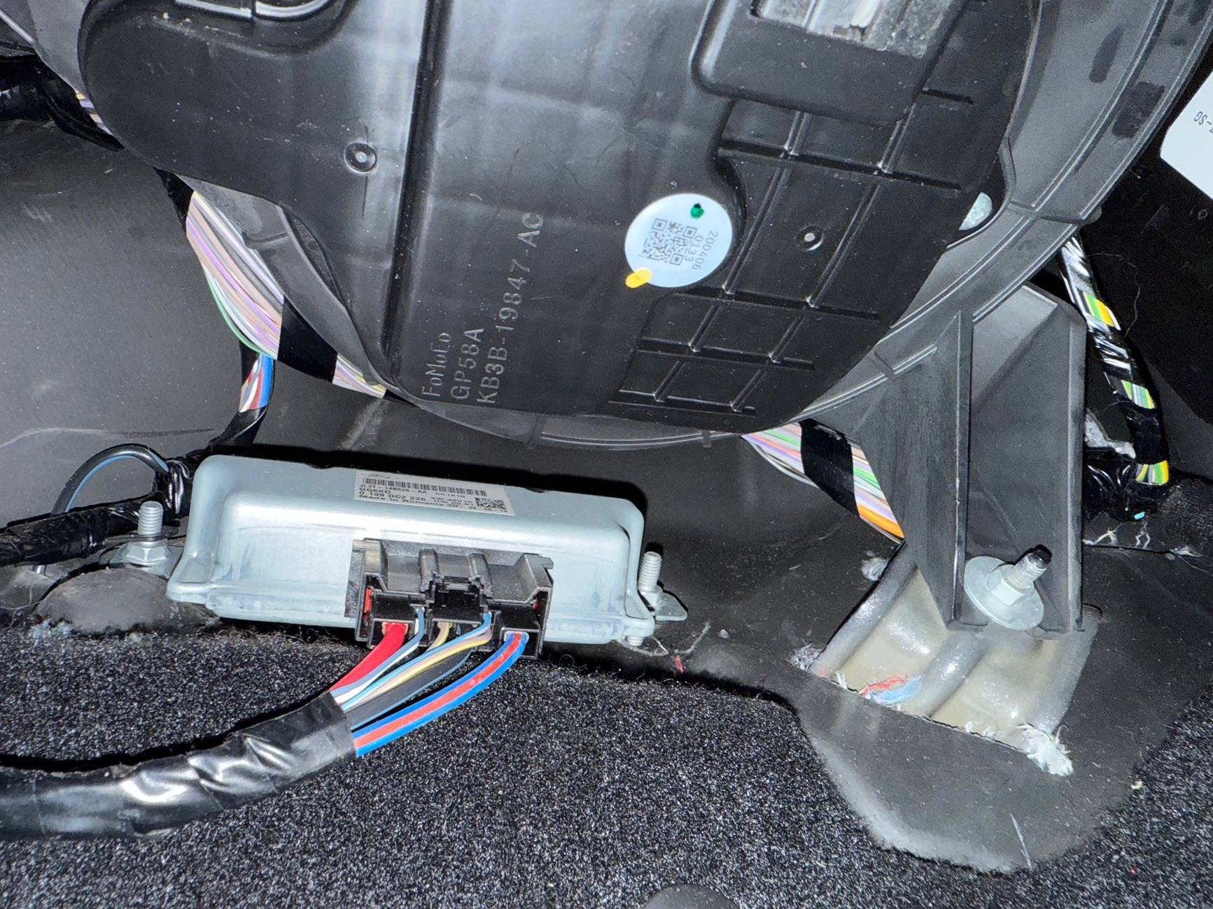

With your (Scan) reports - I see the TRM has a issue of (Not Updating) but it is reporting on the bus.
The TRM is the silver-colored box just forward of the C211 connector, it is mounted under (behind) the TCU.
I would try disconnecting the TRM and then try clearing the codes and see if the FCIM will awaken.
PLUS: I would try - Creating a NEW profile when you load Forscan as this will force a (New Scan) for installed modules to see if the FCIM will populate in the Scan (run) as when you get to the small pop-up when you hook up - it asks you - Load New Profile or use Existing Profile that you named.
If you use existing - it is only going to load the modules it picked up when the (Existing) profile was loaded.
This is (one-drawback) of Forscan vs a Scan Tool, if the module was not picked up with the initial scan it will not pick up that module unless you force a new scan for modules, vs a Scan Tool will scan all available modules.
C2431 - Pins 22 & 23 - are the MS-Can bus wires that feed the circuit and ends at the FCIM, so with the FCIM connected. Reading should be 108 to 132 Ohms
This is 120 Ohms with a (+/-) variance of 12 Ohms.

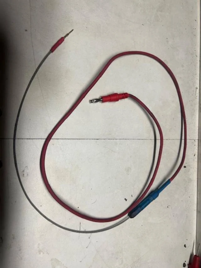

If you do not have a meter and are only needing one for this specific issue.
I would just get a cheap meter and use a T-Pin or Paper Clip as Test Lead Kits are stupid expensive - Flex Probes & Back Probes.
Standard (Leads) that come with the meters are too big to fit inside connectors and even if they do (it requires you to hold them in place)
But in order for you to (adapt) the meter leads to connect test probes; you need to find test leads that will slide over the (meter Lead - Tips) or
Get another set of leads that has the (Banana Plug) adaptors like the ones below
I built my own set of test leads - much cheaper than the sets that are premade (kits)
The angled ends go into the meter and the straight ends are used to connect the leads.
They do make test leads that will slide over the (Meter Lead) probes depending on manufacture but kits like this are better.
My Test Lead
Test Lead Set - With a QD and my various leads are made with Coated Steel Wire Rope
Cheap and adaptive for whatever I need to do.
