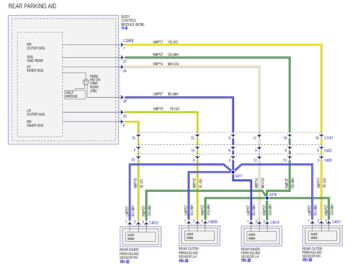

There is (1) more connector C422 we can try to (Clean & Reseat)
and one more possible source (avenue) to get the FCIM to power.

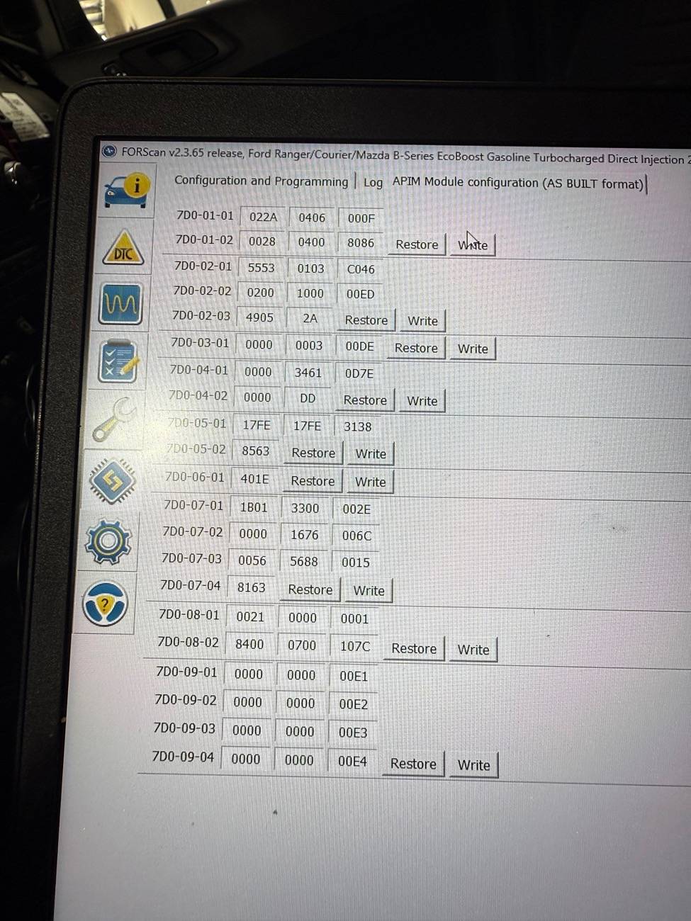

With the APIM being programmed by 4D Tech and it is needing the As-Built files to match the added FCIM - it is possible Ford wiped that programming back to stock and MAY be the reason for the FCIM not powering as the APIM may be set incorrectly - Note there is not a VIN# in the APIM but the settings may have been changed.
Since you are able to communicate to the APIM.
Post the APIM As-Built data you have so I can see if anything stands out as incorrect.

C422 Connector Location
Pins: 31 - 32 - 33 and 34 are the MS-Can bus wires that feed the Tail Lamps and then back up to the C211 connector which you already reseated.
You do not have BLIS, but you do have the TRM (Trailer Module) that uses the can bus data feed.
You are able to communicate to the TRM, but it is also reporting a (Config Not Complete) Msg

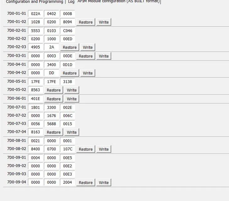

Here is the APIM as built file:

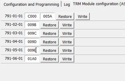

I do not see anything that stands out in the APIM, but one thing that is odd and it keeps showing up and that is the code for the TRM.
Its more of a shot in the dark, but it may be possible that if the TRM is not programmed it may be blocking the passthrough communication on the data bus.
That code means that its not communicating or its not programmed with the As-Built
All TRM's are the same across all trims.

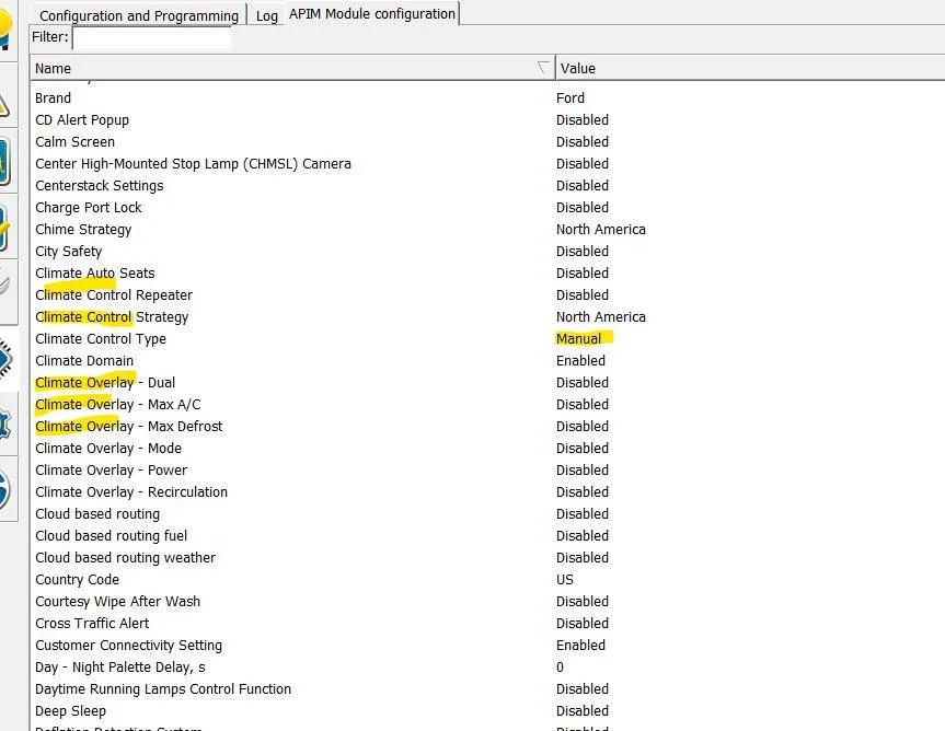

Should match the below settings.
If you can view this and alter if not set, then this confirms that you can communicate on the Can Bus up to the TRM and we only need to T/Shoot the Can Bus Wiring between the TRM & FCIM.

So my TRM showed differently:
So I should update 791-05-01 to "019F' instead? Is there something I should look for to change if it works?
Leave it as is - I did some digging and found some TRM's with that (009E)

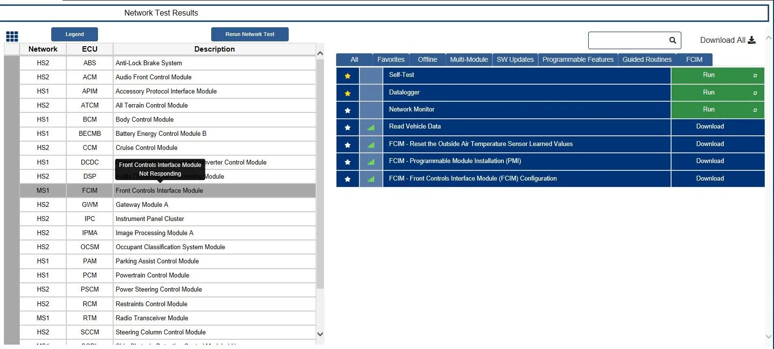

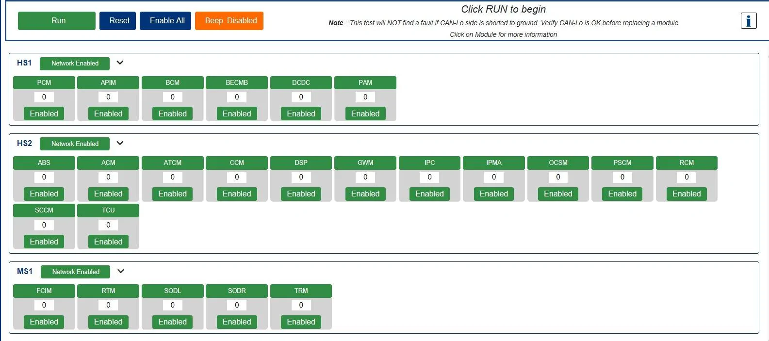

Since it appears that the FCIM is getting power to it, as the Forscan Run shows it sees the module, but the DTC (Message) is telling us that its not communicating. (Data Bus)
I would also clear all the codes again after all modules were reconnected, so you have a fresh set of codes to look at.
I know FDRS has the software (Data Network) that may be able to Force a data message to it to turn it on. (Power it up)
The Good news is that you can get 2-Day use ($50.00) of FDRS the bad is that you must have a approved cable (J2534 Passthrough) compliant to actually connect such as this being the cheapest available or use a cable like my Topdon scanner has (it works with FDRS)
I only played with FDRS out of curiosity just to see what it can do over my scan tools.

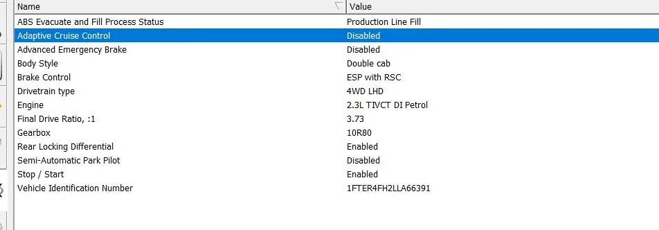

This is a screenshot of my truck running FDRS, I did not dive into this to actually see what the Data Logger can do.
I am assuming that you can at least see (view) the data message code or view the pulses on the data bus (for Ignition Switch Position) and this feature tool will possibly help in seeing what is actually happening on the bus, Forscan will not go this deep.
So, the fist things to check (verify) is are the wires good up to the FCIM and is the (Internal) resistor in the FCIM (Good)
If both of those are good then its most likely the VIN# Mismatch that is blocking it from powering up.
I cannot find any documentation on how to force power on the FCIM, that is controlled by the Can Bus without possible damage to the FCIM or Can Bus, so we need to at least eliminate things that we can do - Wire Checks and Resistor Circuit Check.

Ref: FDRS Screenshots
Note:
Read Vehicle Data - would possibly show the VIN # , if FDRS will connect to it.
The Data Logger & Network Monitor may also help in forcing communication to the FCIM

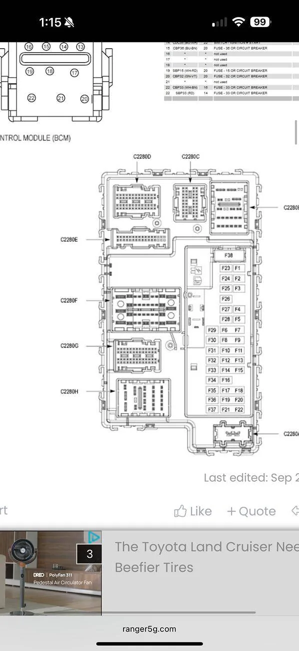

The Point I need help with is - We have a constant power source:
Is that power source a constant ground?
Or
Is it a switched ground? from the (ISP-R) signal?
and can you use that Power & Ground to force the FCIM to power? without damaging the FCIM or the Data Bus (Terminating Resistors)
Sorry, but this part of the Can Bus is where I am lost, and I am thinking that the Power & Ground are constant on the PCB and the data transmission closes the power supply circuit (Internally) via micro relay pulse from the (ISP-R) signal.
Hopefully one of you can shed some guidance for me in understanding this circuit control.
Plus with FDRS and a dead module such as the FCIM can one of the following (force power) to the FCIM if it will not load up (in the module) load via Forscan.
I guess the most important question is the (VIN#) can it cause it not to power up or will it throw another code?
As this would also shed some light on (Possibly) getting an (salvage yard) FCIM and plugging it in , and then use Forscan to Program the (current truck VIN # to it) or will it block the communication?

With your (Scan) reports - I see the TRM has a issue of (Not Updating) but it is reporting on the bus.
The TRM is the silver-colored box just forward of the C211 connector, it is mounted under (behind) the TCU.
I would try disconnecting the TRM and then try clearing the codes and see if the FCIM will awaken.
PLUS: I would try - Creating a NEW profile when you load Forscan as this will force a (New Scan) for installed modules to see if the FCIM will populate in the Scan (run) as when you get to the small pop-up when you hook up - it asks you - Load New Profile or use Existing Profile that you named.
If you use existing - it is only going to load the modules it picked up when the (Existing) profile was loaded.
This is (one-drawback) of Forscan vs a Scan Tool, if the module was not picked up with the initial scan it will not pick up that module unless you force a new scan for modules, vs a Scan Tool will scan all available modules.
Note:
I understand PMI = Download installed module (As-Built) and reload that to the new module.
and
Configuration = Download (As-Built) data from the servers and then load to the new module
however this case is slightly different (Non-OE) modules to get around and the As-Built will not match.
So in this scenario- is it possible to load the (OE) data then use Forscan to alter the settings on a (non-OE) module, as it is now the FCIM for a 8in screen and dual climate vs the 4 in screen version of the FCIM.

It appears they programed the APIM to your VIN# to match the (OE) APIM, so basically it is set the same as the one you had originally installed before the (4D-Tech) APIM.
I can see why the Climate Repeaters are not working as they are all turned off in the (New) APIM.
I suggest you go here:
- FordServiceInfo.Com
Input you VIN# and download the (As-Built) Files that were all set when it was built.
Save the File as a PDF - for easier viewing
I think you will find that the (NEW) APIM is going to match the (Downloaded) As-Built Files.
Note: Using the above website, you can go to any online Ranger for sale and obtain the VIN# and then type that VIN# in and run a As-Built file on that one, this gives you a side by side compare for any truck vs yours.
I use either the F-150 (Forscan) spreadsheet or Cyan Labs (As-Built) file database for a breakdown of all the (Hex-Data)

But you can use the information to see what all the (Hex-Data) lines actually mean

My only (Unknown) is - Will a VIN# mismatch cause the FCIM to reject the (ISP-R) signal to power up and block it, or will it allow a power up and throw a code for VIN# mismatch / invalid data?
So most likely the FCIM itself is bad and the above (Unknown) question comes into play for how a replacement FCIM (from a salvage) yard will work.
Will it power up to allow you to program the (As-Built) files (VIN#) to match your truck or will it be the same as you have not (Not power up)

As, when you do a side by side compare, you will note that the (NEW) APIM has all the climate control settings to (Single) - (Manual)- and repeaters turned (OFF)

Hey, so I think I may have found the issue, but wanting to check with you before I go down this rabbit hole, in my passenger compartment fuse box, I do not have a connected plugged into the J4/2280E BCM inlet, when I was looking up pictures of other 2020 ford rangers fuse boxes, it looks like something should be plugged into there?
RangerBill
Bob
Connector C2280E has all the wiring to your rear parking aid sensors. Do you have the sensors in your rear bumper? If not, then there will not be anything plugged into that connector, unless you have keyless entry sensors on the doors.
Got it, so if I don’t have rear parking sensors (I do have a rear camera) there wouldn’t be a connector?
Also I went through the list of things that were replaced electrical wise and the list shows “Wire harness engine compartment 4WD”, was replaced. Could there have been an issue with replacement of that, that could result in issues with the FCIM/HVAC?
I also didn’t mention this before I don’t think, but I replaced the battery last month, and the even with the truck shut off, the battery has drained and now I have to have it connected to a charger. So I’m not sure if that provides some additional potential issue of something else that is what is then resulting in the HVAC/FCIM issues?
The only other use for that connector is for the four dour handle sensors for keyless entry, if you have it. If you don't have any of those options, then the connector would not be there. The battery drain may be normal if you are not driving it regularly, or only using it for short trips.
I appreciate it, could there have been something with the Engine Compartment wire harness being replaced?
