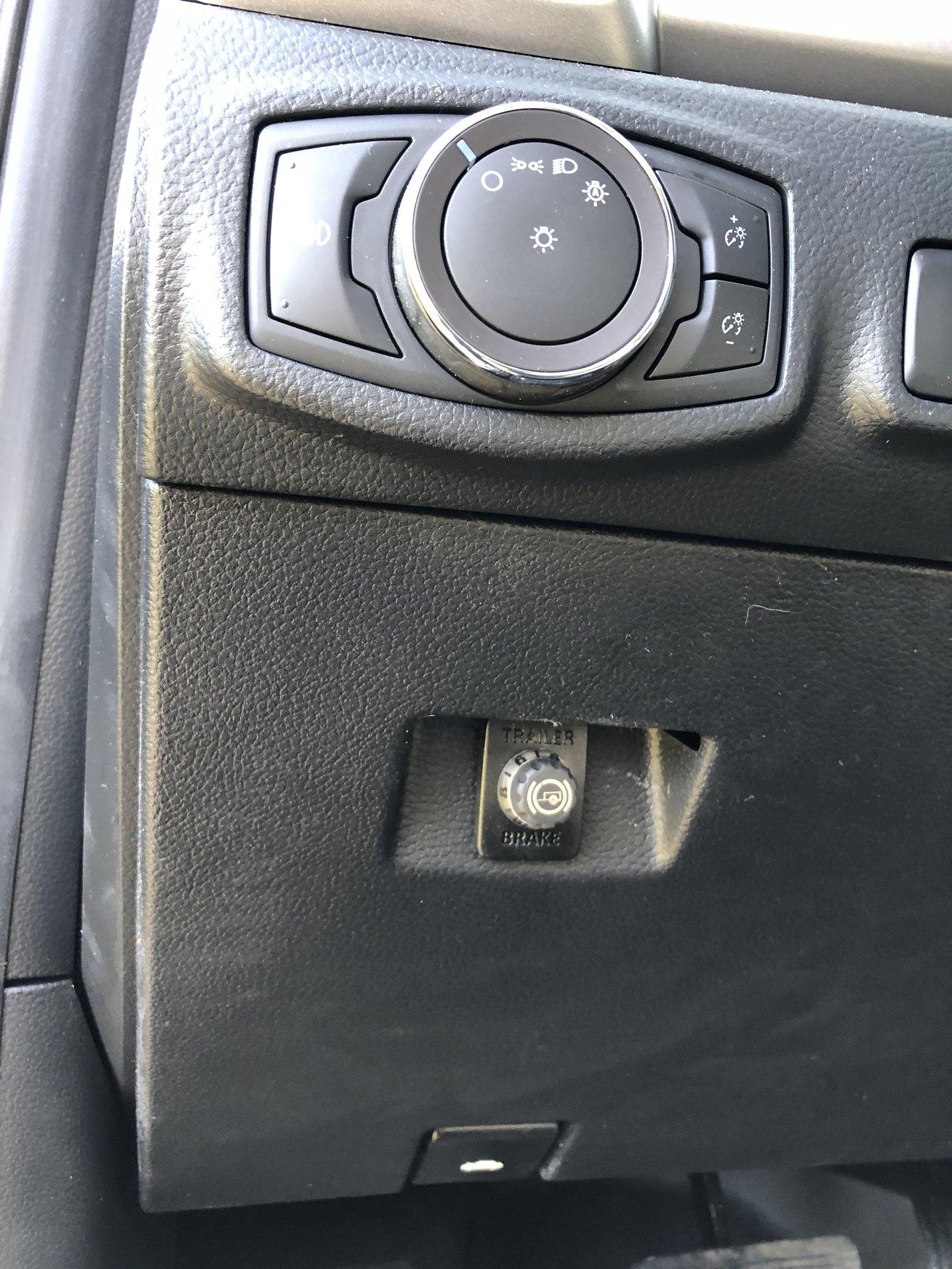

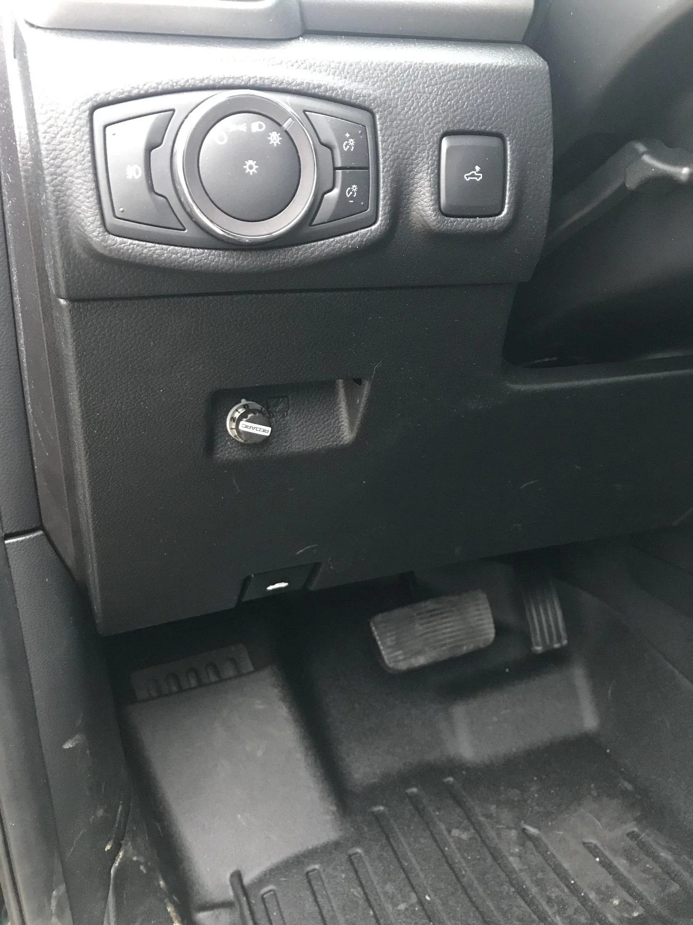

I'm curious whether that's the prescribed location or if the installer just got creative.
That panel (obviously) opens for the fuse area, using that pull indentation and the distance to the four wires for after-fit brake controller is only a few inches away, coming through the firewall right behind that panel, above the driver's left foot rest. Easy to find as they're taped up with blue tape and capped with shrink tube. That location is merely simplest, easiest, shortest-distance-between-two-points place to mount the button. I installed my controller just to the right of the indented pull. Personal choice of ergonomics.
Installing the RedArc button in the center console involves more shop time and is fussier and thus more costly in labor.

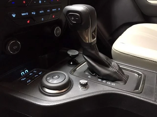

Pre-launch pictures from Ford had the redarc on the center console, and I personally thought it looked a lot cleaner. Install time from a dealership for something like this tends to be flat rate. Hence my curiosity if the directions from Ford say to put it on the fuse box, or if the installer is taking a short cut. If I were to pay dealer rates for the install I'd want the best possible appearance and wouldn't want to see shortcuts. (Whereas if Ford actually says to put it on the fuse box I guess that's just the way it is now.)

Placed my Redarc on the console. It is super easy to adjust and you can see the LED to make sure it is active.

Good thing you didn’t install your controller yet. Those are some funky instructions. I like most others here mounted the Redarc, ran the four colored wires over to the driver kick panel, found the 4 wires taped off with blue painters tape and was done (except for mounting the controller- I took the easy way by mounting the box under the steering column and the controller where the pull is for the under dash cover. Done in45 minutes, including making up a loom with plastic conduit and zip ties. Hate to say it but those sound overly complex.
