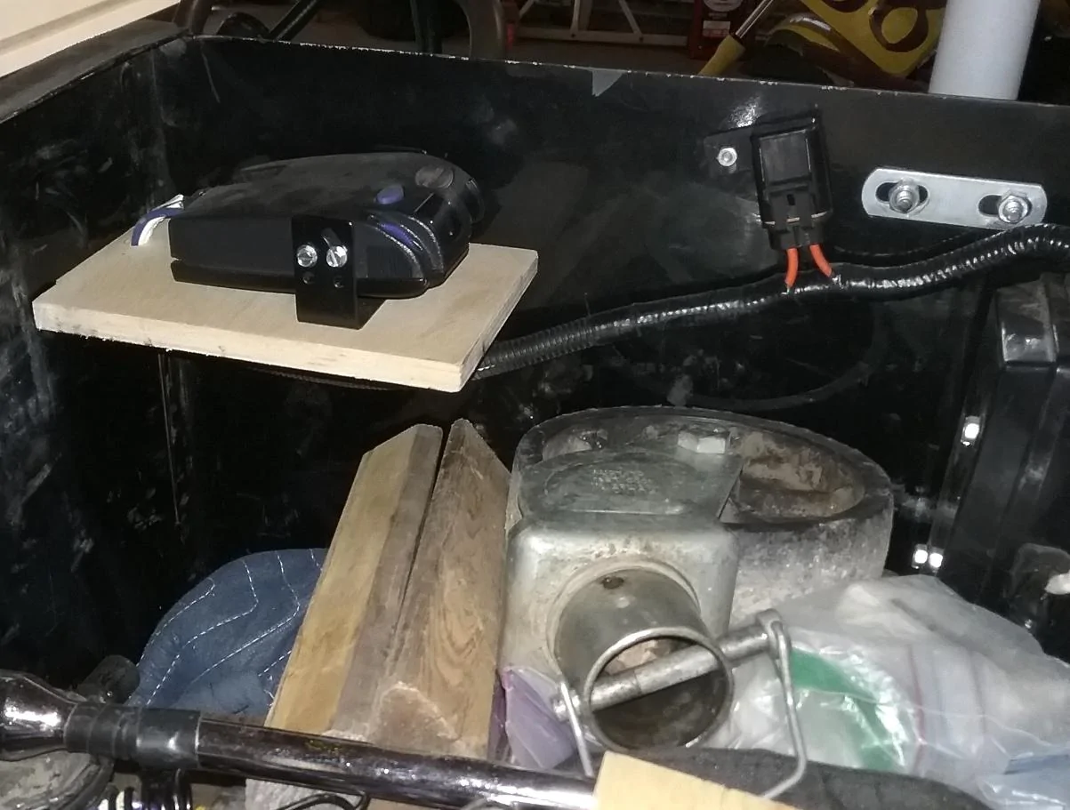

Still happy with my control module mounted in the trailer's tongue box. I just use the signal from the brake lights & the factory 7 pin harness connector for a signal & run it into the module. The rest is just regular wiring from the battery to the brakes on the axle. Still works fine, no controller to bang a knee on or get in the way on the dash. "0
" problems towing this way.

Most places require you to have a manual brake override, which is pretty handy sometimes, I would also test that the breakaway still works properly with the setup like that. Otherwise looks like a good setup.

The break-away system remains intact & functions as it was installed & designed. It's powered by the group 27 AGM battery in the galley & the back-up battery in the tongue box, which is the part of the normal electric brake system. The extra battery in the galley provides trailer power for all systems, so I just wired it into the brake system in parallel. It ends up being a redundant power system with its own charging system (the 100 watt solar panel). The only thing I don't have access to this way is the added braking available by having the controller in the cab & handy.
To me this is a double edged sword. Yes, you can reach down & manually fire the controller for an emergency, but is that a distraction when in a stressful situation, like a cell phone ringing? Mine is set to run the brakes for keeping the trailer straight while braking. The controller was set on a gravel surface to not lock the trailer brakes. To me a $600 dollar controller is absurd when a $70 controller works just as well.

Agreed on most accounts, the only place my opinion differs is in a sway situation you would be able to grab the brake lever and straighten out the train so to speak.
whatever works for you.
