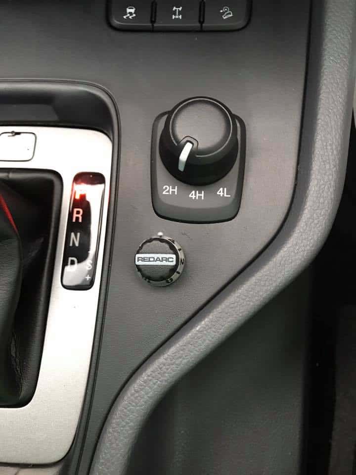

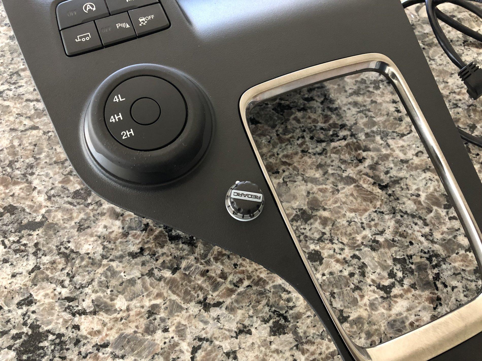

Correct. Does anyone have and option/picture of another location for trucks with 4WD?
This is from Post 74 from the Redac Install thread that is stickied in Towing and referenced in the previous post.

I posted the RedArc installation guide for Australia somewhere on here, it shows exactly what the picture above shows. My guess is we will get exactly that document with the images mirror flipped and Ford logos where the RedArc ones used to be.

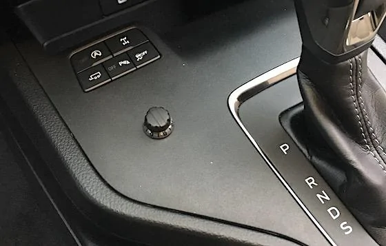

Found this today, more than listed at SEMA
