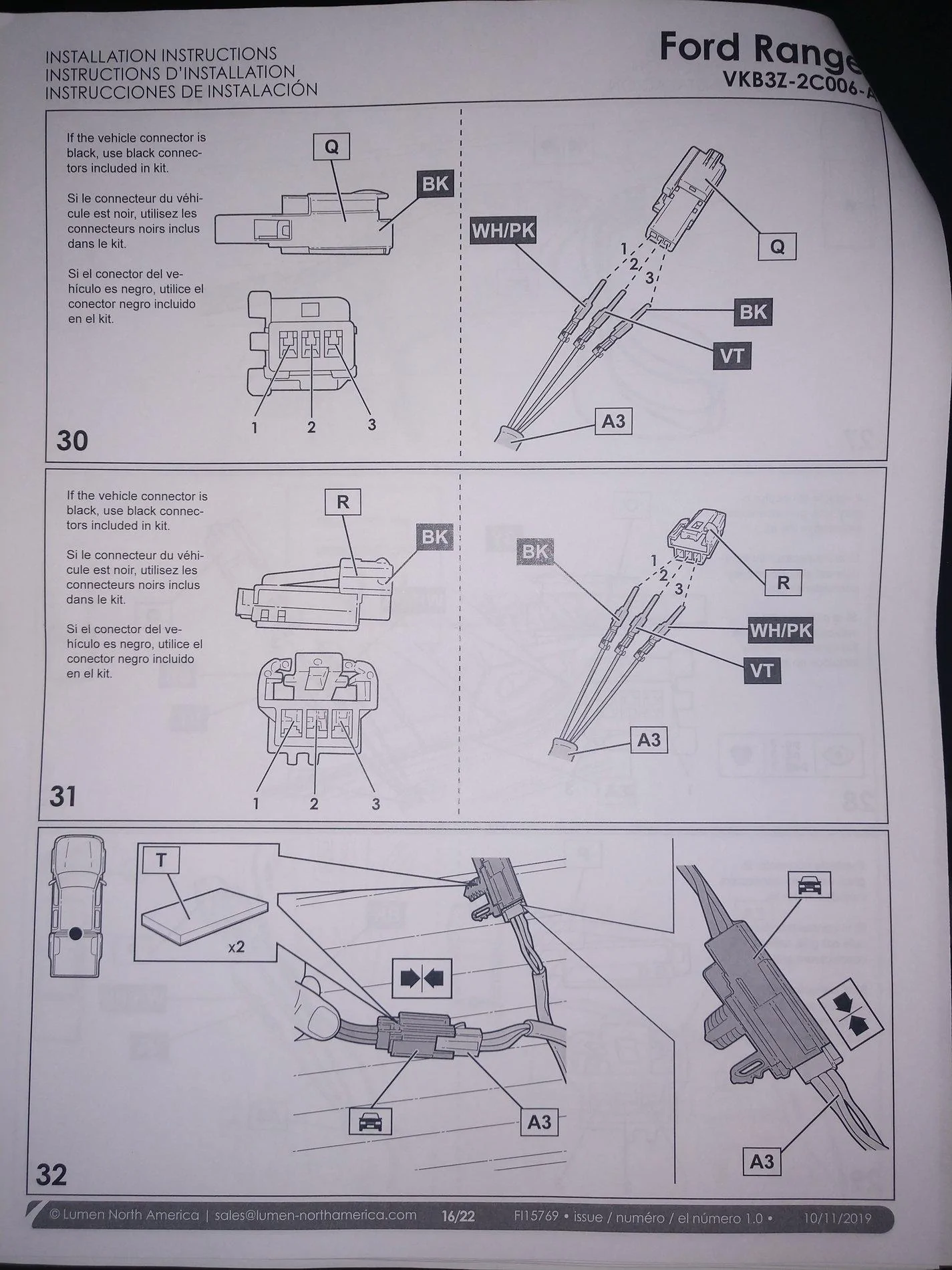

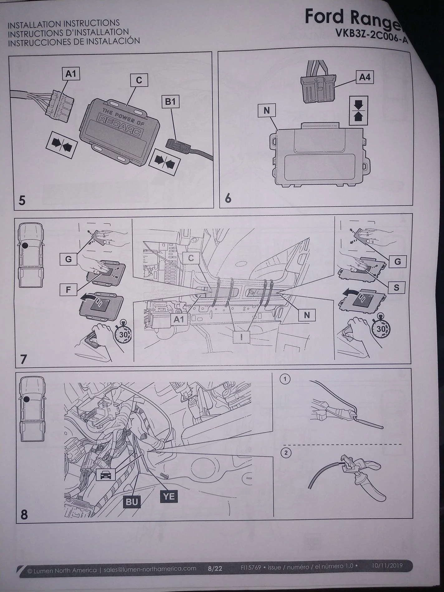

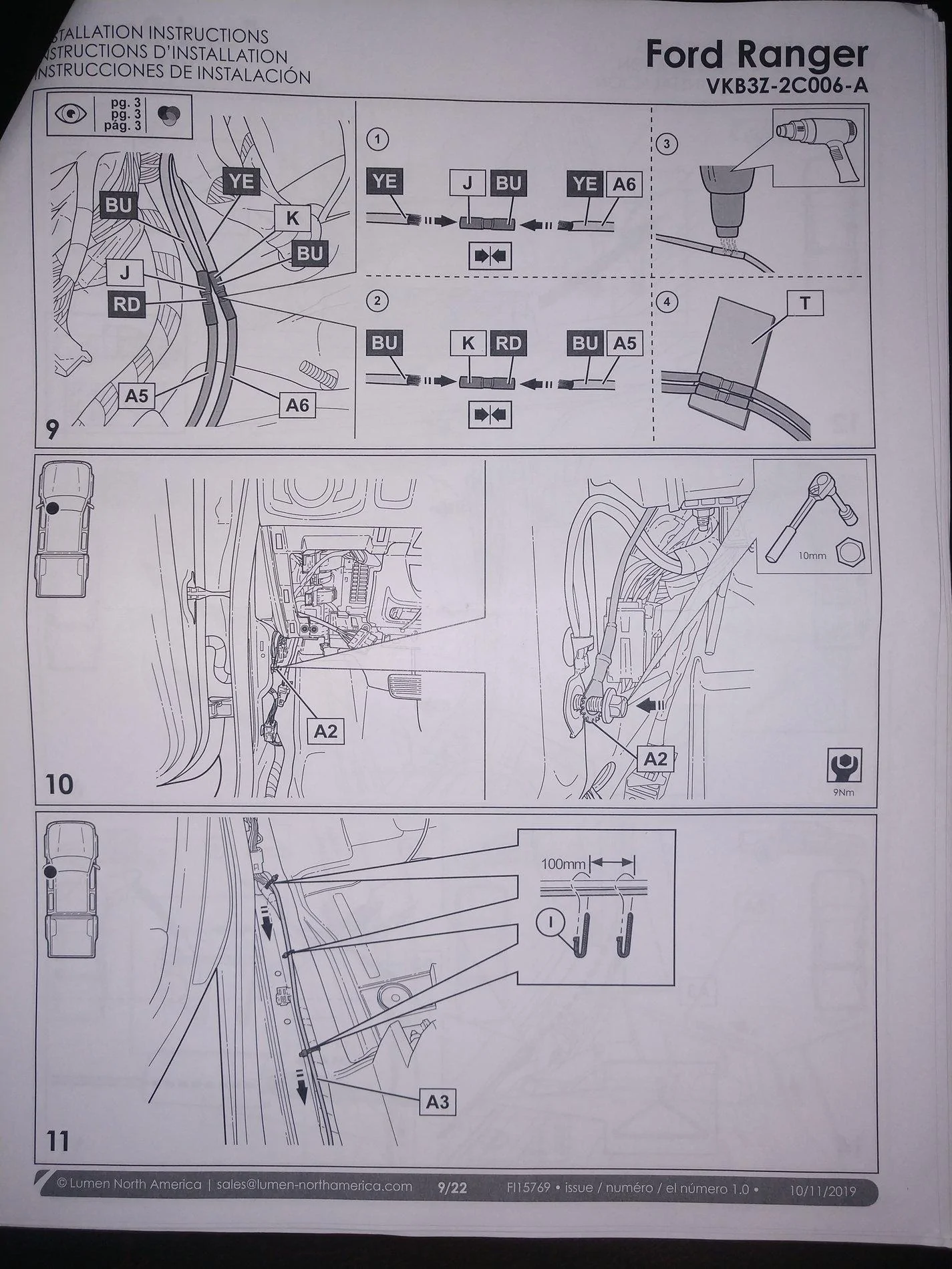

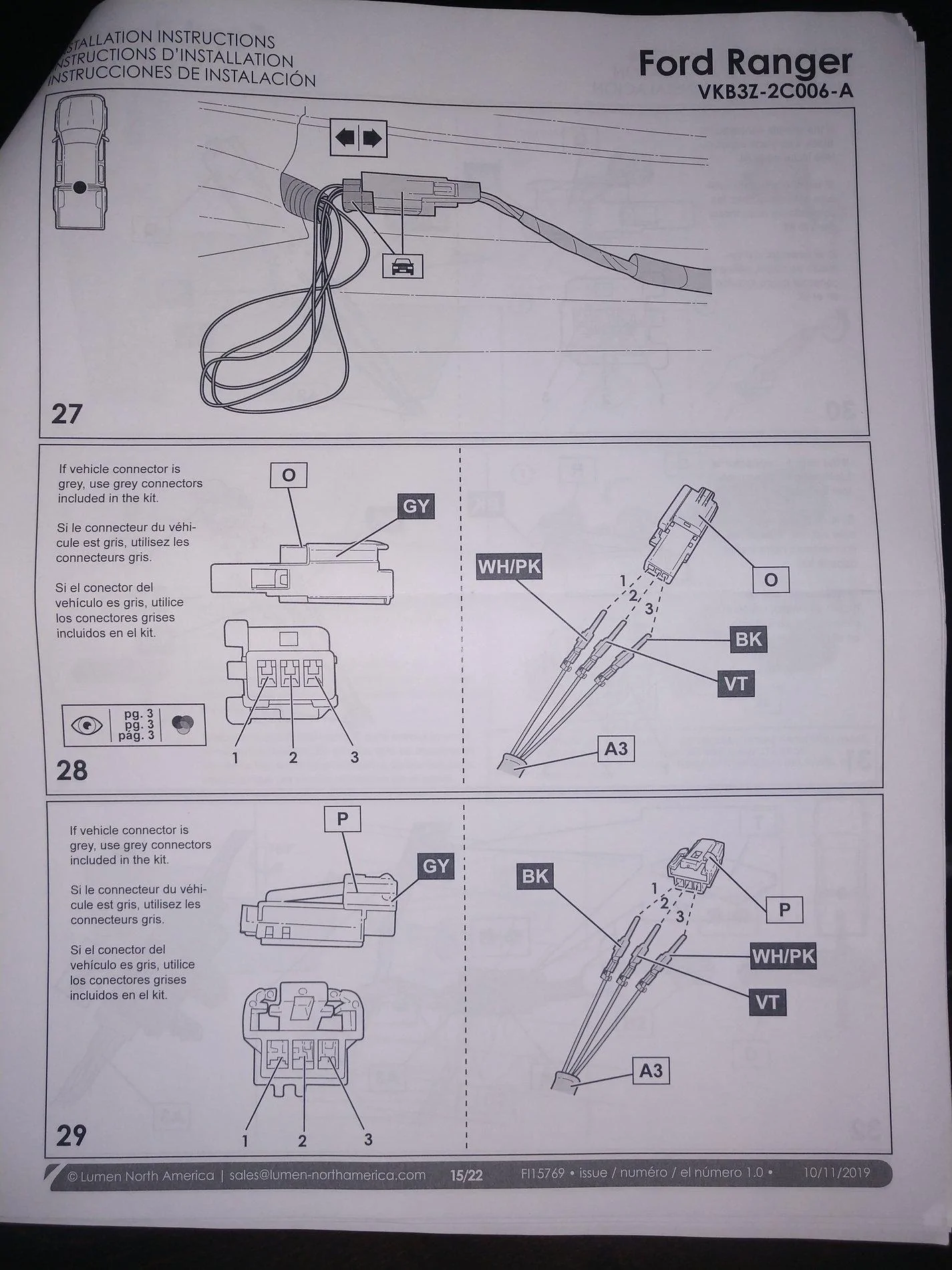

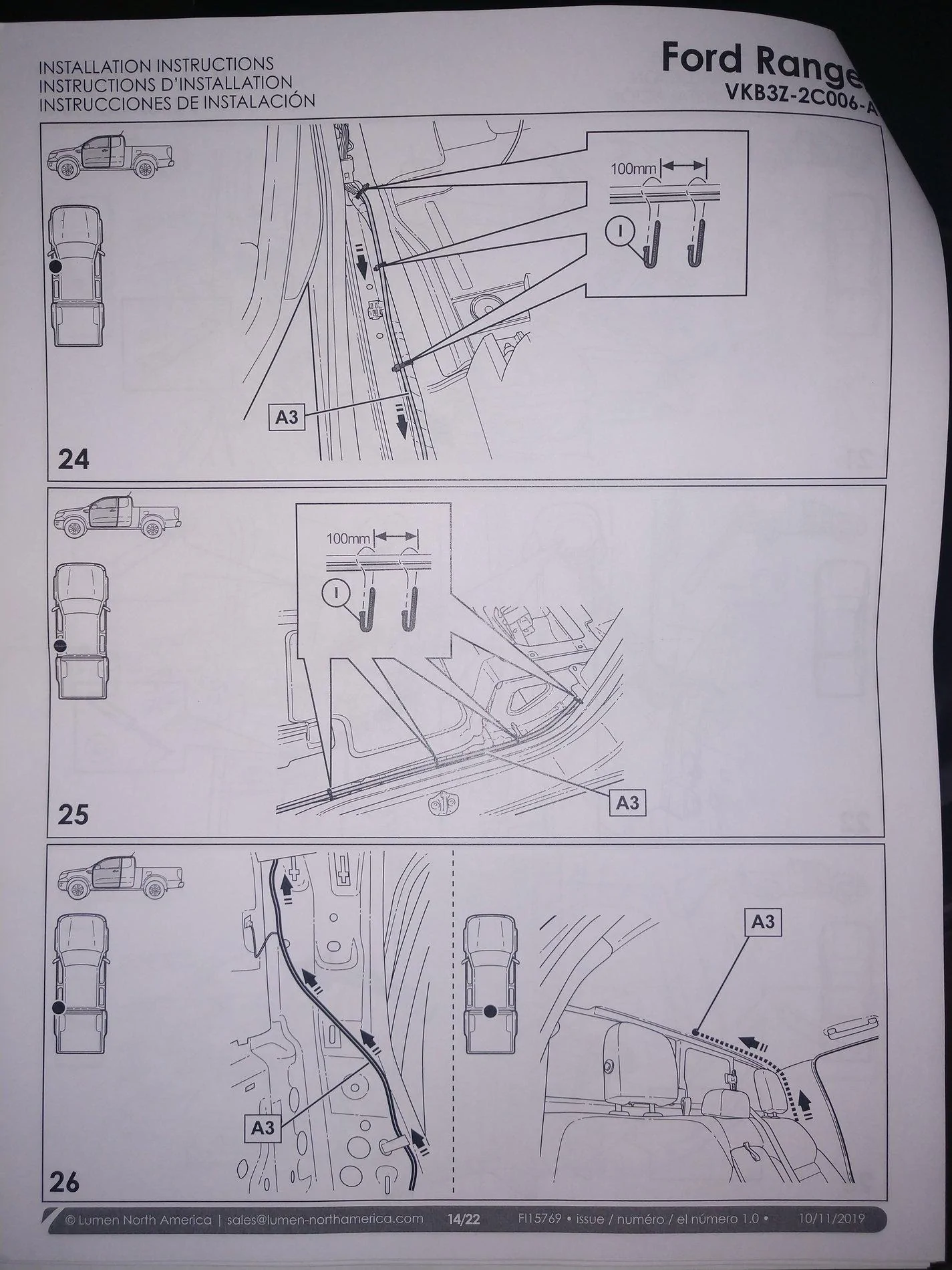

I just received mine, the instructions to install do not use all of the pre-wires, just the Blue & Yellow. This interesting thing is that you have to run and tap into the high mount brake lamp. The set up uses a separate electronic box in use after the Redarc control box.
Did I read this correctly that those stupid bastards at For (No offense Phil) installed 4 wires for a brake controller, then determined it was unsafe to use, so they have their installers tap the high mount stop light and capture a ground from another unrelated fastener somewhere in the footwell? Now I've seen it all.
First time someone gets killed because the brakes go full retard, I'll be making popcorn to watch the class action lawsuit.
My guess is that the extra box gets a signal from both the Autonomous Emergency Braking and the brake pedal input, and sends which ever one it receives to the brake controller, whereas an aftermarket unit will only get the trailer activation signal from physically pressing the brake pedal.
If true, that means that if the AEB kicks in, then your trailer brakes will not activate properly until you realize you need to brake and hit the brake pedal. If the AEB only sends a pulsing/flashing signal to the brake lights then that's what your trailer controller would see unless the extra box magically transforms that into a solid signal.
Fortunately, I always allow extra distance in front of me, and if the AEB did kick in for some emergency reason I hope I would realize it quickly enough to actually apply the brake pedal myself.
