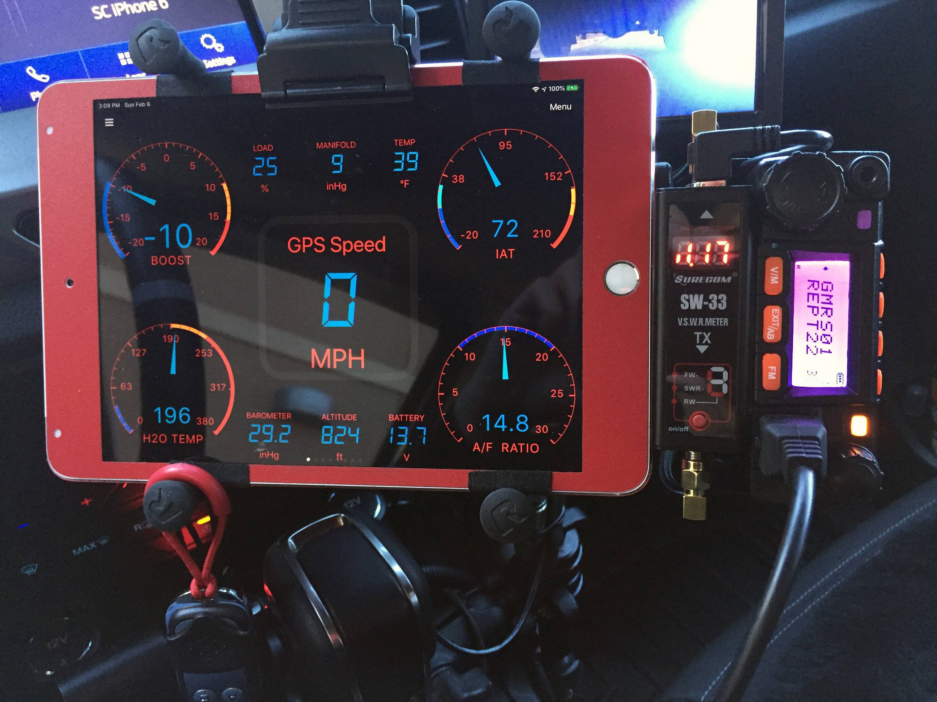

I disabled ASS with Forscan and use the OBD for more useful info...
Wow Sid, I think the electronics are starting to take over your Ranger. Not sure if that’s good or if it’s this…

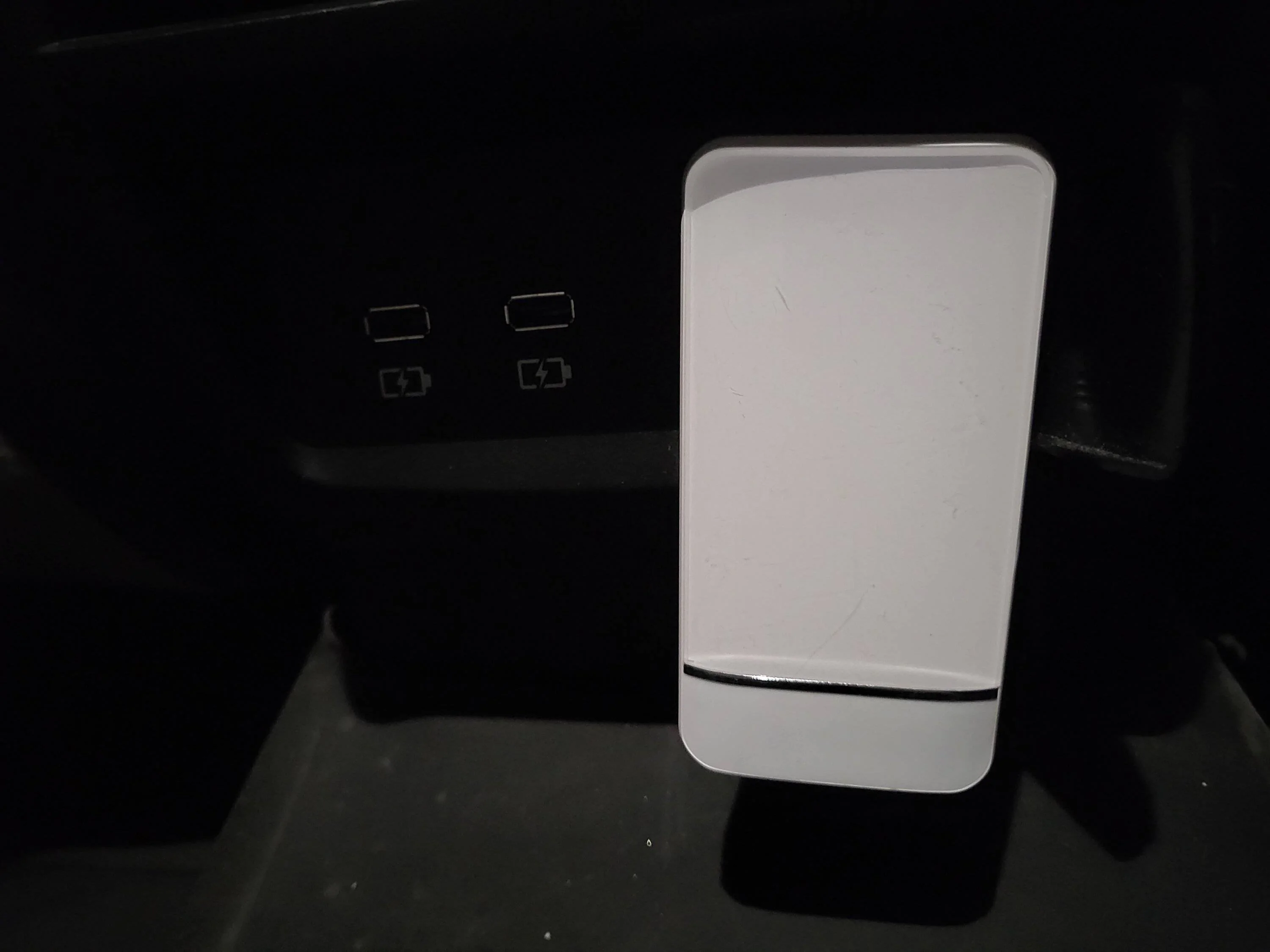

I just push the ASS button every time I start the truck--for free!
Sure...sometimes 10 times a day when running around...hundreds of times a month..I solved it with a $5 nightlight in the 110 recepticle.
BladeRanger
Bladimir
May 16, 2020
907
2,267
Escondido Ca
Ranger 2020 XLT FX4
Electronic Engineer
How long does it stay off after truck is turned off? Any battery drain issues?
This is the nite light I used, got it from Costco years ago and can be used as a flashlight as well. No battery issue so far and had it plug in for almost 1.5 years.
