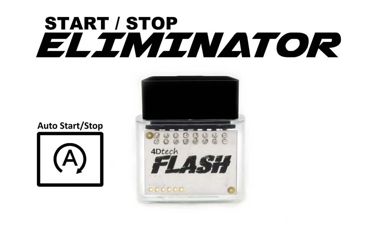

Did some research on Disabling the ASS. I know there's some other threads on this but couldn't see where the 4DTech item was mentioned. So, after researching it decided to order the Version 1 ASS Enabler/Disabler for my '22 XLT.
Received it in the mail today. Started up the XLT with the ASS Enabled and plugged the device into the OBD port. Started out the programming with a confirmed Violet light to confirm initializing..........then turned flashing blue to confirm programming..........then turned a solid green color to confirm was finished.
Took the XLT down the street for a drive........came to a stop.........the grey icon on the display came on but the engine did not shut off. Took off from the stop and the grey icon disappeared.
Total time for programming was under 1 minute.
You can plug in the device and revert the programming back to OEM setting at any time.
Here's a link to their website and a video of their install which was spot-on!
https://www.4dtech.com/ford-ranger-19-22-start-stop-eliminator/

Seems easier to use than getting into the console.

That's what I thought before ordering it. Didn't want to tear the console cover, shifter cover and then try to get a small hand in there to plug/unplug anything. This was very simple and took less than a minute!

$100 to the same thing you can do in Forscan with out the benefit of what else you can do with Forscan.

Forscan disables ASS in exactly the same way.
I assume this device just does the same OBD-II operation that Forscan does to disable it. Good to know for people that don't want to muck/deal with Forscan.

I also went with the autostop eliminator even though I have used forscan quite a bit now. Id rather leave the battery monitoring intact on the software side, but thats just me. Something like this works too if you dont want to pop up the center console trim.

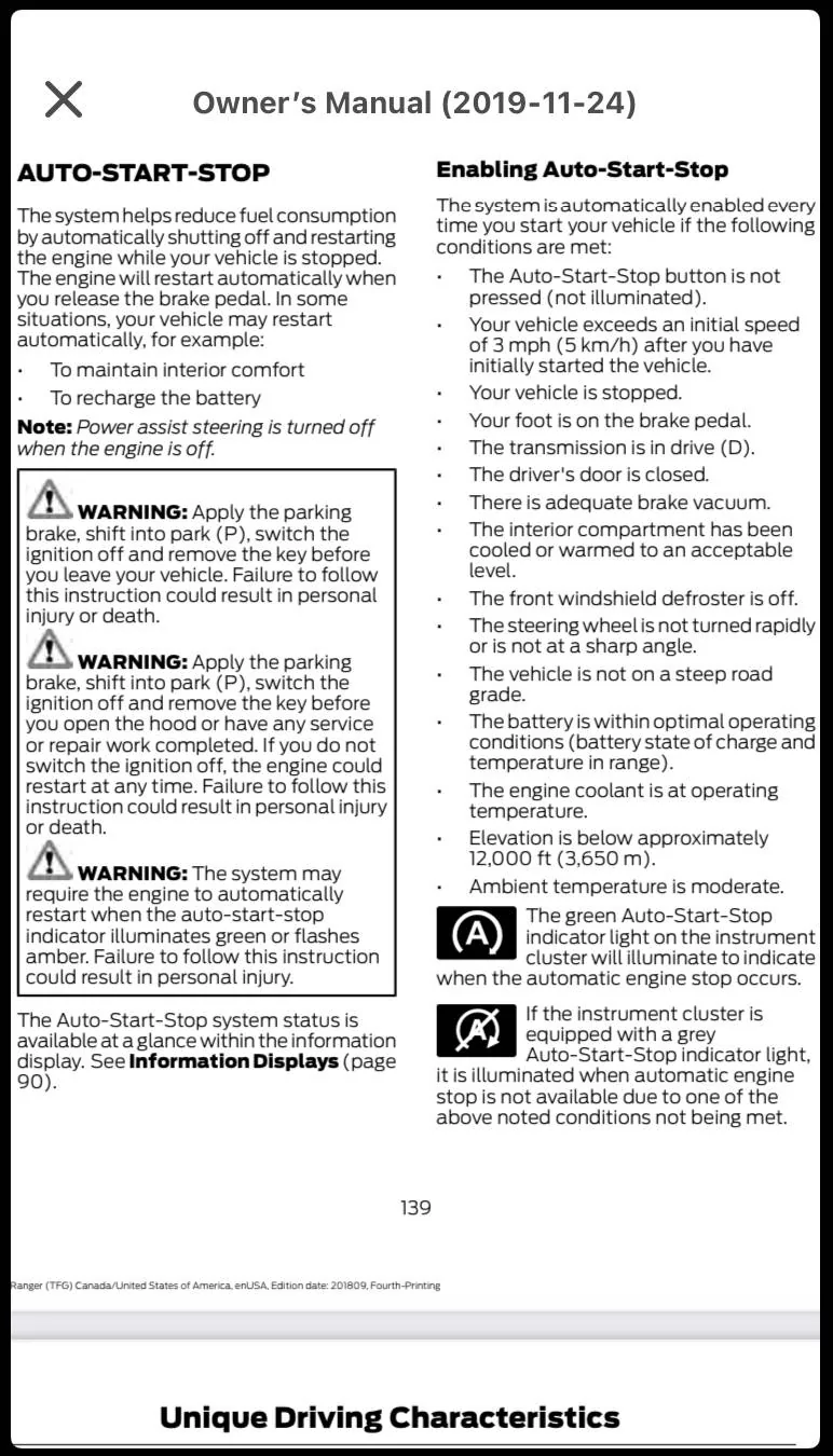

The ASS can sometimes be your “canary in a coal mine “. When the canary isn’t chirping, that can be bad.
There are certain conditions where the BMS wants to keep the truck running and prevents ASS from turning off the truck - Defrost is on, Max A/C is on, something is plugged into the 120V outlet - here’s a list of the conditions that must be met for it to be on.
If the ASS is not engaging, it means the truck wants to provide power to systems that are running or keep charging the battery - usually nothing to worry about.
However, it could also mean you have a battery or alternator issue, trouble with your climate control, or even a brake vacuum problem. Folks who drive in S mode or use a night light to “disable” it, sometimes unplug the light or drive in D for a short trip just to test that their ASS is working as it should.

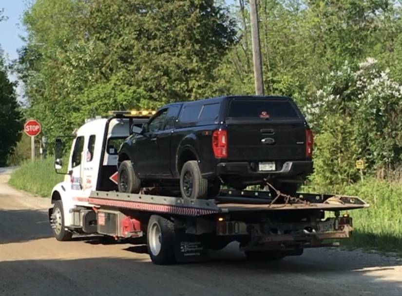

If your ASS is not engaging, check the obvious items but if it persists after checking, you should see your dealer - bad batteries have been noted on this forum. Ask me how I know…
