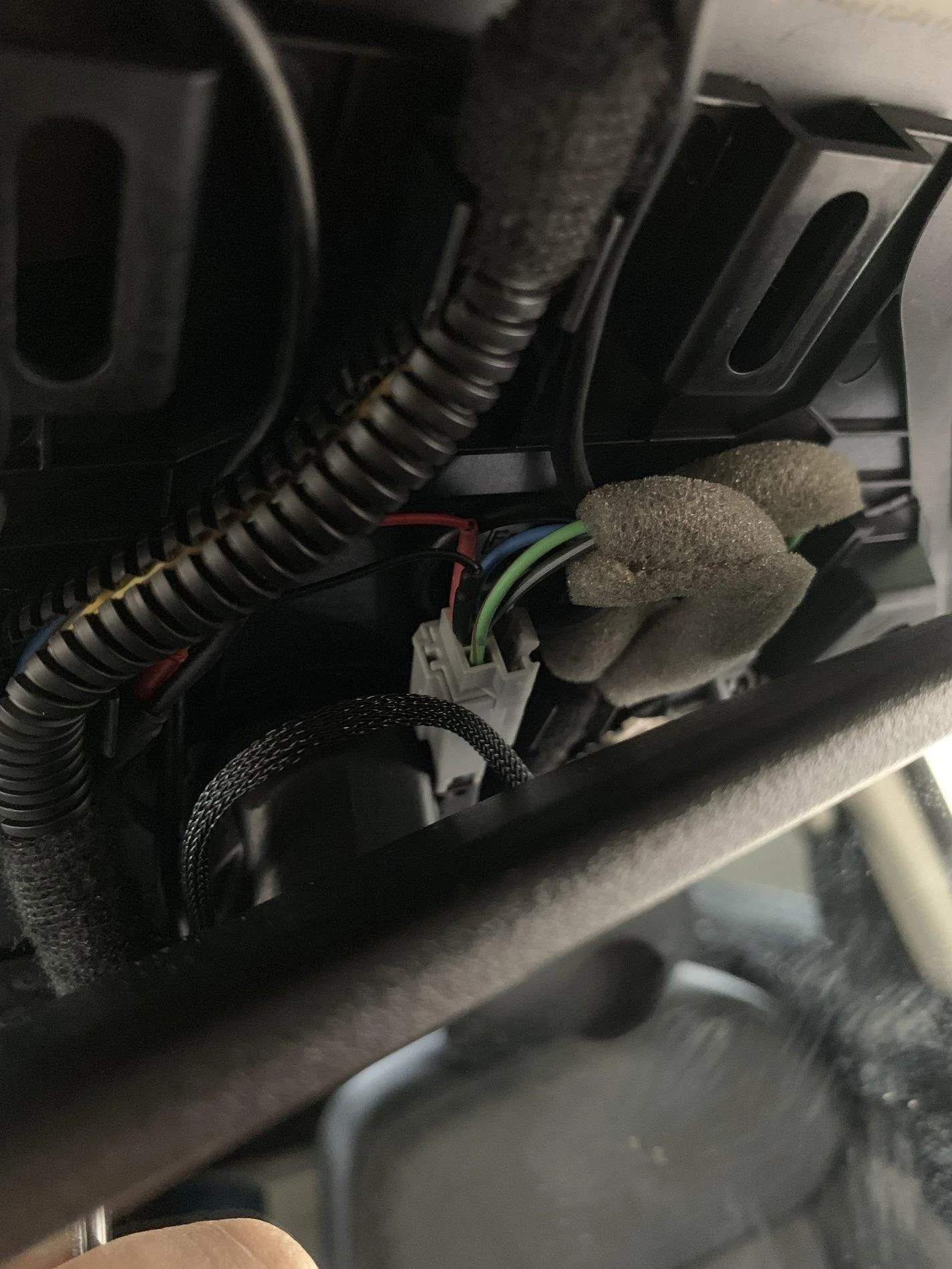

I've got a Lariat so I'm not sure if you have the same harness behind the mirror, but from my post above you can see the gray harness that I tapped into to get switched power and ground from. you can see the red and black taps in the photo below.

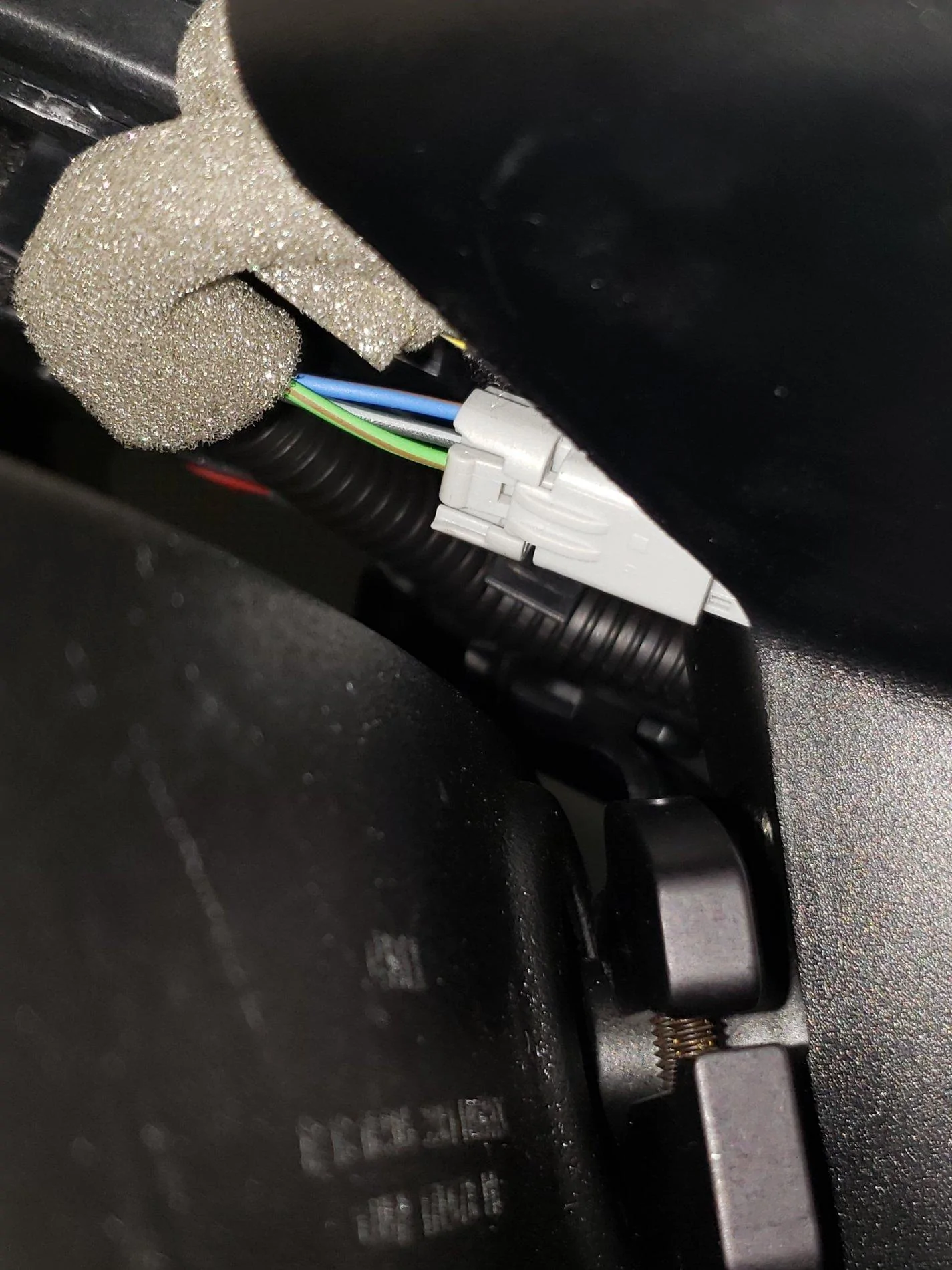

Not a problem, we're all in here to help each other. If you have this Gray three wire plug, you can tap in to the blue wire for switchable 12v power and black for ground.

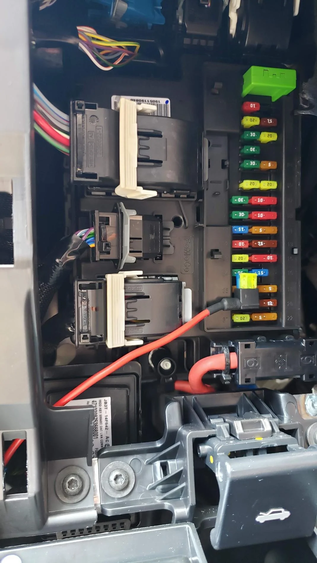

If you don't have this, you could purchase these and use a fuse tap to get your power. Like in the photo below. Fuse 36 and 37 can be used for switchable power.
