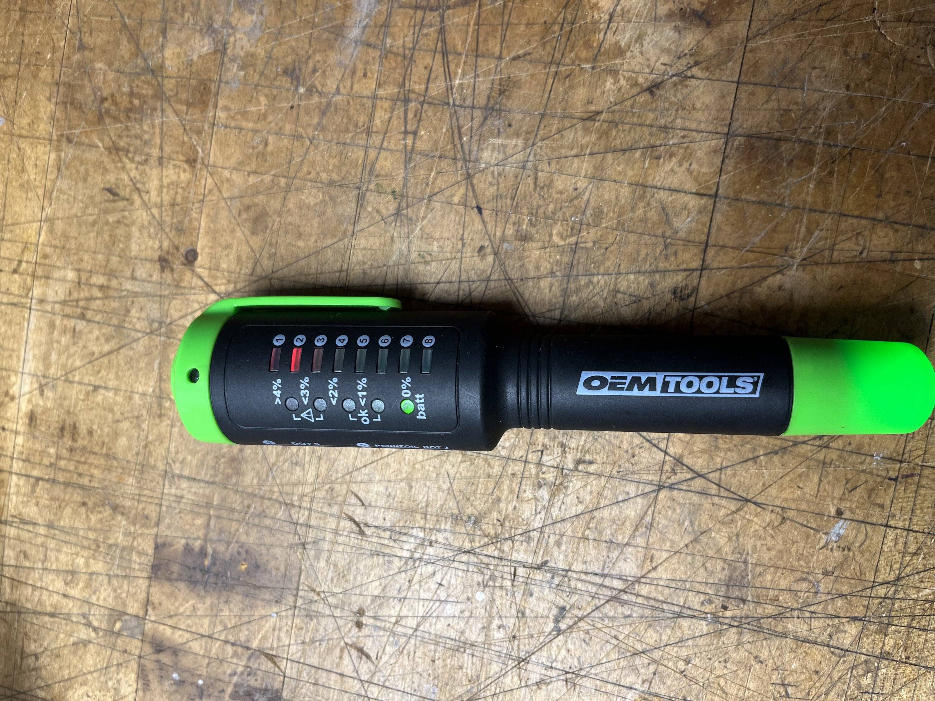

I just replaced the brake fluid today on my 2019 Ranger Lariat. A few hours and $12 for the DOT4 fluid. Truck a few months short of 3 years old with 35,163 miles. I have a brake fluid tester (OEM Tools) and it showed 0% water and the fluid color looked just slightly amber. Its a closed system but most car manufacturers are now recommending the brake fluid be replaced at some interval.
I have done brake fluid replacement on 4 vehicles recently and all fluid showed no water and color was slightly amber.

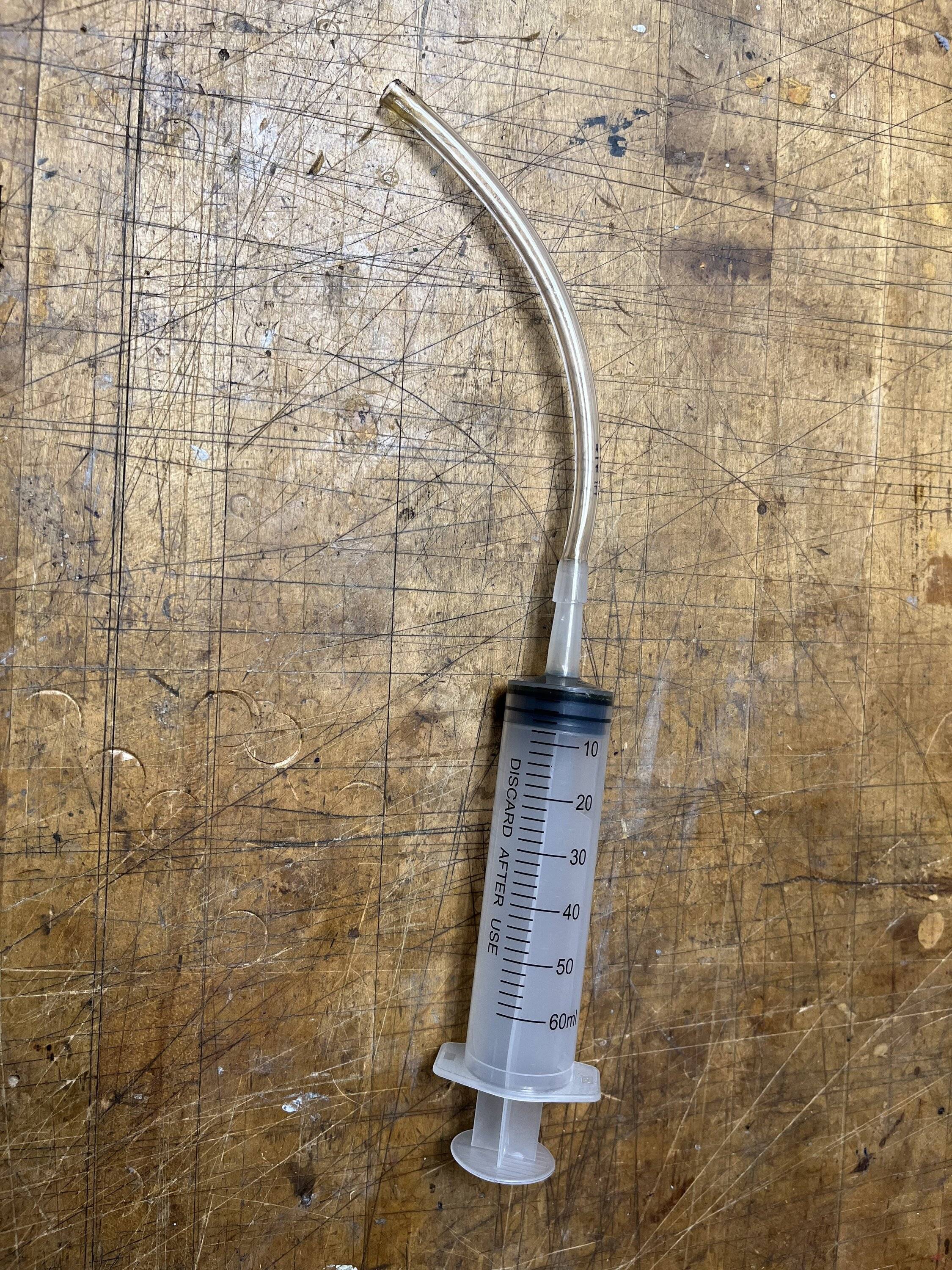

Here’s what I do. With a medical syringe with a small hose attached to it, I remove the old fluid. The Ranger master cylinder has a small hole that I insert the hose into to empty the reservoir. Then I fill the reservoir with new fluid and put cap on.

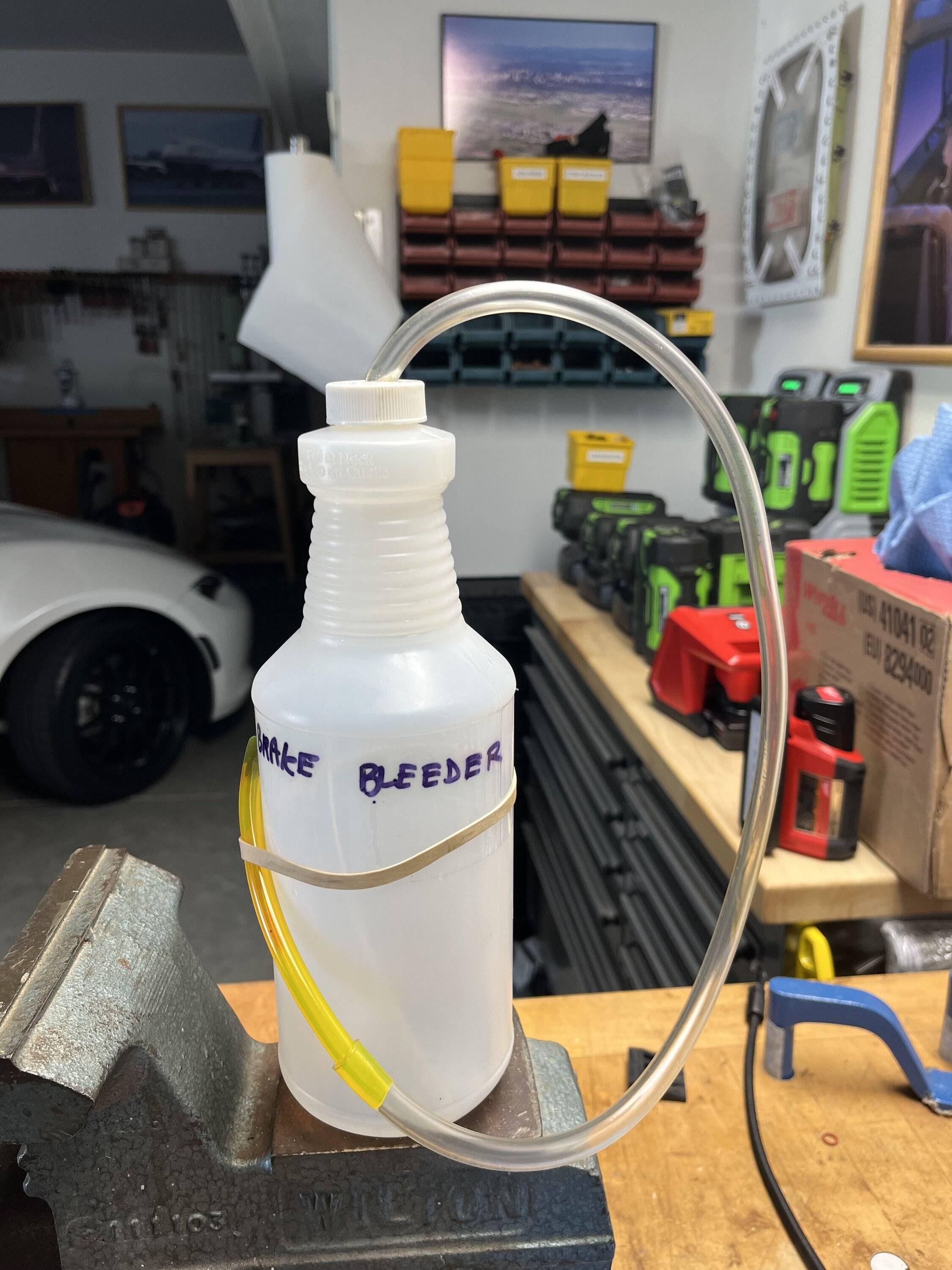

I do a single person bleed using a plastic bottle with some brake fluid in it. Then I have a hose that goes into the bottle immersed in the fluid. Attach the hose to the bleeder fitting and crack it open. The bottle and hose is situated above the bleeder fitting. I glued a magnet to the bottom of the bottle so it stays in place. Then I pump the brake pedal slowly for 20 pumps starting at the RR, LR, RF, LF. This per the FSM. Making sure to refill the reservoir after each brake bled. I used 32 oz bottle entire contents including final top off of reservoir.

rpeterson53
Sep 23, 2019
80
105
Richland, WA
2019 Ranger Lariat, 2019 Mazda MX-5 RF, 2016 Subaru Outback 3.6R
Vacuum pump method does not work well due air leakage into the hose at the bleeder fitting. Sealing the bleeder fitting is a pain honestly.
There are numerous videos on YouTube explaining the single person bleed.

I tested the removed fluid and it was less than 1% per the tool which allows selection of fluid type
