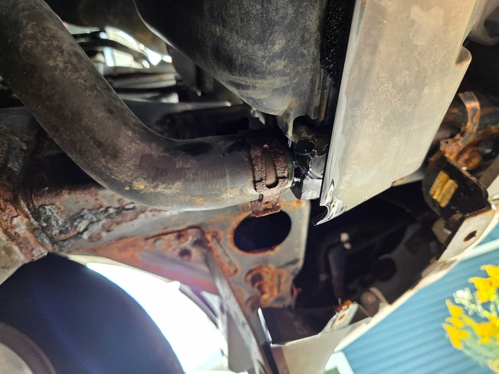

Well finally got under the truck today and pulled the skid plate off, looks like it's leaking at the radiator hose connection. Not sure if I should replace the clamp or the entire hose assembly.

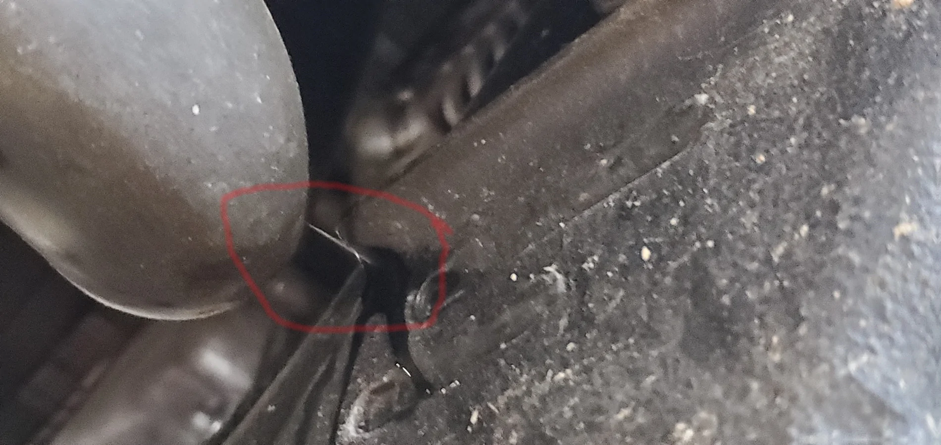

Aaand the clamp broke wtf, you can even see it in the picture. Going to attempt to pry it with something and use a dremel to cut it because it's on there tight

You have quite a bit of rust there on the frame. Looks like the clamp failed because it rusted out.

I think the clamp comes attached to the hose, so it might be hard to separate.

Frame is super rusty, plan to hit as much as I can with a wire brush and fluid film.
Ooff if the clamp is connected that's gonna be annoying, I can get part of it lifted so we'll see. Started storming pretty hard today so will try to get back at it tomorrow.

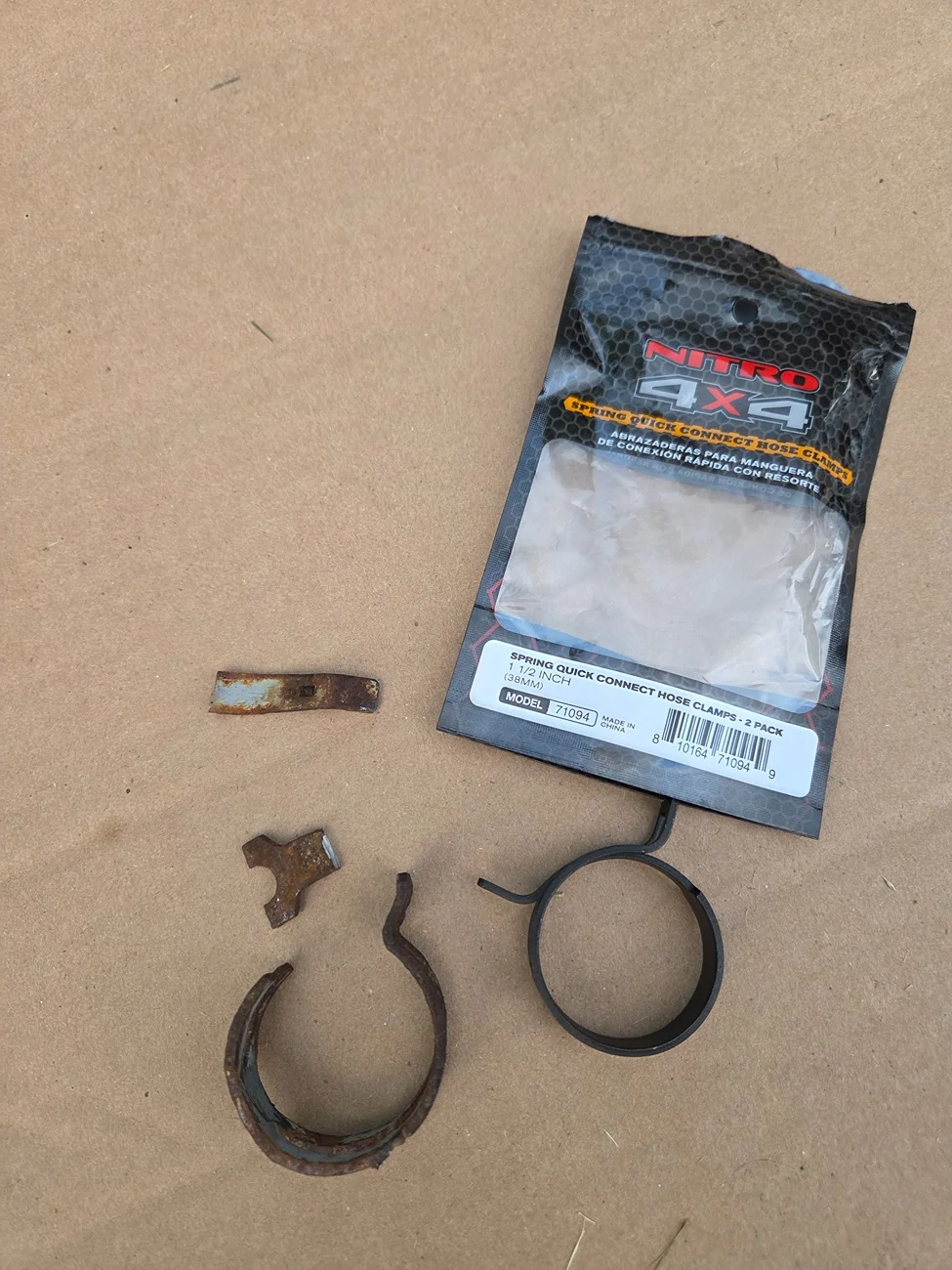

Managed to sneak a dremel in there with a relief cut and and pryed the rest off. Got a new clamp from autozone that seems like the same size 38mm (though probably about time I bought some calipers), it definitely feels a little less heavy duty than the stock one but hopefully it lasts.
New coolant in, ran the bleed cycle and a quick test run on the highway, everything looking and running smoothly.
