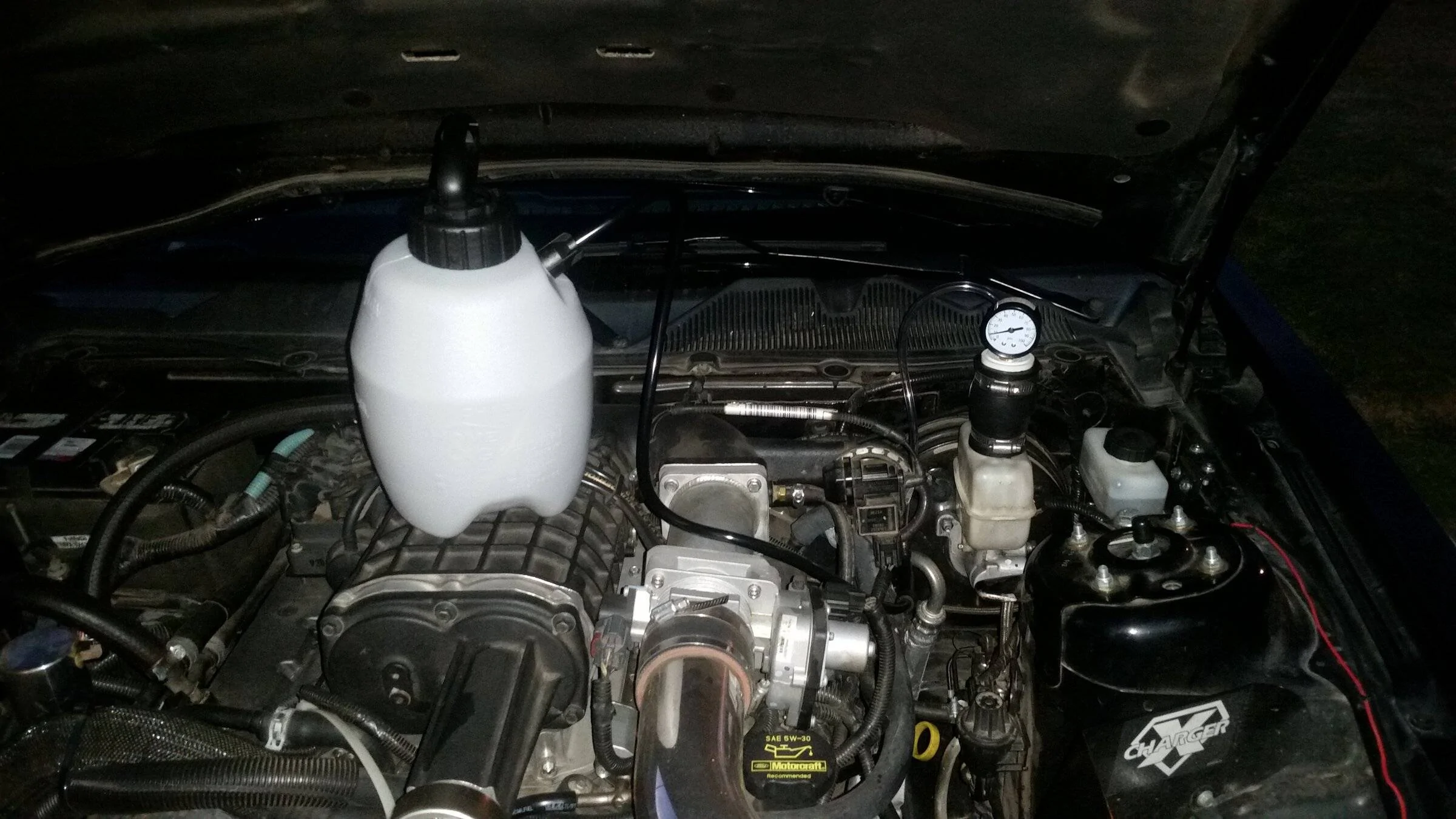

I built a pressure bleeder from a garden sprayer 6 years ago and it still works like a charm. I can flush and refill the whole car in under 2 hours start to finish. The key with the pressure bleeders IMO is to use them dry. Putting fluid in them just makes a mess. You just have to keep an eye on the reservoir level.
Pressurize the reservoir, put a clear tube on the bleeder, open/close till no bubbles, tighten bleeder, then on to the next.
