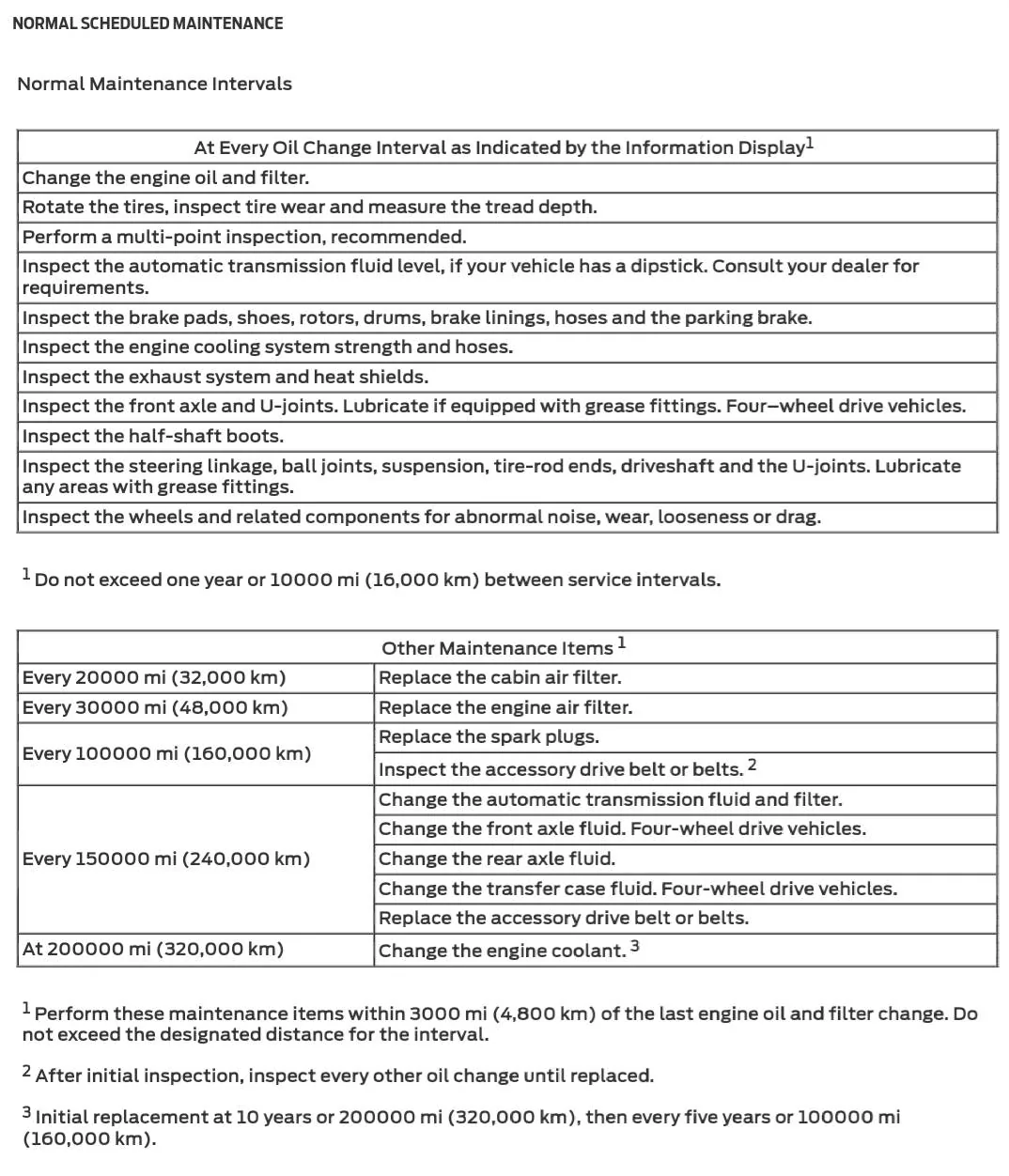

I am worried that now that they tagged it as needing it, and if I don't get it, it will void the warranty.
Here is the maintenance schedule

Is it safe to say you neve opened your owners manual? It has a maintenance section to help you out.
That said I recommend the following at that mileage. Air filter, cabin filter(I recommend every 15K), fuel injection service(it malty be a combination of things to help get carbon buildup off the intake valves and yes its common with direct injection), brake flush( should be done every few years anyway).
What Frenchy said.
I do both air filter about once a year (~12-15k miles) myself. It is cheap and easy.
For fuel injection service on my vehicles with direct injection (which is all of them now), I use a bottle of Chevron Techron Concentrate (Amazon link) in the gas tank just prior to each oil change. Again, it is cheap and easy, so no harm if it doesn't help.
for Brake flushing, I tend to do the first at about 3 years, then about every 2 years. This is fairly cheap and easy to DIY, or about $100 at the shop(s) I go to.
