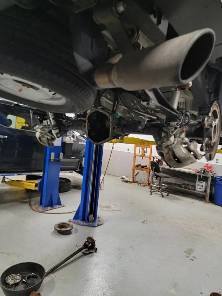

So I'm writing this to help anyone else who is hearing some noise from their rear end. Starting last winter I began to hear a faint noise similar to tire noise but a different pitch. It would increase and decrease in volume with slowing and accelerating. After a few months, it became a howl. It was audible from the cabin as well as the outside, and was very very loud at this point. I had become accustomed to it as it had began small, thinking it was the very aggressive tires I have wearing down. Eventually, my buddy was riding with me and asked me about it. I said I had noticed it but the truck was working fine. (Quick basckstory, I sold the truck to myself, I was a salesperson for Ford for almost 2 years. My friend was as well. We are both car people and have built several vehicles. My Ranger is significantly modified aswell) This started my search for the problem. I began stripping off my wheels and spacers, looking at rotors, pads, calipers, U bolts etc as I had thought my tires wer rubbung or that something was rubbing on a moving piece of metal as it would increase with speed. I couldn't find anything. I combed over the entire rear axle several times, and at this point I knew it was something happening inside the pumpkin. This was obviously my worst fear, as my truck isn't stock. I was definetly concerned I was going to be in a fight with Ford's warranty department for months, as I've seen first hand how they can be. (I had a customer with a Raptor who was denied cam phasers by Ford, took him 4 months of back and forth before they fixed it) Thankfully, I knew several people in service from when I worked at the dealership, including the GM. In the end, Ford warrantied it and the entire axle housing was gutted and replaced.
I wanted to make this post mainly because I am lucky I was a former employee. Most people aren't in my situation. I hope I can help someone find the issue before their trucks warranty is out so they don't get stuck with a massive bill. ( Which you will see the final cost)
