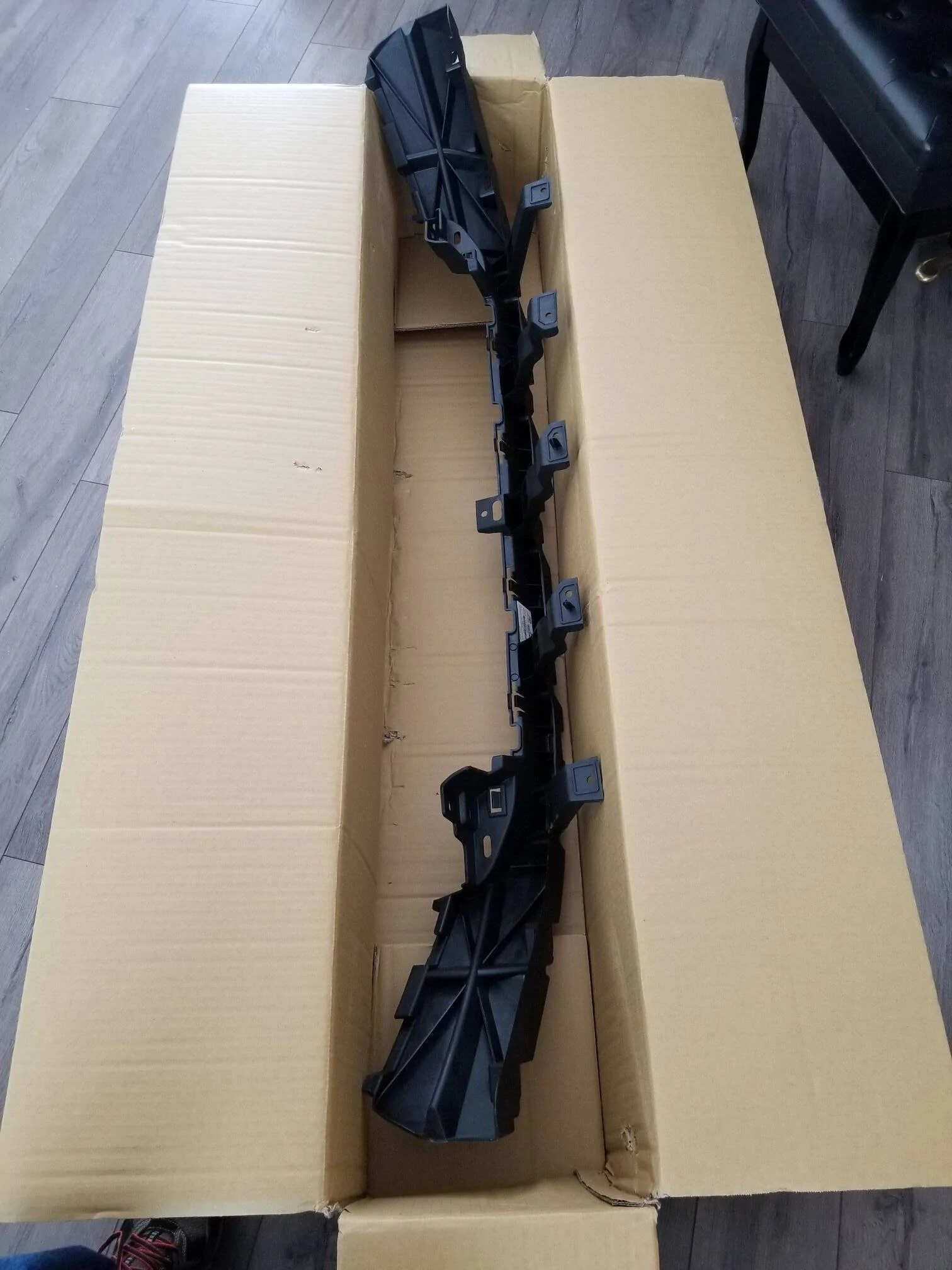

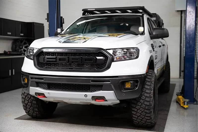

One more (pricey) piece for the Ranger puzzle. It's the support that goes behind the upper bumper cover
Looked at grills until my eyes bled. Finally chose the Ford Performance grill. Still debating on OEM or aftermarket bumper. Found a place with several full OEM bumper assemblies that had been removed to fit aftermarket bumpers. Waiting to see if they'll ship and if so how much.
Watched a video today from Stage 3 Motorsports, same place the grill is coming from, where they fit 285/70-17 tires on stock wheels with 1.5" spacers. That would put them at the equivalent of about a 17 mm offset. Pretty close to the Roush wheels at 25 mm.
That vehicle had a 2" front lift, which is what I'm looking at doing. To clear the tires they not only removed the front intrusion bars but ended up cutting an angle out of the mount. The rear bars were cut down about half way. Not sure if I'll cut mine or purchase a modified set. They also cut away some of the plastic and splash shield in front of the front tire. My Ranger currently has none of that, obviously.
Still waiting for at least a few days of decent weather so I can get serious working on it.

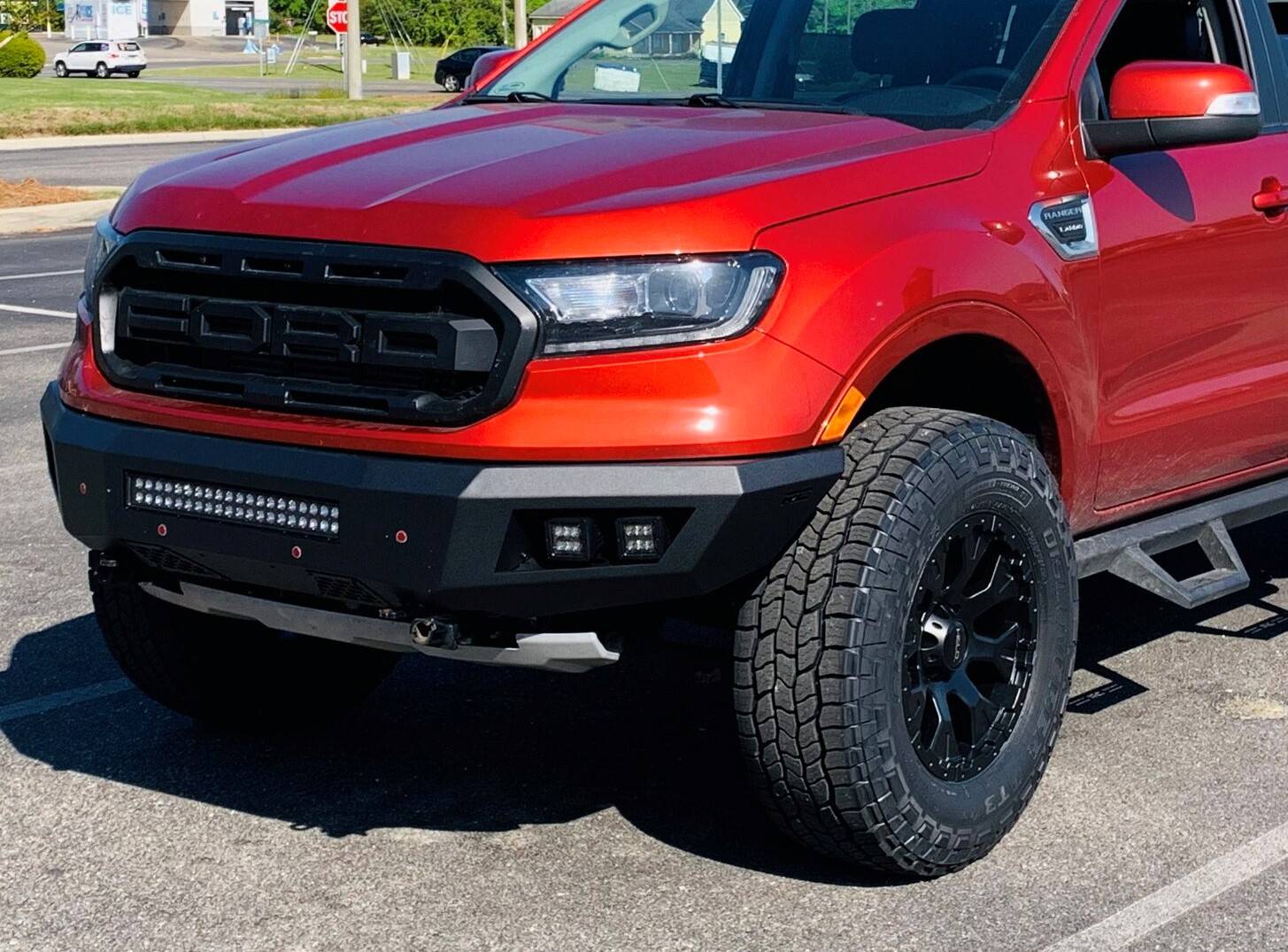

Well, the bumper question just got answered. Found a Rough Country bumper that was a customer return on their scratch and dent site. Ended up at half or less than what I would expect for a used OEM unit.
I'll likely still modify it a little for more lower air flow but it was too good a deal to pass up. Maybe I'll find a reasonably priced OEM unit later if I still think I have to have one. Last big ticket part item will be the hood.
Stole the picture from another forum member.

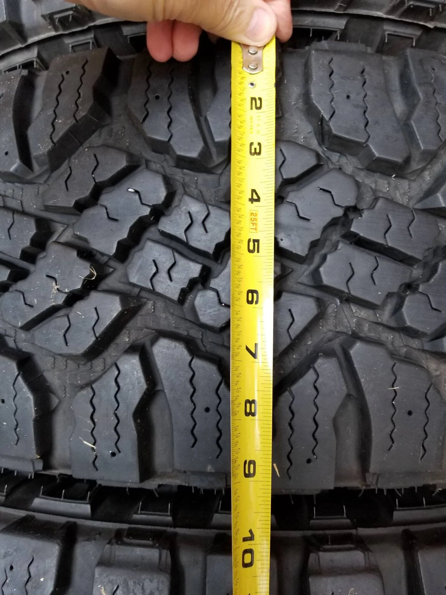

17x8.5 25mm offset. That was pretty much the exact specs I was looking for regarding offset and width. The 285/70-17 Duratrac tires are just slightly over 9" wide at the shoulder edge so that means with an 8.5" wheel width (measured at the bead), the edge of the tire shoulder should be almost even with the outside of the wheel rim, with the tread maybe just a hair wider.
A 9" wheel would put the outside of the rim just past the edge of the tire shoulder, which I did not want. 8" would be fine with the tire sucked into the wheel a little more but I'm not a fan of wheel spacers even though I think the stock wheels look really good. So when I found these Roush wheels there was no hesitation.

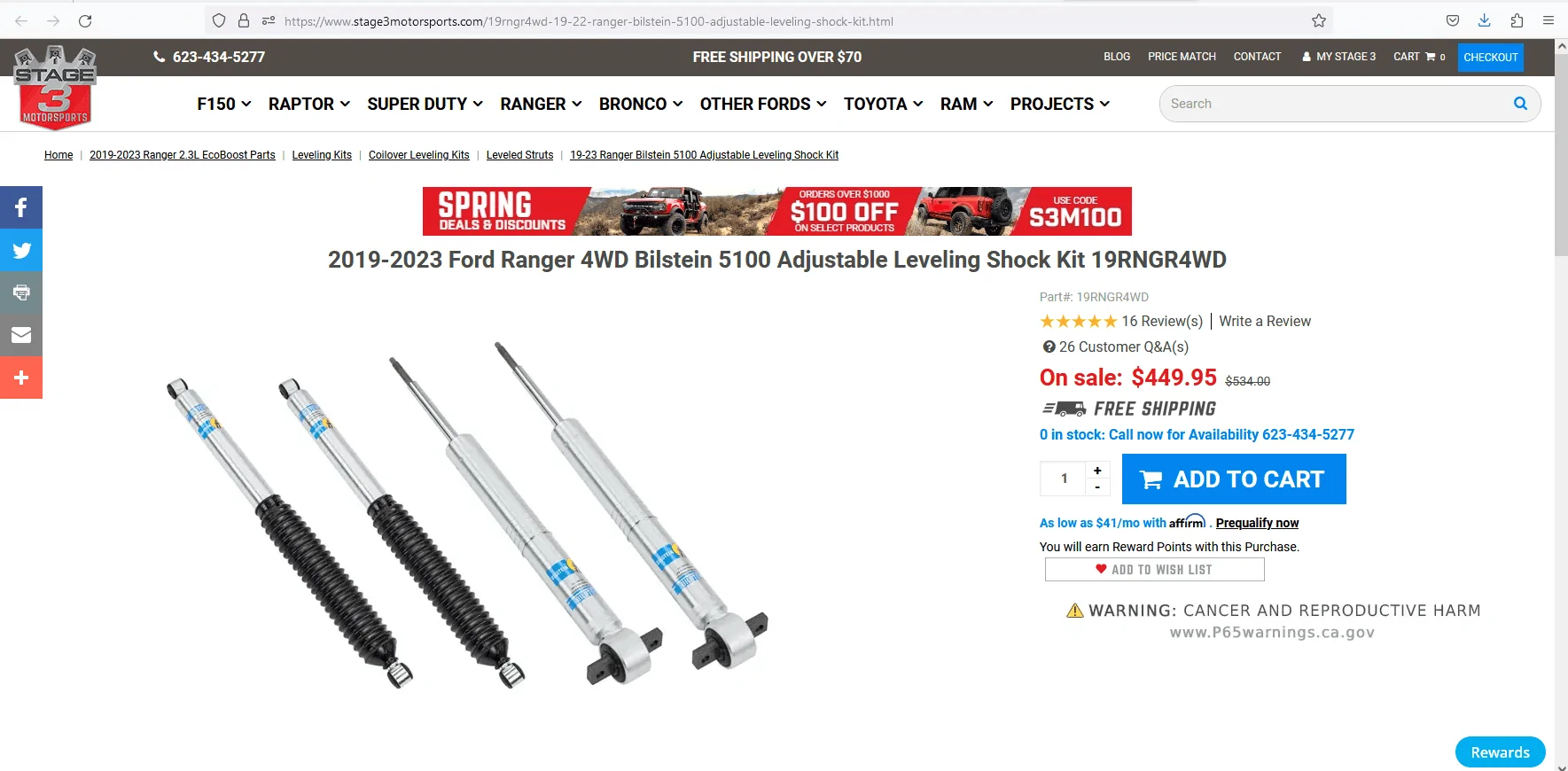

And just like that, changed my mind. Always been a fan of Bilstein and like the idea of the adjustable front strut cartridge. After reading reviews and talking to Frank at Stage 3, and since a fair amount was saved by getting the customer returned RC bumper, new shocks have been ordered. May add 1" of lift in the back but we'll see. I've found that still having a small amount of rake makes seeing things out the front a little better for us shorter folk.
Some recommend longer UCA's even with a 2" lift but others say the stock one is fine at 2". I'll wait and see what the geometry looks like after the lift.
