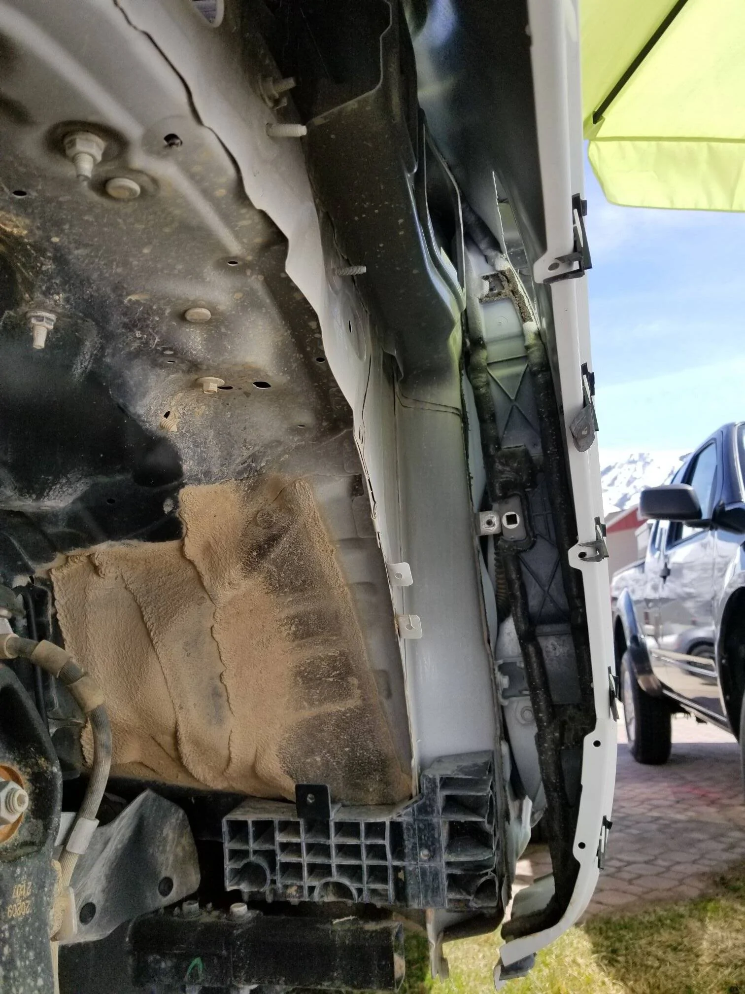

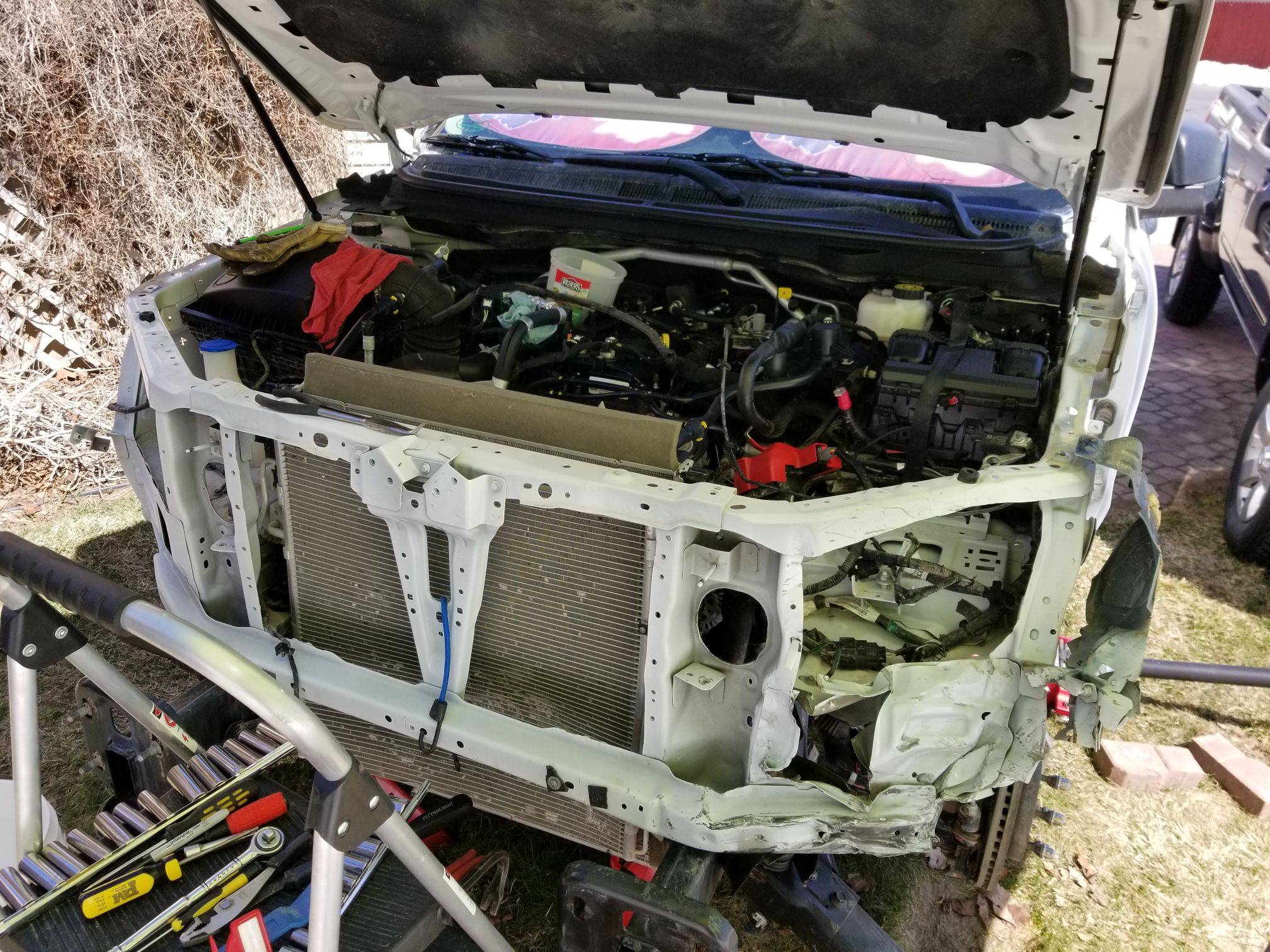

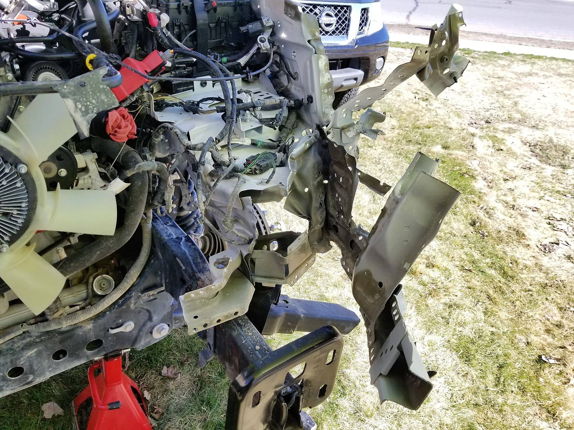

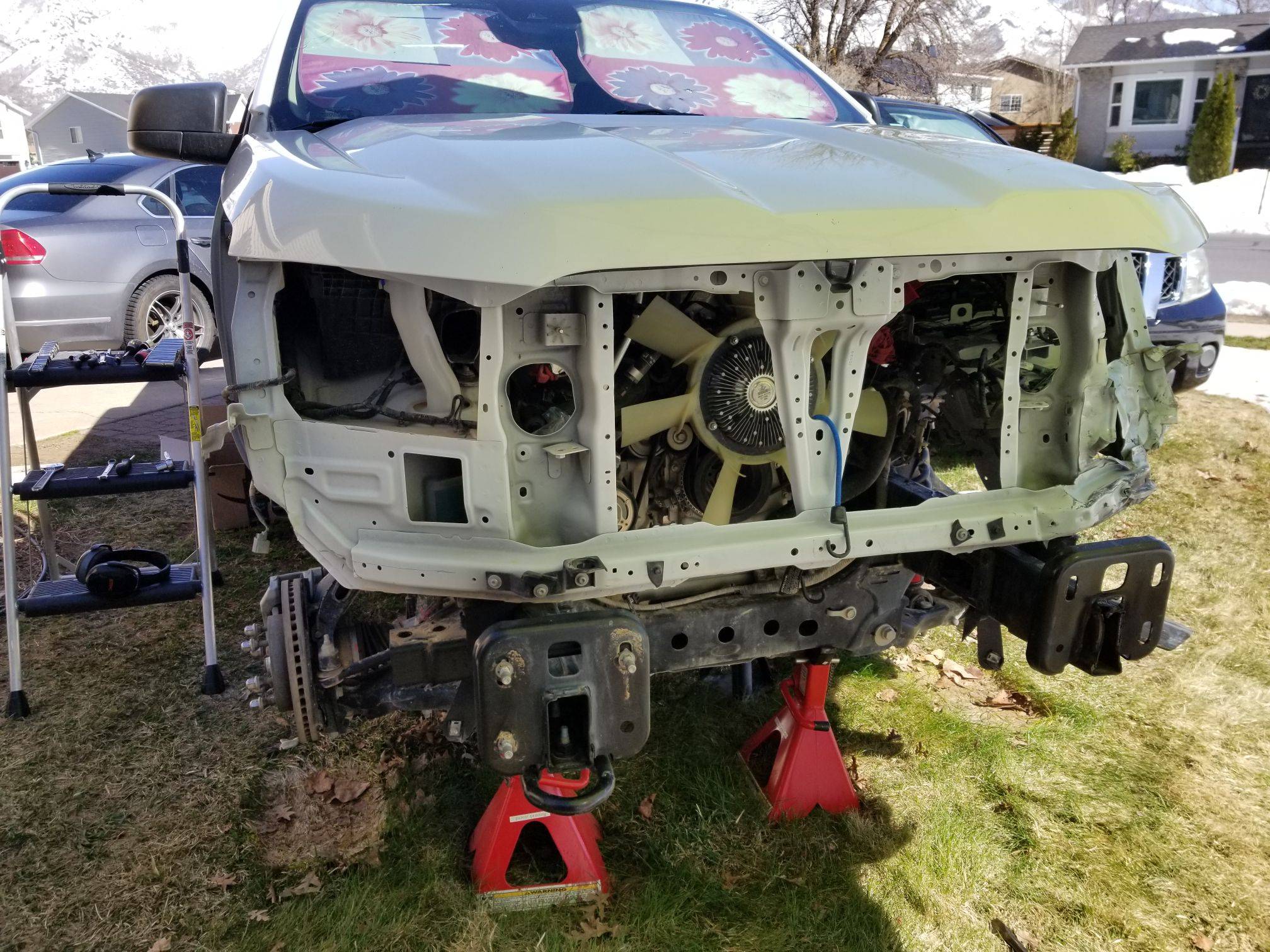

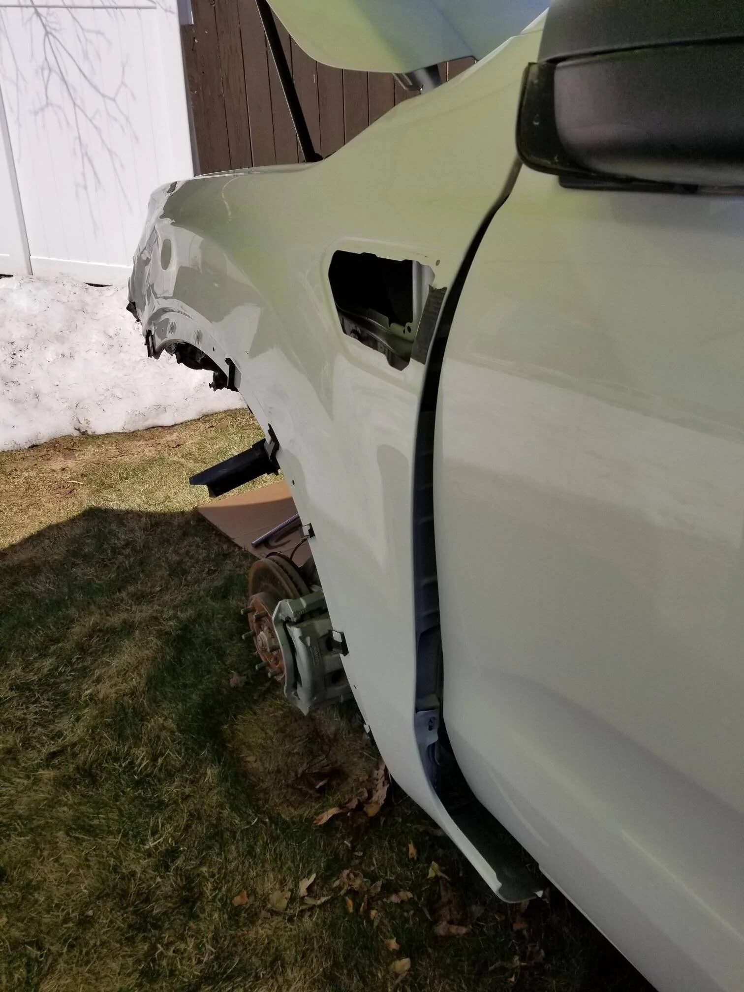

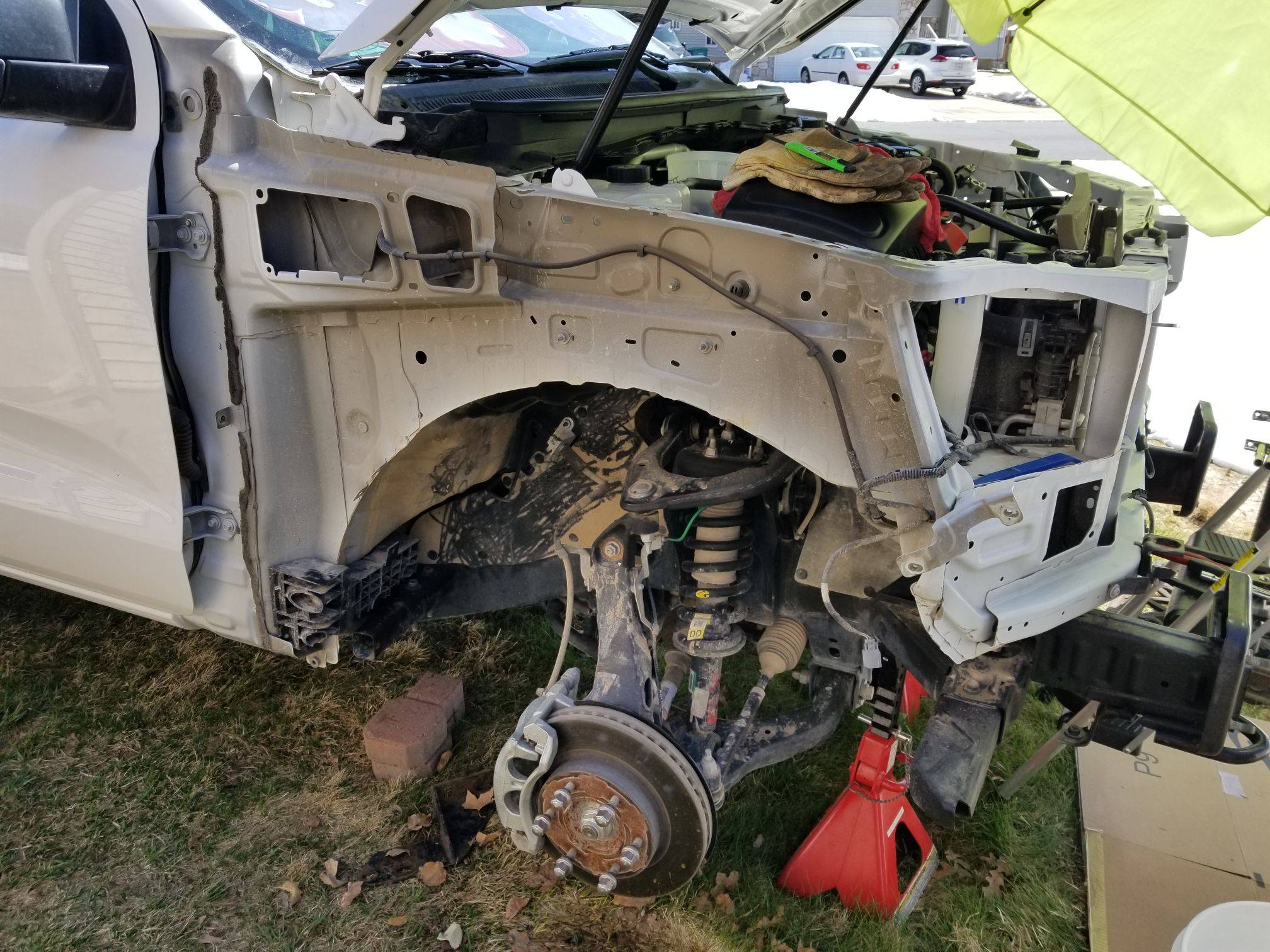

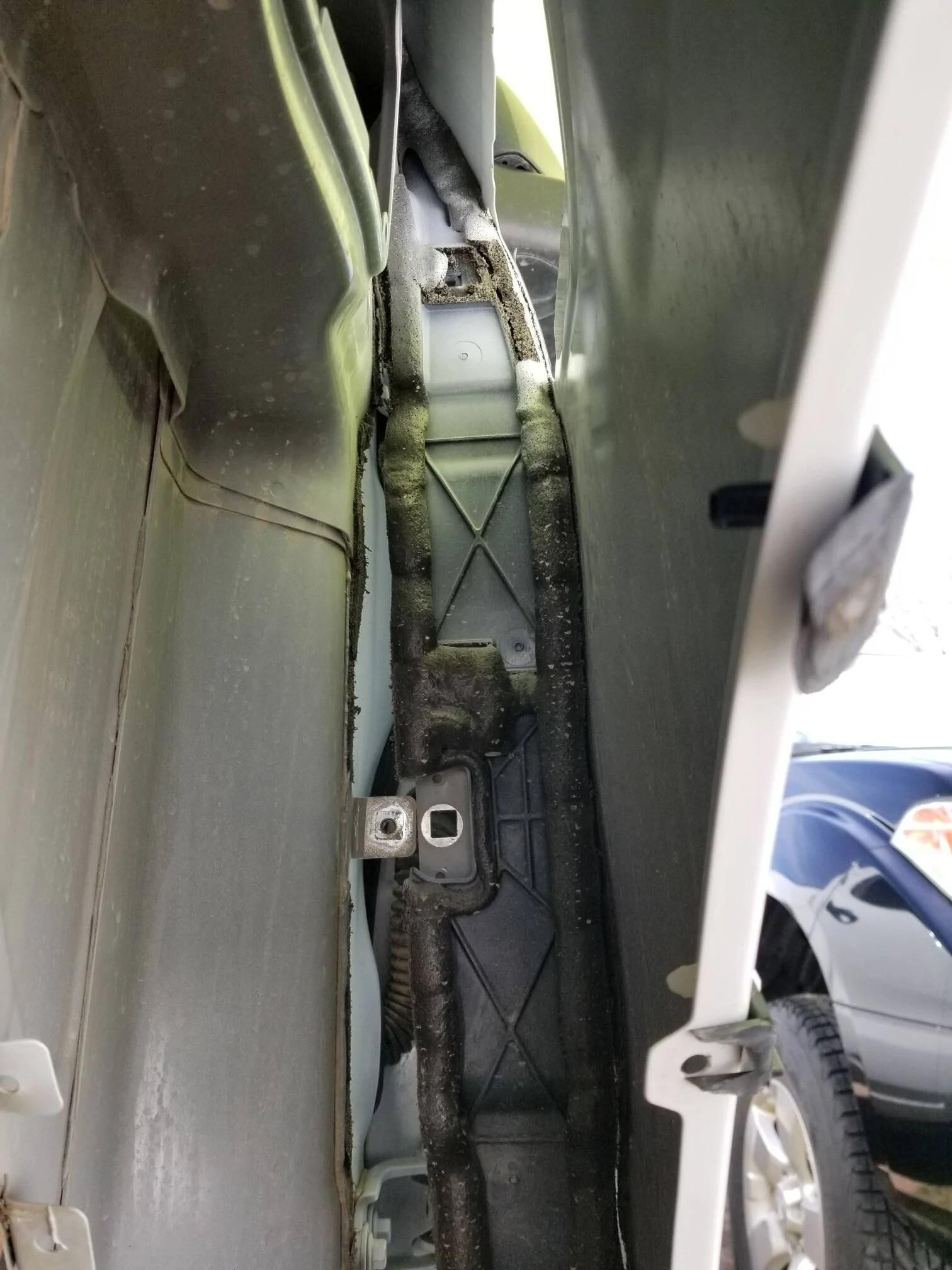

Well, here we go. Got both fenders off, the radiator and AC condenser out and removed some other stuff here and there. Tomorrow will start the radiator support removal.
The fenders are a pain because they're glued to the body at the door hinge with foam sealant. You have to cut the foam at the body to get the fenders off. It could mostly be cut from inside the fender with a little through the opening for the XLT badge and then from the door opening side. I'm assuming I'll have to cut out the plastic piece that connects the fender to the body at the door hinge and glue it to the new fender.

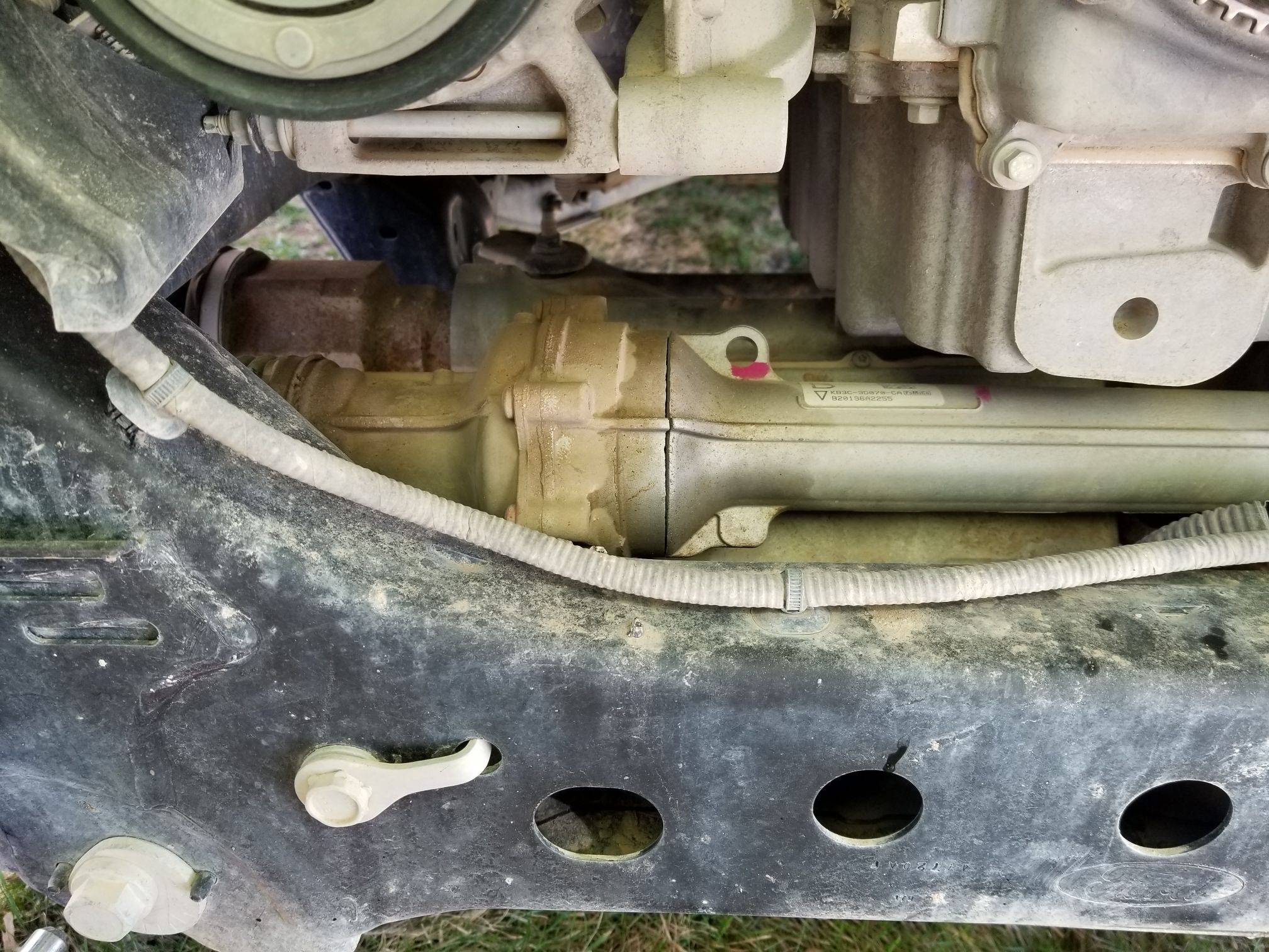

And then there was the "Ah chit" moment when I discovered the rack and pinion case is cracked in half. There goes another grand.

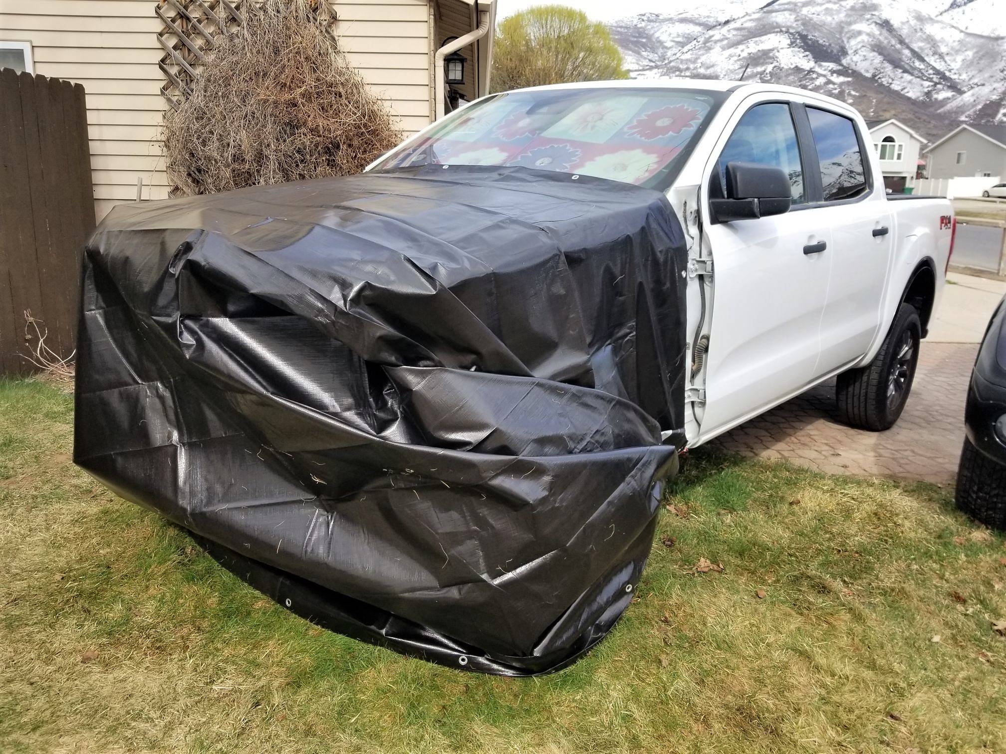

Good eye. Yeah. Funny story.
Had an old Xterra for mountain and desert use that was great but decided it was time to upgrade. Looked around and found the Ranger at a salvage dealer but it already had a deposit on it. Left my email and moved on.
Found the Frontier, 6-spd, new clutch and coil packs. Needs some manly-man tires and a little suspension work but very nice otherwise. Gave the guy a deposit with plans for my wife to go back with me later to pay the rest and bring it home.
Literally the day before we were to go get it, I get an email that the hold on the Ranger had been released. Made an offer and got the Ranger and still honored the deal on the Frontier. So when the Ranger goes to the frame shop I'll do the tires and suspension work on the Frontier and get it ready to sell.

Thanks. Recently ordered a new front frame rail was well. Decided the existing one was too far gone to straighten.
And now needing a new steering rack, it will be even more work. Inquired about one from a salvage dealer in North Dakota so we'll see what happens. A local yard has a couple of Rangers with front end damage so I'll check those as well to see if a steering rack survived.

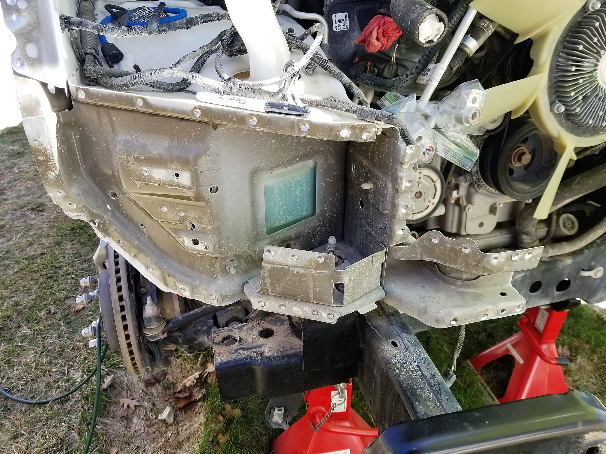

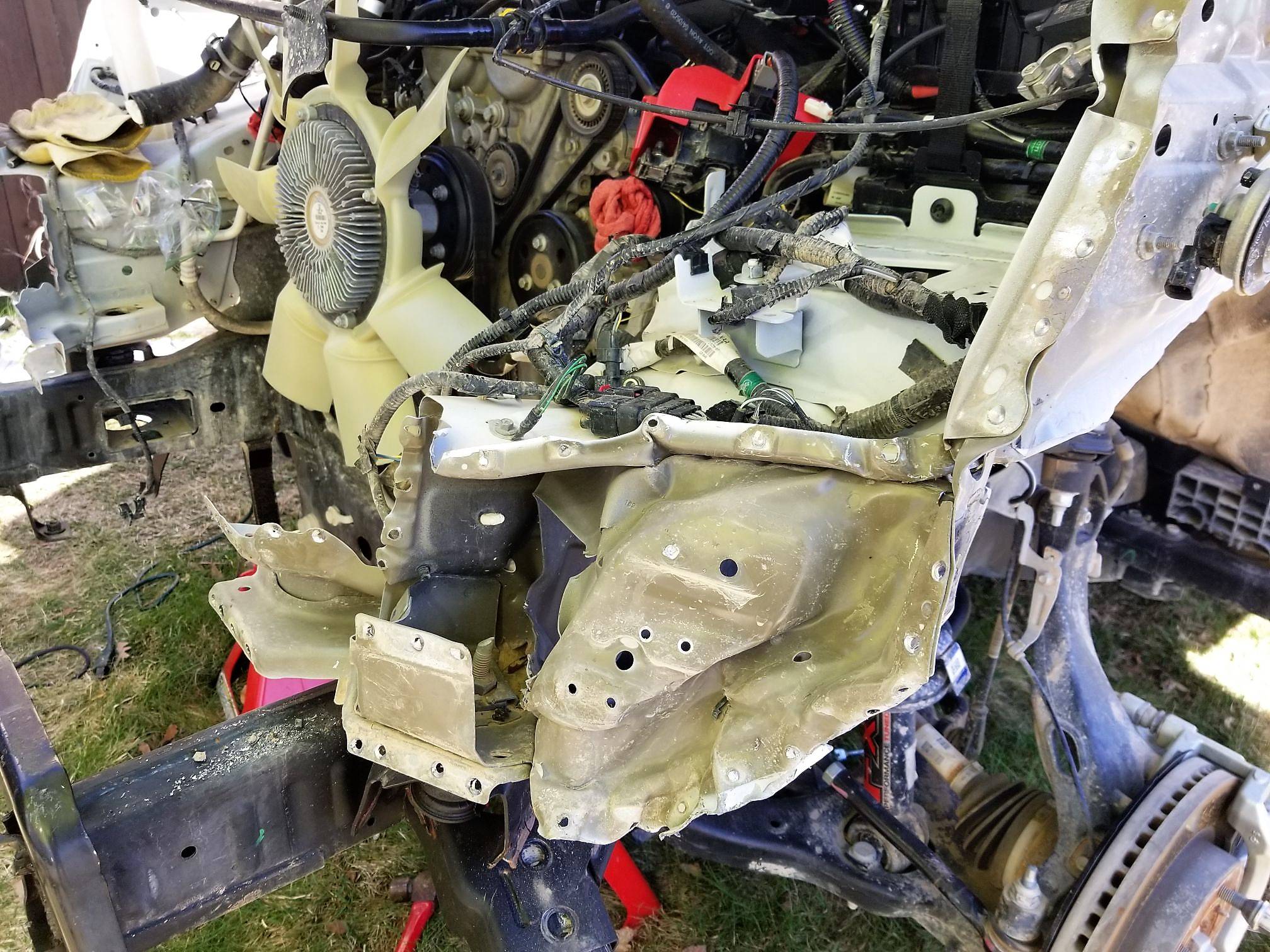

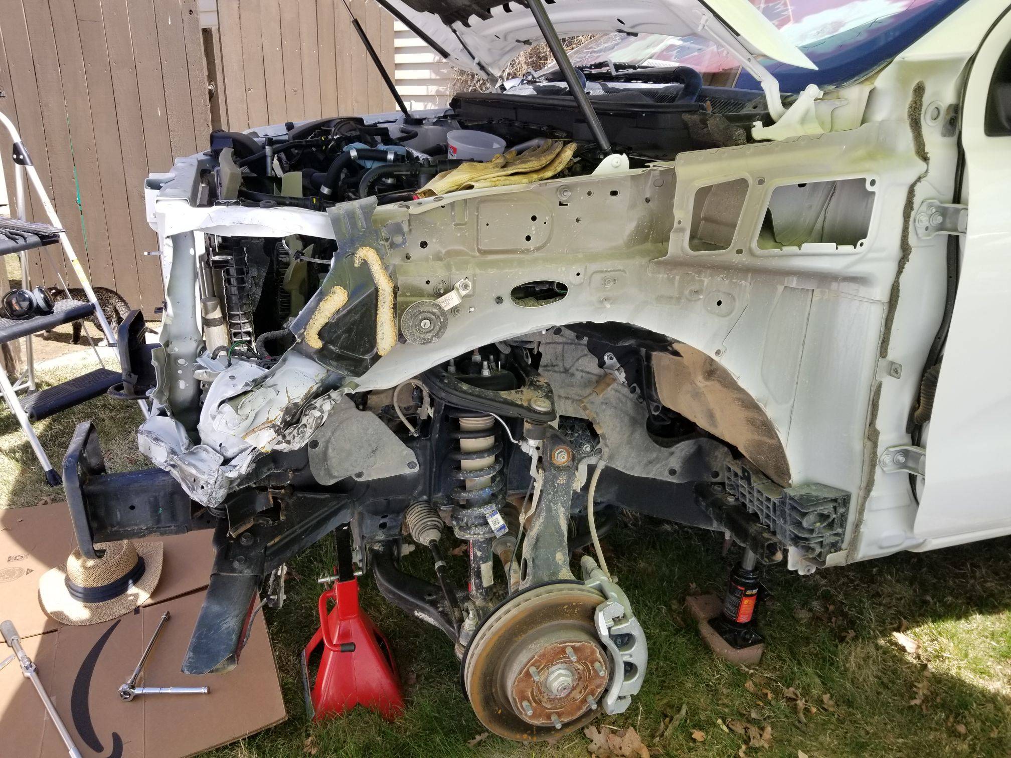

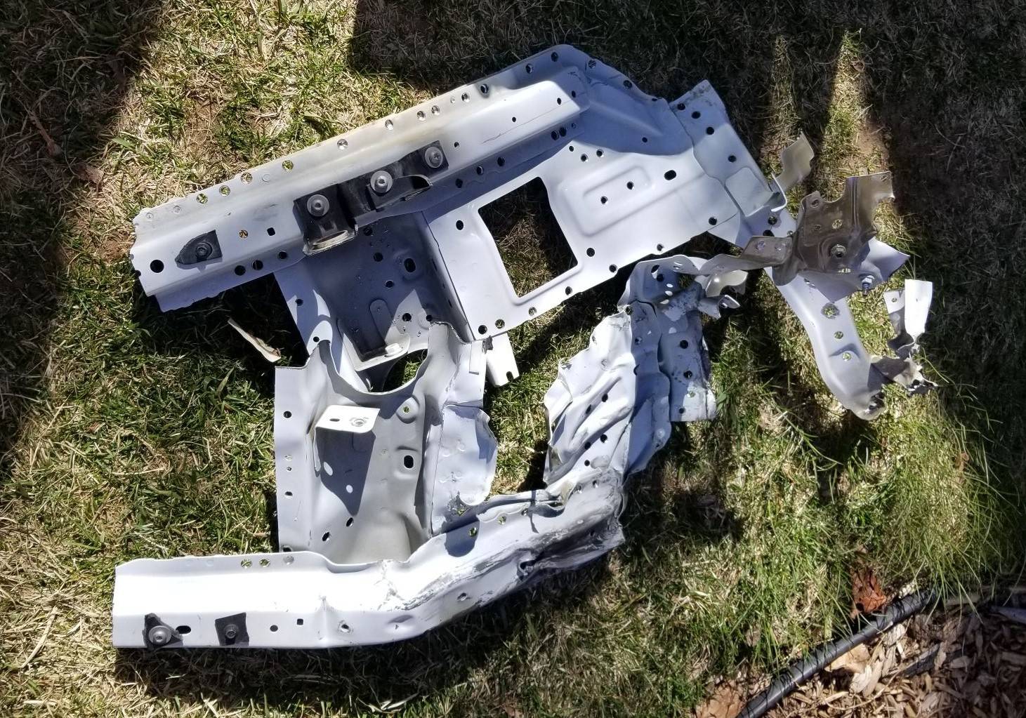

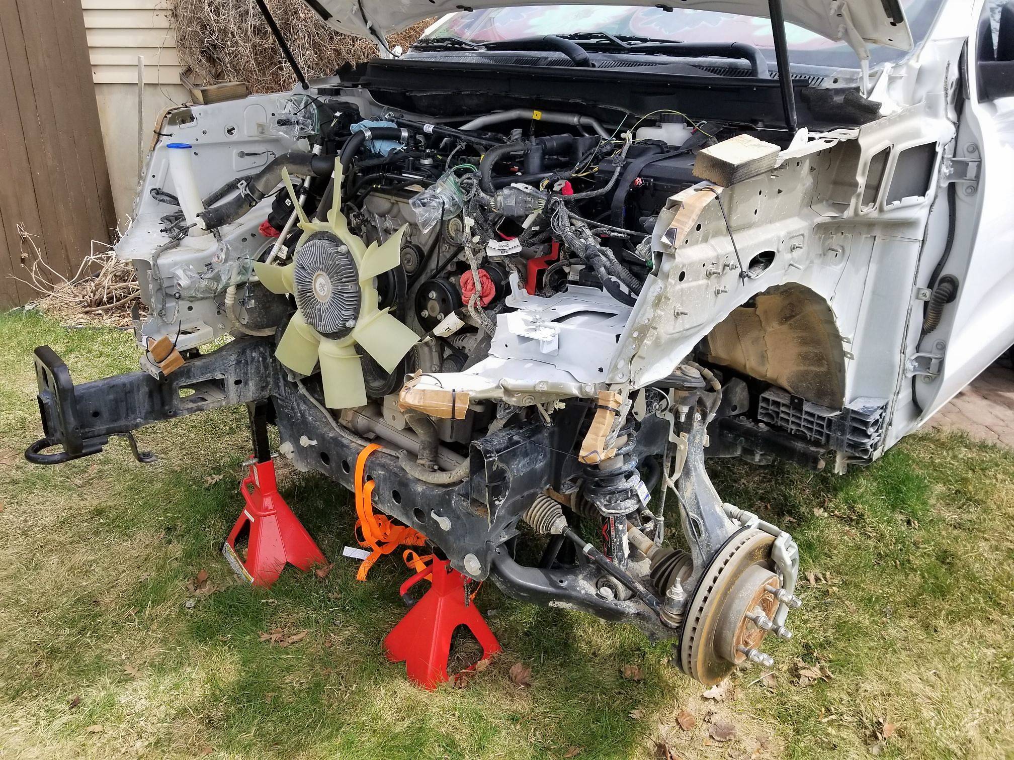

It's amazing how much work can get done when what you want to work on isn't covered in 2 feet of snow.

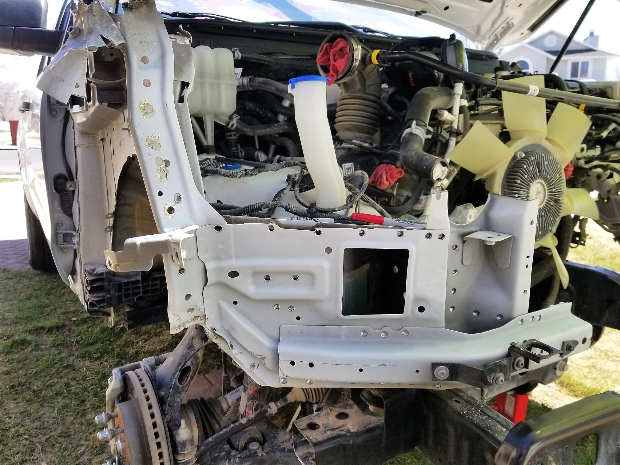

Got the radiator support removed. Full day drilling out those little spot welds. Tomorrow I'll try to remove the mangled lower front box. It has the body mount and support for the radiator. Then grind off the welds on the frame to remove the front frame rail.
After that it's straighten out some of the sheet metal best I can, wait for the new front frame rail to arrive then off to the frame shop.

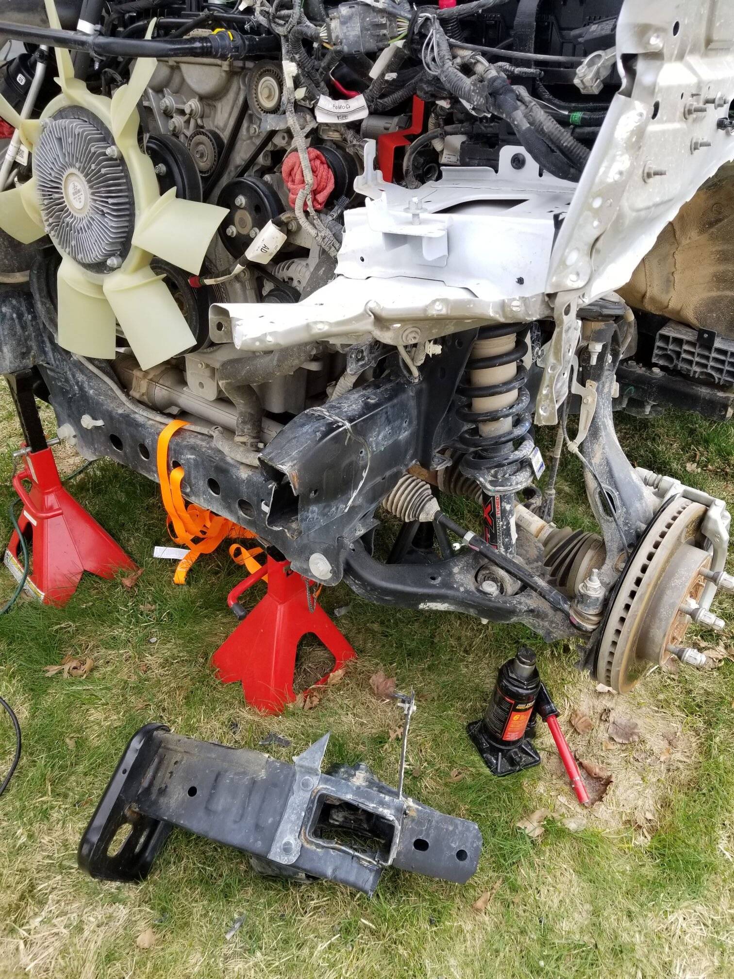

Ranger is now ready for the frame shop. Got the rest of the mess removed including the front frame rail. That took a while to make sure the welds were cut and not the main frame. Power washed the grime out of the fender wells and frame and buttoned it up. Will talk to the body shop tomorrow to see when we can get it in.

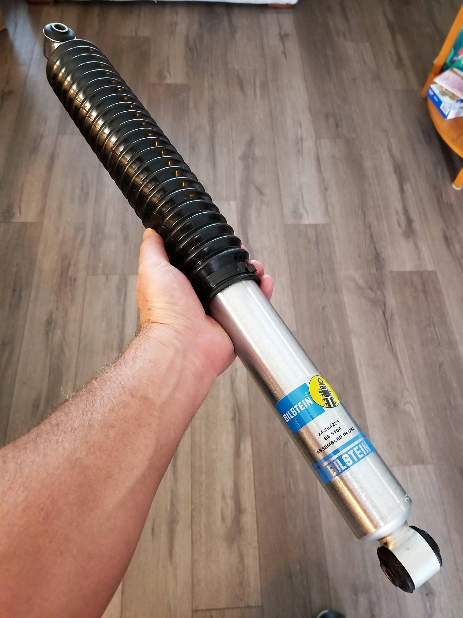

Got the Bilstein shocks and struts today. They are gorgeous.

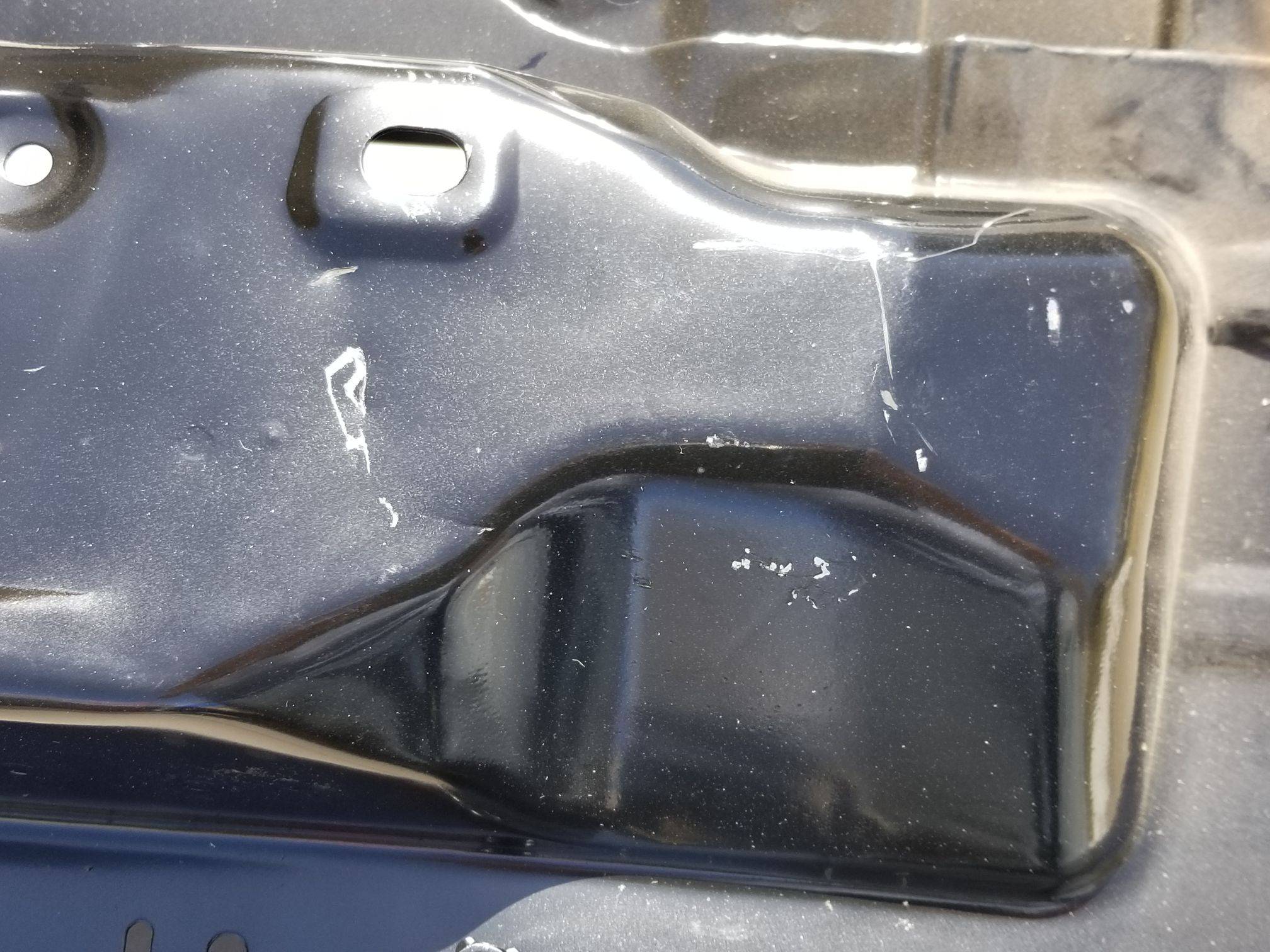

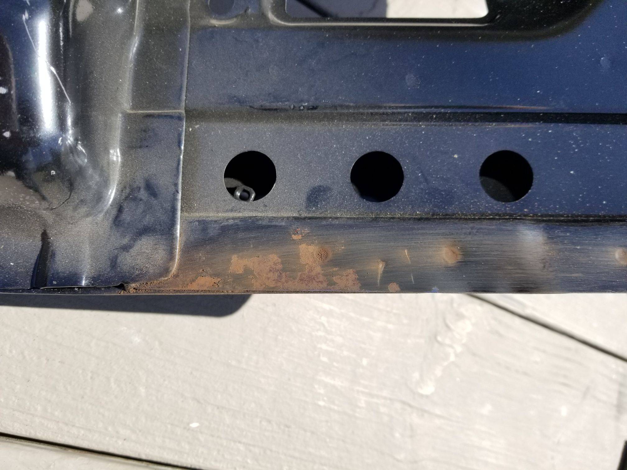

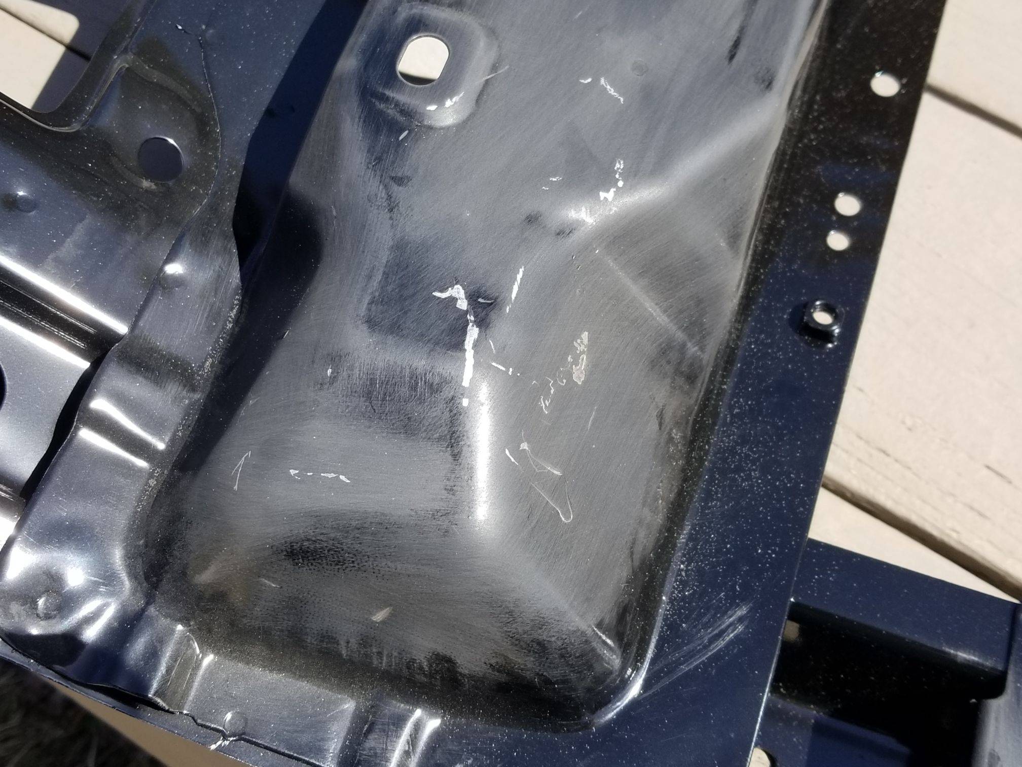

Looks like delivering the Ranger to the frame shop in 3 days will be delayed thanks to the discovery of another crap part.
The radiator support was the first thing I ordered a little over a month ago. Best deal was from CarParts.com. It arrived slightly warped with sections of bare metal all over it from scratches and rough handling. Decided to just clean it up and spray it thinking it would still be fine. Wrong.
While sanding I found a section of rust at the bottom under the paint. The rust encroaches on a layered and welded section. That's some pretty crappy work and quality control for sure. Dropped it right there, ordered a new support from OEM Ford Parts Direct, contacted CarParts.com and filed a claim.
