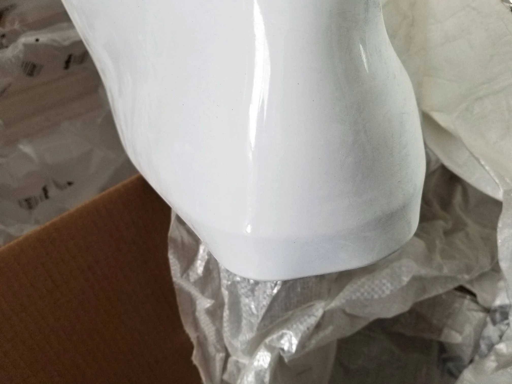

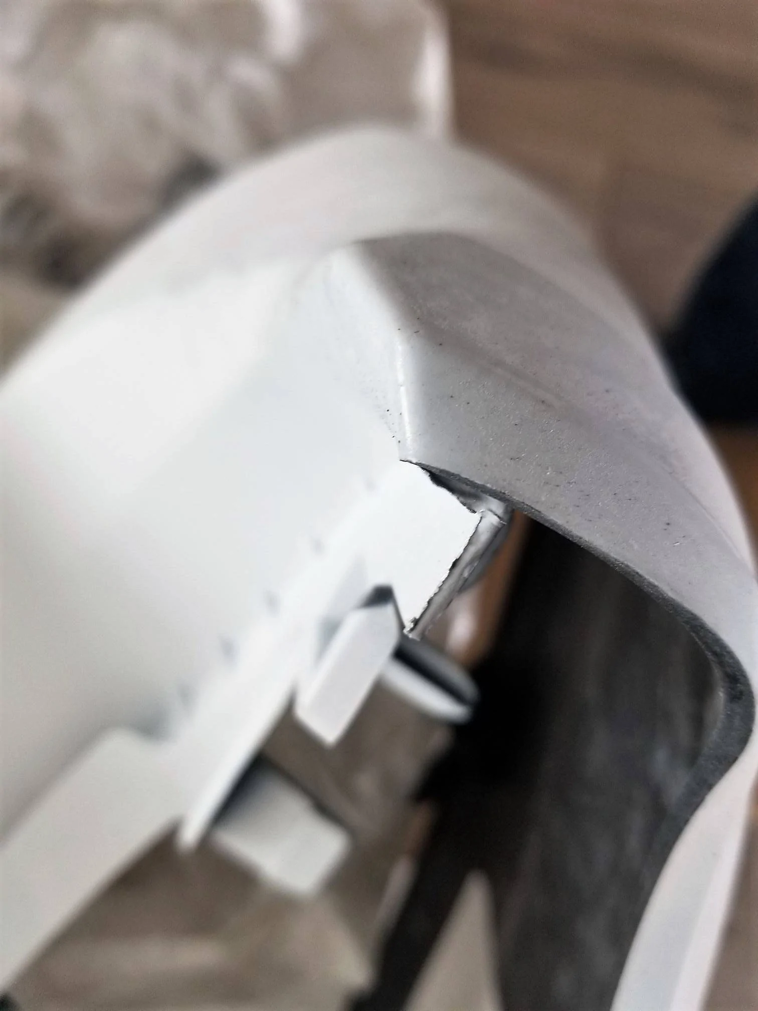

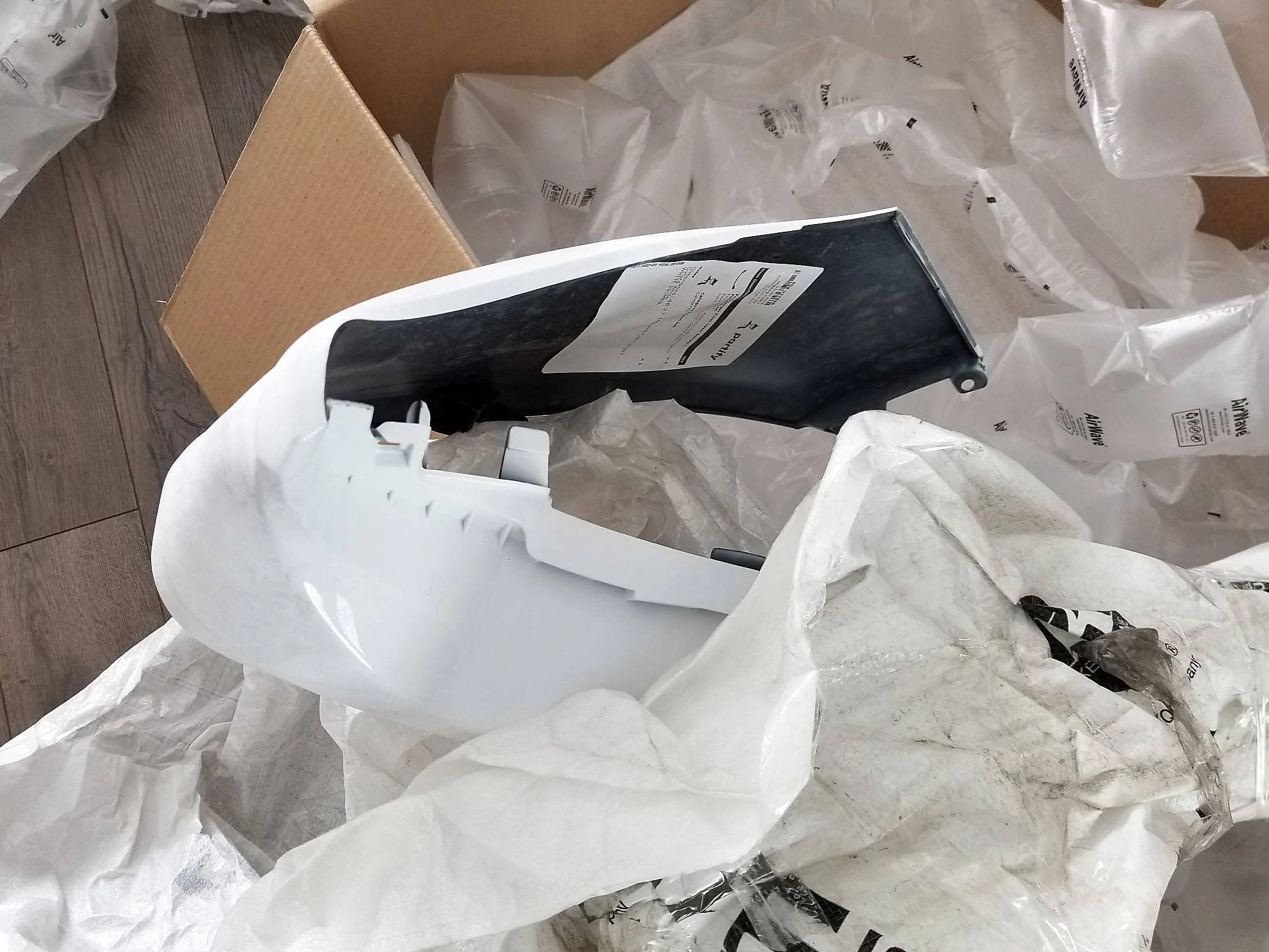

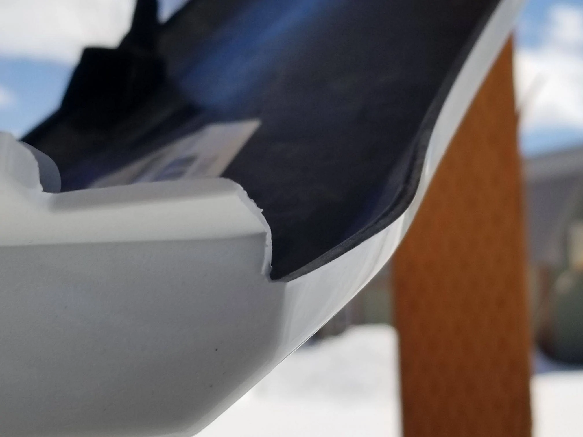

Here's the first mind-blowing stupidity regarding the rebuild.

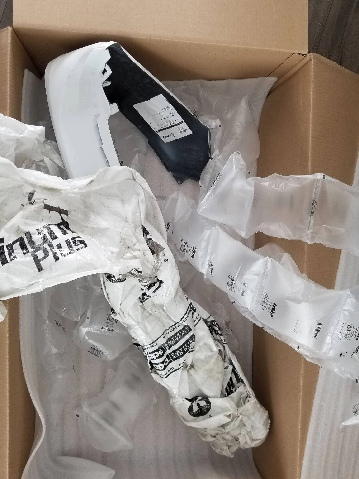

Thought I'd be smart saving time and hassle ordering a prepainted upper bumper cover from Partify. This is how the upper bumper cover showed up today. They creased it in two places to FOLD IT FLAT AND PUT IT IN A BOX. WHAT THE HELL!!!???
What auto body school of delusion did they come from to think the plastic will magically unfold and be perfectly smooth again??? Absolutely unbelievable.
Later found a shipping confirmation email in my spam folder stating that the bumper had been shipped folded up. They do it to supposedly save on shipping and state that the cover will unfold and be like new. Yeah, I don't think so. They claim it would cost upwards of $300 for shipping otherwise.
I've had several large parts shipped already, including a full length, stiff plastic upper bumper cover support that cost about $60 to ship. The charge to paint the cover was $180. Obviously I won't even think of ordering anything from that company again and wouldn't recommend them.
As a professional, I am just absolutely baffled that a company would think that sending a plastic, painted body part in this manner would be acceptable, even if it was for a cheap, old import. I'll likely source another cover that doesn't have crease marks and just paint it myself. Seriously irritating.

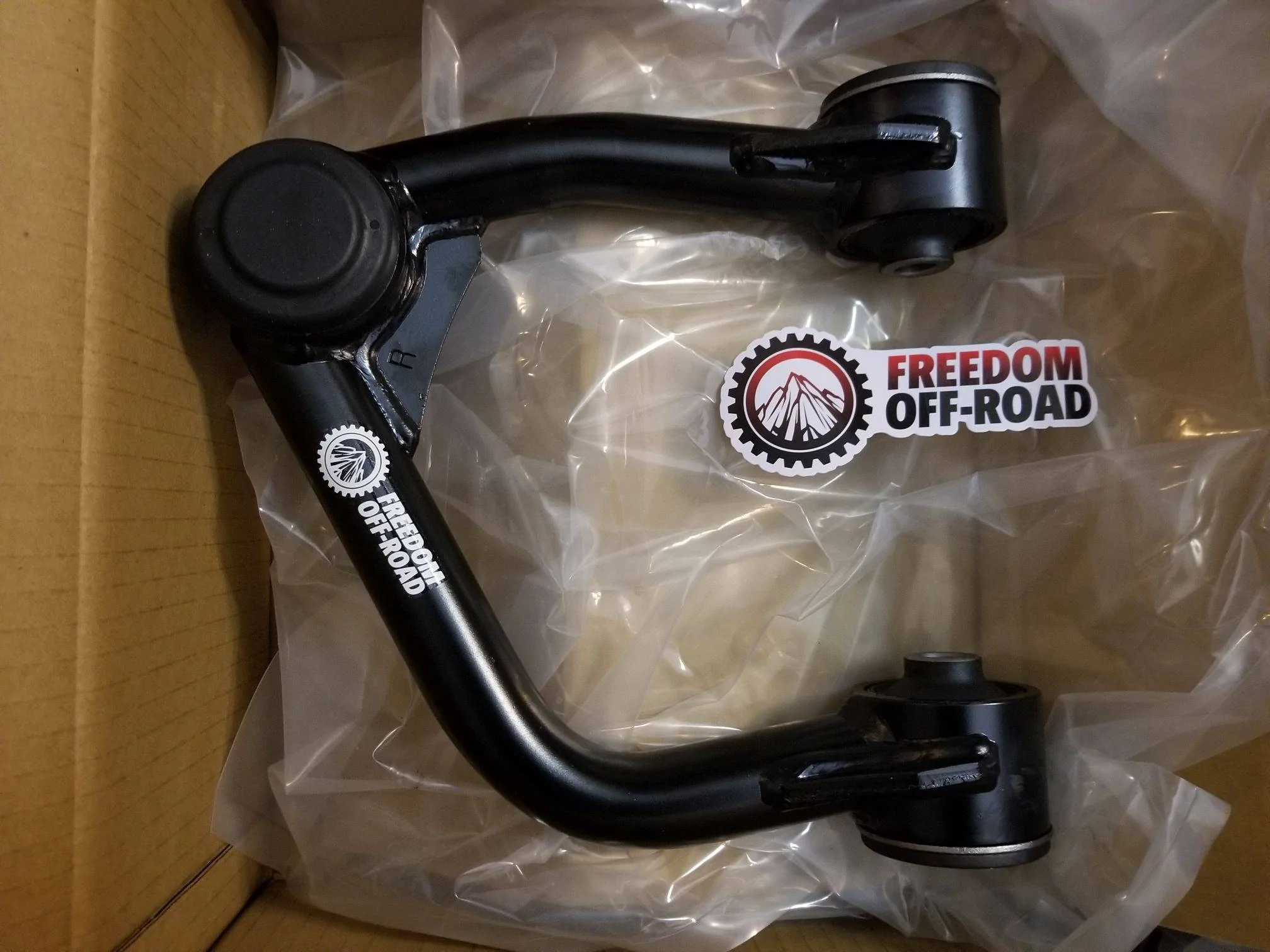

On a much less annoying note, the skid plate, intake manifold, upper and lower cooling fan shrouds, Freedom upper control arms and Lund pocket flares have arrived. Decided not to even mess with the OEM arms given the 2-2.5" lift it will have. These control arms are seriously beefy.

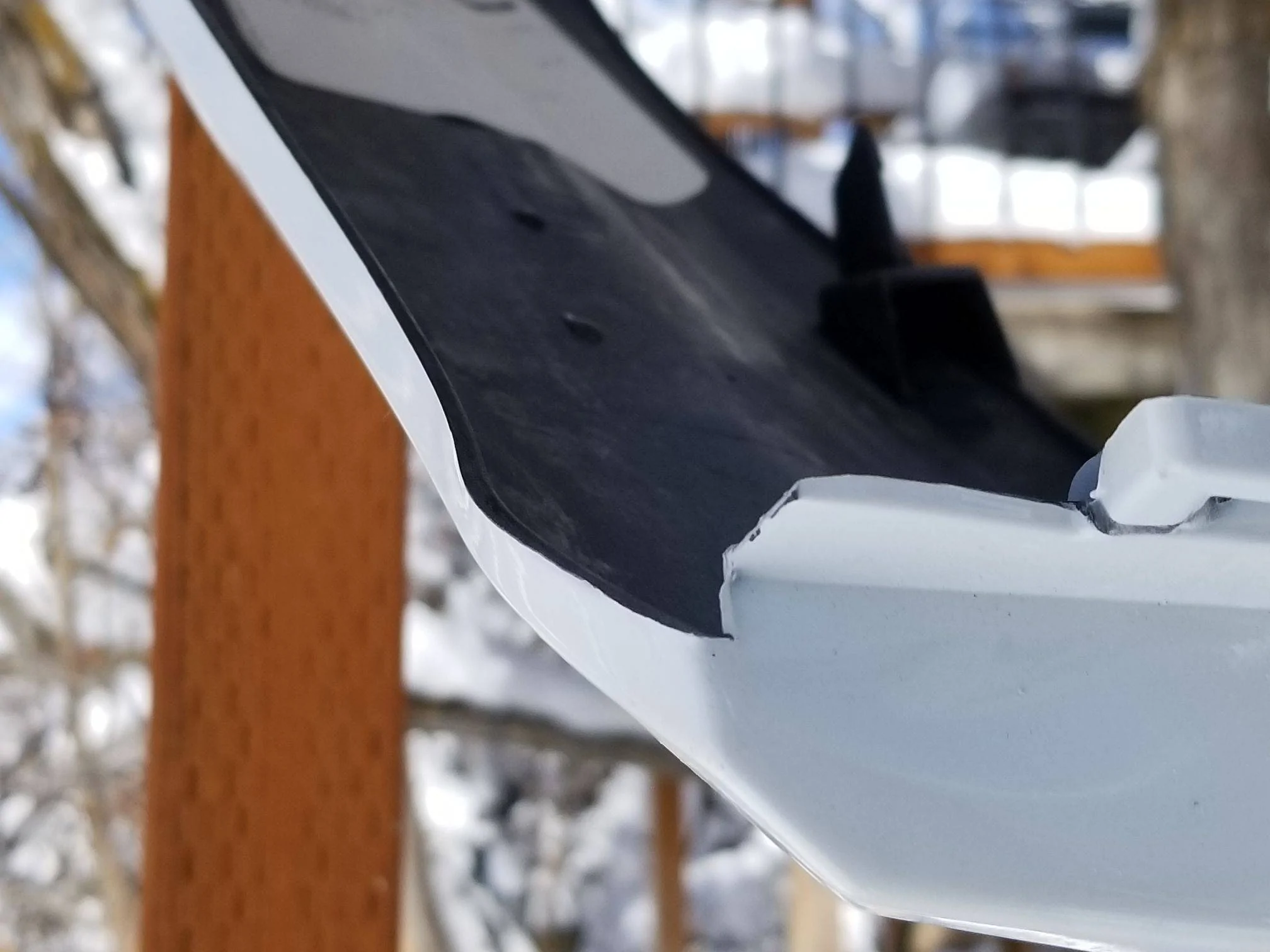

At least Partify's customer service is better than their shipping standards. They replied stating that if I cut the cover in half they'll give me a full refund. Fair enough. I'll see if I can get one painted from the same company supplying the fender and hood.
Before doing that, I hung it up outside and stretched it out just for the heck of it. Definitely has creases that won't go away without some serious massaging. What a waste.

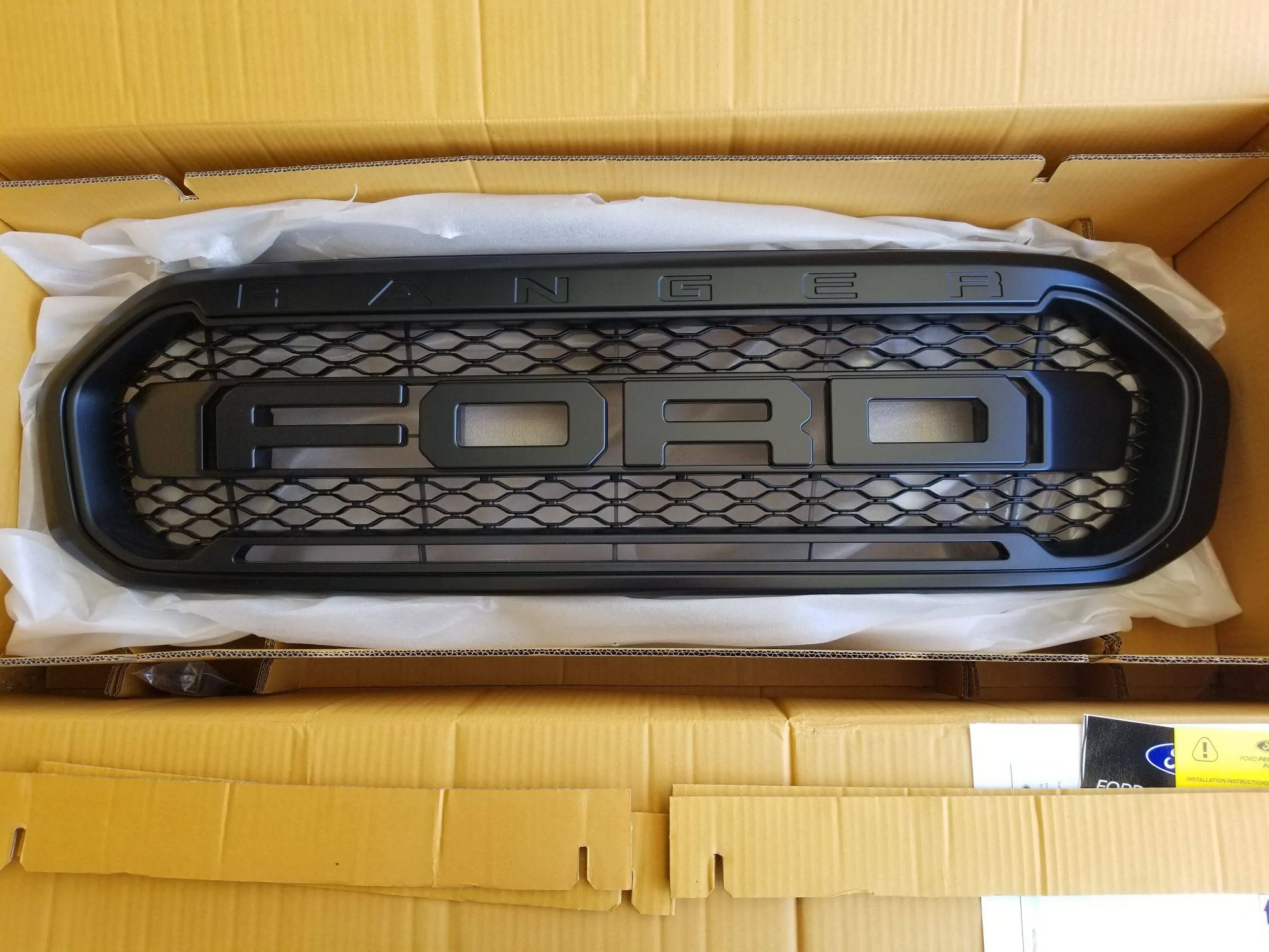

Forgot to mention that the grill arrived. Looks very nice. The truck currently has dark gray accents but because the Rough Country bumper is black, I'll probably leave the grill black as well. In the end the only gray will be the OEM rear bumper. Could paint it or have it powder coated but that would be waaay down the list.

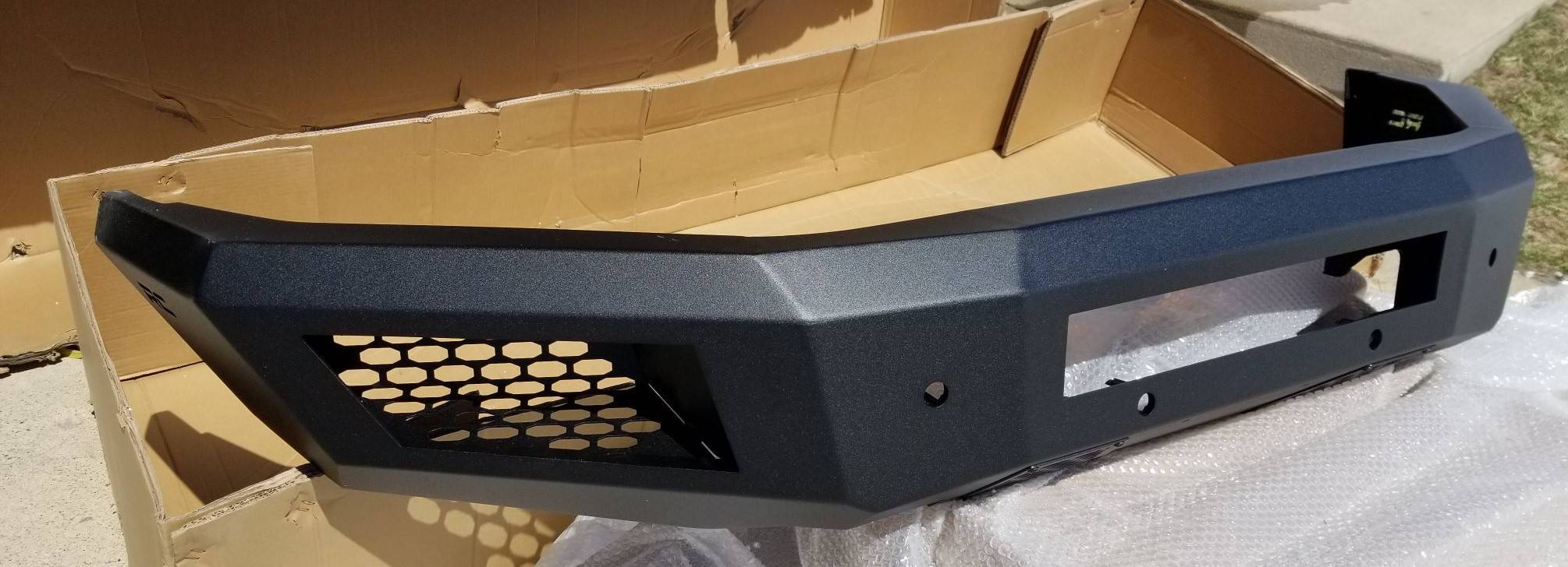

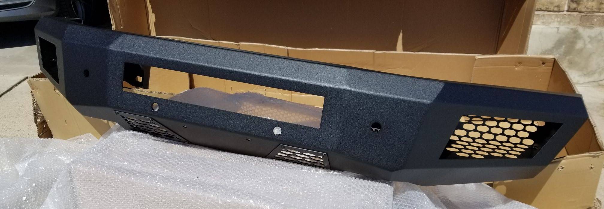

Rough Country bumper arrived today. Looks good except for some scuffs and dings on the tips at the ends. Certainly could have been protected a little better but a great deal for the price. Hopefully some satin black paint will be good enough.
Next will be to source a grill for the open area where the LED bar light would go.
