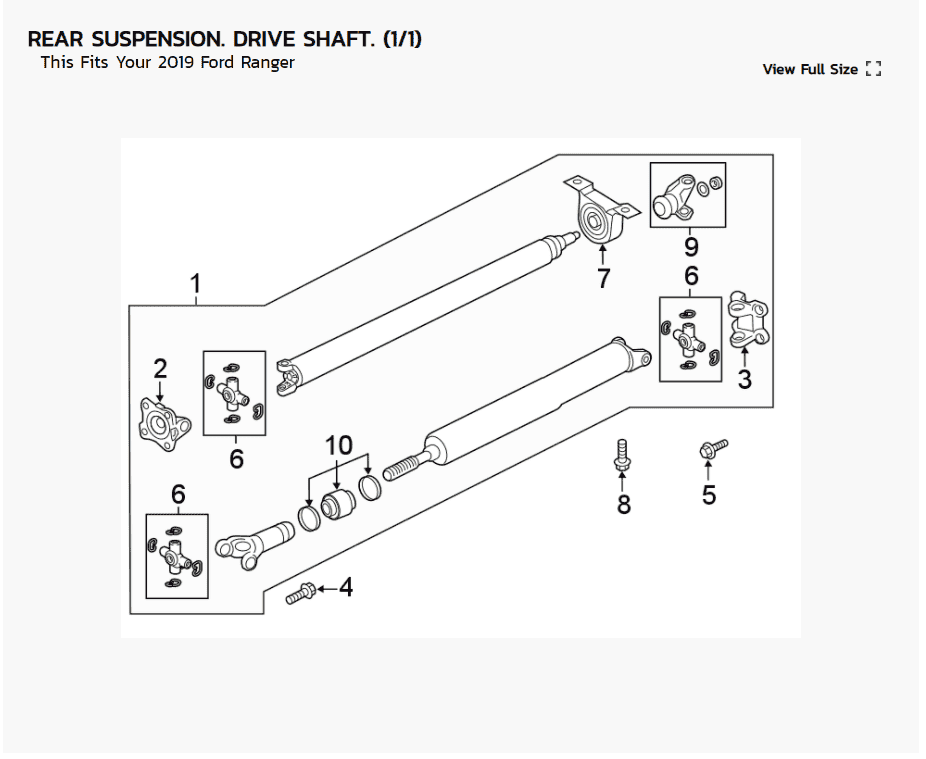

Your truck has 500 miles. I would be asking them for a test drive in a brand new truck to prove to you that it is normal. I would then ask them to grease the slip yoke and show them this diagram if they say "it doesn't have one". See figure 10 for the booth that houses the slip splines.

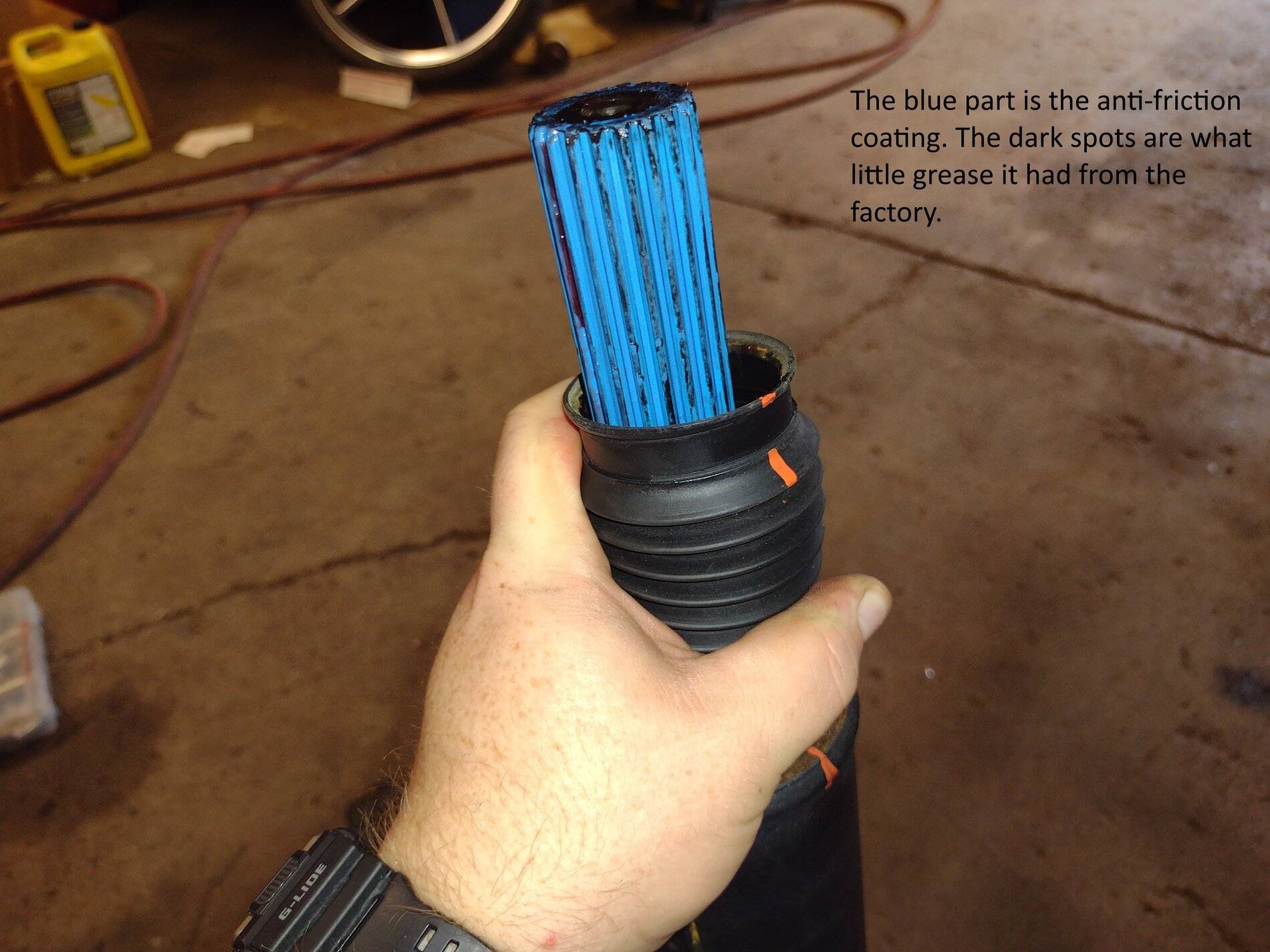

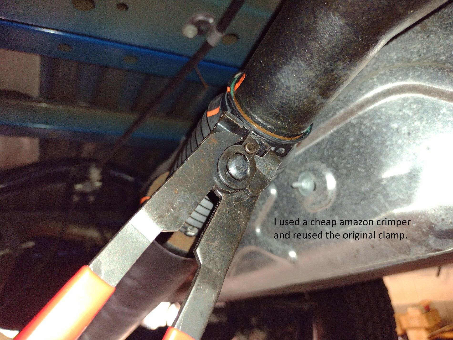

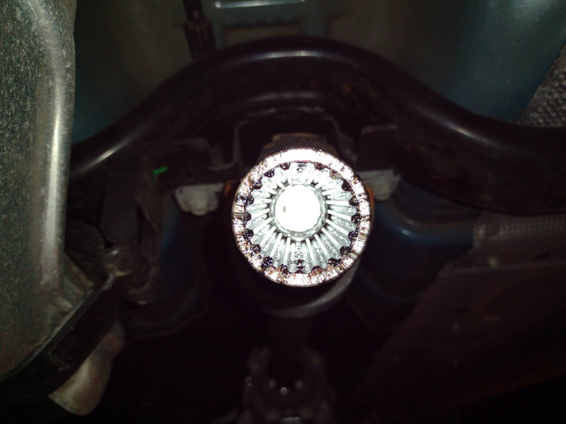

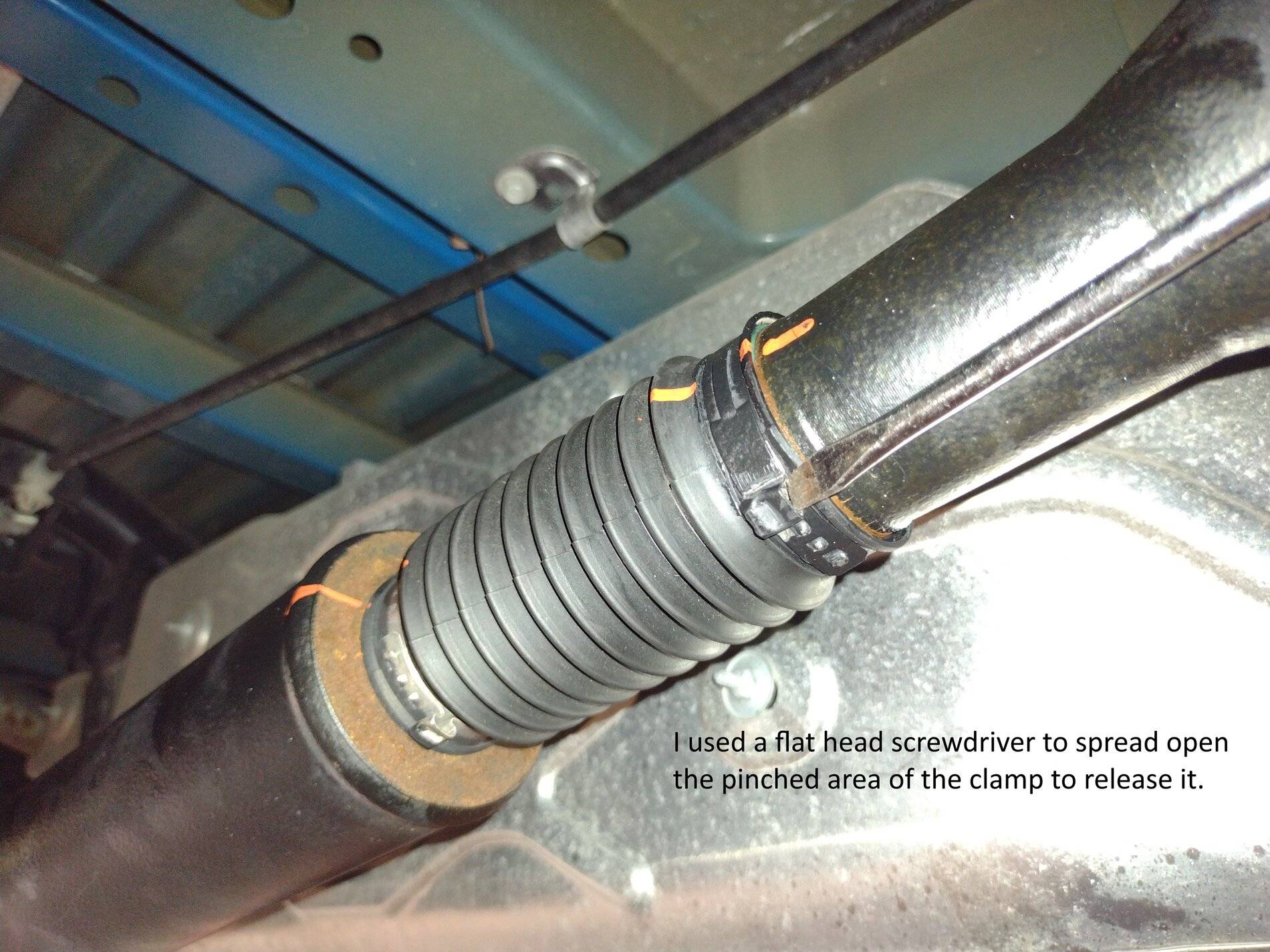

I fixed mine myself today. I bought a $12 bootclamp kit with crimper and a $10 tube of quicksilver spline grease from amazon. It took me about 15-20 minutes. I put a heavy coat of grease on the inner and out splines. The bump feeling I used to get when coming to a stop is gone now.
