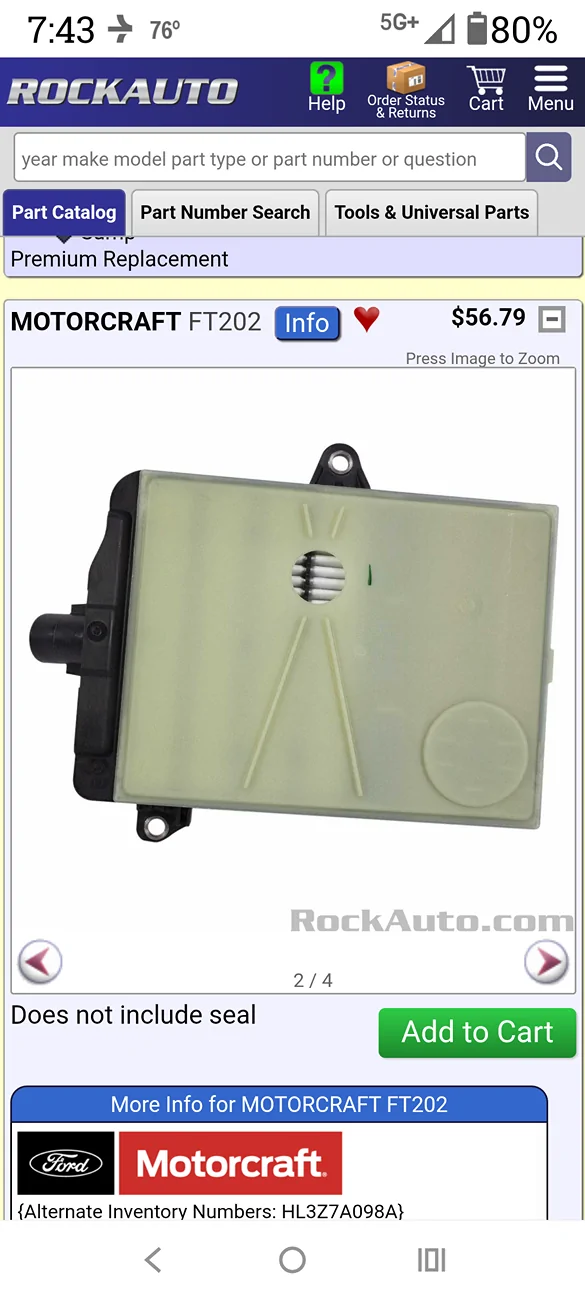

Your dealers wrong about the transmission filter
Yep, dead wrong 10000000%.
The filter is a pleated unit that will not 'clean out' if it is flushed.
Right,
sometimes it’s not worth arguing with the ”experts”.
I even asked specifically what is the cost to replace the filter and that’s when he said there wasn’t one,
