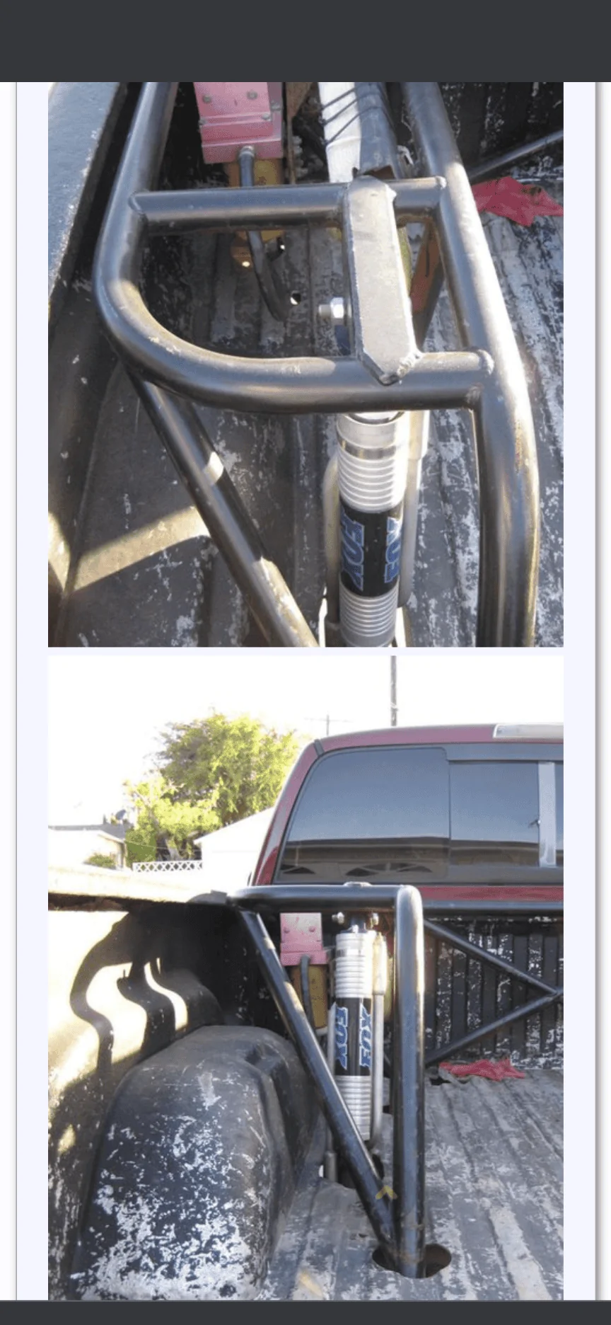

I just want enough room to put my pit bike in the center to go fart around on until I get another truck in 3-5 years. Something like this
Bajaforged has one to order, but I requested an estimate for the cage without the spare holder in the center and I asked them how it mounts up.
https://www.bajaforged.com/ford-ranger-bedcage
I don't want a spare in the middle, but I do want 2 vertical spares as close the the bedsides all the way back as possible.
When my yearly bonus is 20k-40k I'll remove the bed, remove the leaf springs, link it, put a fuel cell, and upgrade to a full floater.
I'm reading that a spring under helps with axle wrap, any other benefits?
If I leave the springs on top and 2 link it to prevent axle wrap, I wonder if I could use those links when I add trailing arms down the road. Dang trailing arms are the price of the deavers. This research is never ending.
You will be able to get a lot more travel with a spring under. Downside to these trucks though is there isn't a lot of room between the frame and inside of the stock fenders.
I'll re-state my opinion on a bed cage. The size of these beds are small. Even mounting the spare tire vertical you will lose a lot of room. If you don't need the truck bed then go for it. If you need the bed don't do it. Let's say you do a 35" tire.... Even without the cage that tire takes up over half the length of the bed.
I've got a few extra inches with the fiberglass on the inside.
I definitely need to do more research on a leaf spring setup that I can be content with for a few years. I'll bolt up the deavers and figure out a bed cage down the road. Looks like a spring under would benefit if I had a longer spring pack.
I've already measured the locations of the vertical spares. The bed is small and I only want enough room in the center to put my little bike.
