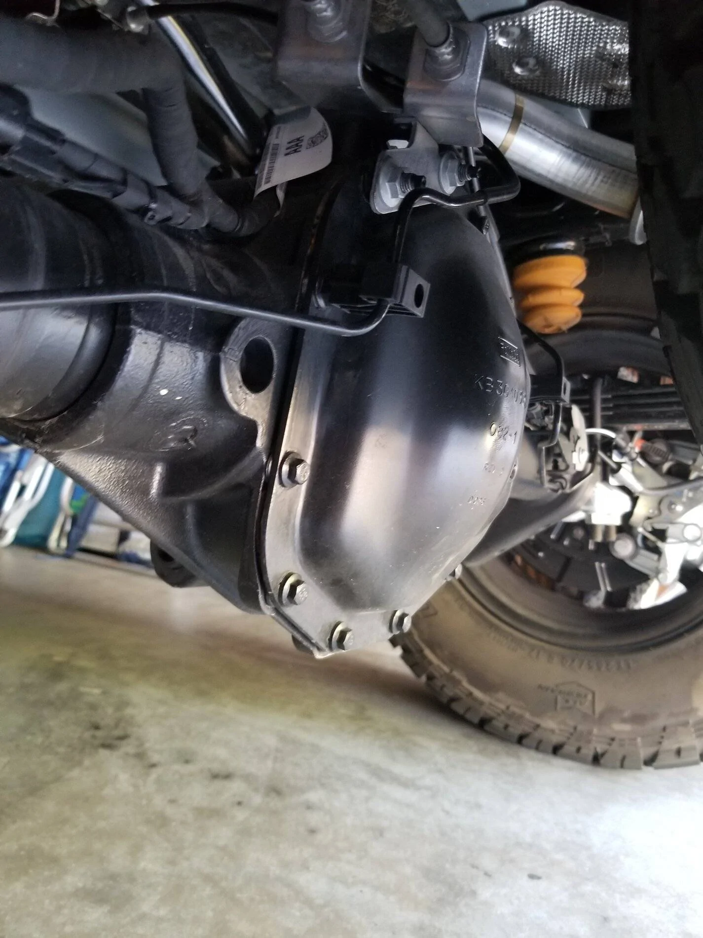

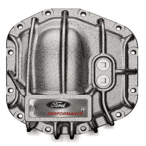

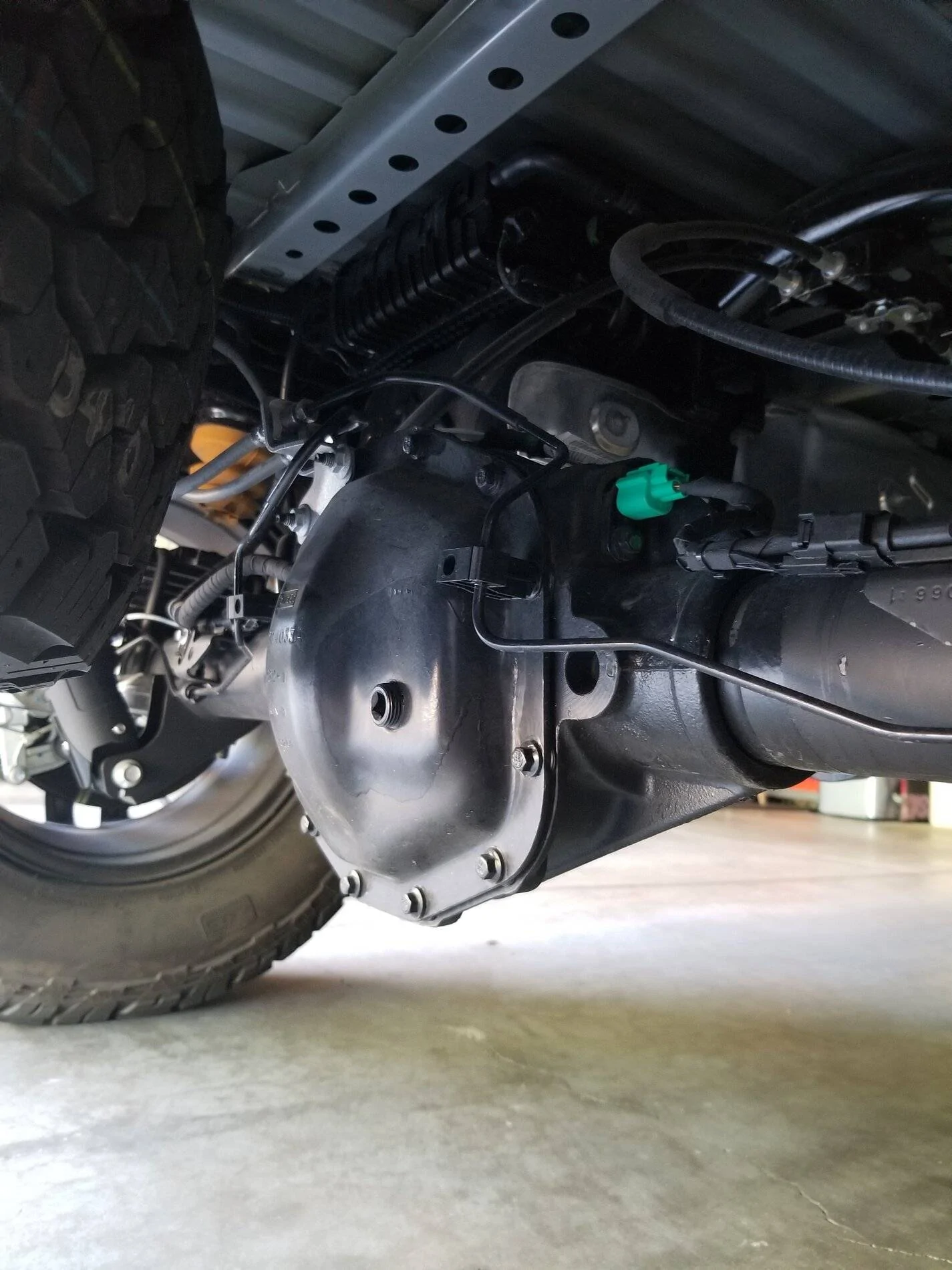

Looks to me the brake line bracket that is mounted to the axle via the diff cover bolts would be the reason that cover won't fit by Ford's standards. my 19 Lariat W/ locking rear diff does not have the same mount. but another Tremor owner might have better insight.
I think you are correct. That bracket would need a spacer or mod to clear the casting rib.
