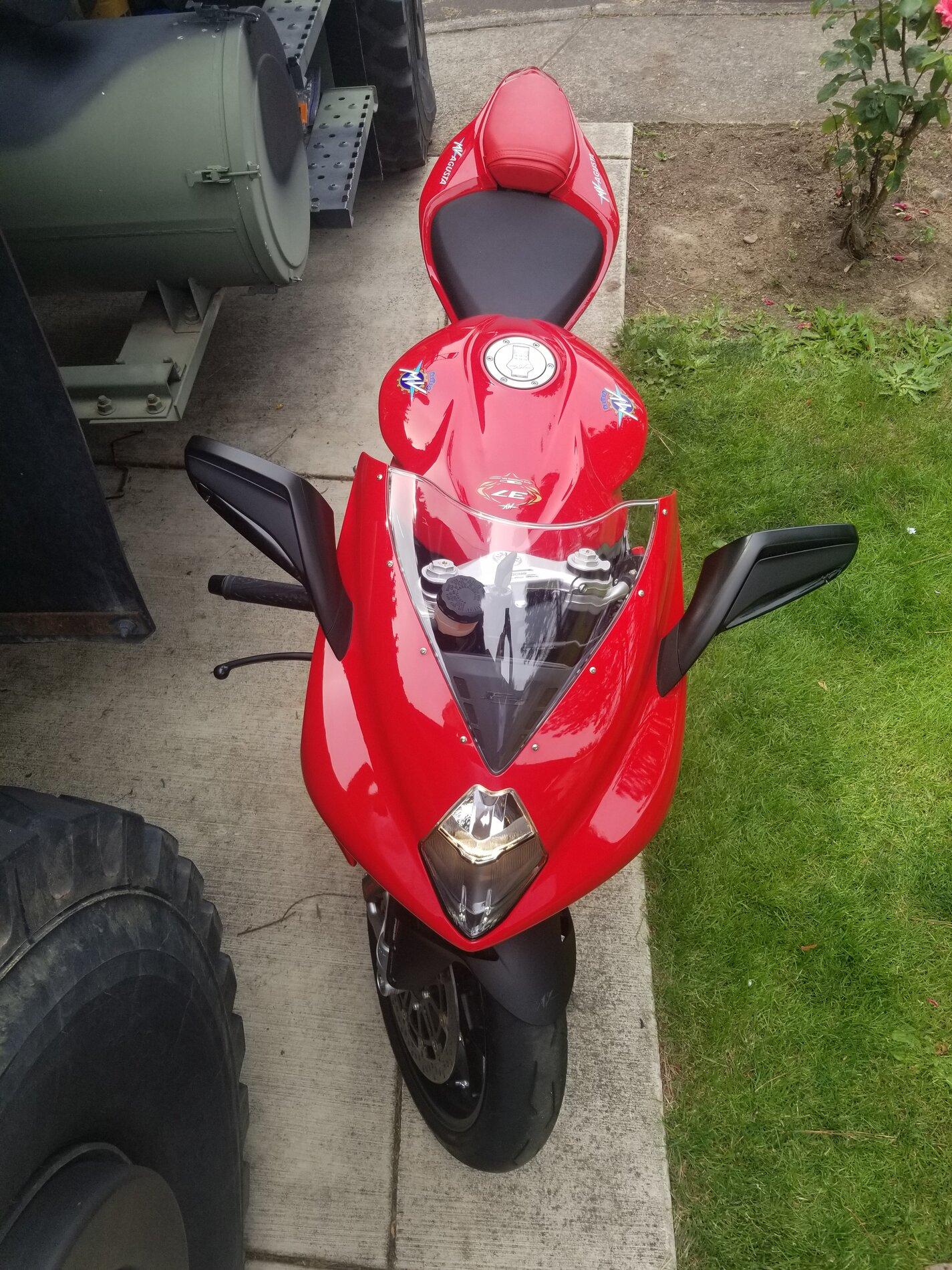

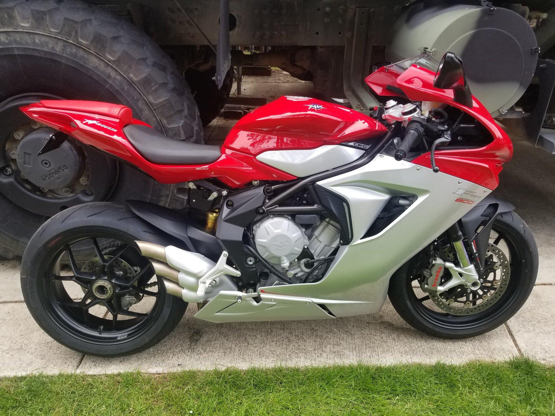

My most recent motorcycle is my MV Agusta F3 800. I just installed a fresh set of Pirelli Supercorsa SP tires- hoping to do some track days at COTA this year...

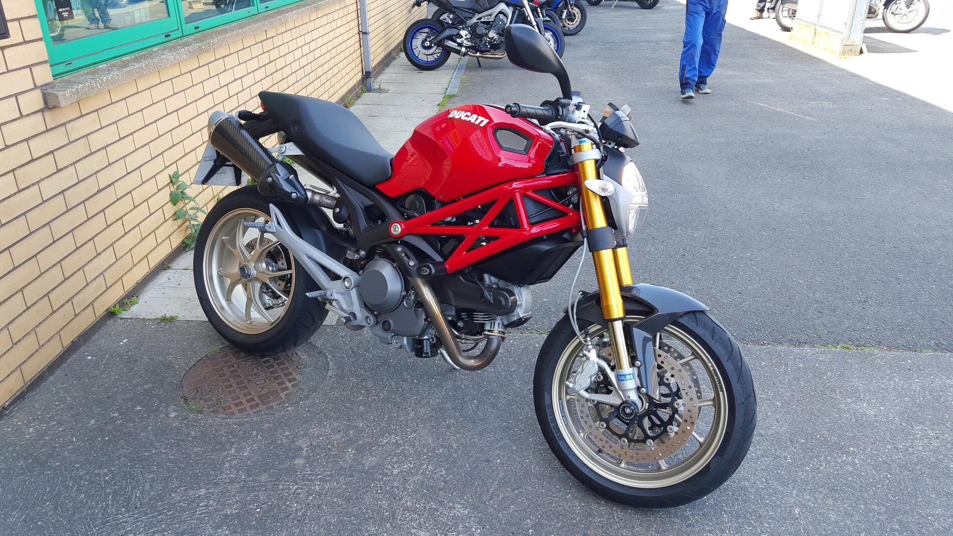

When we went to the Isle of Man for practice week and race week of the TT, we rented Ducati il mostro 1100S, with full Ohlins suspension and carbon-fiber Termignoni exhaust ($250 a day), to ride the course at triple-digit speeds (there is no speed limits on the Isle of Man outside of town).

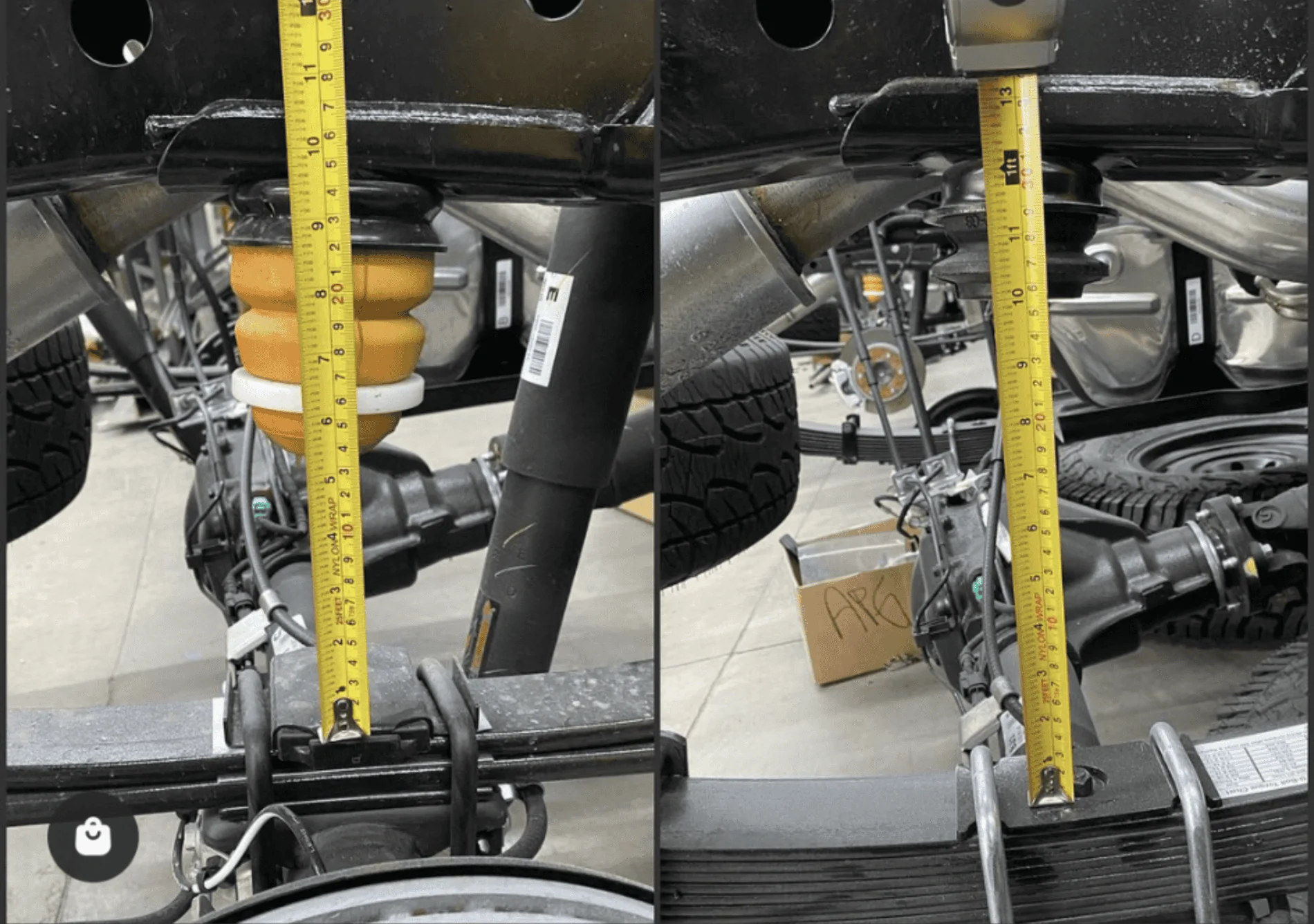

I'm not going to lie that the APG Springs are pretty darn nice. They're definitely great for someone who only wants to level their truck or not lift the truck whatsoever. But my question to you is how much shorter are the bump stops for the APG Springs? To my understanding they're not short by that much compared to the factory. I want to say it was only what half an inch at best? Don't get me wrong half an inch is still quite a bit but not enough to say you're going to gain way more travel Overstock.
You gain roughly 30% more usable travel with ApG springs and bump stops over factory. The difference between the ranger bumps and raptor bumps (the ones apg uses) is huge. See pic
Travel is rated up and down....combined. So at a static ride height, if your setup to sit mid stroke and have 14" of travel. You have 7" up and 7" down. That's a very simplistic way of looking at it.
So I can technically have the truck sit lower than stock (assuming right parts are used and geometry accounted for) and still have more travel than the factory suspension. It's all about suspension setup, allowed clearances and a proper cycling.
This idea of needing to lift to gain travel is wrong. You need longer arms/ springs/ shocks....whatever. I don't have to lift. Again....very simplistically put.
I could link the rear, throw on some nice long PR King coils, sit at factory ride height and blow APG's travel numbers out of the water. But that's a complete redesign of the rear end

How do you like the Deavers with Raptor bumps? What shocks are you going to use? Are you able to use the stock shock mounting locations? Do you have to use limit straps to protect the shocks?

I love everything about this post. Italian art in the form of a motorcycle, the military vehicle behind said art work and doing track days at COTA. Can we be friends ?
Sure.
The F3 was the last motorcycle designed by the late Massimo Tamburini, "the Michelangelo of motorcycles". 148 horsepower, and 381 pounds. It is as exotic as any Ferrari- it makes Ducatis look like Hondas, by comparison. It handles better than anything I've ever ridden. And it sounds like sex on wheels.
